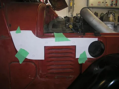

Paper template of my one off 3.5" snorkel for marking and drilling

I gotta say she's on there good. Pounding with your hand she feels very solid - no tinny feel to it. I grabbed it and shook it with two hands and the whole truck moved on the suspension. No movement between the snorkel and the cab at all. One could definitely push through the bush without worrying about the snorkel or use it as a hand hold when trying to walk on the fender to get the winch line:D
They aren't very heavy. I could make them with thinner material but the welding gets slightly harder the thinner you go and this thickness allows more grinding and sanding to make it purdy.
