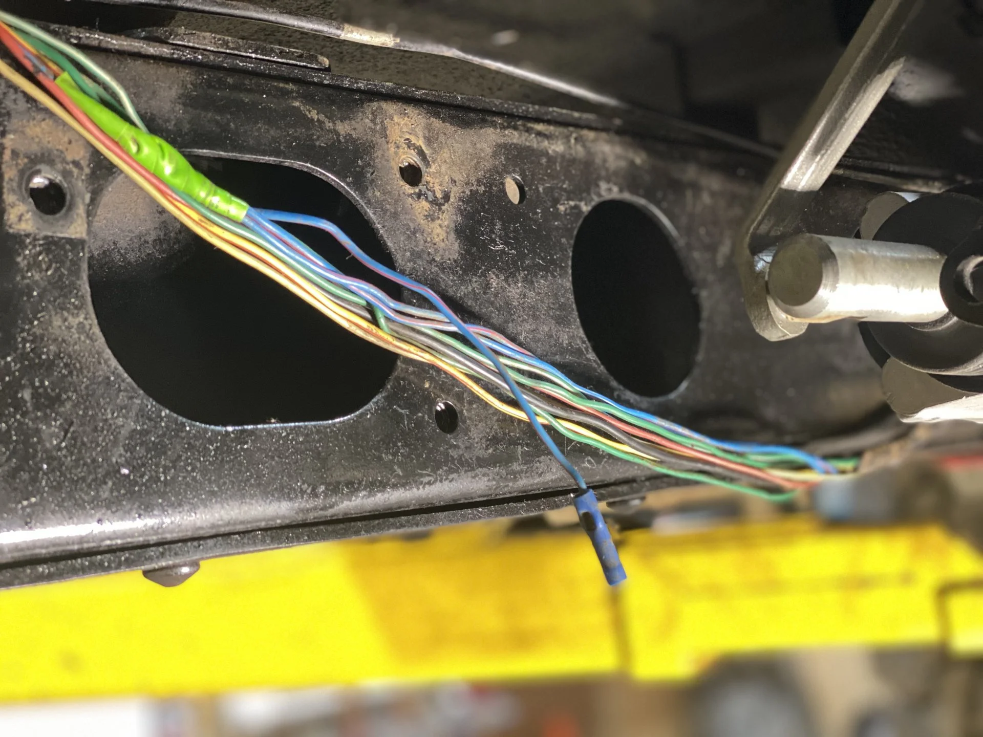

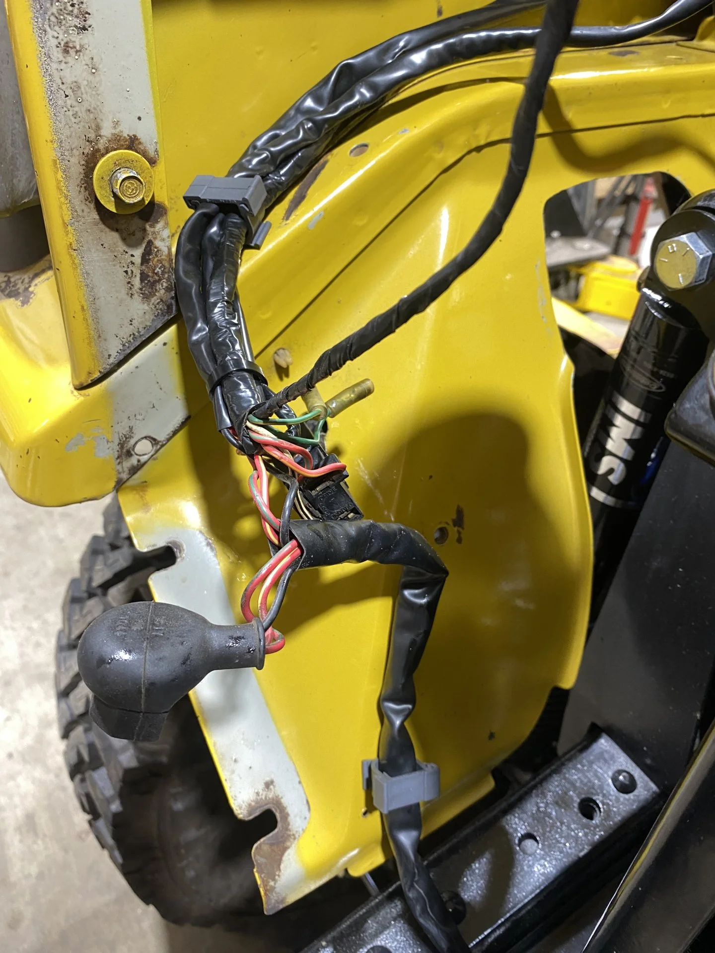

Went under to hook up the reverse lights on the transmission and discovered someone decided to tape in a bunch of random wires into the main harness.
I recommend against this. Anything you add could short out if you are dumb enough to do this so just zip tie your 10 gauge black wire to the outside. Maybe you won’t kill your harness

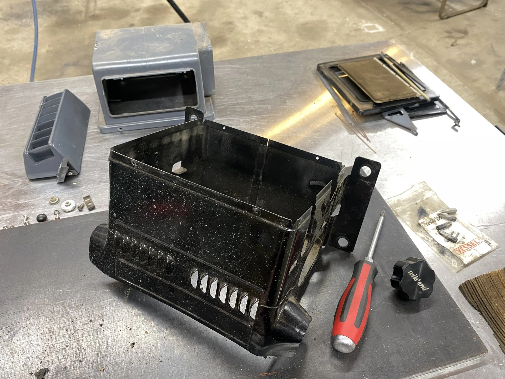

The heater box has some “eh” stuff going on so it’s getting dissected and a new core via City Racer. Powdered as well.

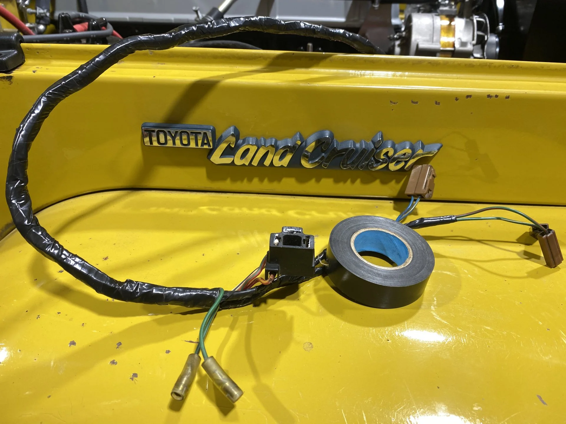

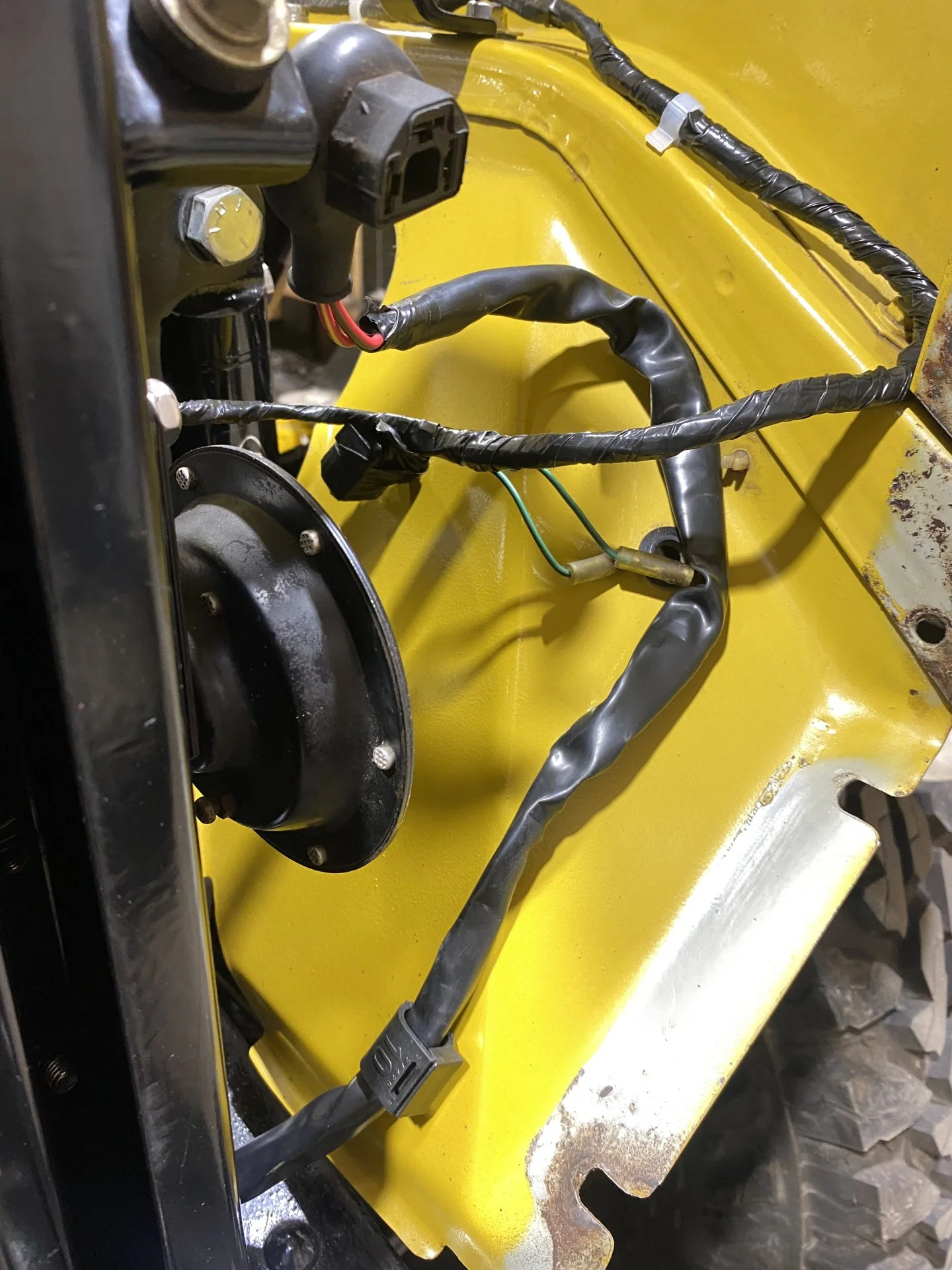

Then I started on cleaning and retaping the factory loom and identifying wires. So many things that are not used once these get modified. Toyota loom tape via @Onur is the cheese.

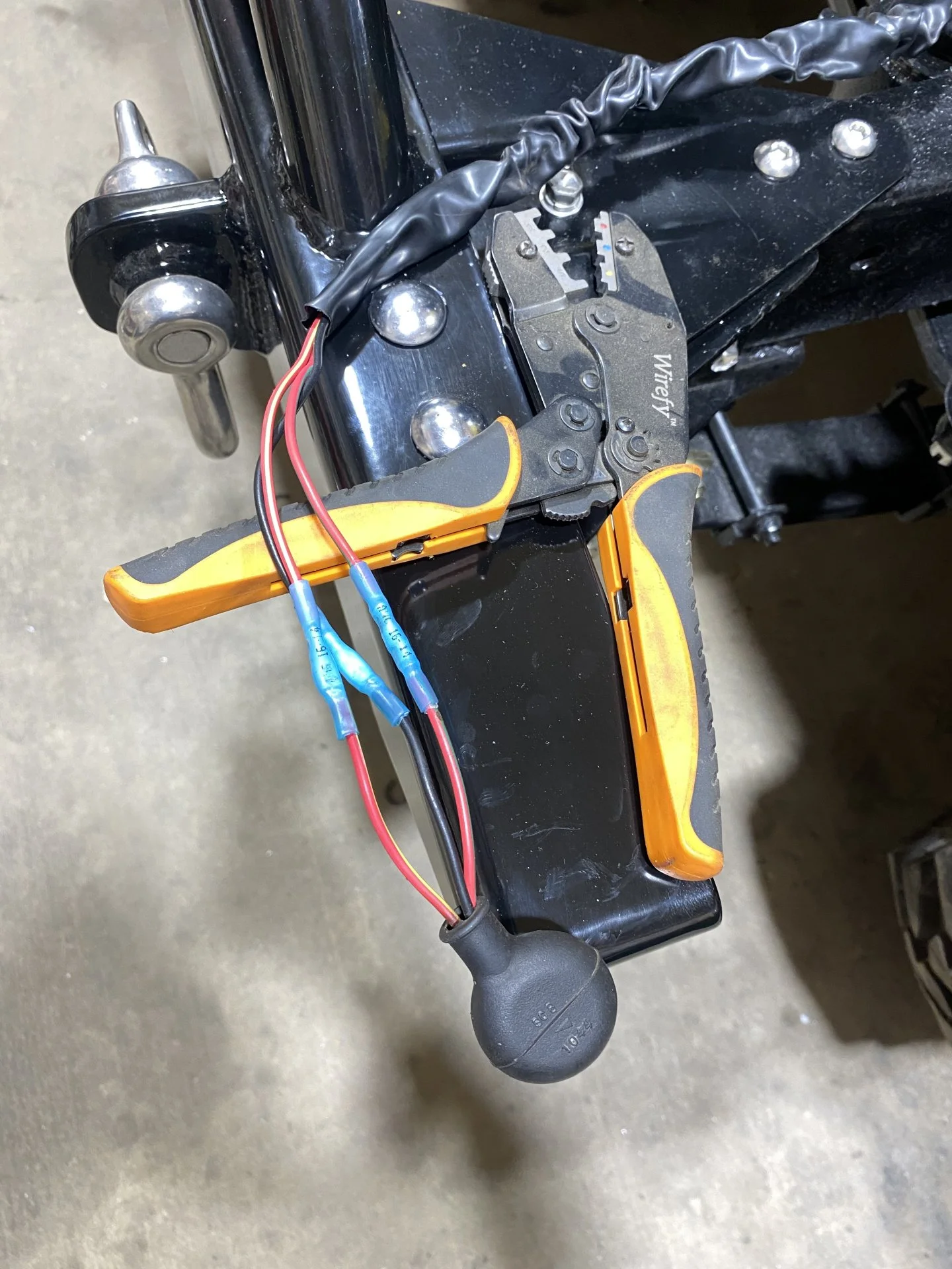

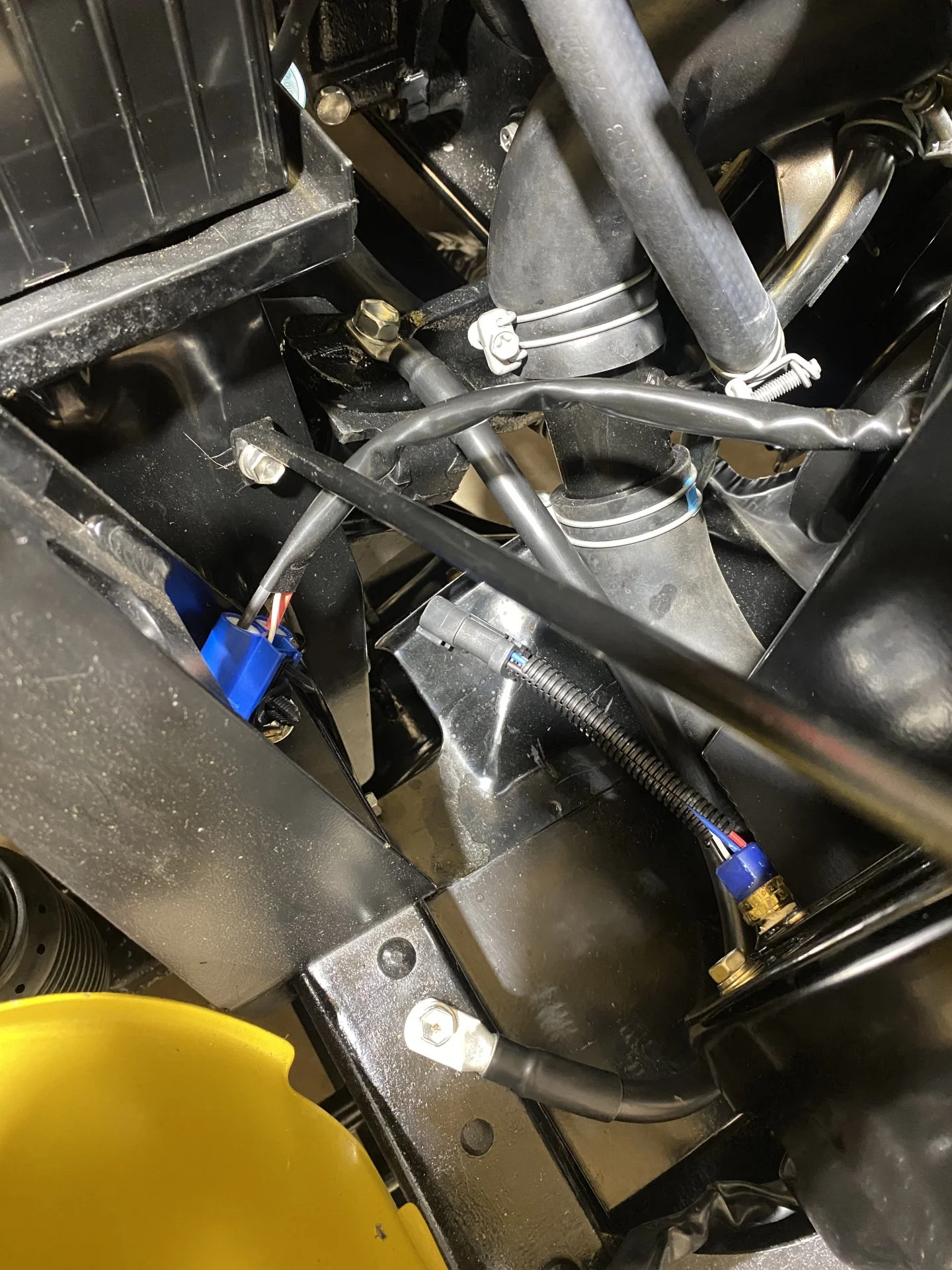

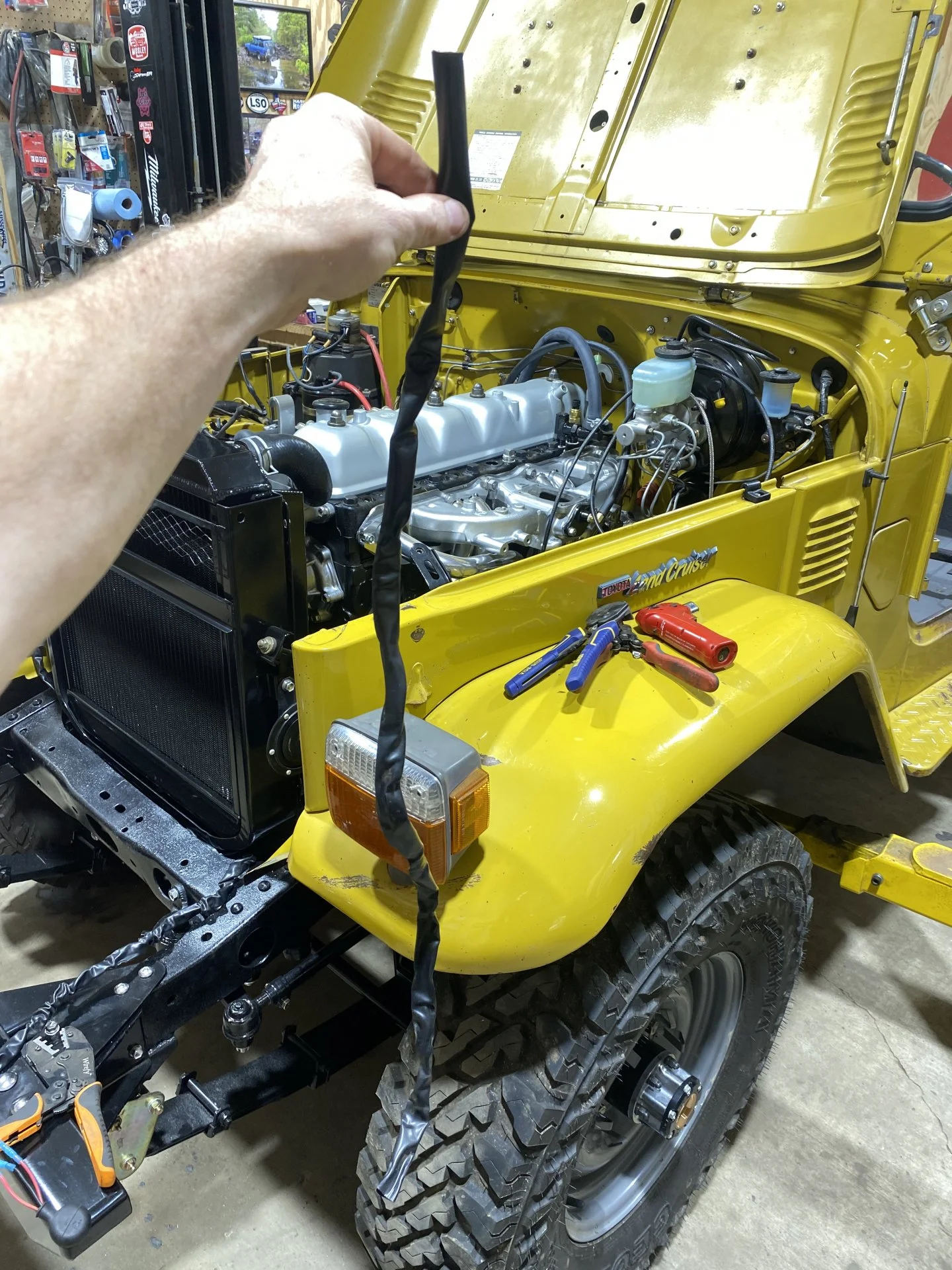

The Koito H4 light kit is truly the greatest value of anything ever available from Toyota but there is enough wire in the harness to go around the firewall versus the direct route across the grill. I trimmed 5’ out of it and used some cool wire loom clips @Onur sent me.
Lop them off and join them back up. Why would you need Toyota parts to reconnect 3 wires?

@Fourrunner HD cable kit with an extra ground from the starter to the frame not pictured.

Just a different way to do things, depin the plug and shorten from there. To each their own.
I wasn’t questioning your work. Just a different way to do things, depin the plug and shorten from there. To each their own.

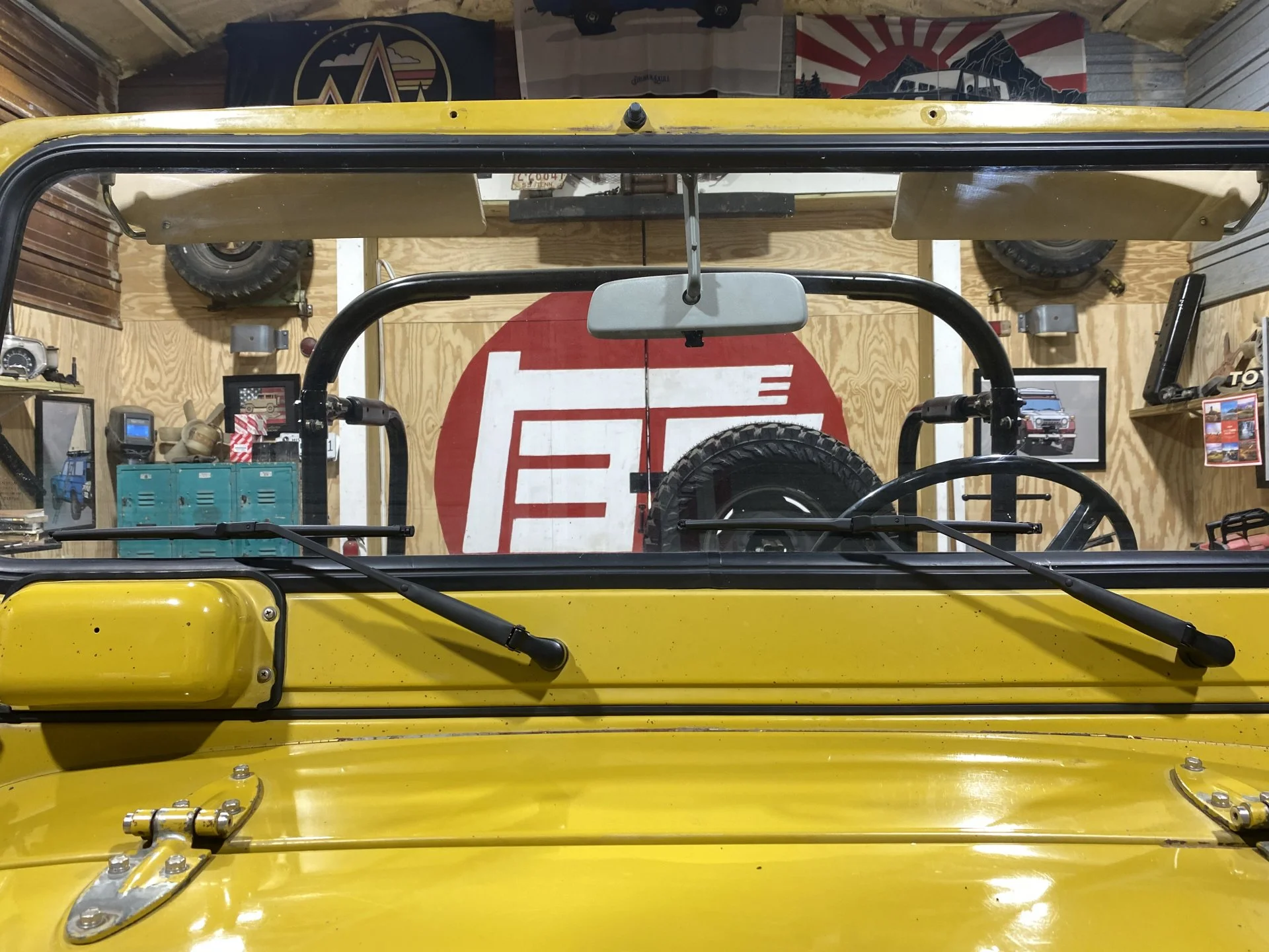

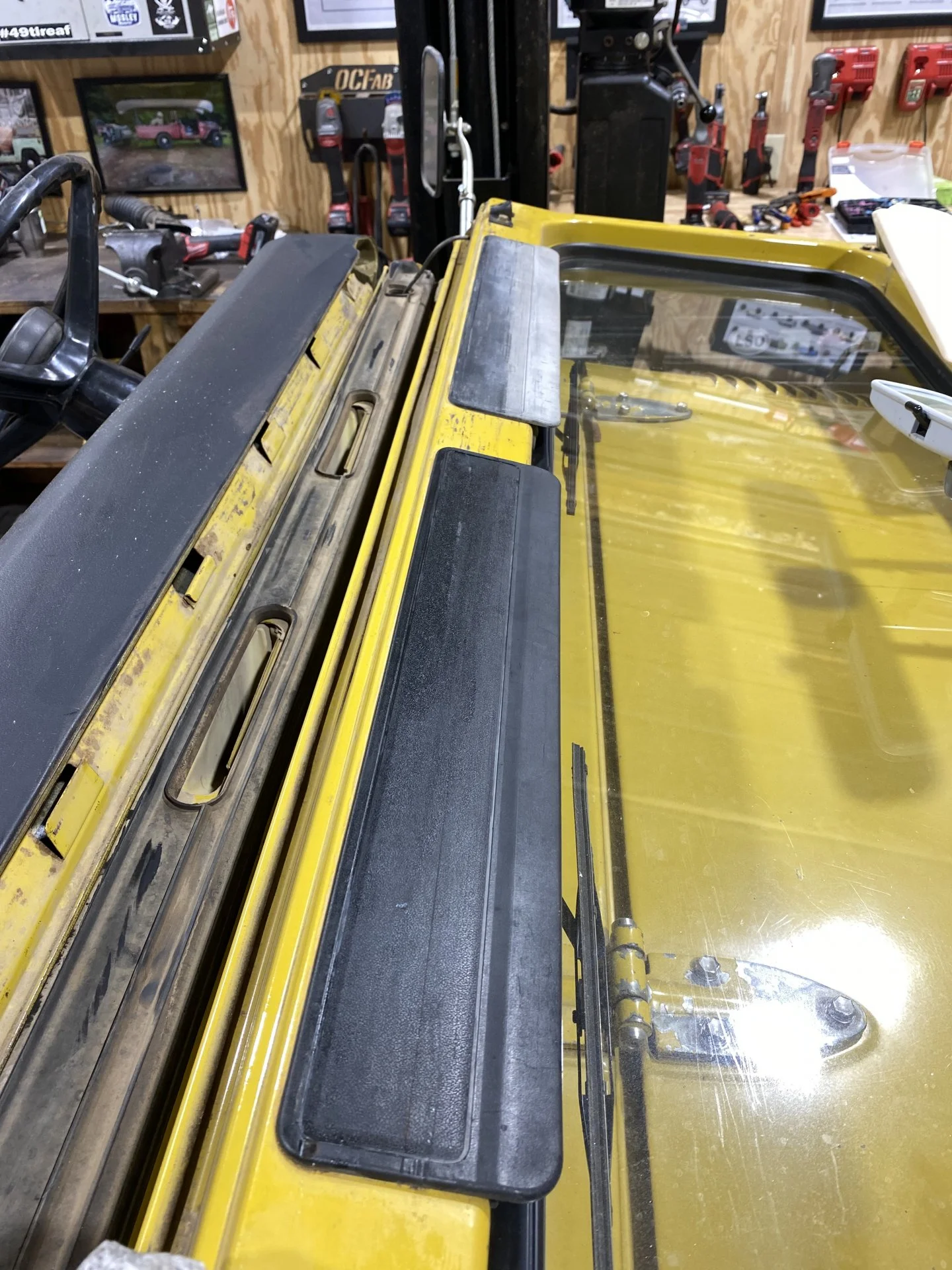

When I trailered this to my shop I dropped the windshield and saw the gasket was crusty and the defrost vents are faded white. Can’t have that (driver side vent uncleaned)
Polished out the black with some alcohol and then some Mothers Back to black.

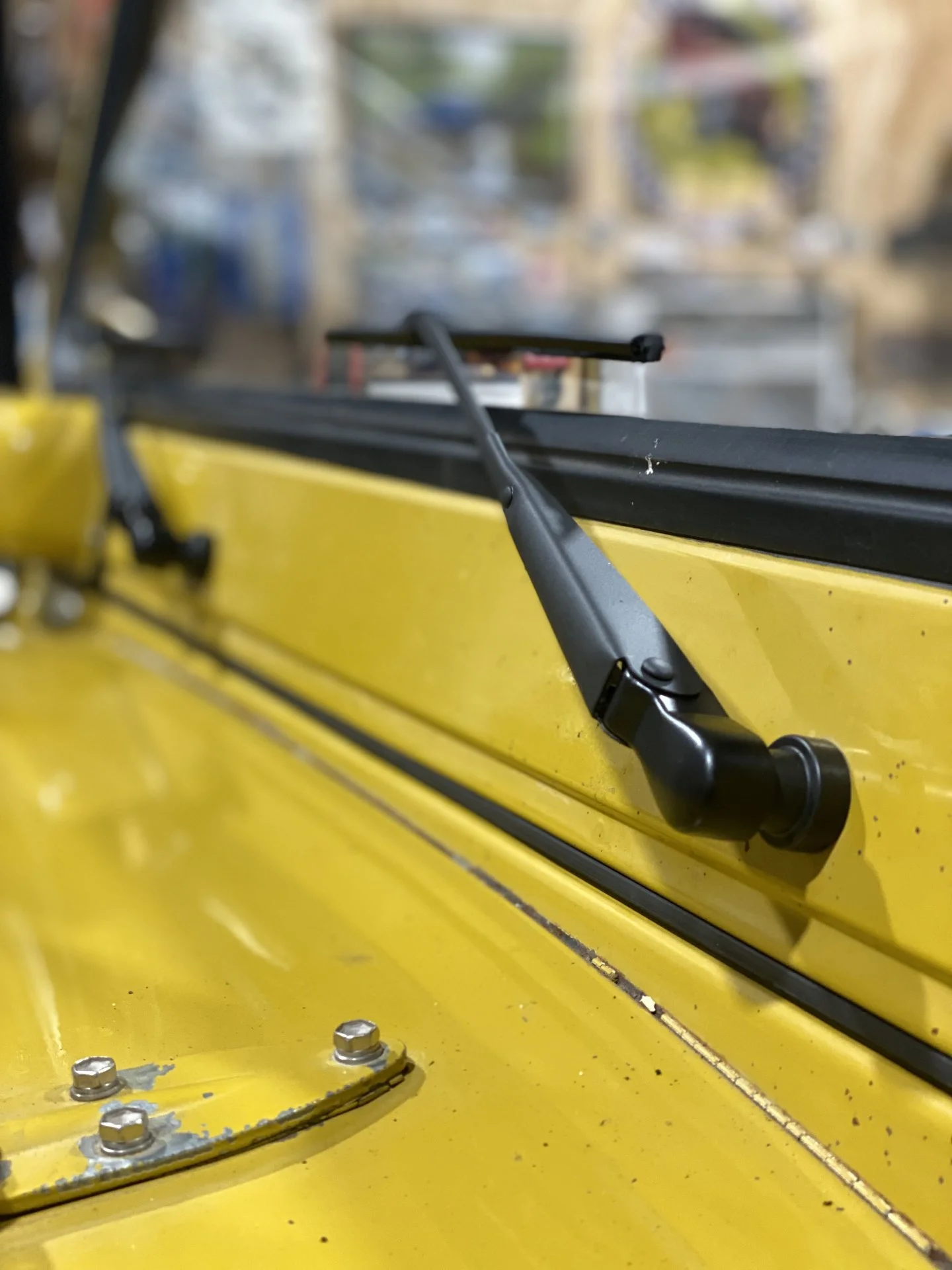

Buttoned that up and installed some beautiful new OEM wiper arms and blades via @Onur

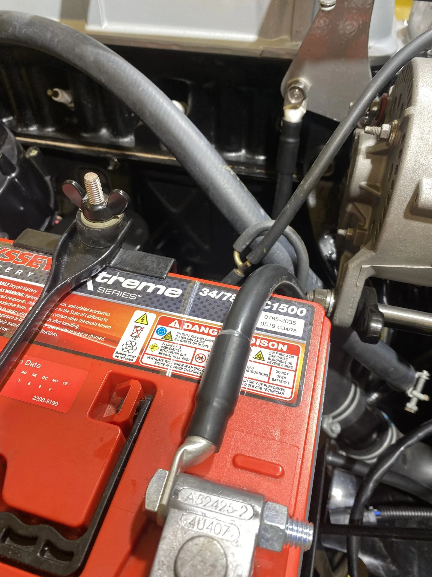

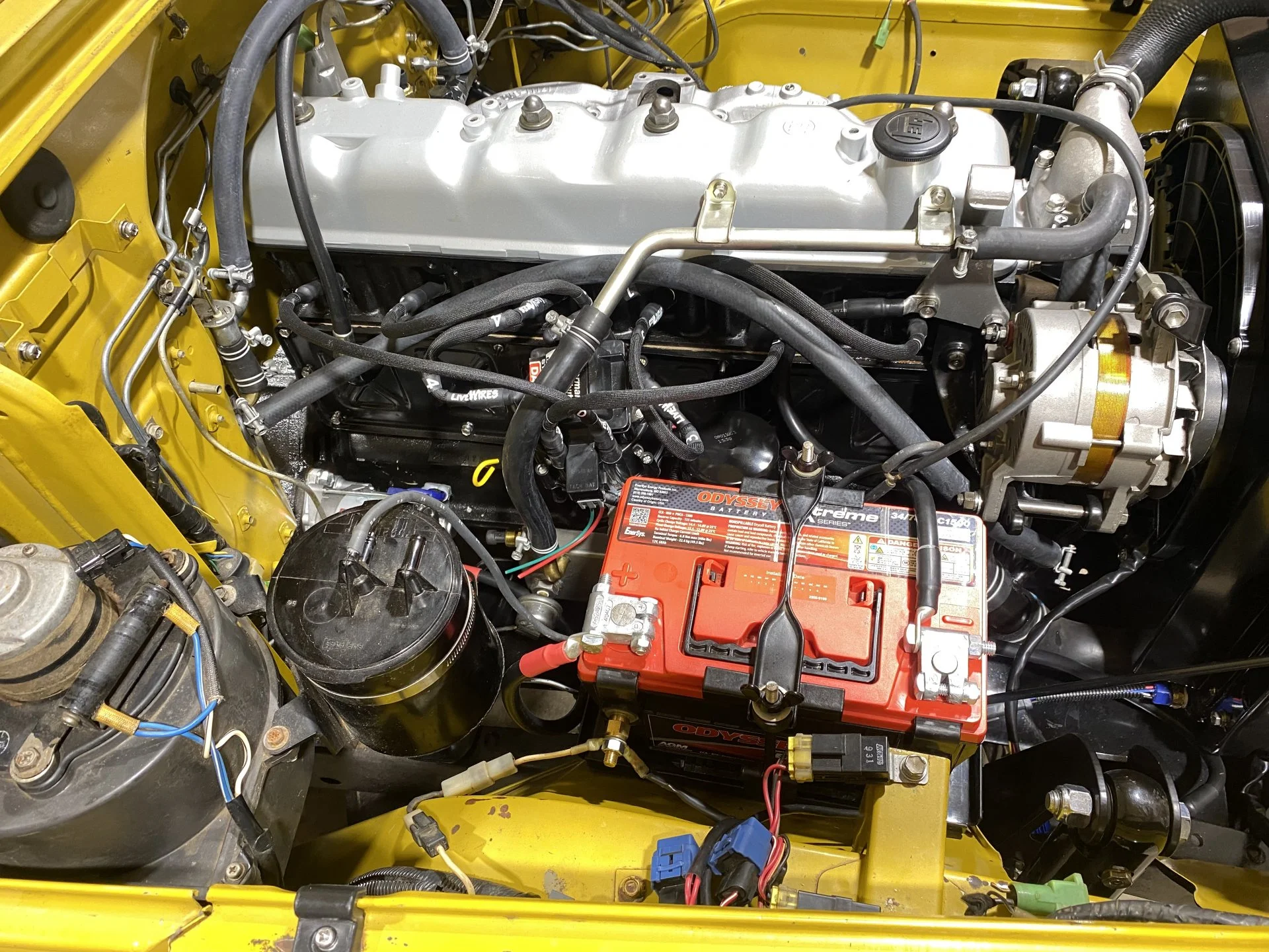

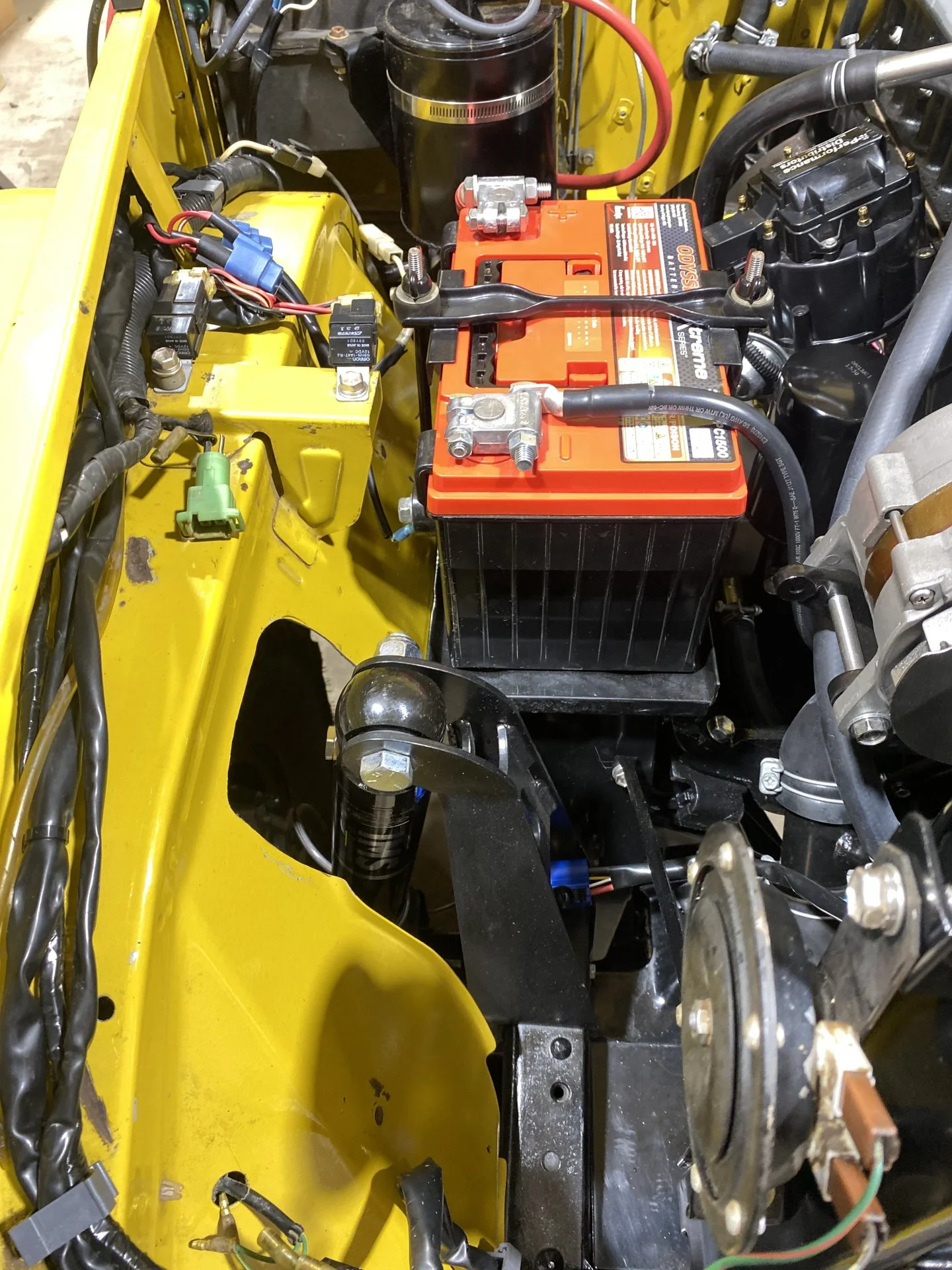

A while back I bought a replacement battery tray set up like the one here. I was really pissed when I couldn't get the wing nuts on and cursing the supplier. Now that I see the set up you have here it makes more sense and I can see I'm the dummy....Where can I get those rubber bumpers?
I think these are sway bar bushings. Nothing special
