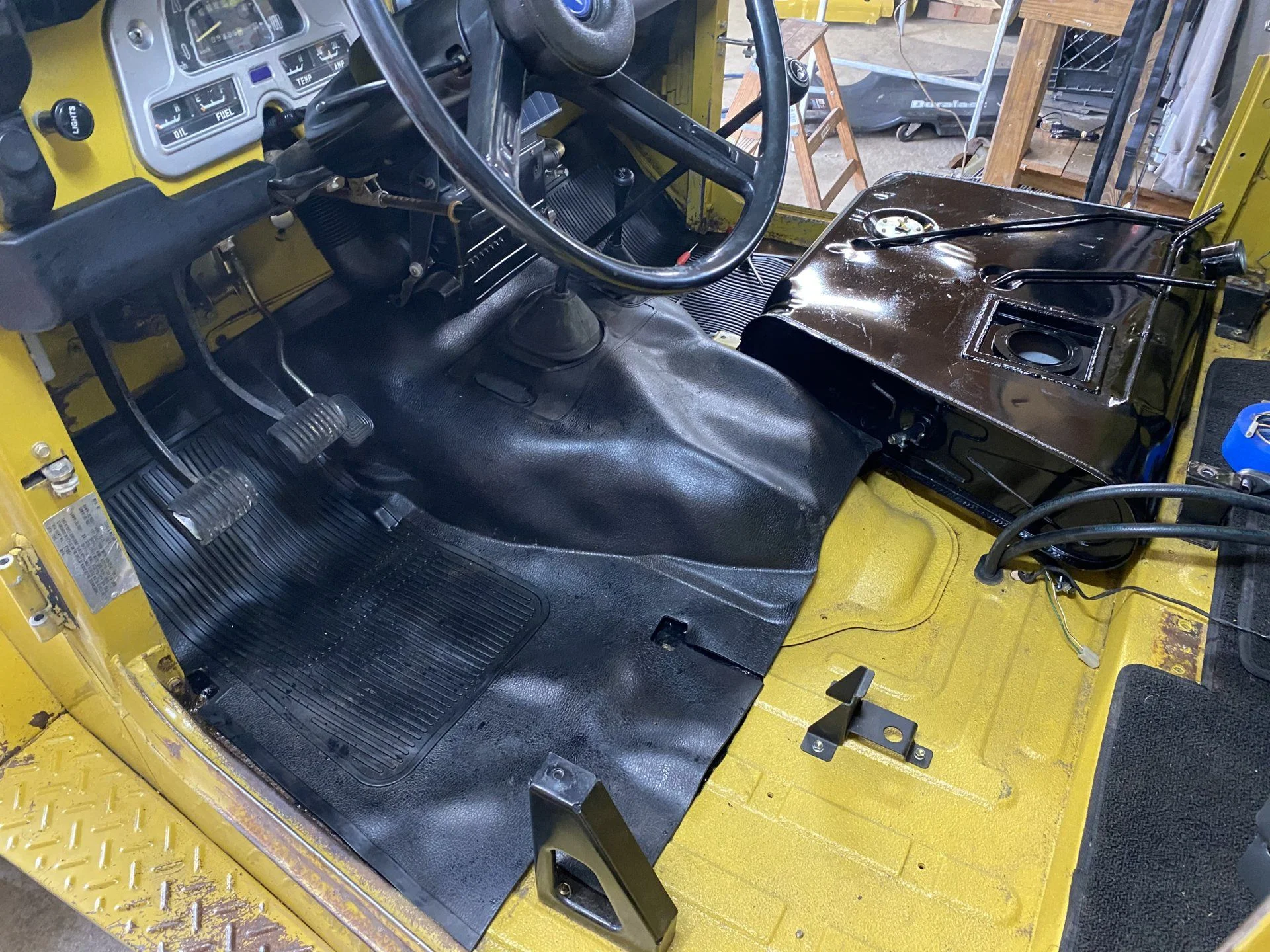

Put a coat of paint on the tank first off so it will be somewhat dry when I install it.

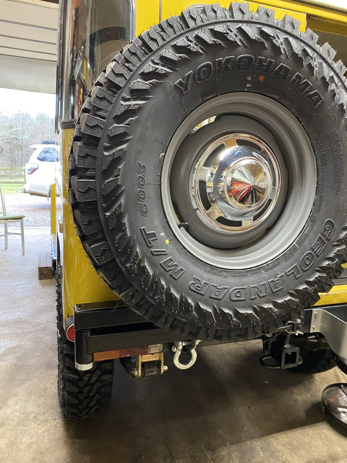

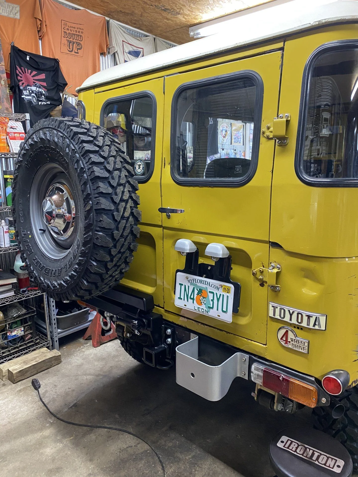

I added the swingout in the 4Plus carrier and installed the tire.

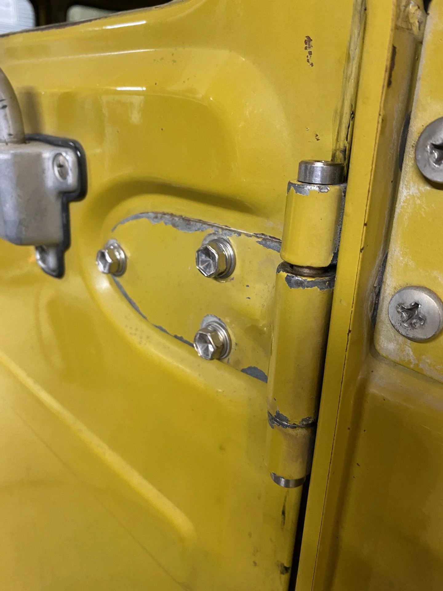

Passenger side Amby door installed with the hinge that was used to match the powder coat.

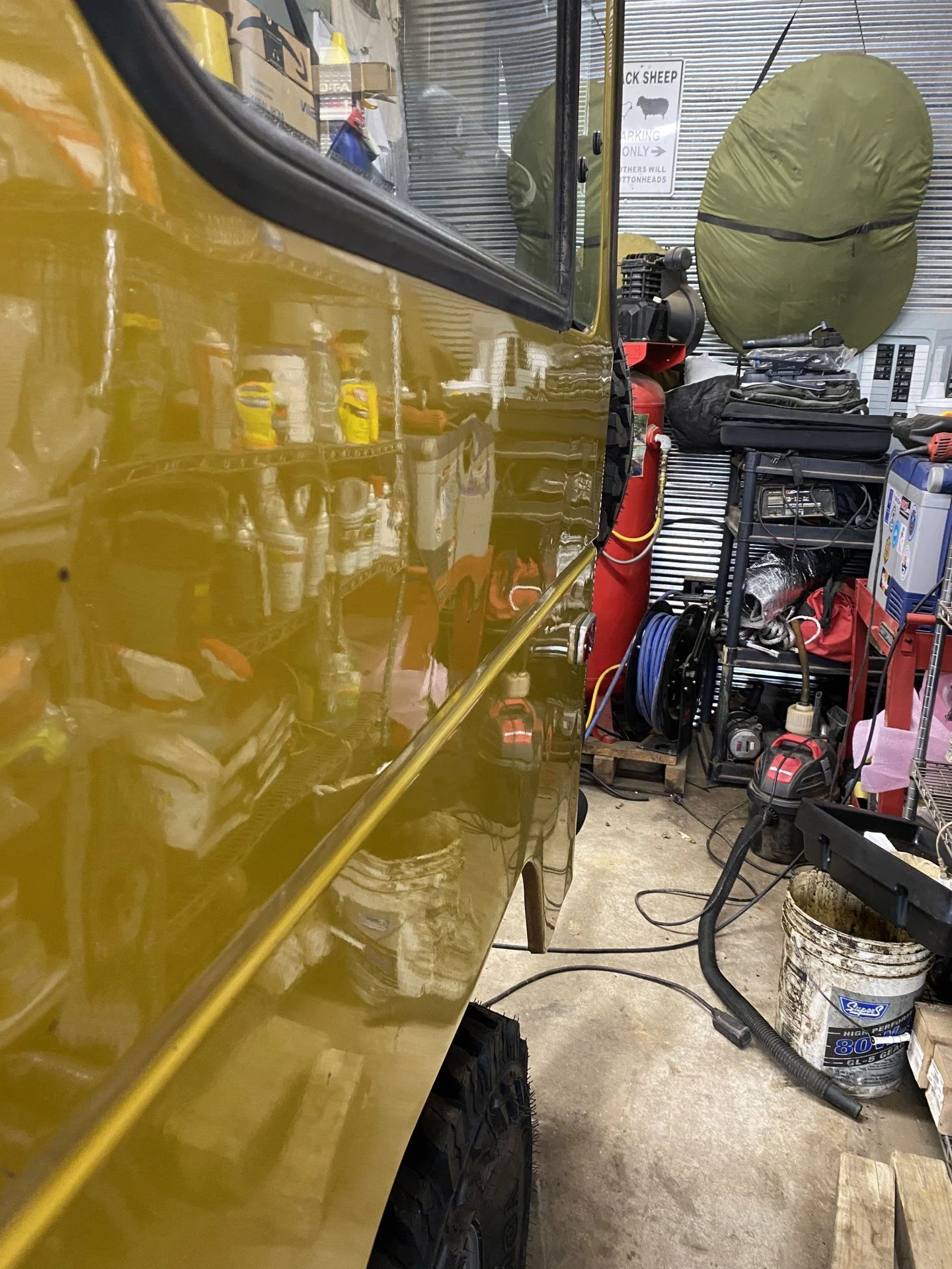

New weatherstrip on these doors makes all the difference in the world. The thing closes like a coffin now. Add the rattle free spare carrier that makes it where the spare does not stick out beyond the tub and you have solid money.

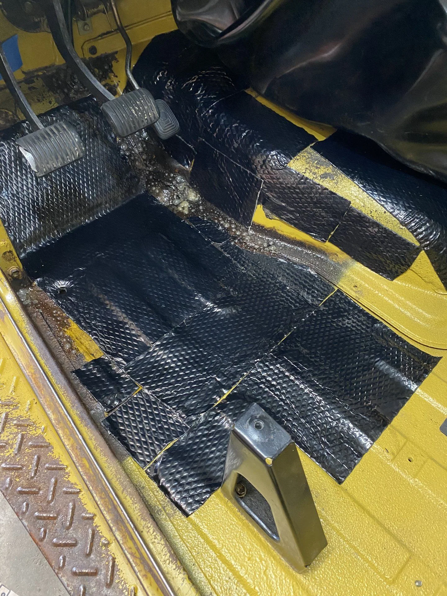

One of the biggest complaints I have about these old trucks is how damn hot they are inside with the top and doors on.

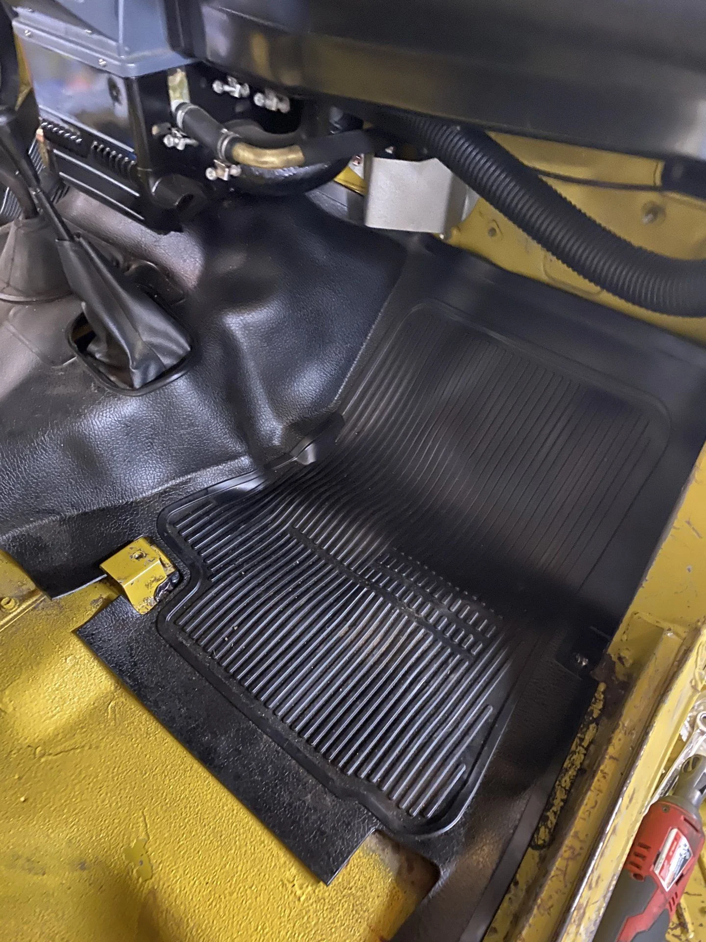

I added a fresh tcase inner boot and lined all the places that can’t be seen under the fuel tank and City Racer mat with Noico.

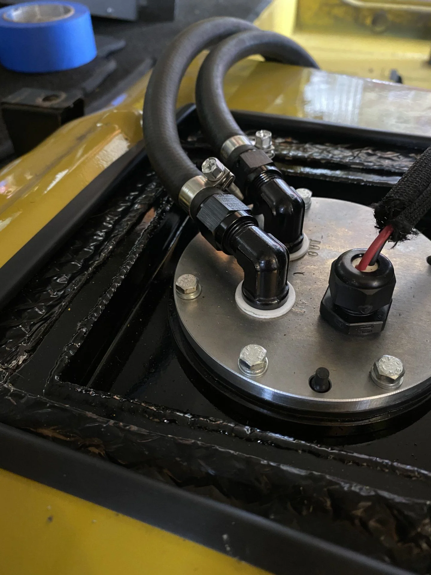

Top of tank will get some Noico as well to cut down on any fuel Pump noise.

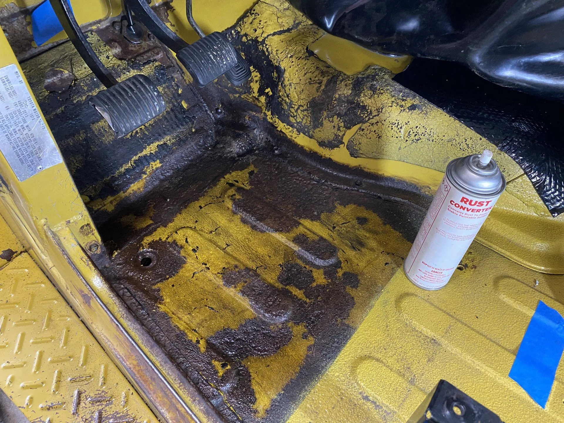

All the drain plugs are reopened. This truck will live inside and John will be reminded to keep it nice and dry under here. There was no active rust so it should do him great for noise and heat
The drivers side has a little more rust. I gave everything a good soaking with Rust Converter and left the rusted areas without Noico. Before I put the mat back I hoses the old rust with Fluid Film and covered.

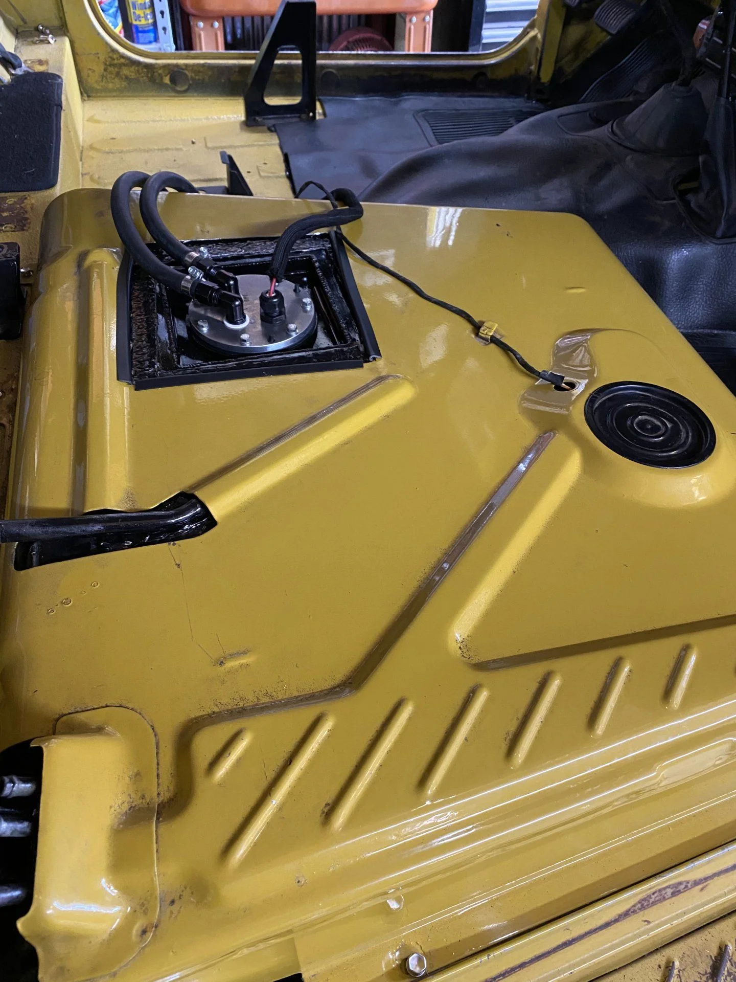

In-tank pump setups, while very nice and reliable and hopefully, quiet, are extremely labor intensive. Bear that in mind if you go this route.

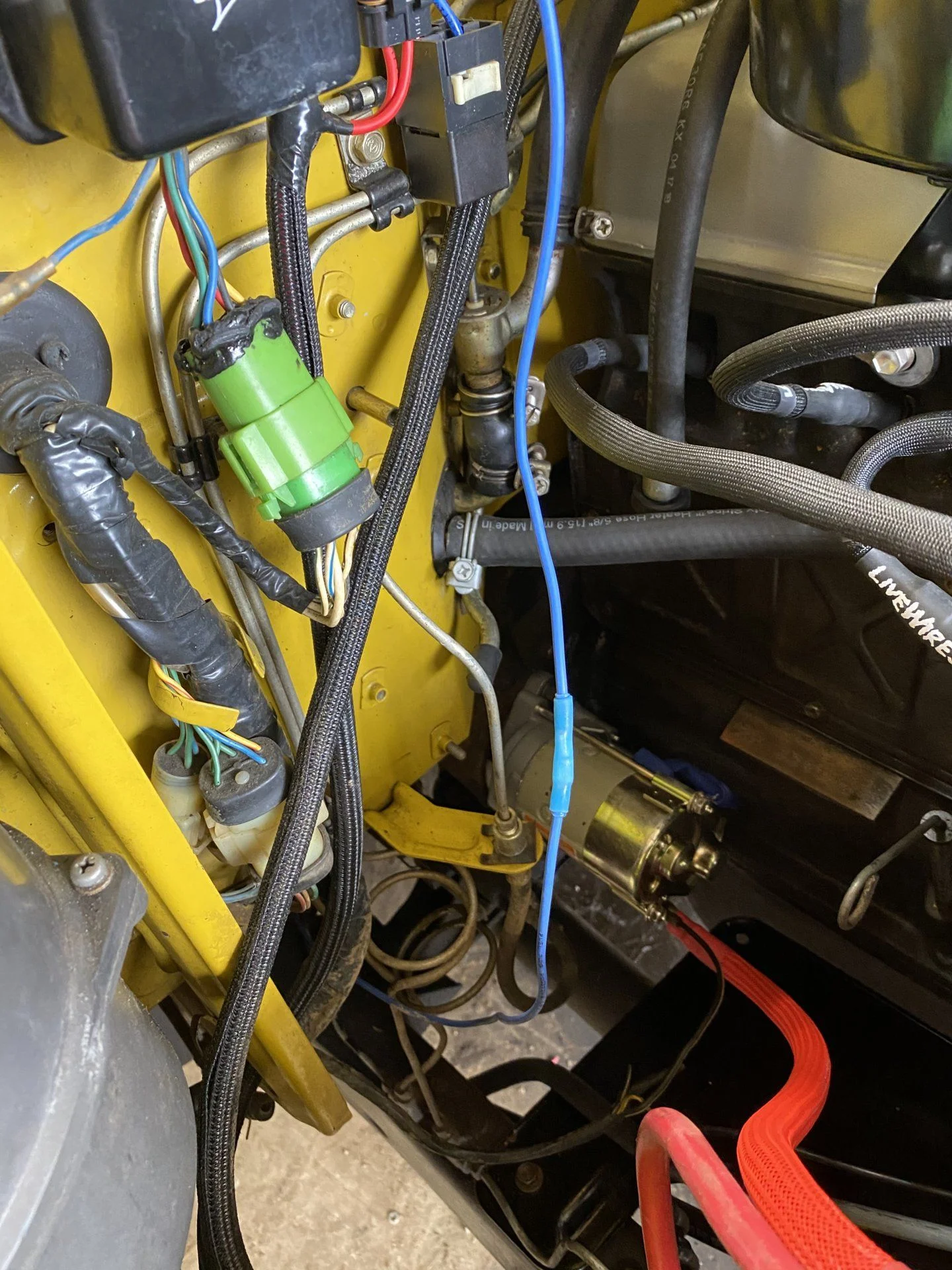

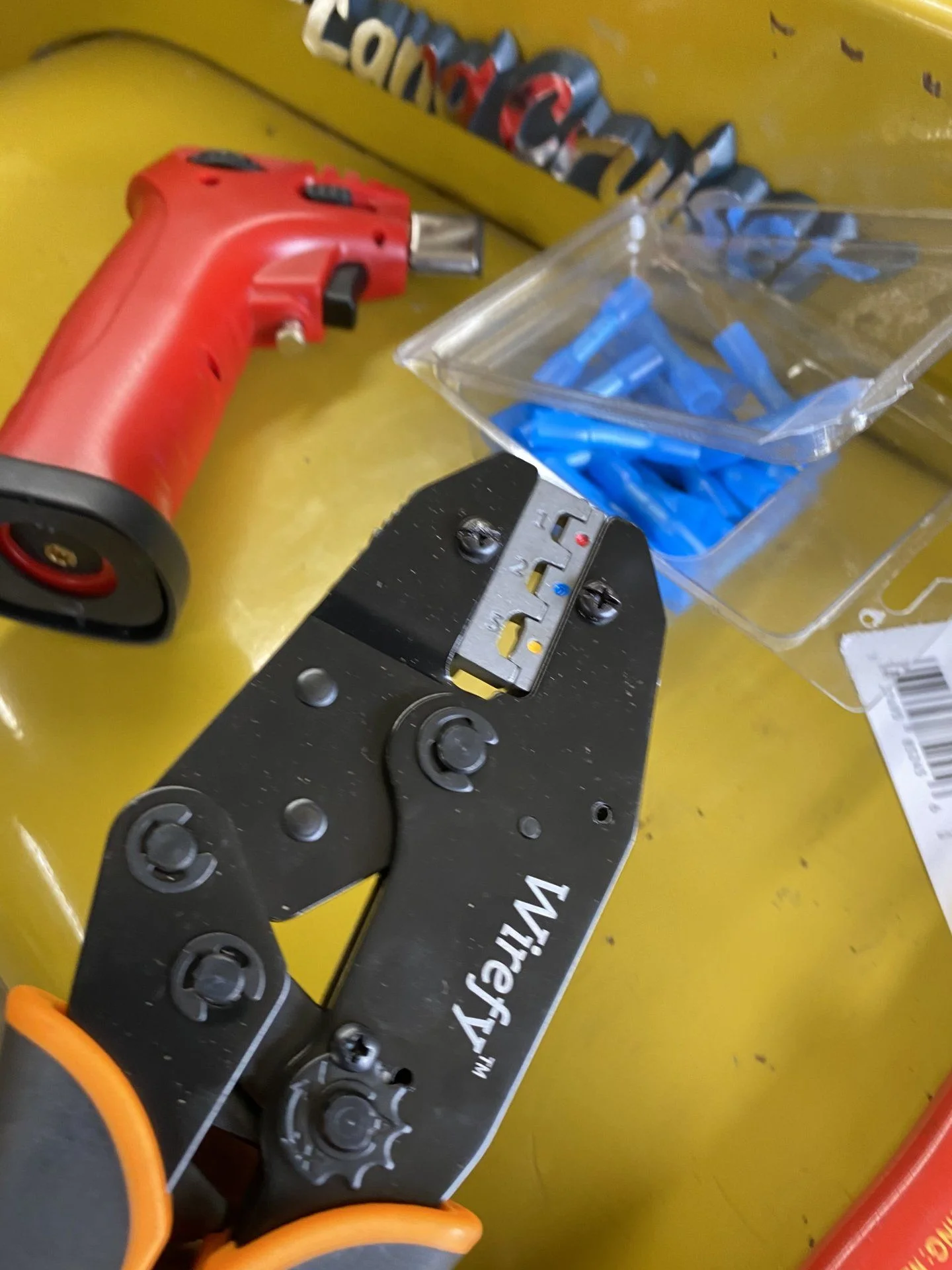

I found some purple Sniper wire and was able to tie in the pump using the proper Sniper color.
These new crimpers I got are $$. Love them.
In and working. I’m waiting on a new fill hose to add gas and prime it.
The harmonic property of these tank covers can me reduced greatly with a barrier. Factory uses some cloth type strips. The fuel pump will likey need more.
I ended up cutting the entire area where the weld in plate was out of the cover because I did not want anything associated with the pump to hit the cover and produce noise

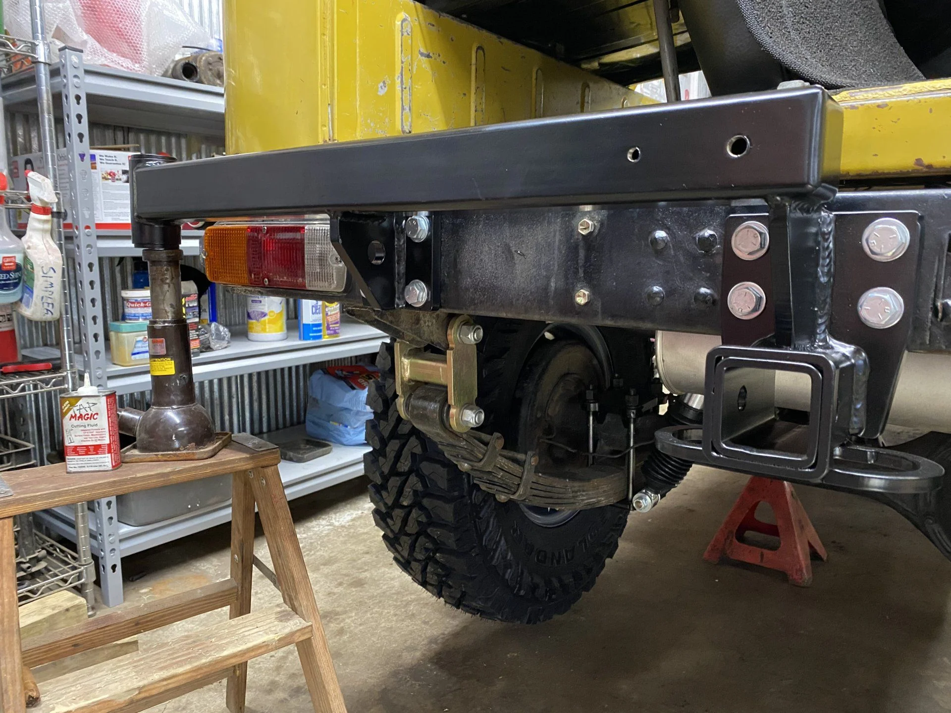

Next I broke out the 4Plus rear swingout and spent an hour drilling and installing the lower section. Sadly, I got the correct lower and the incorrect upper so I’ll have to wait to finish it up. The rest of the hardware is installed so it will be a 10 minute install once the correct swingout arrives.

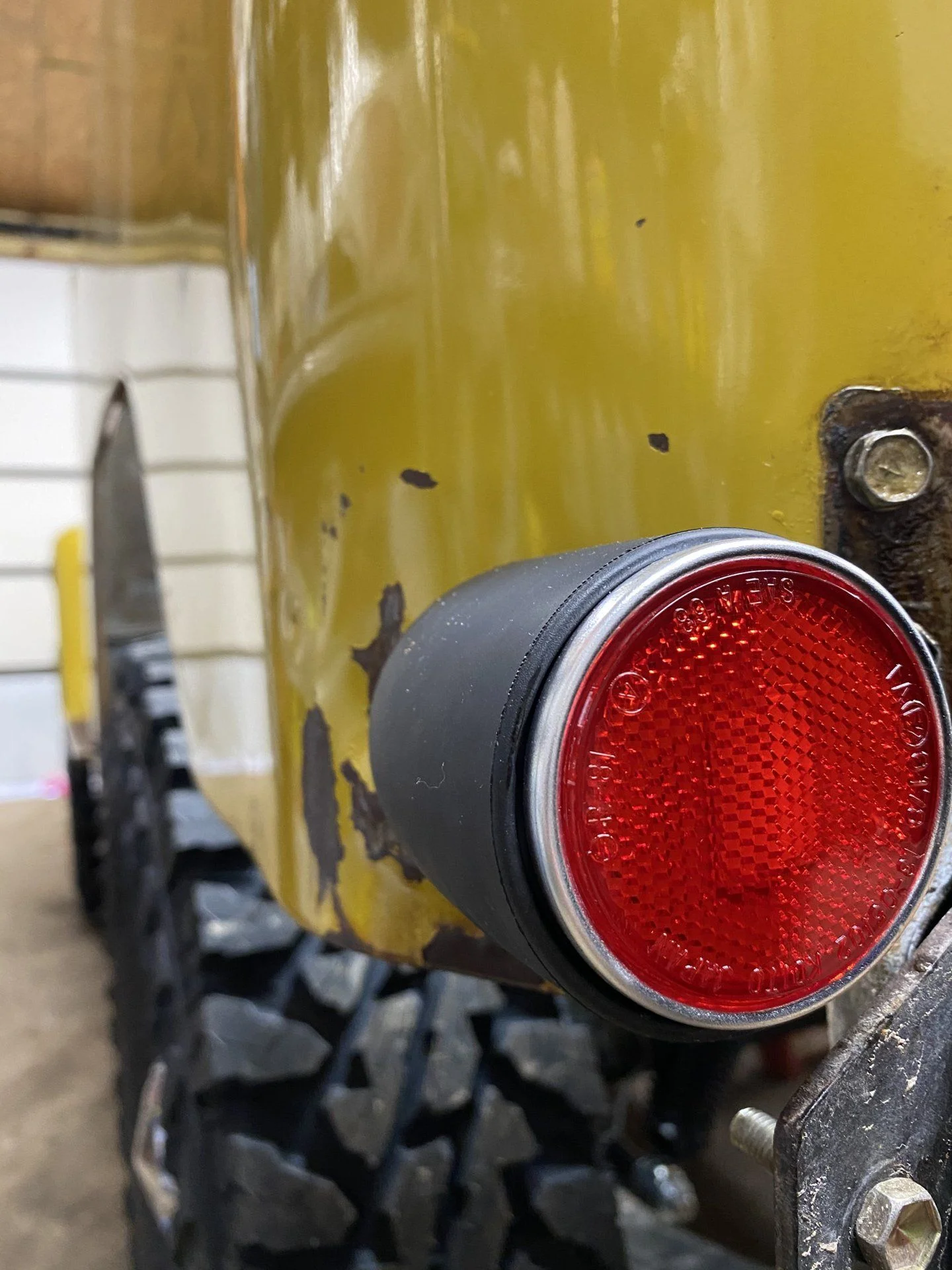

New OEM reflectors. Cleaned up an old trailer harness while I was back there.
These little simple swing outs are on everything build. They get rid of all the annoying rattles in the back and really support a heavy 33” tire nicely. I even adapted one to work on my Pig.
Is the 4Plus rear swingout bolting to the rear bumper/frame only, or utilizing a portion of the factory spare mounts?
I hate how much an oversized tire sticks out on the factory setup. This looks like it could be a good option.
It is the 4 stock trailer hitch bolts and you drill 4 more in the frame.
I run them in my personal rigs and man. They never rattle. Always work. Simple. Takes all the strsss off the body

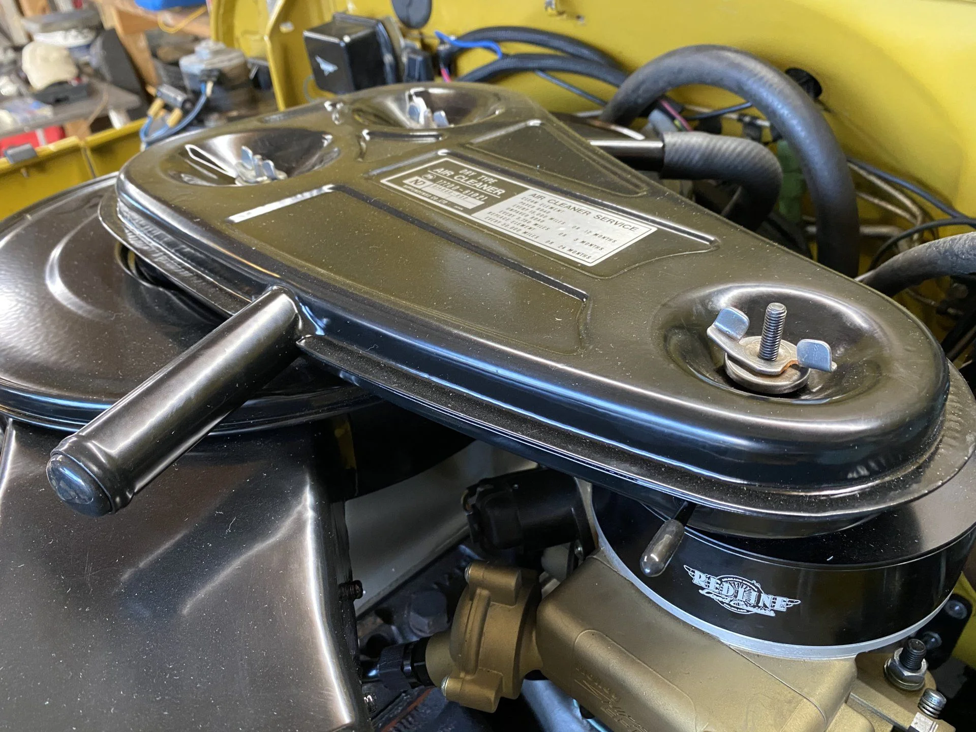

My buddy Mike @Cruiser Corps hooked me up with 3 proper air cleaner nuts and the fuel evaporator.
These high pressure fuel systems send a ton of fuel through the tank Sure, it will work without the evaporator and charcoal canister like to arrived here, but you are basically riding around on a bomb. Fuel fumes and tank pressures are not something to play with, especially here in the south.
All new hoses are on. I am waiting on a new large fill hose. The one on the truck is as hard as a rock.

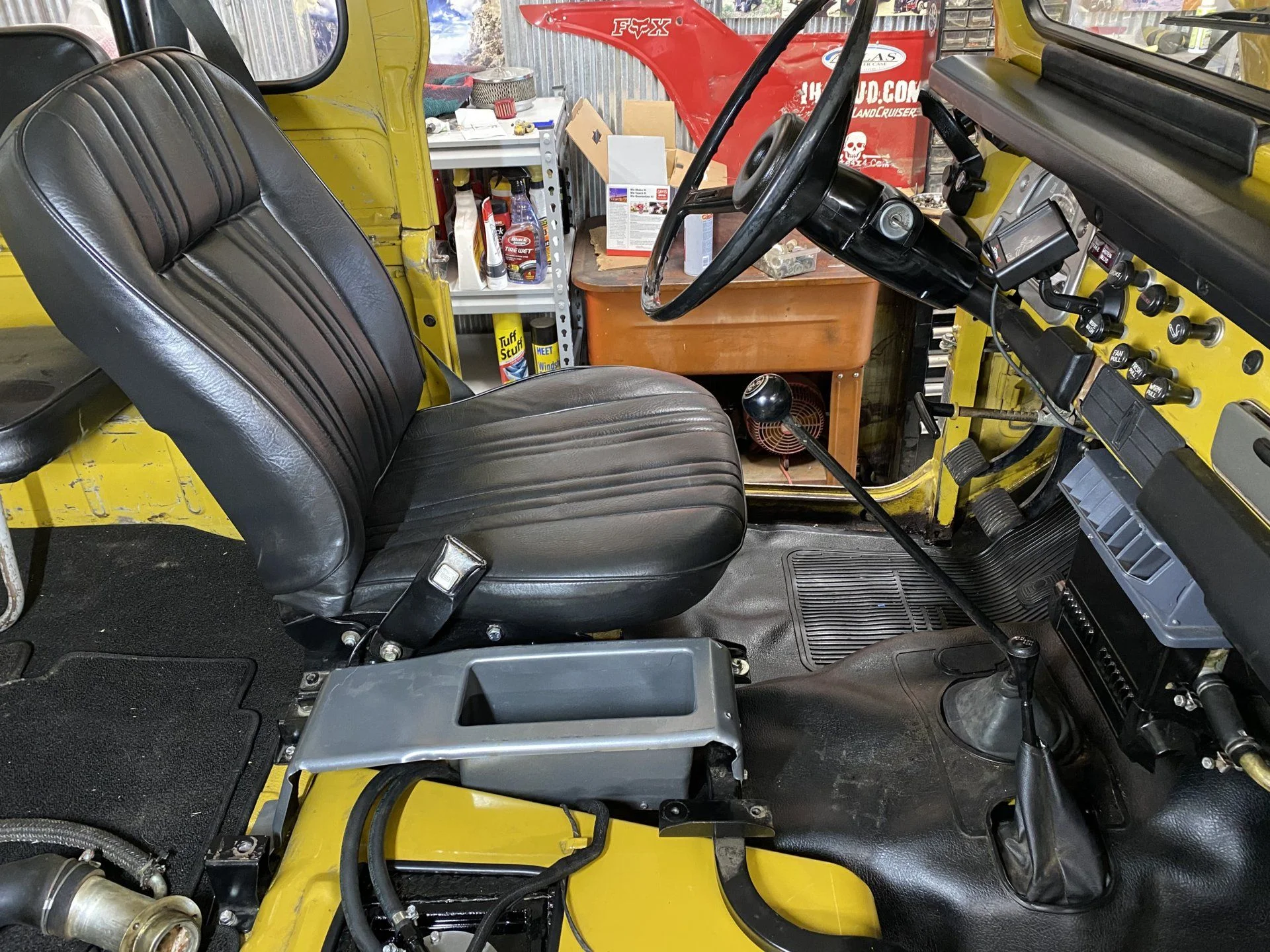

I bent the console back toward its normal position. Most all are bent behind the box part from people stepping on them. This one was that way
I also remounted the ECU display where it can be seen when driving with a suction mount on the dash.

The doors are tight. This is a bit more difficult than the others I’ve installed because the door is HEAVY.
I highly recommend anything he sells.
*tip...:
Install bushings, add your loctite to the bottom screw on the stainless pin and tap it up from the bottom.
I’m thinking the best way to remove them will be to loosen the top and lightly tap the pin down until you can get a grip on it and then pull it out from the bottom
Also replaced the gold bolts in the door with SS
