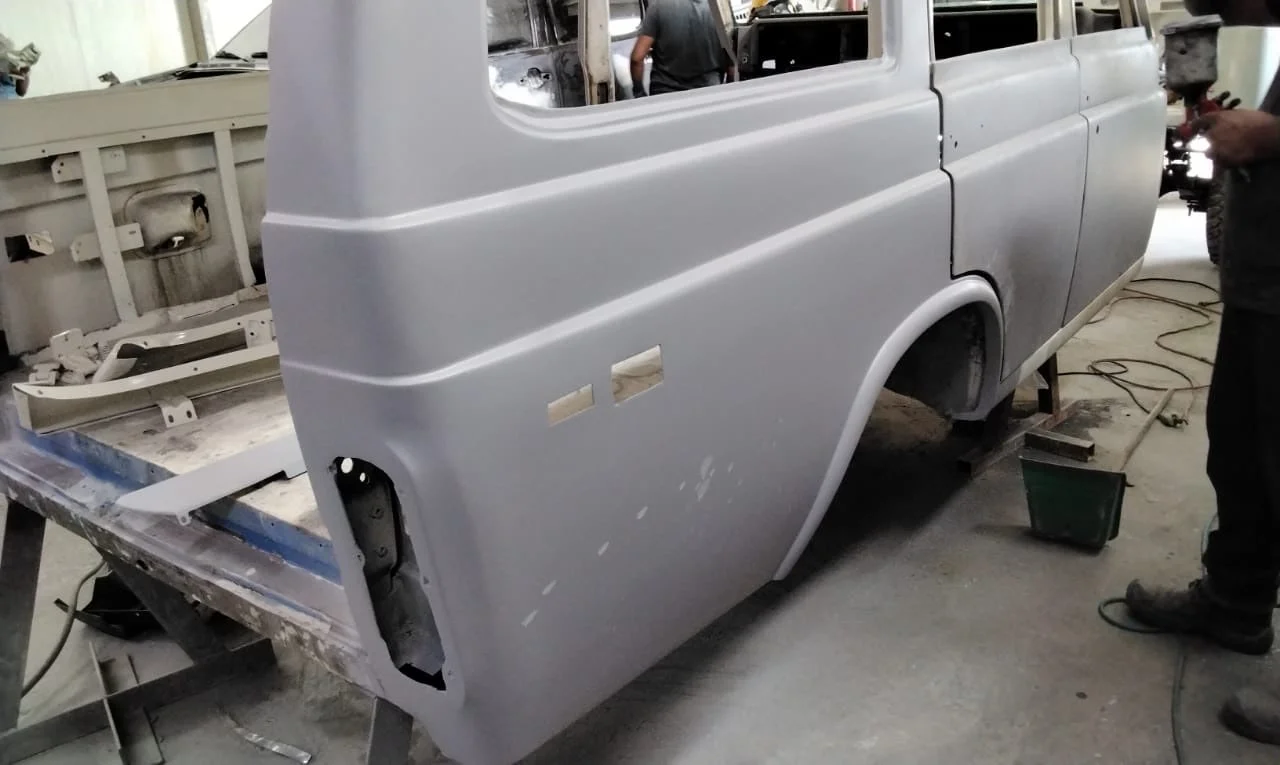

1978 Barn door FJ55 "daily driver"
Base is a Lexus color: Eminent White Pearl, so tri-coat.

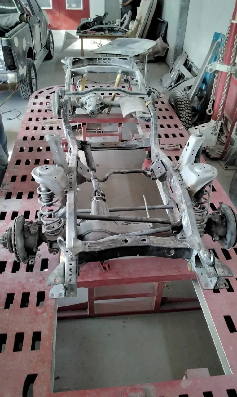

You can think of it as a UZJ100 drivetrain. The engine (a 2006 VVTi with about 36kmi in it, ECU, input shaft and bellhousing from a UZJ100 (sourced in UAE) and a H151 / H2FA behind the bellhousing.
AEM, Haltec, MoTec and Link G4 will all run the VVTi engine, but not an auto trans, but I don’t have an auto in this truck, and I’m focused more on it being a reliable daily driver, so I’m sticking with a factory ECU (unless it doesn’t work.)
The front and rear axles are sourced from a 70 series. The 70-series track is about the same as the 40 and 50 series, so the wheels & tires should tuck nicely.
Coils on front, leafs on back, as y’all can see. “Factory” four wheel discs, LSD in the rear (this truck won’t be wheeled so no lockers required).
