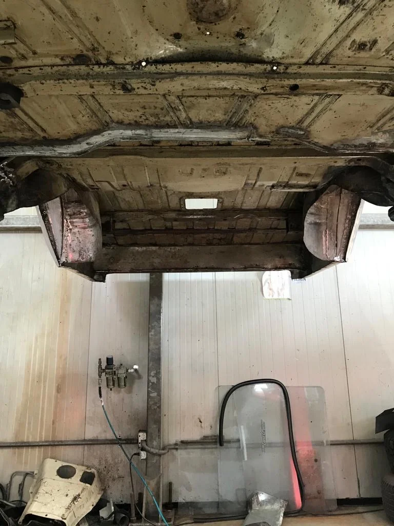

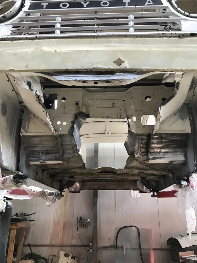

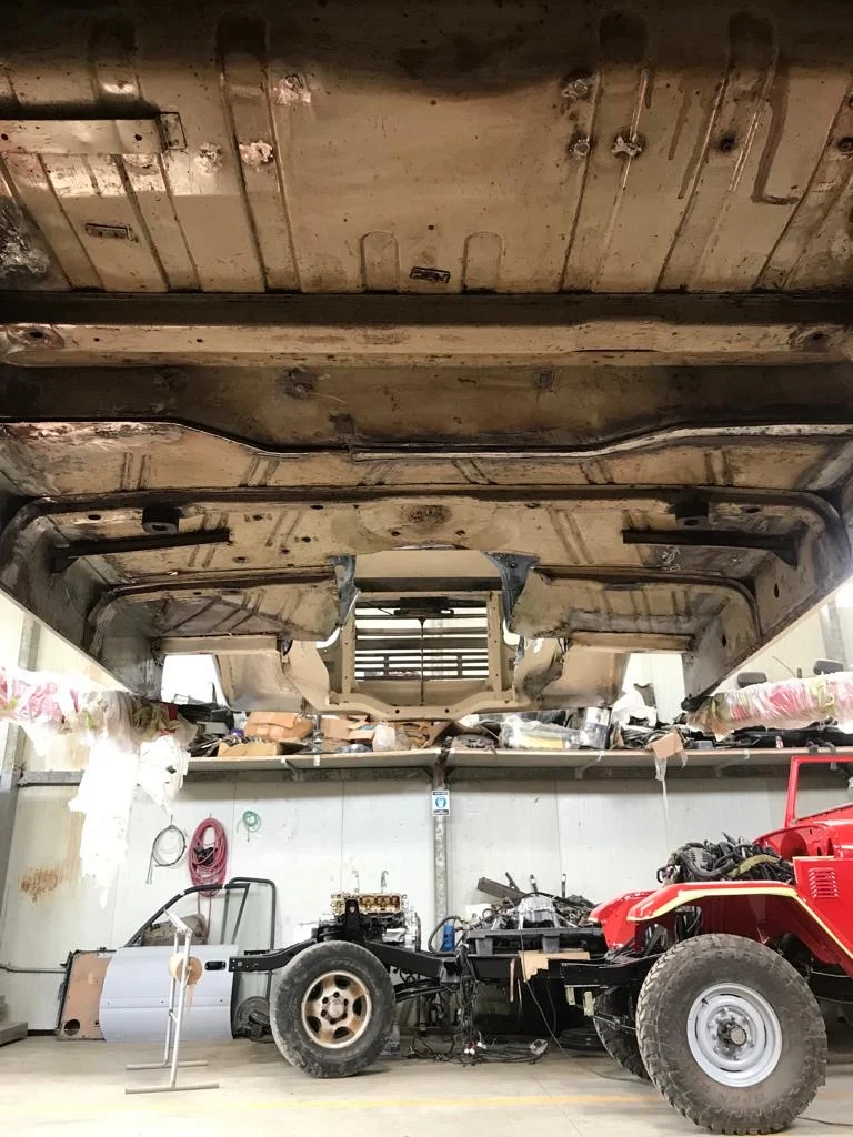

Underbody

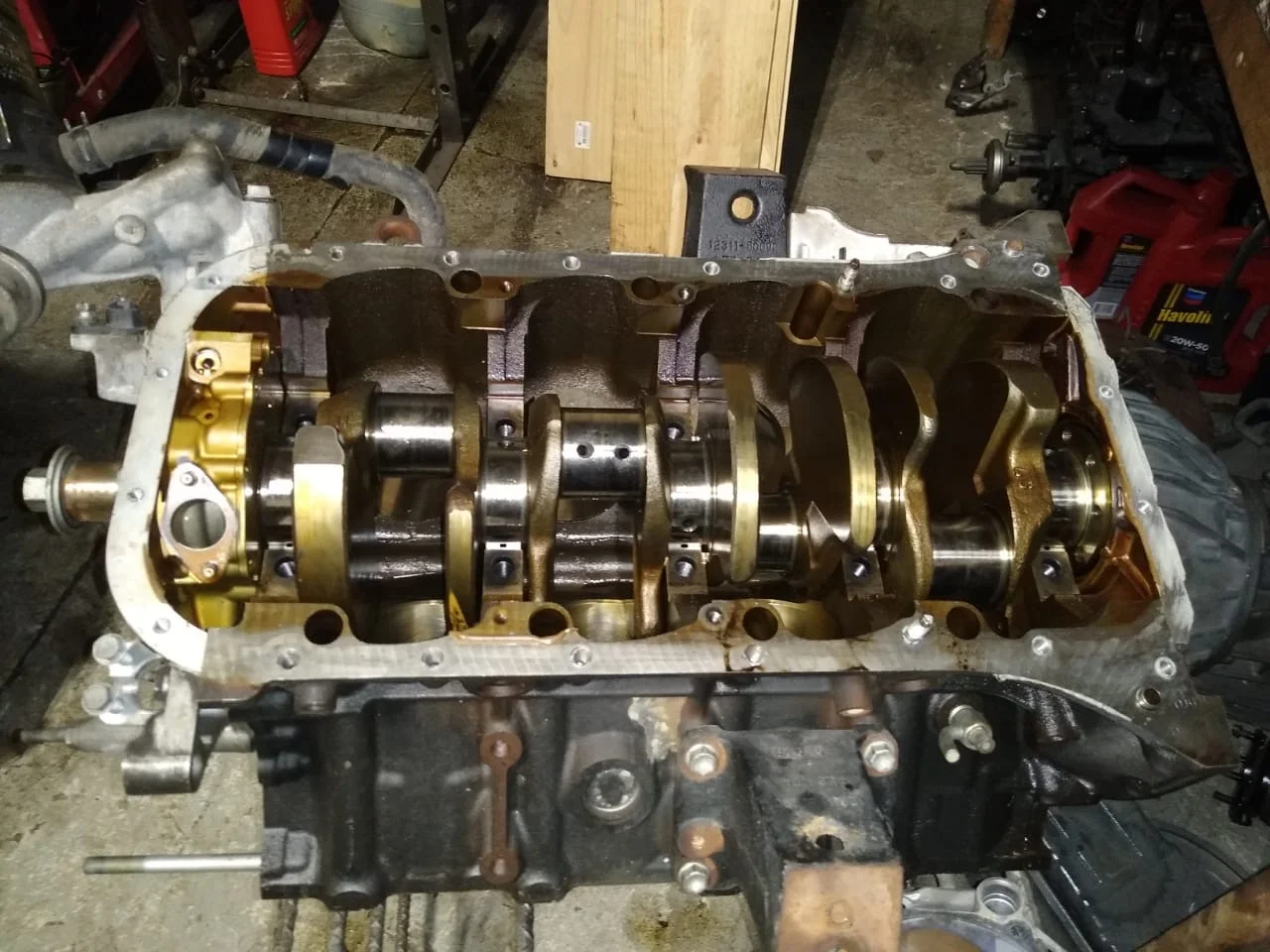

Would not want to do it in the Pig engine bay:

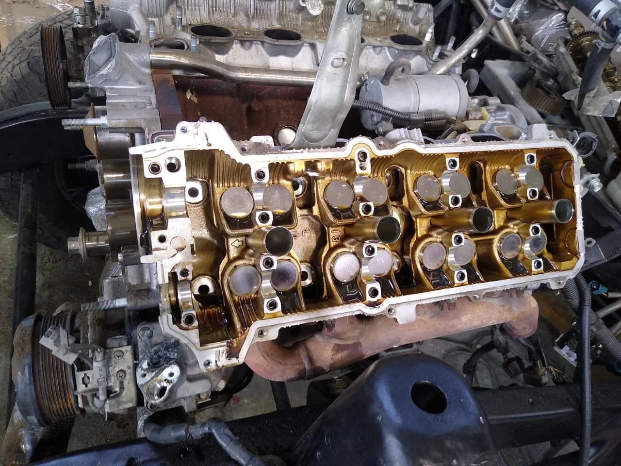

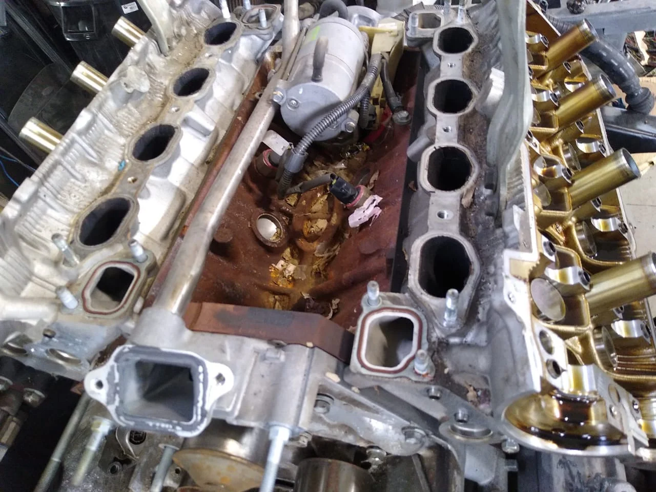

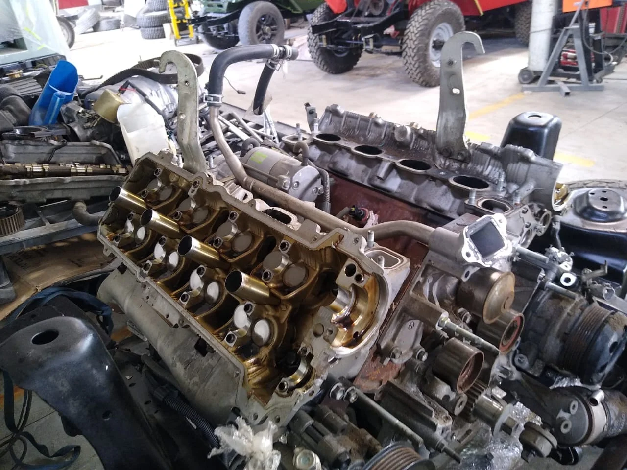

So of course once it runs, a few small leaks are found, and that just won’t do.

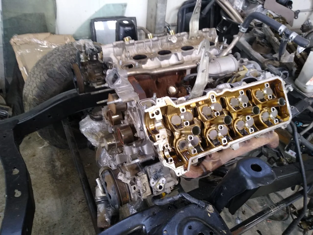

Tear the manifolds and valve covers off!
Looks like you are on track to replace the gaskets on the coolant bypass pipes. Good practice if you are chasing leaks. I did the rear when I replaced the starter a few weeks ago. Will do the front when I do the timing belt soon:

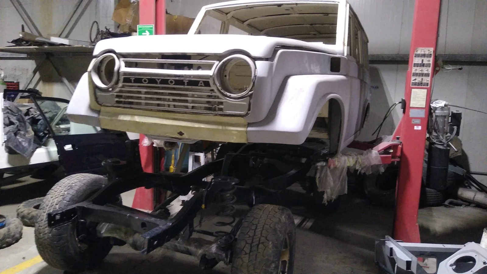

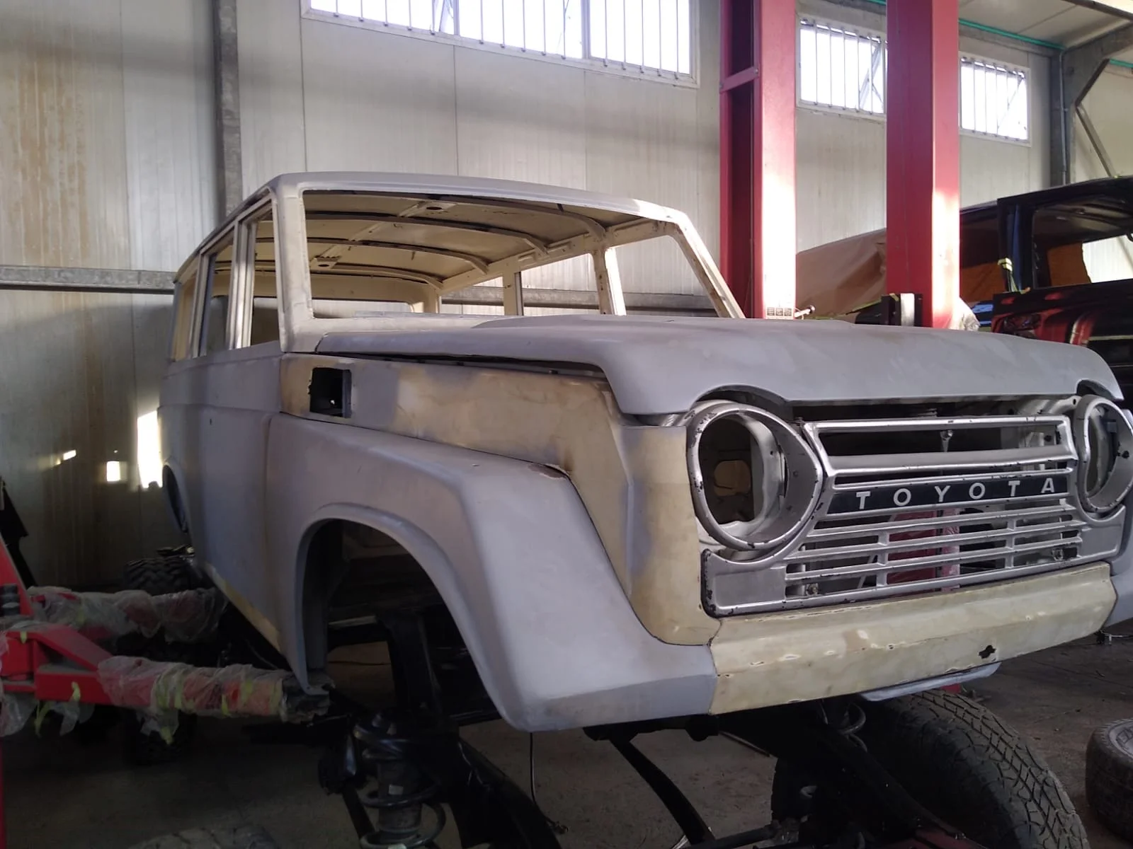

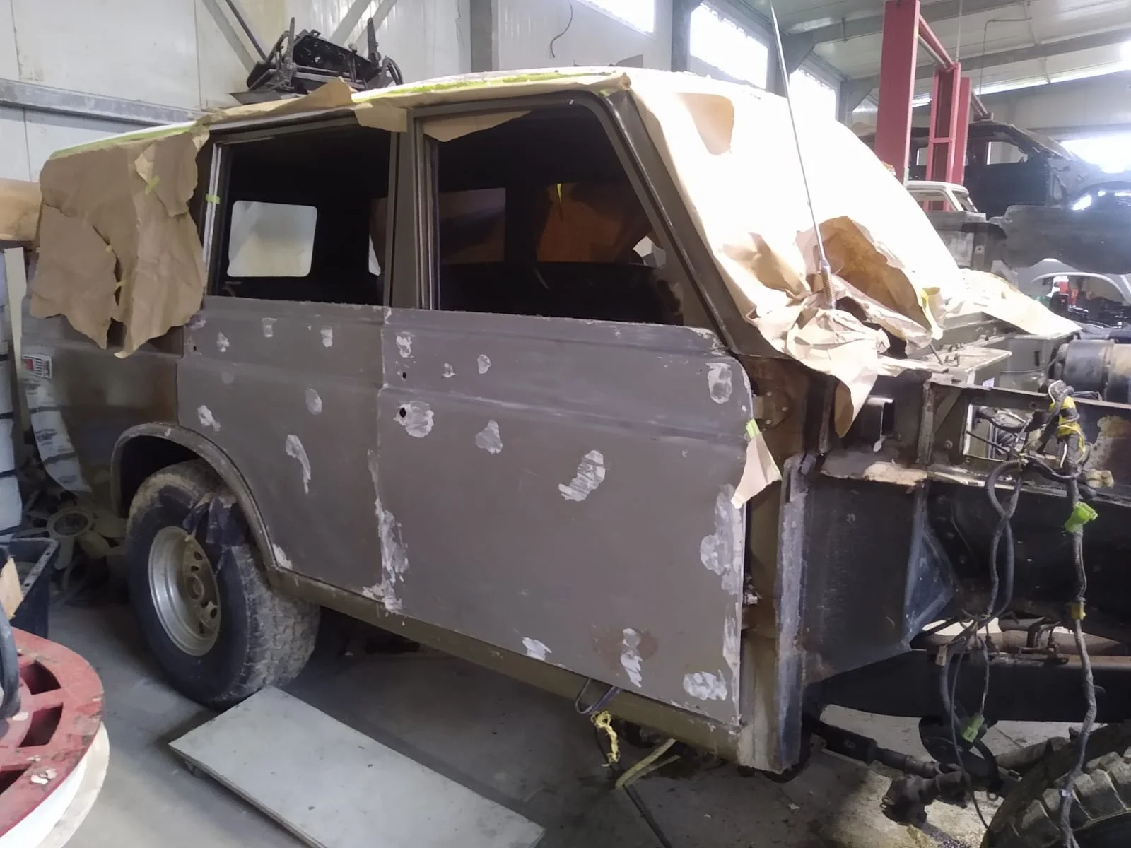

Base is a Lexus color: Eminent White Pearl, so tri-coat.
I’m trying to pick a blue. Considering VooDoo but will consider what the sty thinks.
Voodoo is a good choice. Two tone or not? Really cool project, looking forward to more photos.
