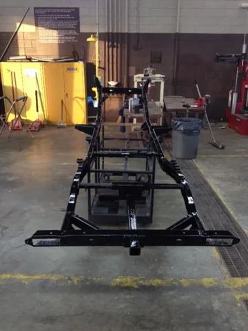

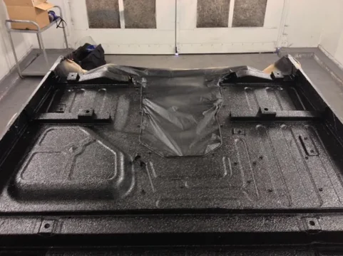

Undercarriage is finally done. Coated it spraying Gator Guard II.

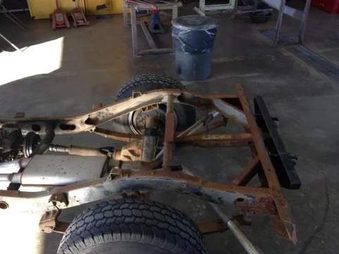

Finally working on the frame.

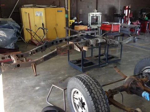

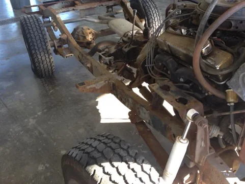

It's almost been two months since I worked on the FJ40, I've been traveling a bit. Was just in Cordova for one week for work. I've started wire wheeling the frame and stripping it down. I've been contemplating taking it all the way down to the frame and getting it Sand blasted. I've gone through two stripping discs and it's been difficult to get in most of the areas of the frame. I'm going to make some calls tomorrow for quotes to sandblast the whole frame.
It took me two and half hours to get the monster number off. PO welded in all sorts of places. The rivets were a pain to get off even after grinding them down. Need a BFH for sure!

Slow progress. I didn't realize how time consuming it would be to remove the undercoat. It took me five days. Maybe a total of 40 hours. I first started wire wheeling, then tried heating and scraping and then using a paint thinner to remove undercoat in hard to reach areas. Now I'm back to wire wheeling. I think I should have just stuck to getting a good quality wire wheel and wire wheeled the whole thing. Or I should have just paid the Honolulu price of $600.00 to have it sand blasted. Lesson ex learned for sure.
I went through the same thing as you, but with exterior as well. I could never get it how I wanted it, and it was hard to wire wheel all the cracks and crevices, so after many hours of labor, and many dollars in wheels and bits, I ended up having it blasted. I was so glad I did, but I was mad at myself for not doing it sooner. I think it's well worth the money, and your time can be used for something much more productive.

JetRanger - thanks for the advice. I'm still debating if I should sand blast the frame, but I'm probably going to keep working on the frame since I'm paying for storage and bay usage at the Auto Hobby shop on the Air Force base.

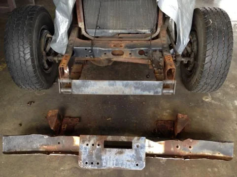

I have a question, On post # 6 it looks like the rear fenders have been cut. Mine has been cut too and that has discouraged me alot. Is this a big problem or do they make something to fix this problem? I am having problems trying to decide which way to go. Mine in a 72 model.

The rear fenders were cut out. I think when Previous Owners put the bushwacker fender flares it tells them to cut it down. I plan on putting new fender flares to cover the aweful cut the PO made. May be down the road I will replace the rear fender panels.

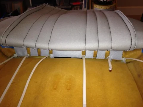

Bought new upholstery from Cruiser Corps on Cyber Monday and got free shipping. Finally completed reupholstering my seats. Took me about 8 hours total. Hardest part was putting hog rings in the inside slits that keep the seats recessed. I ended up using wire ties because it was easier.

I was hesitant to take it all the way down to the frame for a while, but then today I just thought what the heck, so I did it. It is so much easier to get to everything on the frame. I was surprised the leaf spring nuts came off so easy with an impact wrench.
I flipped the frame upside down so I could get to the underside easily. Well worth the time to take it down to the frame.

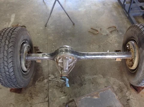

Are these shackles worth keeping?

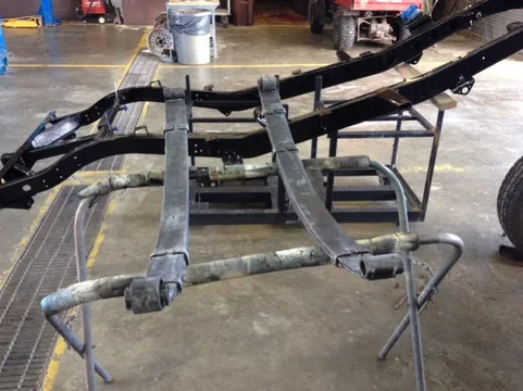

Painted the frame with KBS Coatings Rust Seal. Came out good, used a syphon spray gun for most of it and brushed on in hard to reach areas. Was a three step process. Now moving onto the axles and leaf springs.

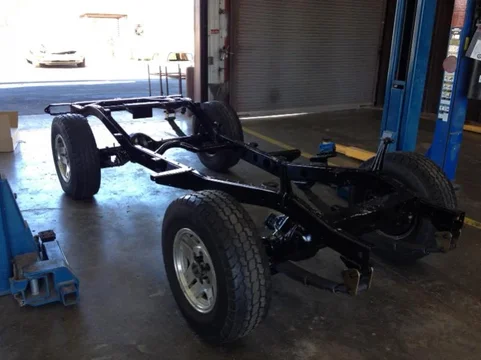

Have a rolling Chasis now. Also added new iron man shackles and bushings. Painted axles with Rustoleum and leaf springs with slip plate. Onto the next step, the engine and tranny reassemble.
