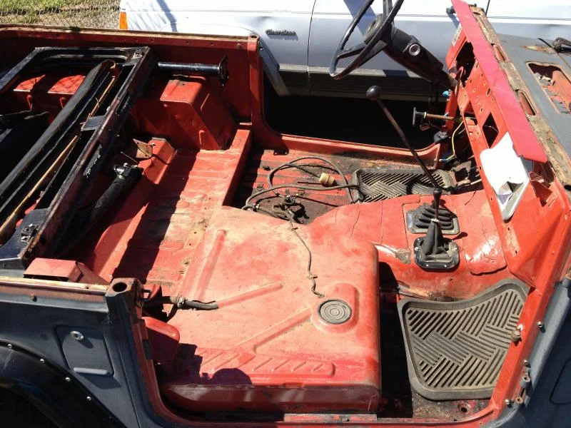

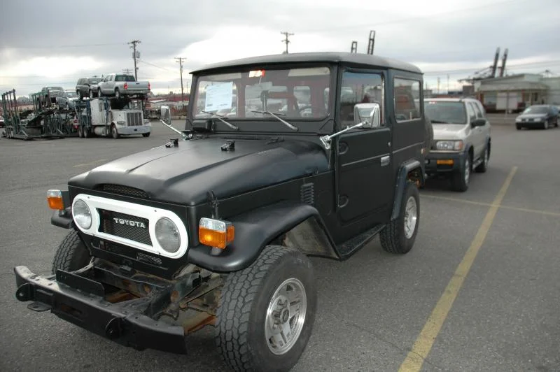

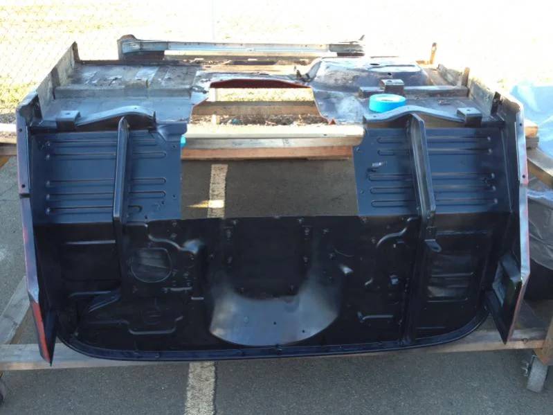

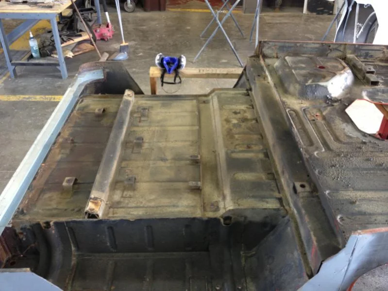

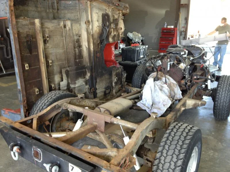

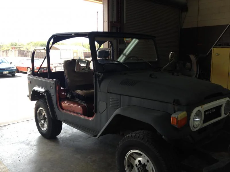

First Pic is when I first got the FJ40 and took it somewhere in the mountains of Washington State. Second Pic is before I shipped it to Honolulu. Third is right before I started taking it apart.

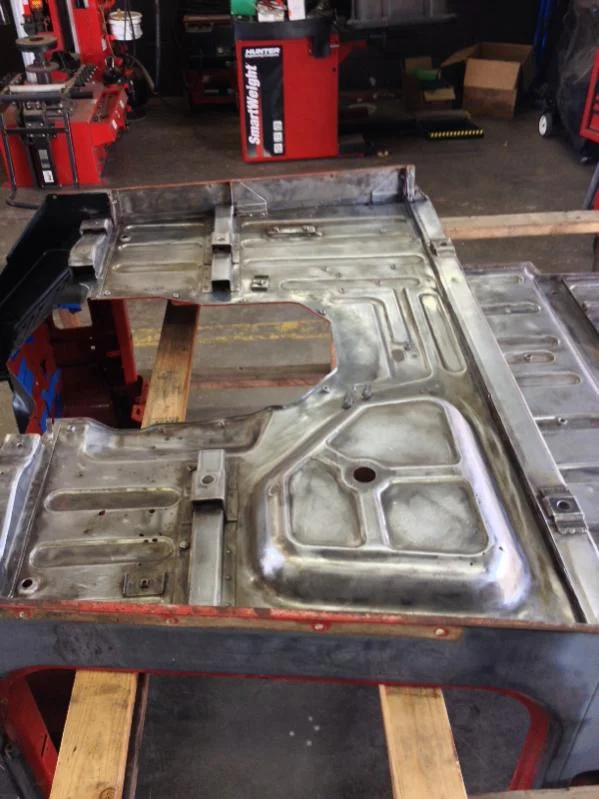

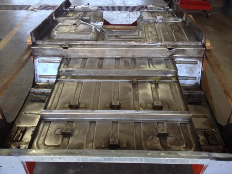

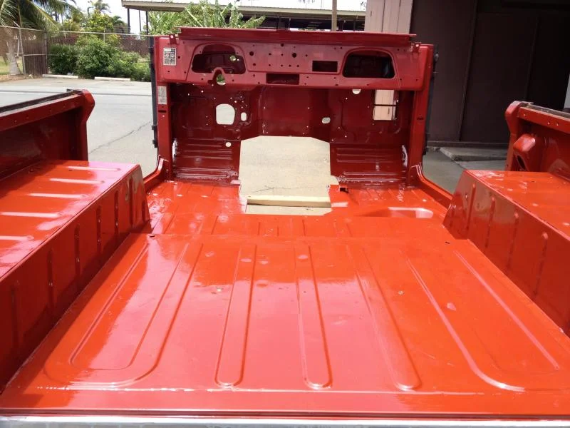

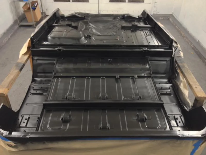

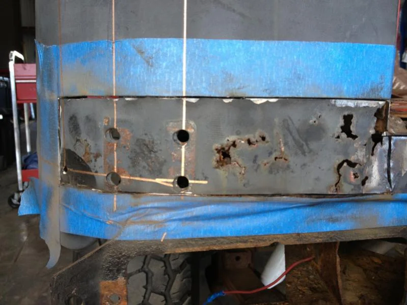

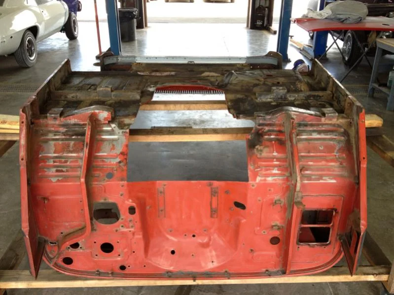

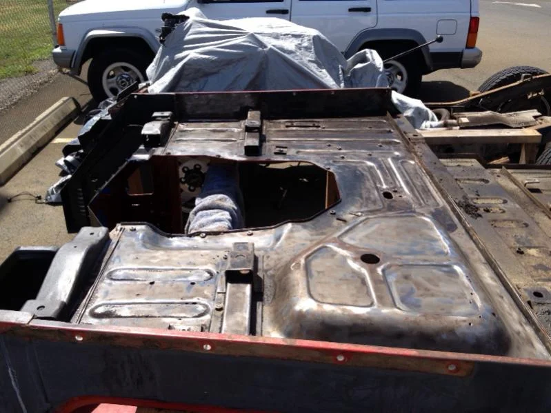

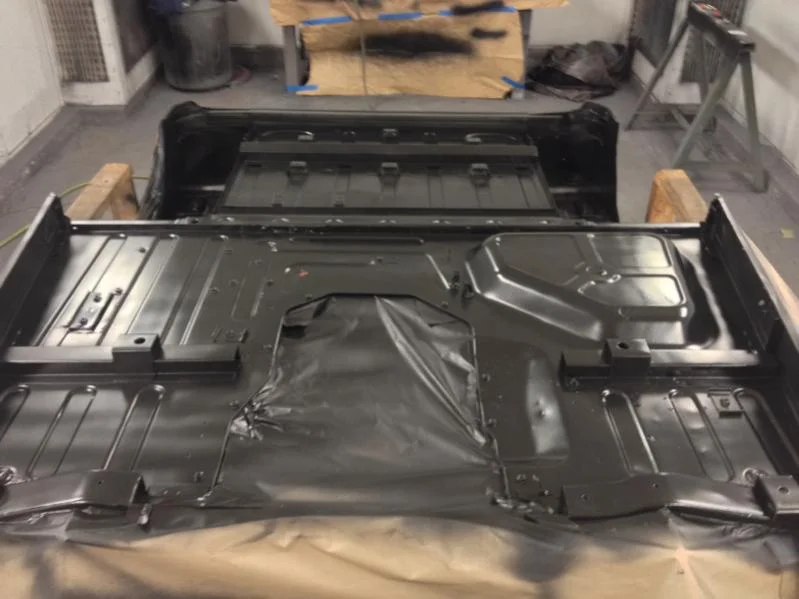

So far I removed all the rust and replaced the rear sill. I also sanded down the tub and painted it with Rust Seal.
By the way, "land billet" is being stationed on land. I still work on the cutters, but I don't have to go out that much any more until I transfer again.
This was where I was at with the tub about a month ago.

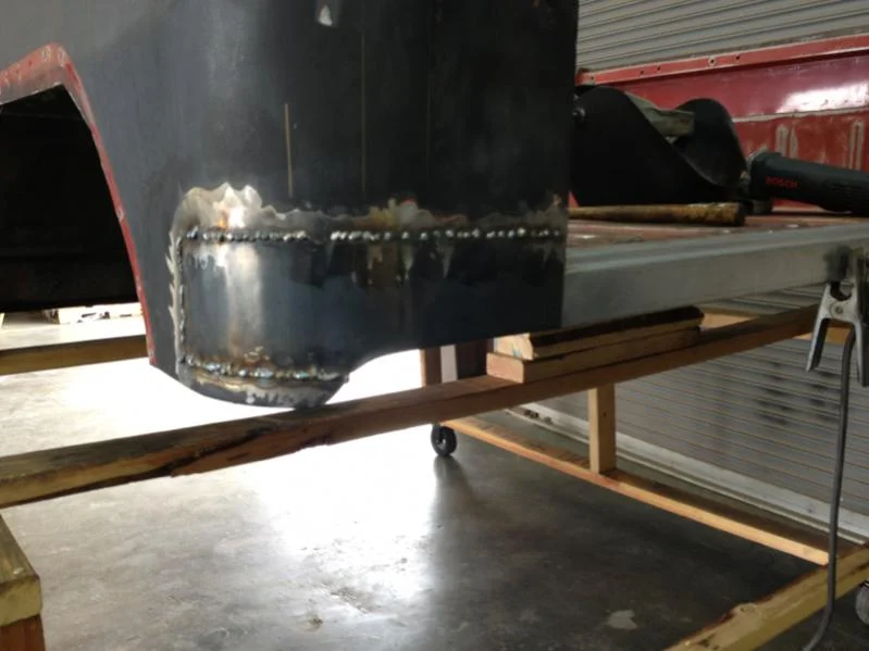

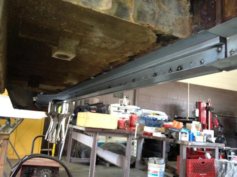

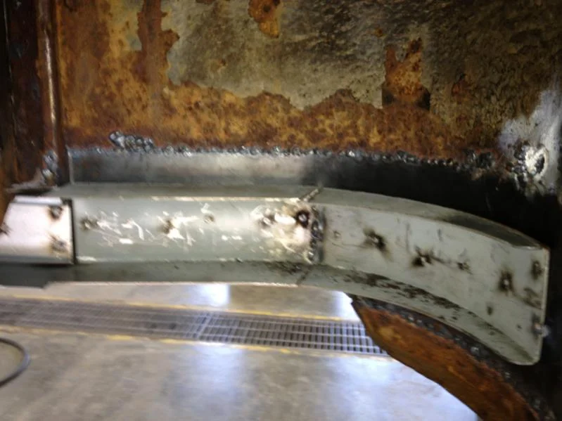

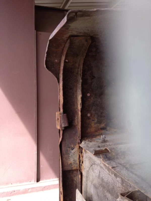

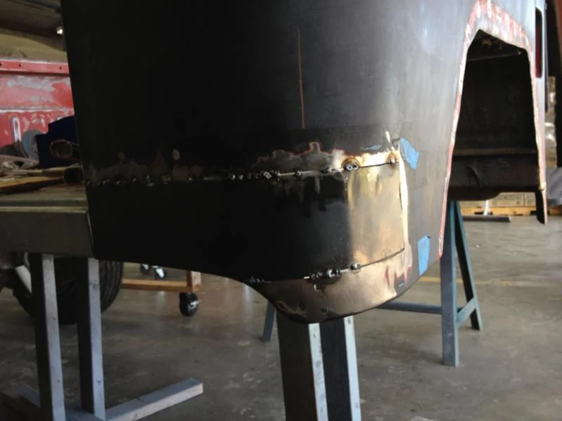

Here are some pics of the rear sill and the replacement.
This was my first time welding and I learned a lot, I used a friend's mig welder. He showed me once and then I just figured it out from there.
I brought the cut out pieces to a metal shop here in honolulu and they made me what I needed for $250.00. I have to mention this was my first build besides doing some body work and paint over twenty years ago, and I probably would have done it differently.

FJ40RobQ, nice job on the body tub! :beer:
Be sure to paint the tub well, salt air is rough on auto sheet metal! :mad:
The Eastwood Company sells many fine automotive paint products. They have anti rust coatings, etc.

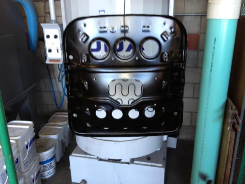

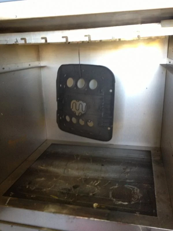

So I started powder coating for the first time because it was easy to order and cheap.
Here are some pics of my seat frames. I wanted to practice and try it on something that wouldn't be seen if I messed it up.

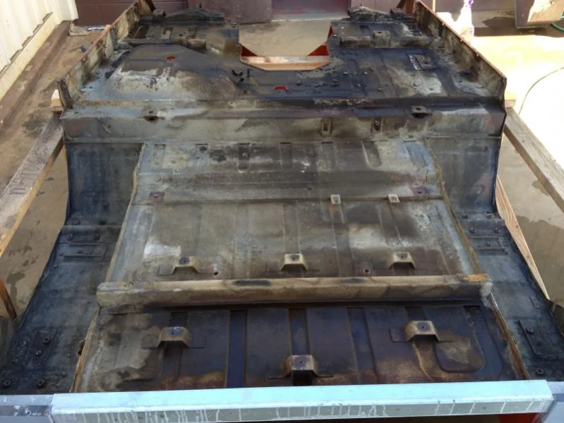

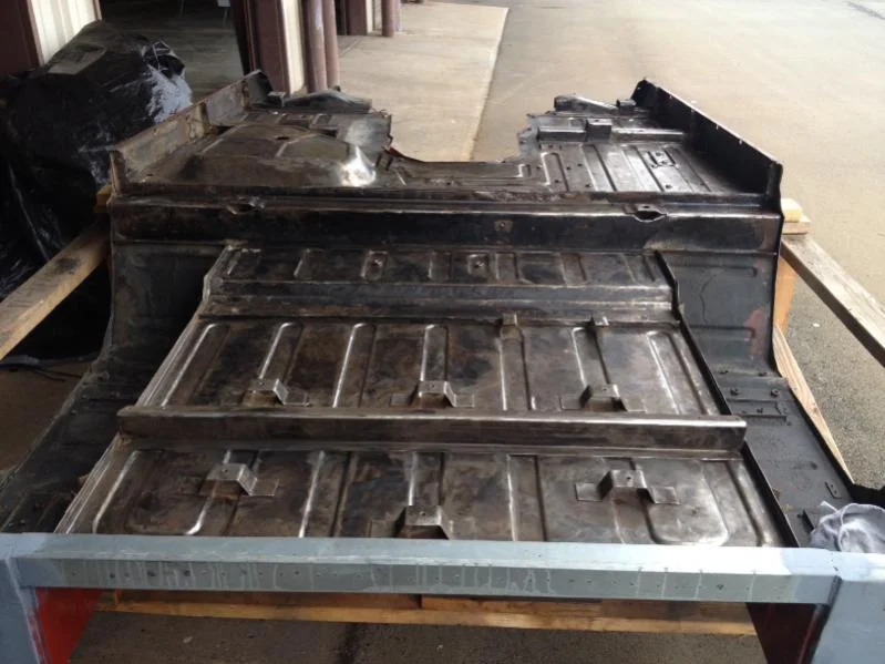

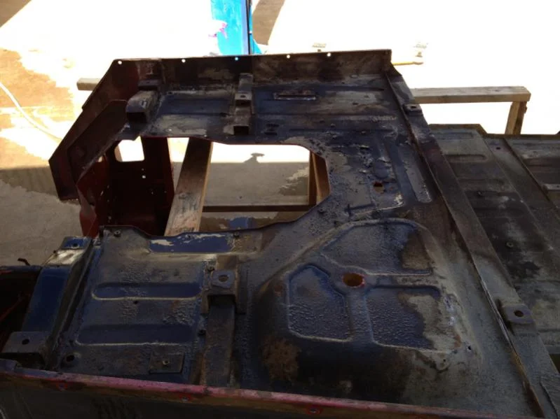

After cleaning it with a degreaser and wire brushing it, it still looked dirty. The rubber undercoating was loose so it was easy to remove but the rest is still a work in progress with a wire wheel cup attached to a grinder.
Does anyone have any suggestions on how to remove the rubber undercoating an easier way?
Slow progress. I didn't realize how time consuming it would be to remove the undercoat. It took me five days. Maybe a total of 40 hours. I first started wire wheeling, then tried heating and scraping and then using a paint thinner to remove undercoat in hard to reach areas. Now I'm back to wire wheeling. I think I should have just stuck to getting a good quality wire wheel and wire wheeled the whole thing. Or I should have just paid the Honolulu price of $600.00 to have it sand blasted. Lesson ex learned for sure.
Probably should have clarified that I wasn't done with the undercarriage. Since I've come this far, I still have to wire wheel some more to complete. Then I plan to Spray epoxy primer and then spray Gator Guard II.
