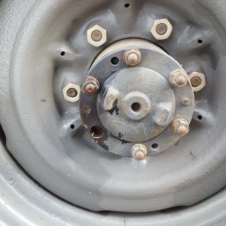

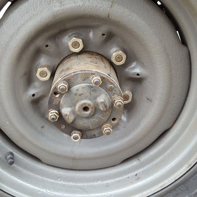

going to be looking into 10mm studs.

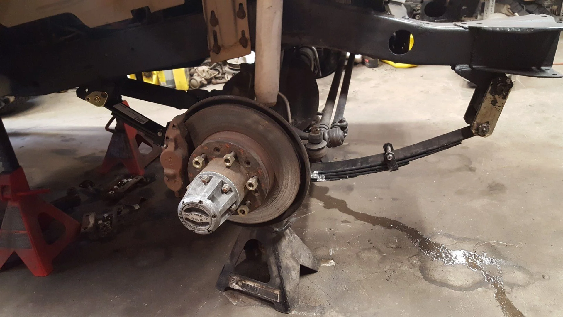

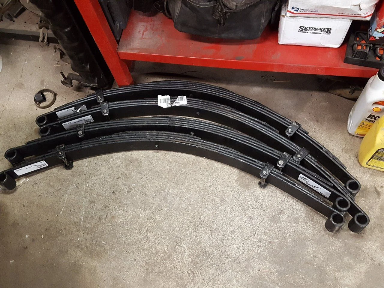

Also gathered up some fresh springs, went with 4 inch skyjackers...going to remove the shackle reversal and return to the oem front setup.

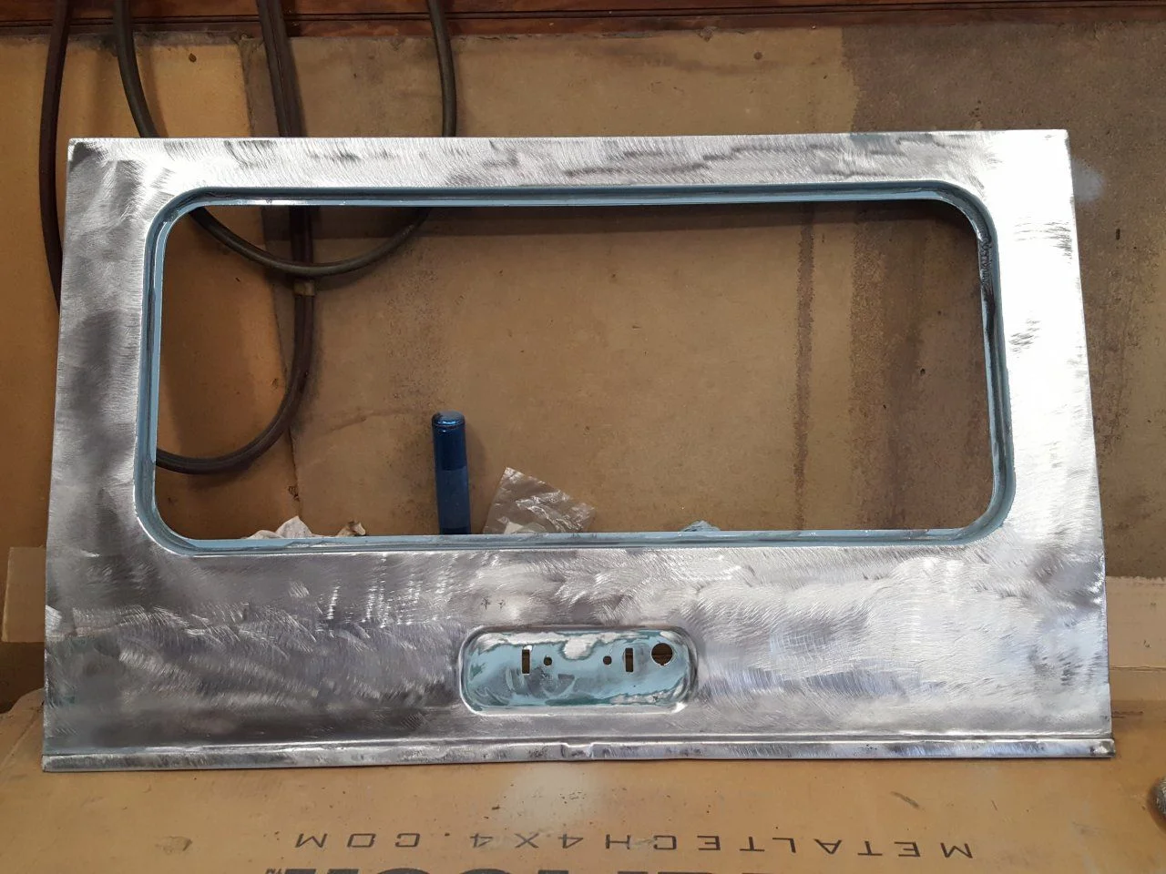

Rounding up parts from btb to turn the tailgate panel into a functional tailgate.

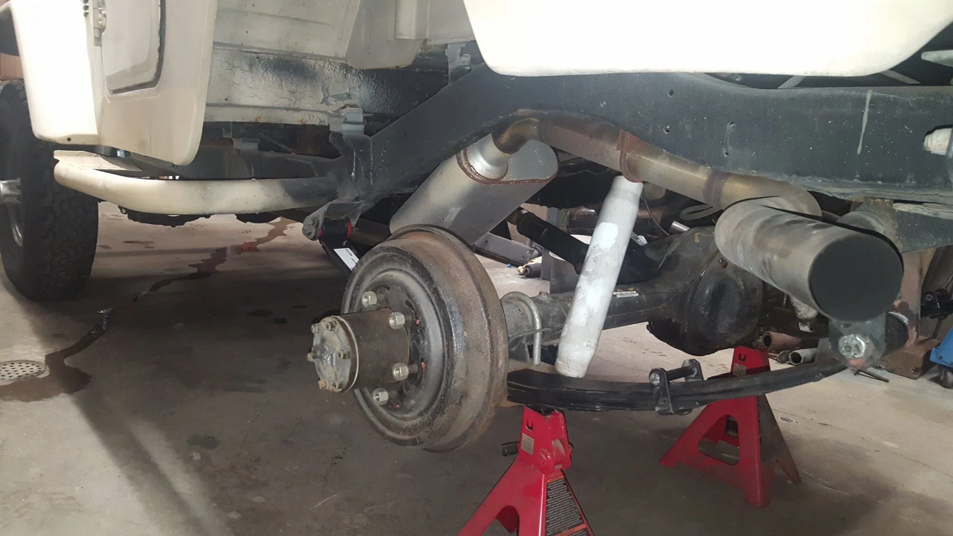

new rear springs on.

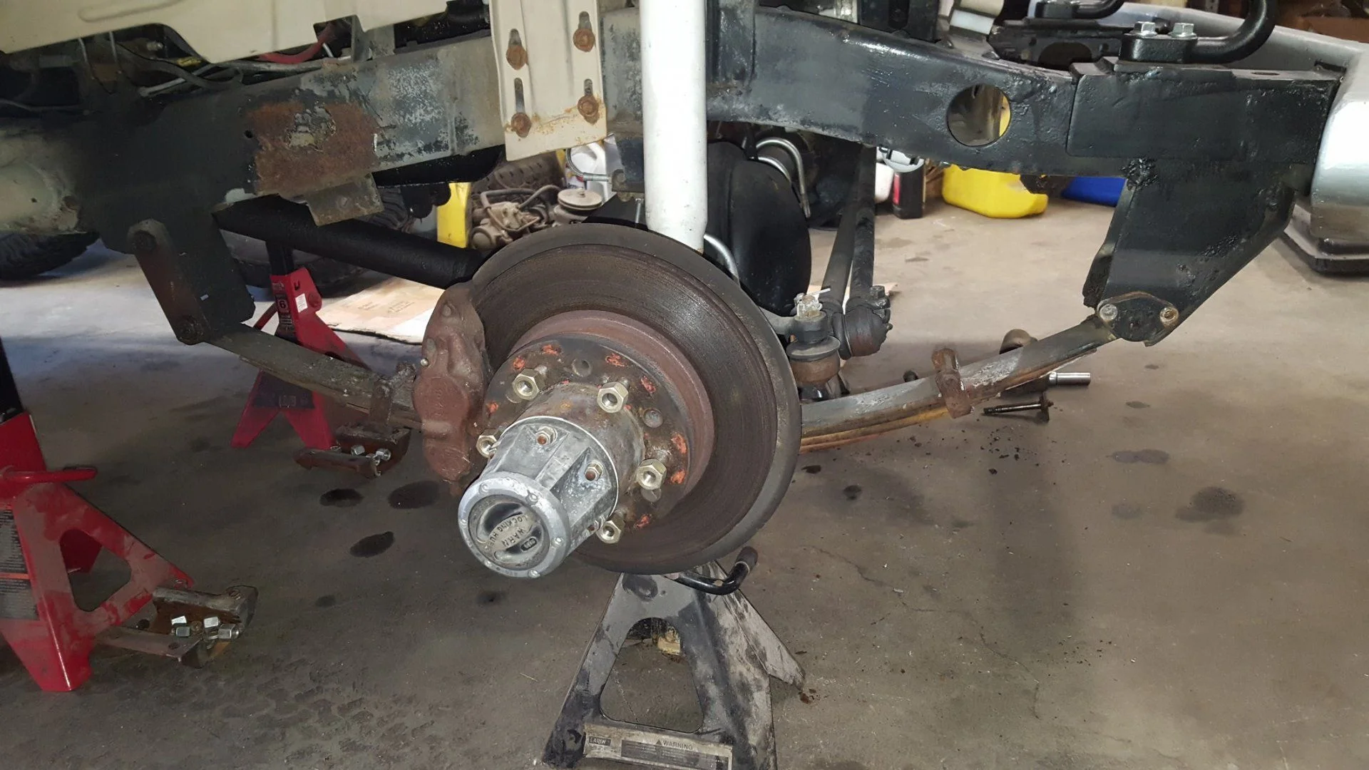

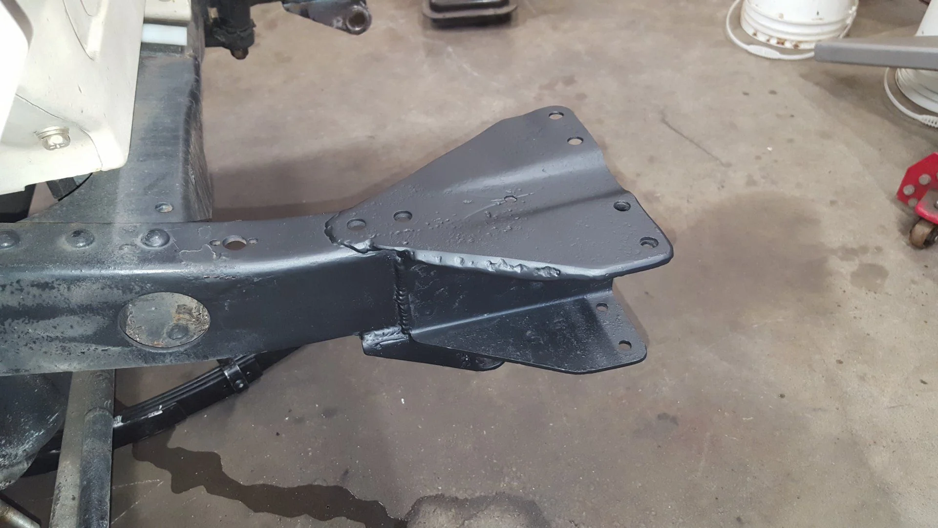

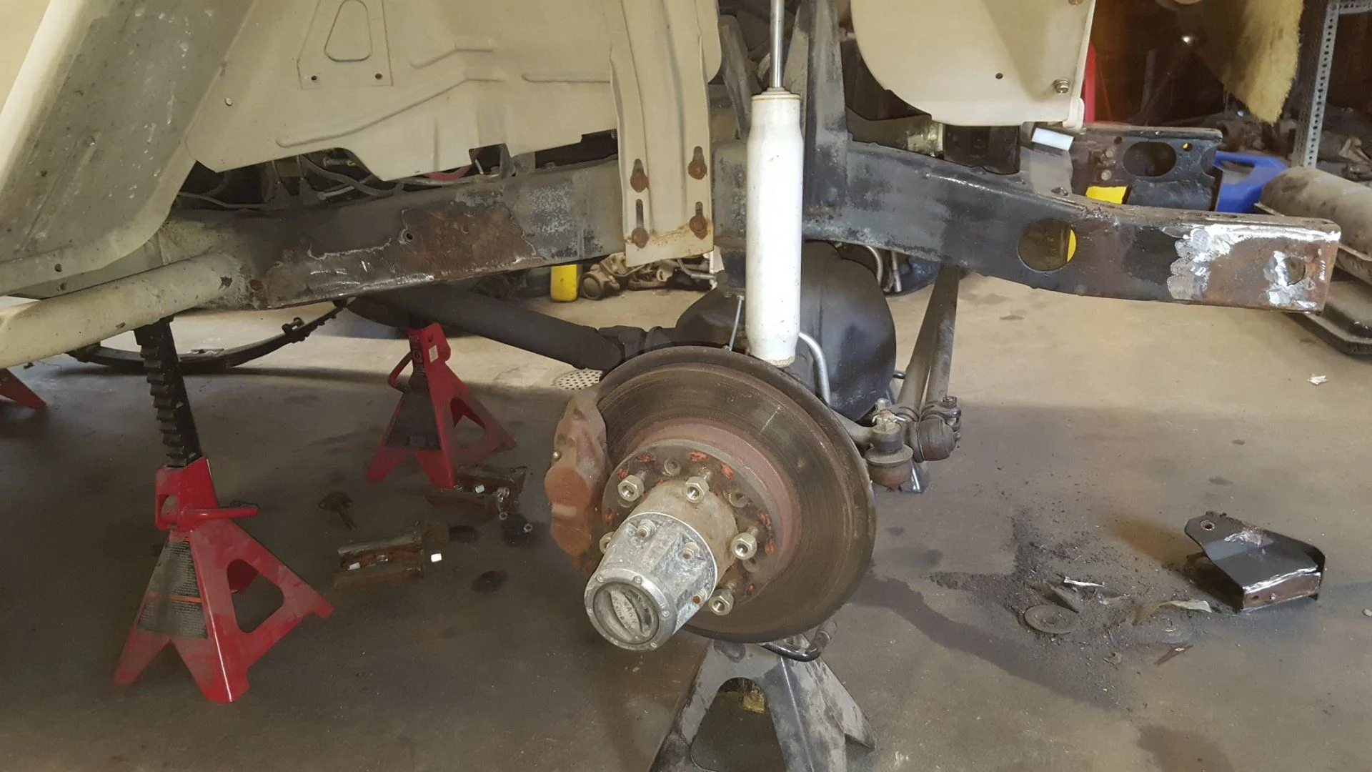

started hacking the shackle reversal off it.

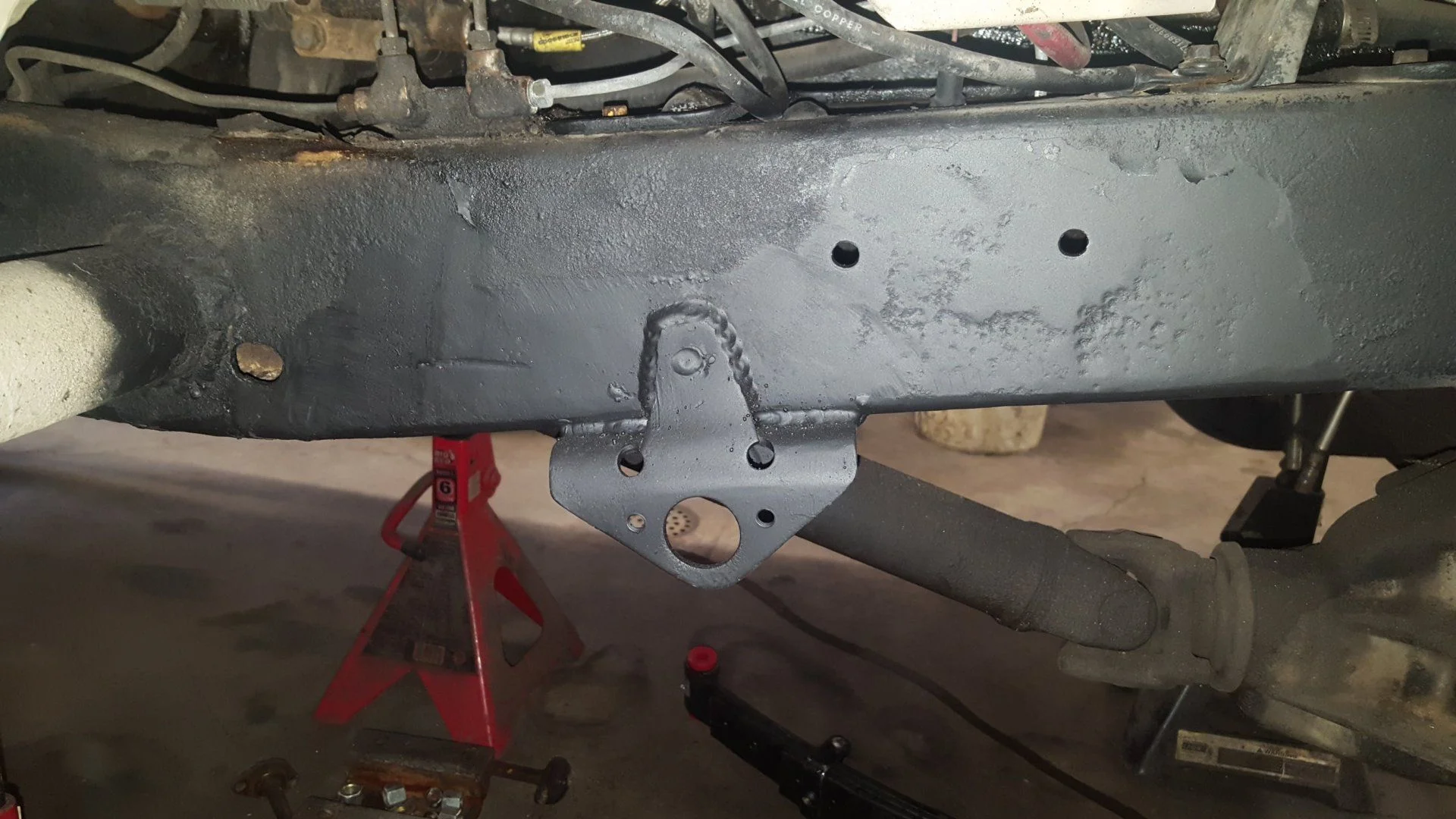

Passengers side ready for the spring.

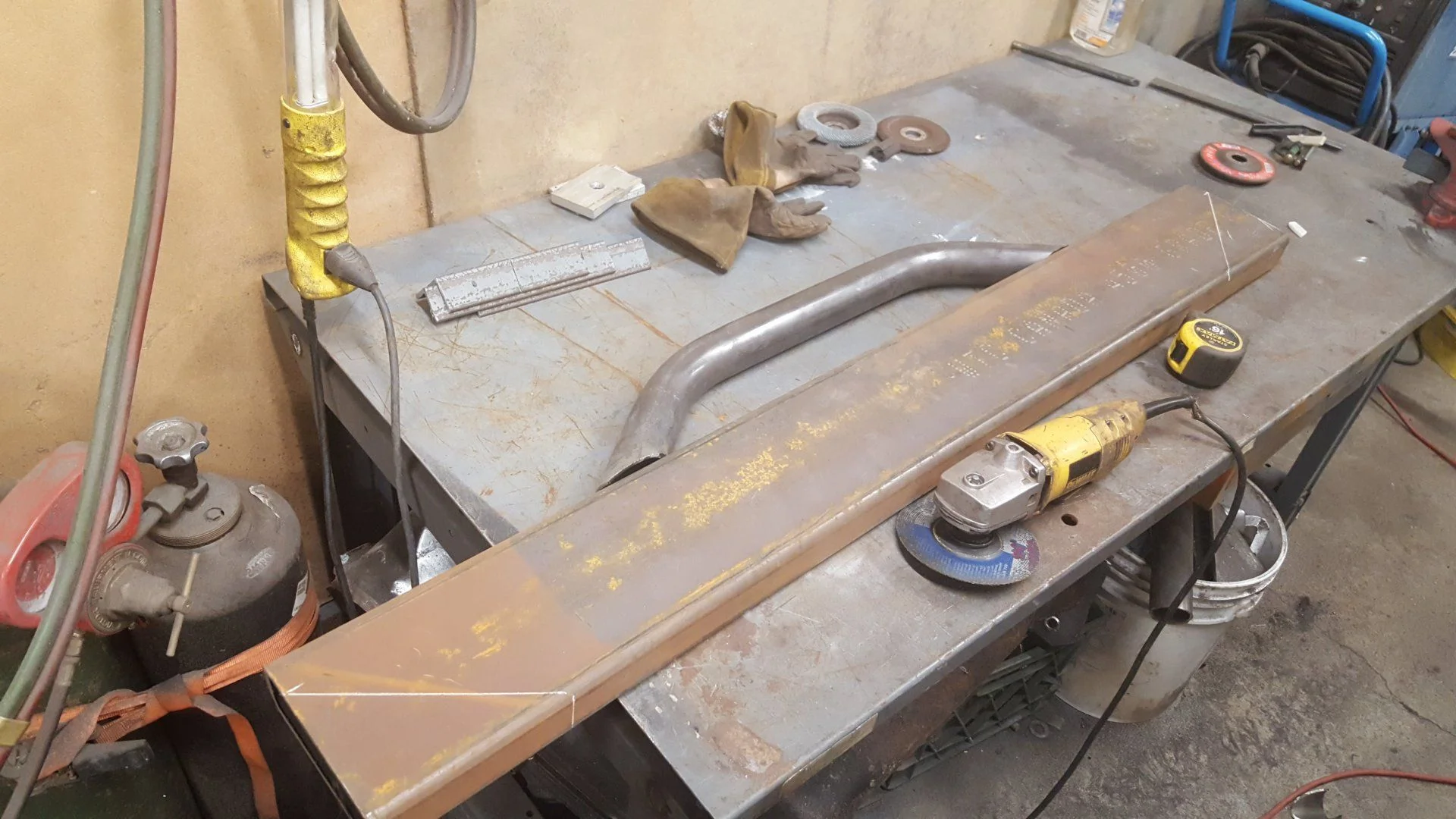

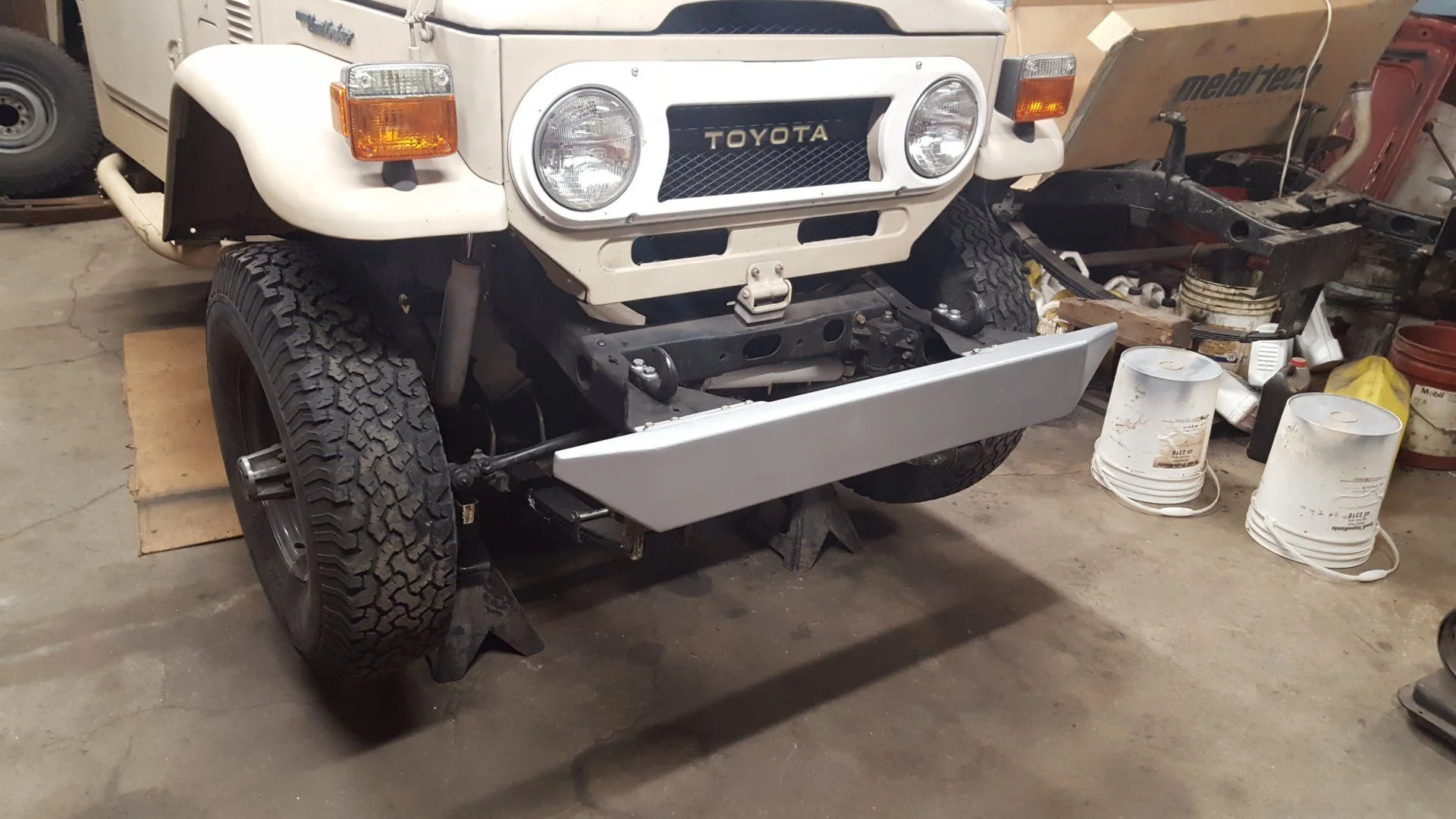

Decided that it's getting a new front bumper as well.

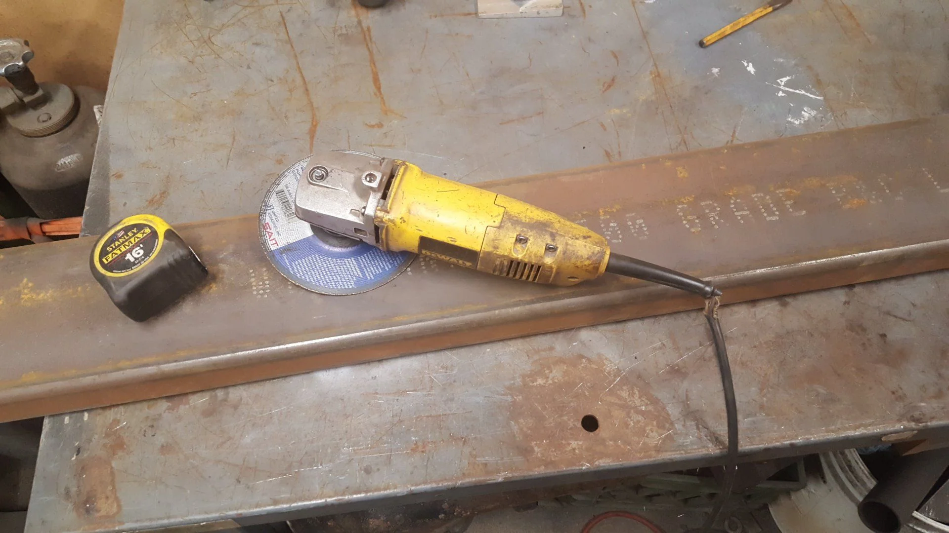

I know this is a g rated forum.
But it's time to talk about the birds and the bees and where bumpers come from.
When a grinder with a cutoff wheel falls in love with a piece of box tube....
Sometimes you just have to stand back and let nature take it's course..

I went through your entire thread. Great in-depth work! Just curious- was the tailgate created by you welding two barn doors? That's what I thought I saw, now at thread's end. Also, was BTB reasonable for all those pieces? I have found them to be $$$ for parts in the past. Even back as far as 1995-96.

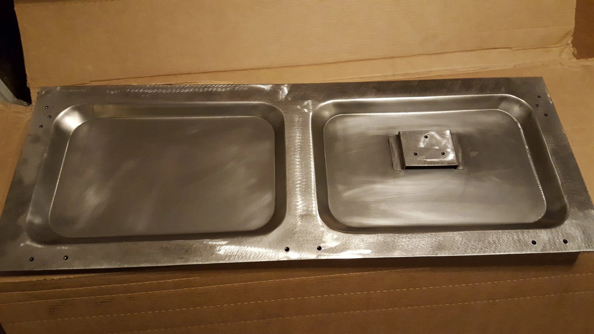

There are companies who make actual tailgates or just the block off panel as seen here.
This is an ever evolving project, as funds show up and I find better condition parts things get swapped around....but at this point there isn't much left that needs replaced.
The btb parts are a joke for the price.
The current tailgate fill in panel and the replacement drop down tailgate, both real steel cruiser parts stuff....they are worth the money.

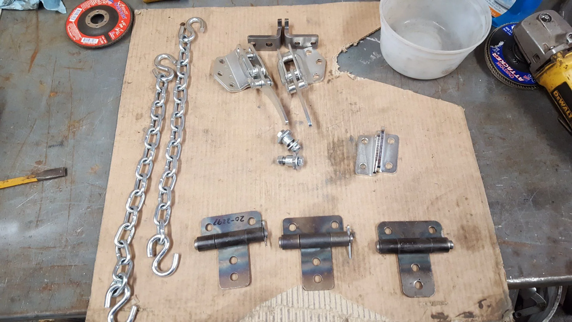

can't believe i waited so long for this...drop tailgate awesomeness.
still have to rub some love on the latch catches yet.
