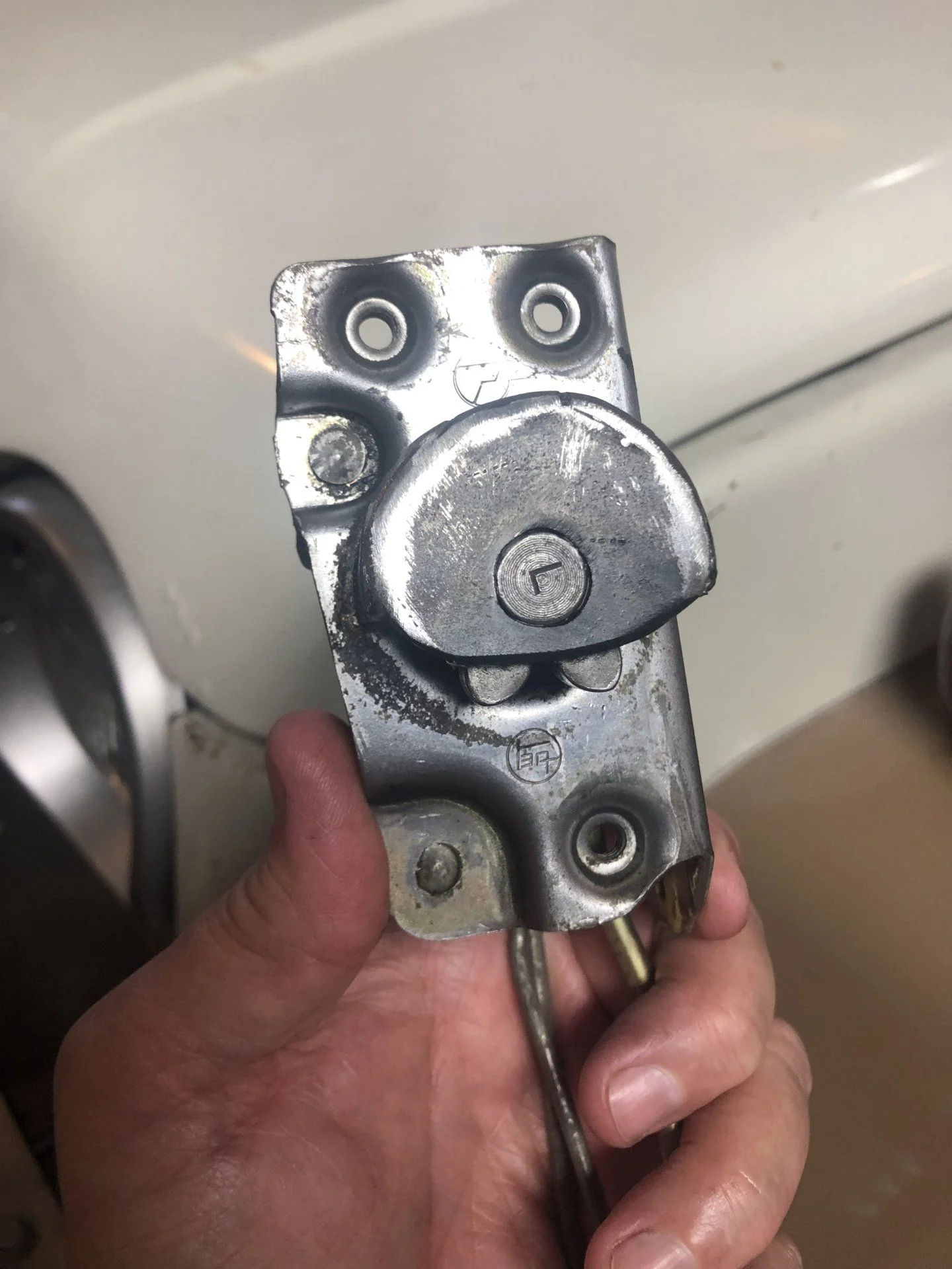

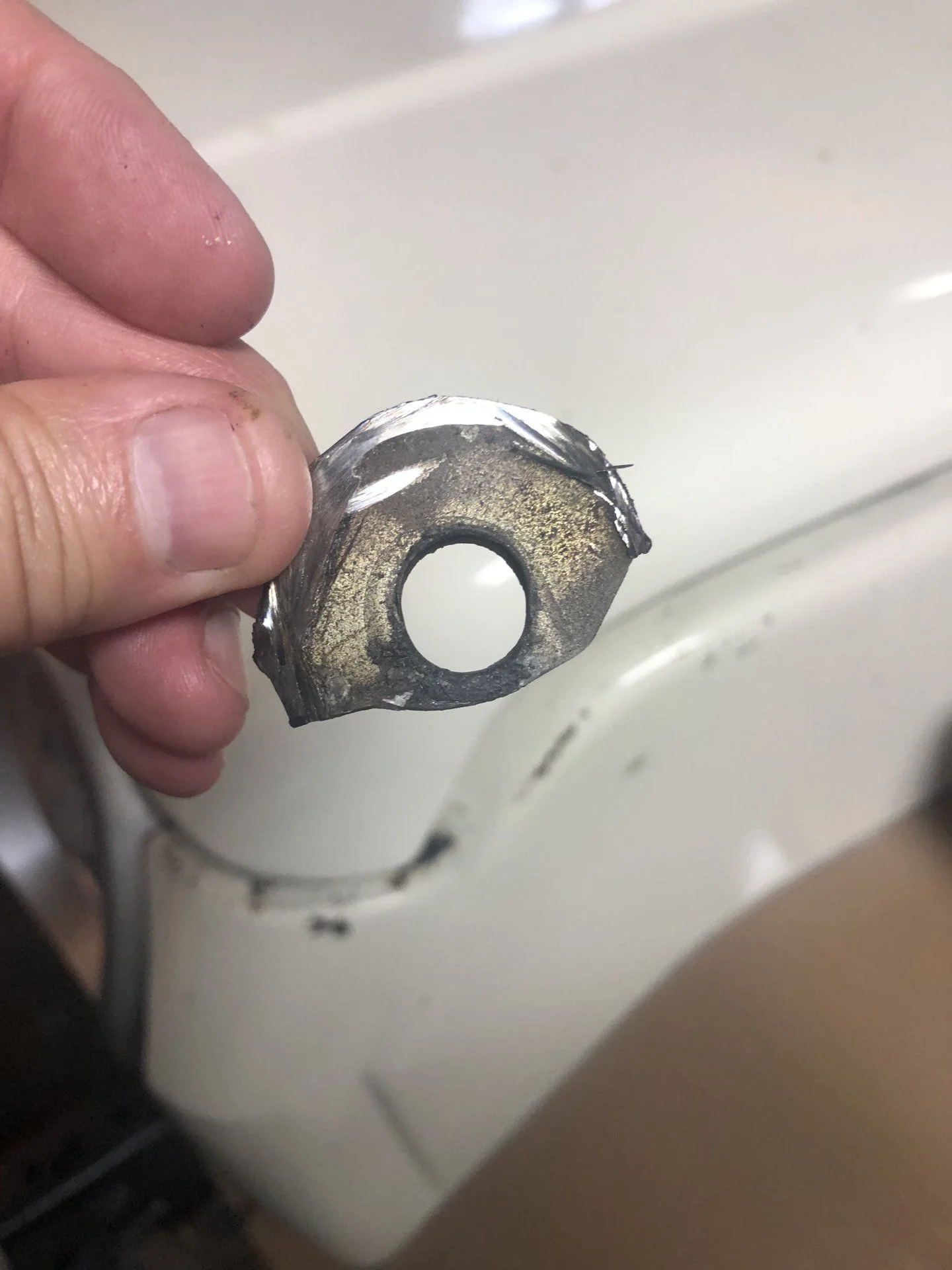

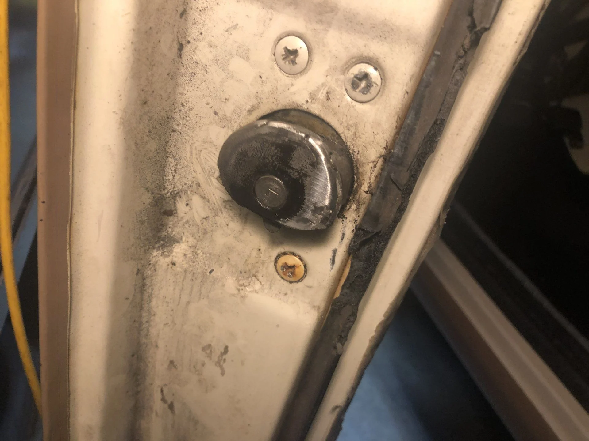

You'll play hell finding one that isn't already worn out. The driver door is worn out on all these trucks. I tried to find one and gave up. I decided to repair mine. Cut off end. Trace outline on flat stock. Drill hole for tight fit. Weld on new piece.

SirBarton,
Is that the problem with your striker? I'm guessing it is and this fix is really easy to do if you have a welder, etc. It's one of those Winter jobs with the door torn apart for a while.
Yeah - that's the problem with it. I don't have a welder, but I'm sure I can get someone to fix it.
If you come up empty for help, send it to me and I'll fix it for you. it will be bare metal and need to be painted. It's a one hour job, so no big deal.

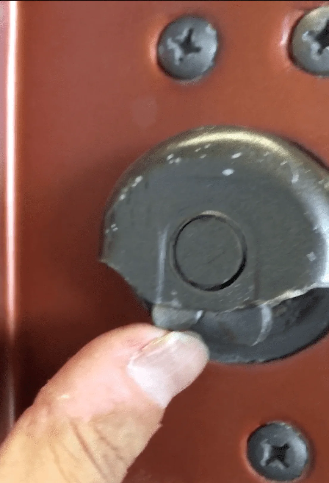

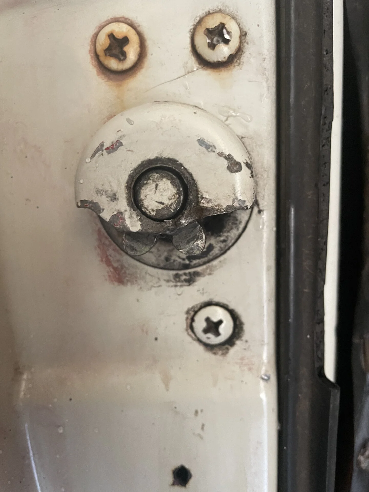

Hey @scrapdaddy , I'm having the same issue with my driver latch. The wheel inside has a fair bit of play in it so once it makes contact, it's pushed to the side therein making it difficult for the wheel to turn. Think I can send it to you? I don't know of anyone here in PHX that knows about these things.
Will do. Probably this afternoon.
Front driver and passenger. The rears are nice and tight.
A slight bit of play in the hinges, but no cracks in the mounting plates where the hinges attach to the body. From reading it looks like this is the place to start with doors that don’t close properly… but I am completely open to other suggestions. Thanks
