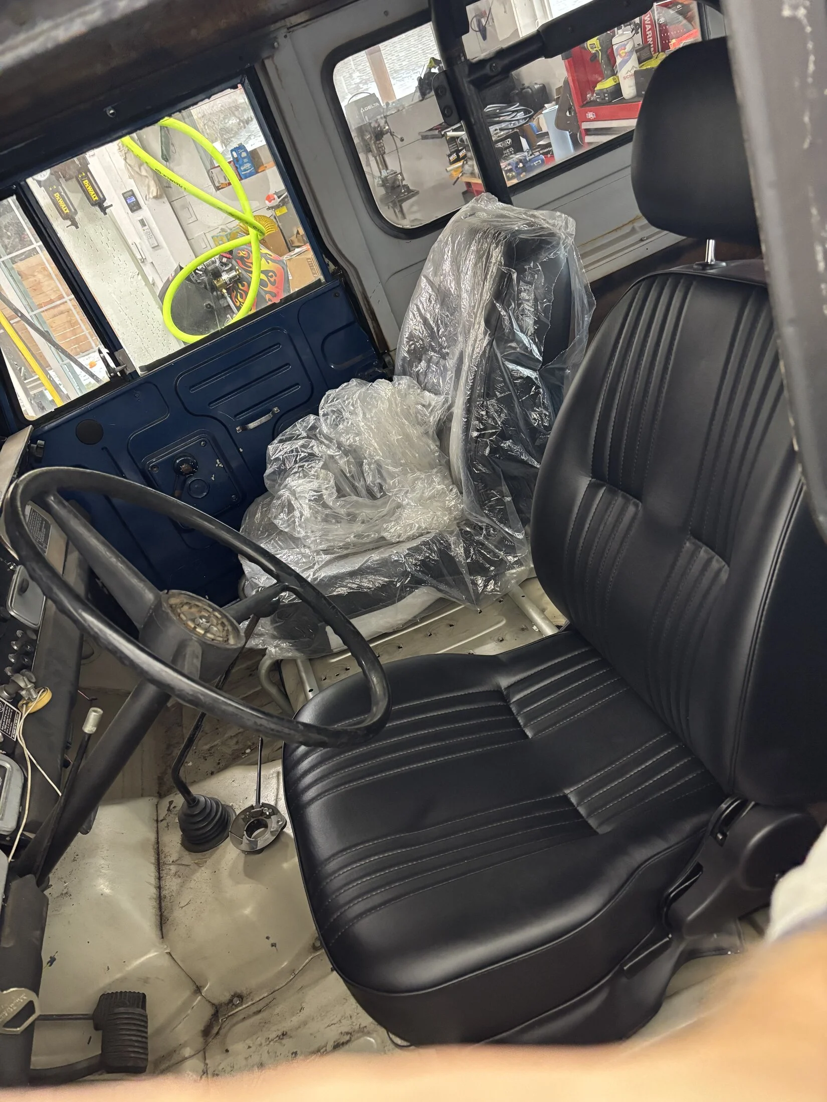

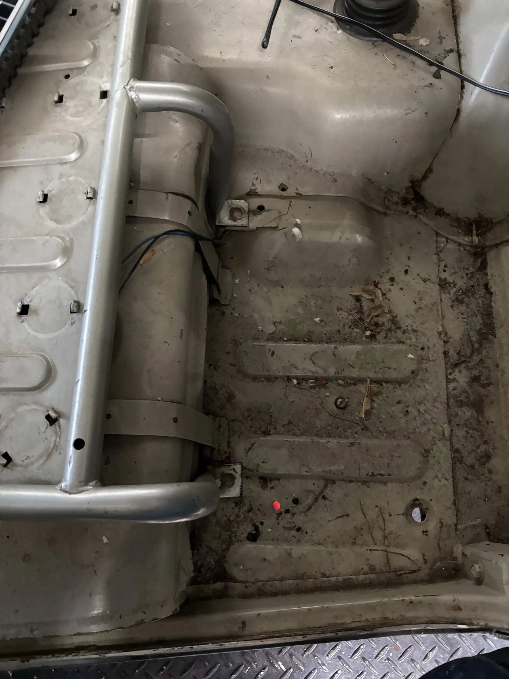

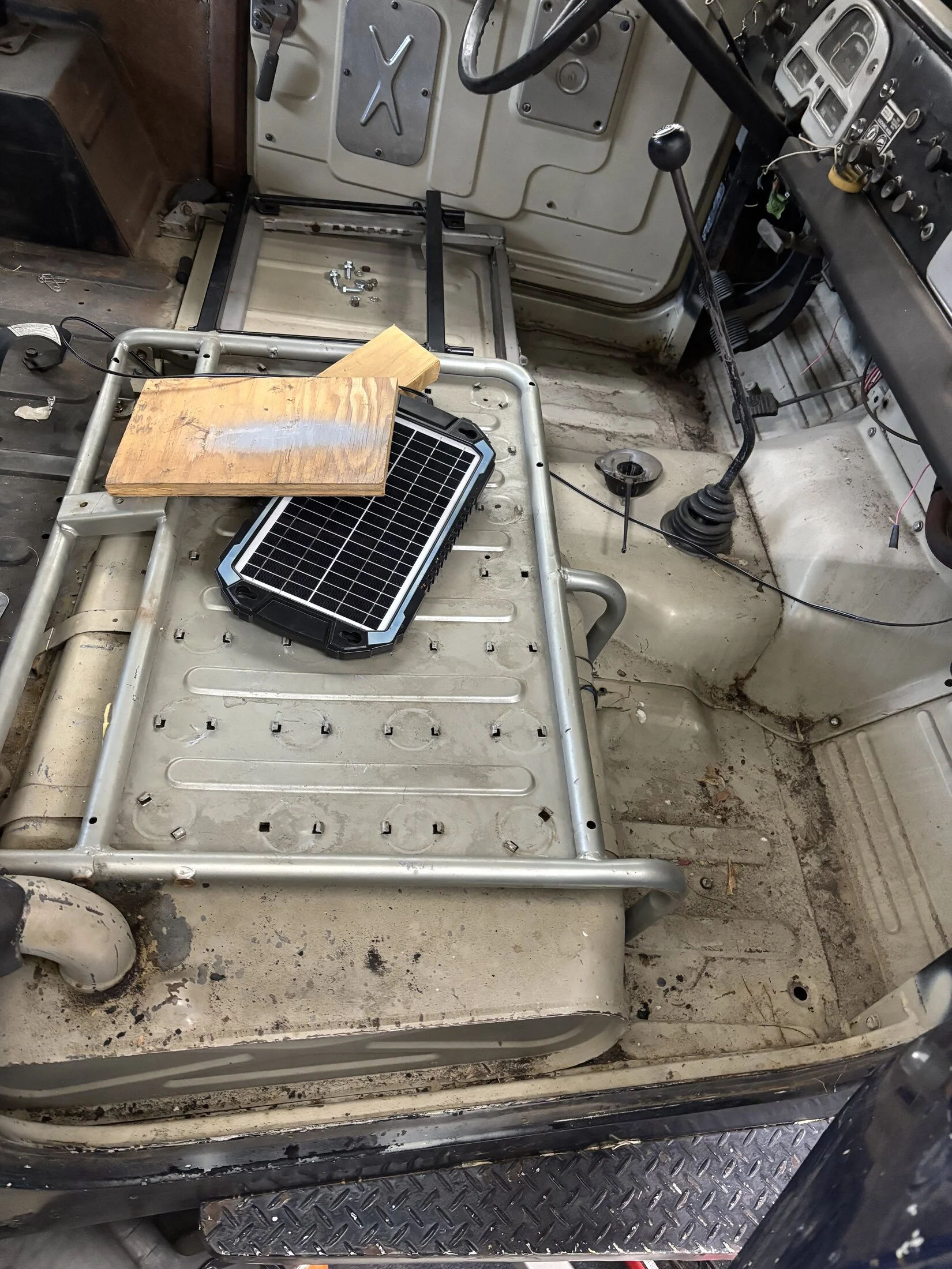

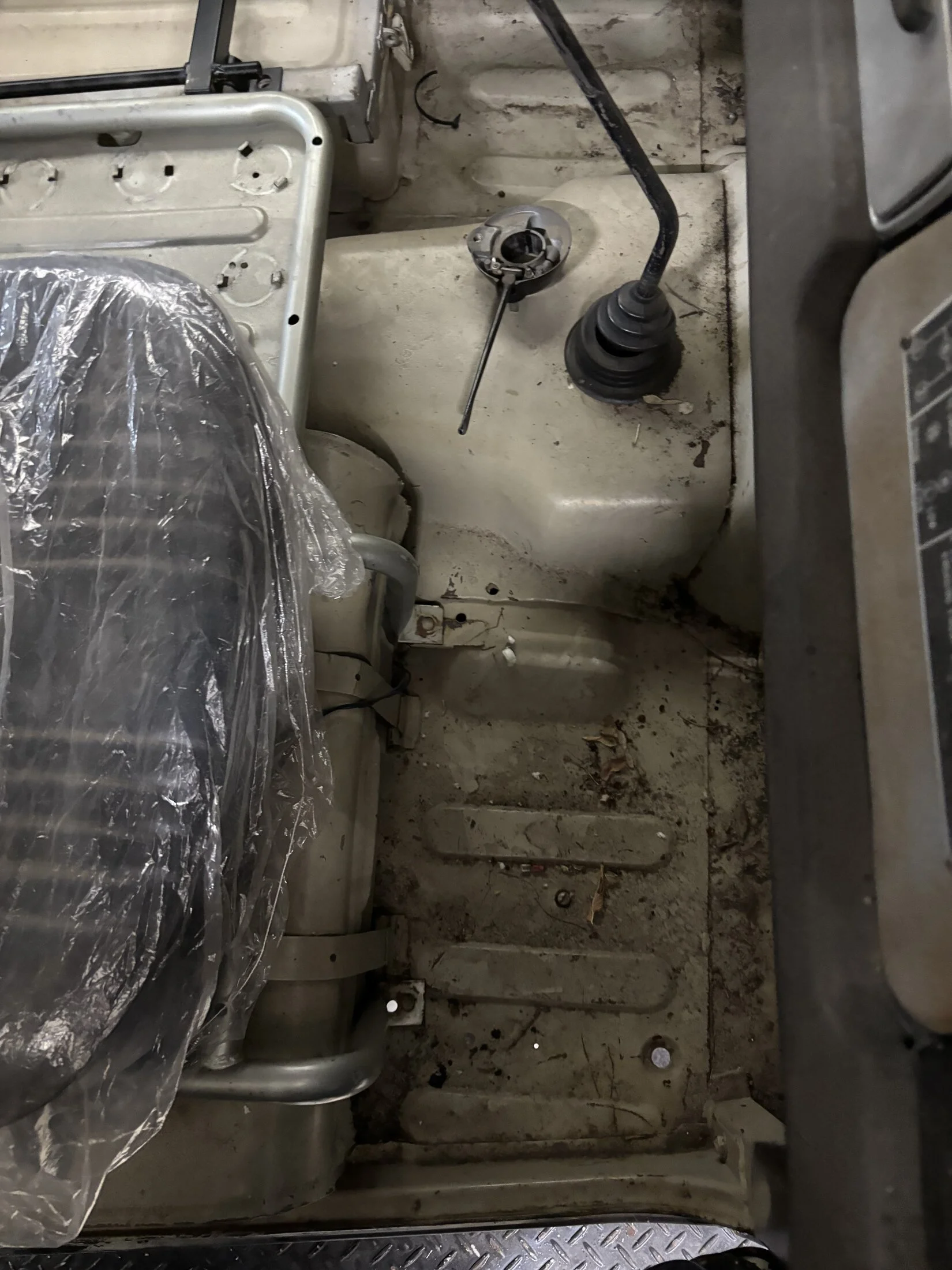

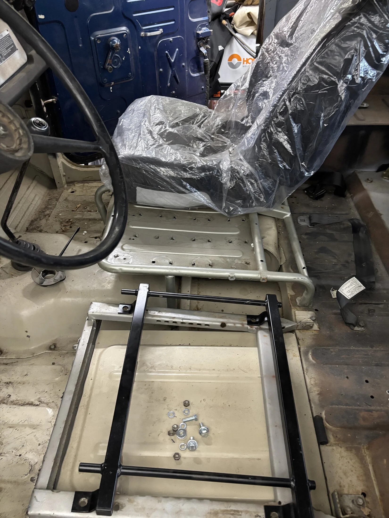

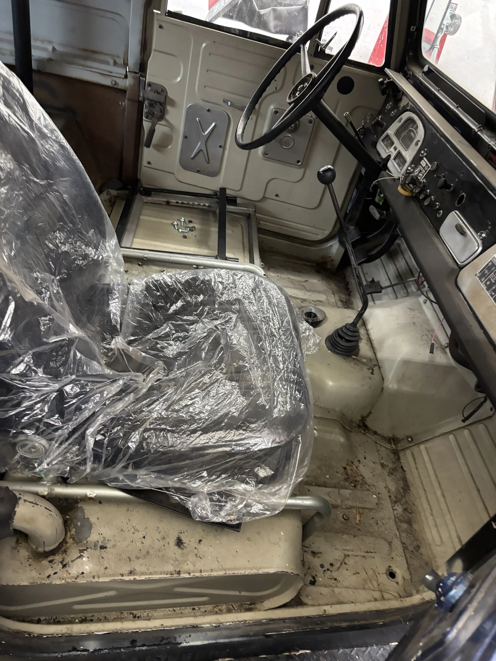

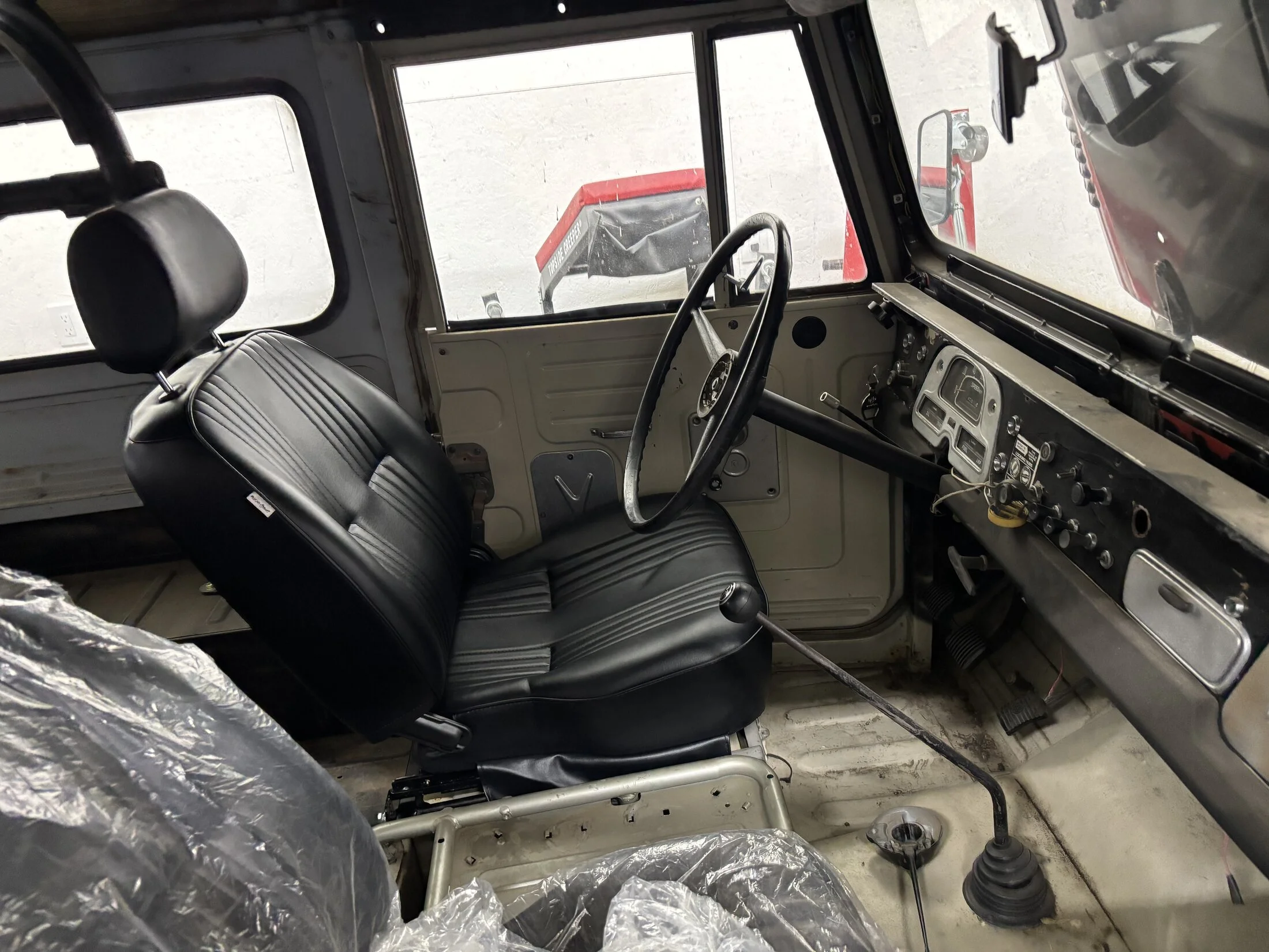

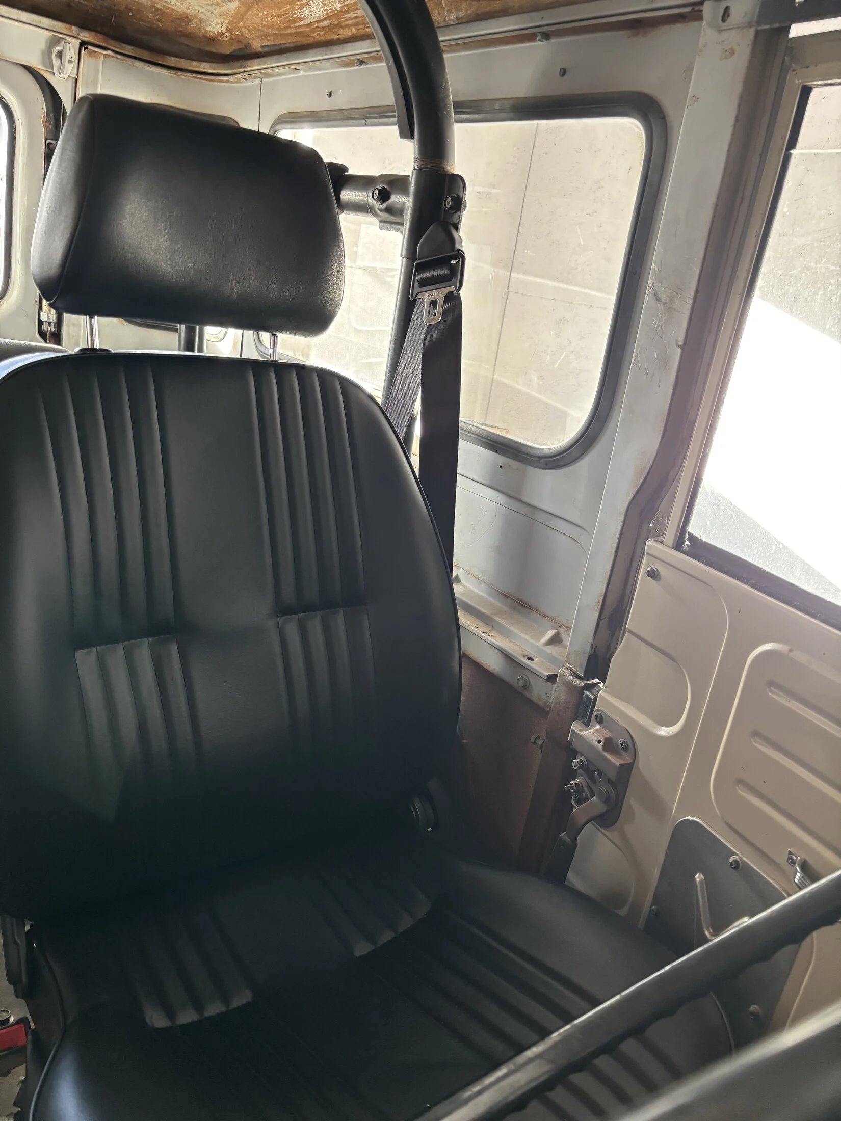

Then got to work on installing my Pro Car bucket seats I bought two years ago. The drivers side looks like it going to work well and is nearly in. The passenger side is a different story. I just now opened the box for the passenger side adapter and found out they sent me one for a Bronco. To make it worse, my passenger side factory base really isn’t in great shape. Only two of the four bolt holes on the legs match up with the floor pan, it’s much wider and hence ugly with just a bucket seat on it, so looking like I’m going to fab up my own bracket. Maybe time to get a stuffy console in there too.
Got the drivers side in today, definitely a huge upgrade in comfort over the original spring seats. Haven’t driven it yet, but I can definitely scoot it back and give my long legs a lot more legroom.
I will say that the quality of the adapters and seat mechanism isn’t great. Had to bend some stuff and drill out a hole to get everything to fit. The passenger side is going to be more involved with a custom frame, but hey when have I ever said no to a project…

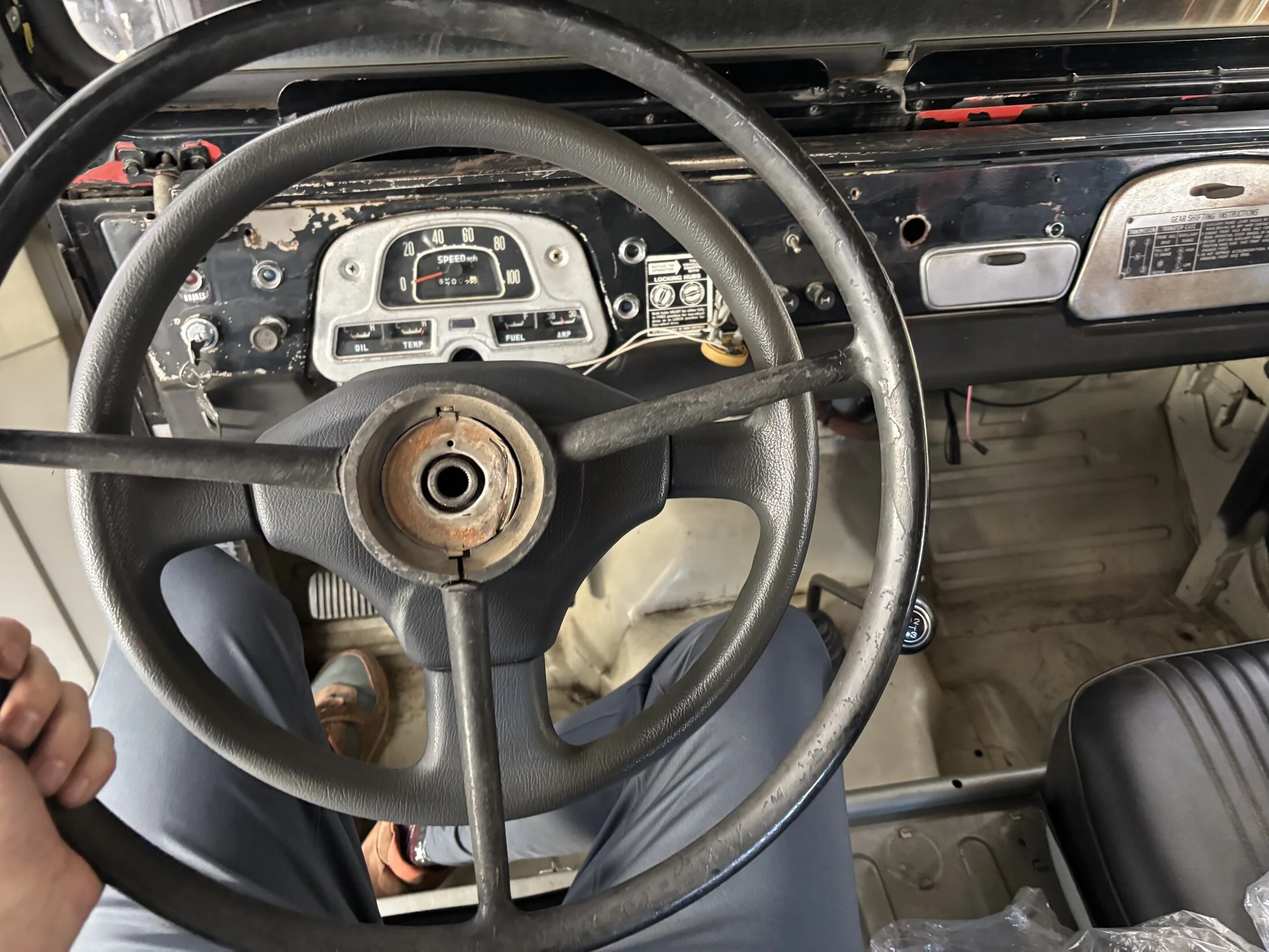

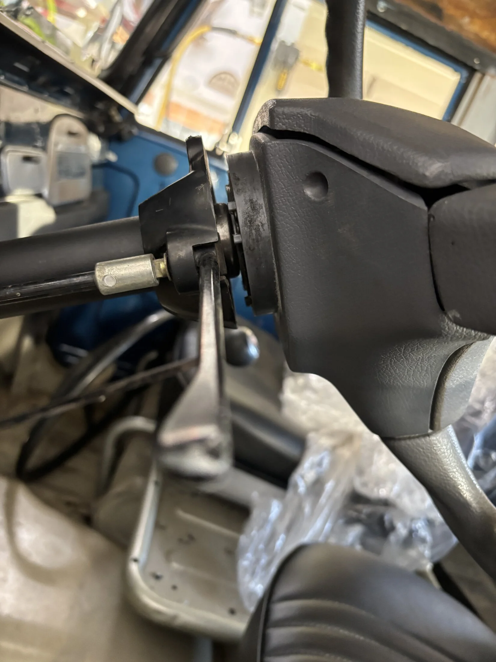

Continued to knock out some small projects today. Got my CCOT retractable 3 point belt installed on the drivers side, and my new 80 series steering wheels installed. It’ll be a project for another day to get the horn working as it looks like I’m pretty far apart, will have to do some investigation. I really really like the size and ergonomics of the new seat and steering wheel together, huge comfort improvement! Plus my old one was so cracked it didn’t give much confidence.

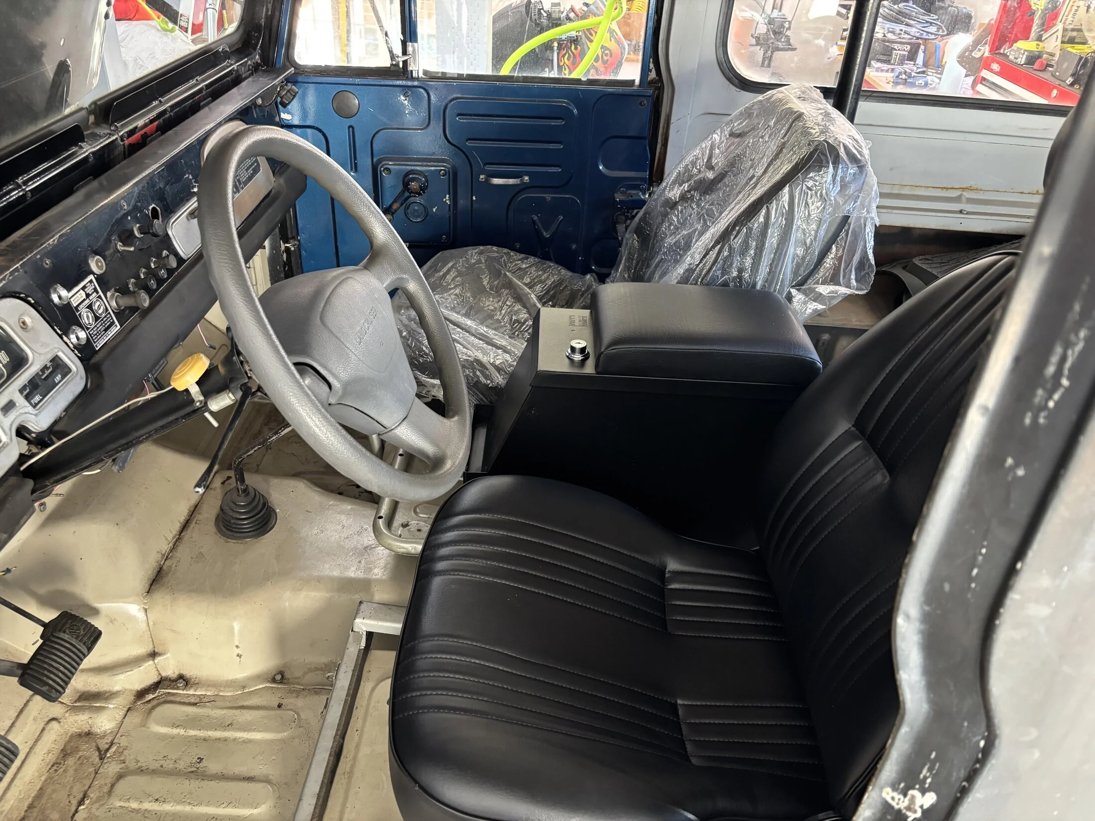

Another small update- figured if I am going to build my own frame for the passenger seat frame, now is the time to also do a console. Tuffy 8in was on sale so picked one of those up. Have only set it in the cab for now, but wow, the comfort just keeps getting better! Can’t wait to get some free time to get the seat in and get this puppy on the road!

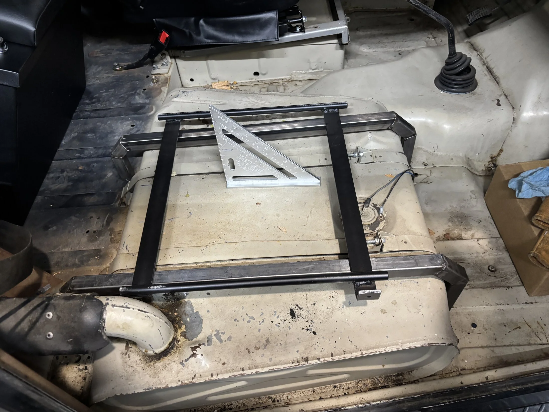

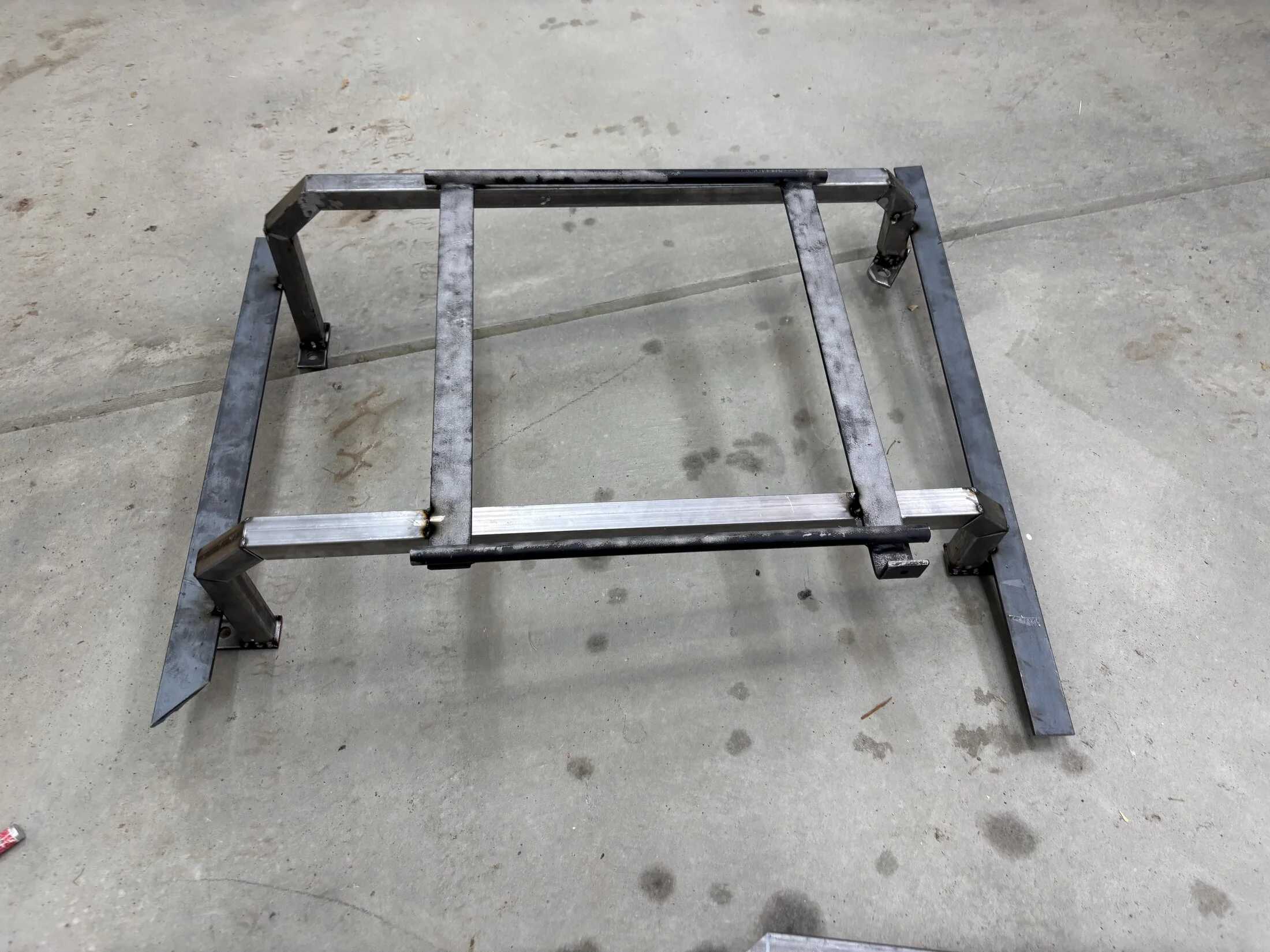

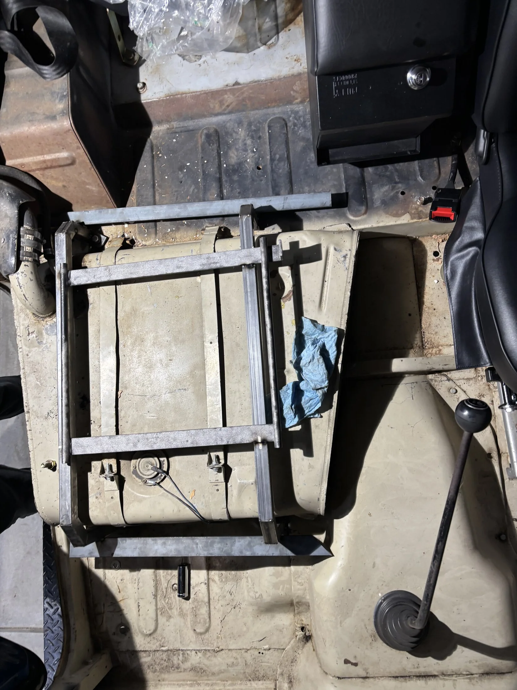

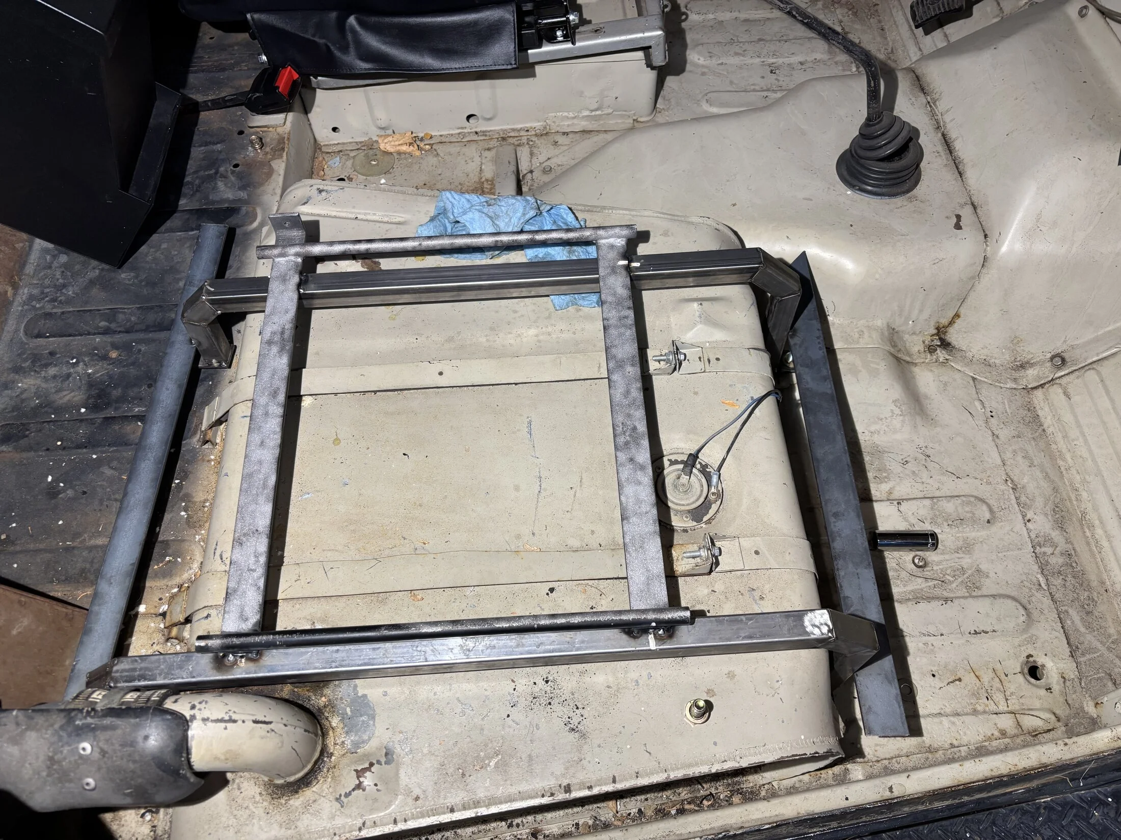

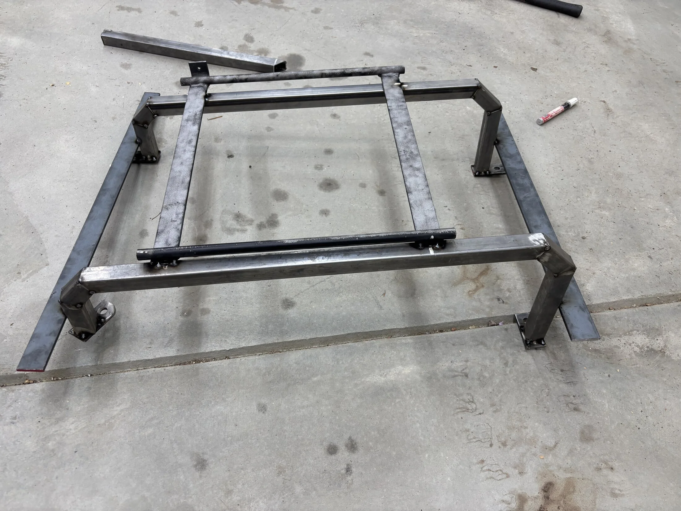

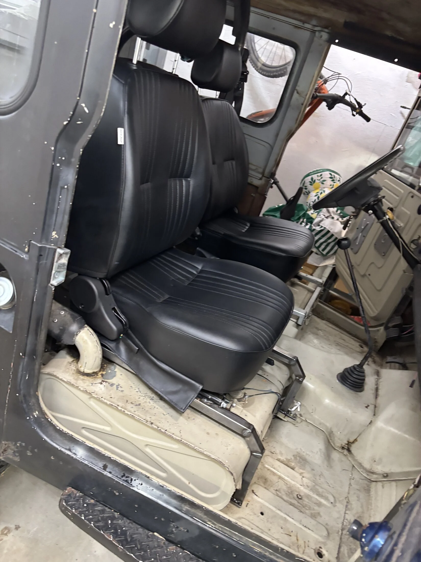

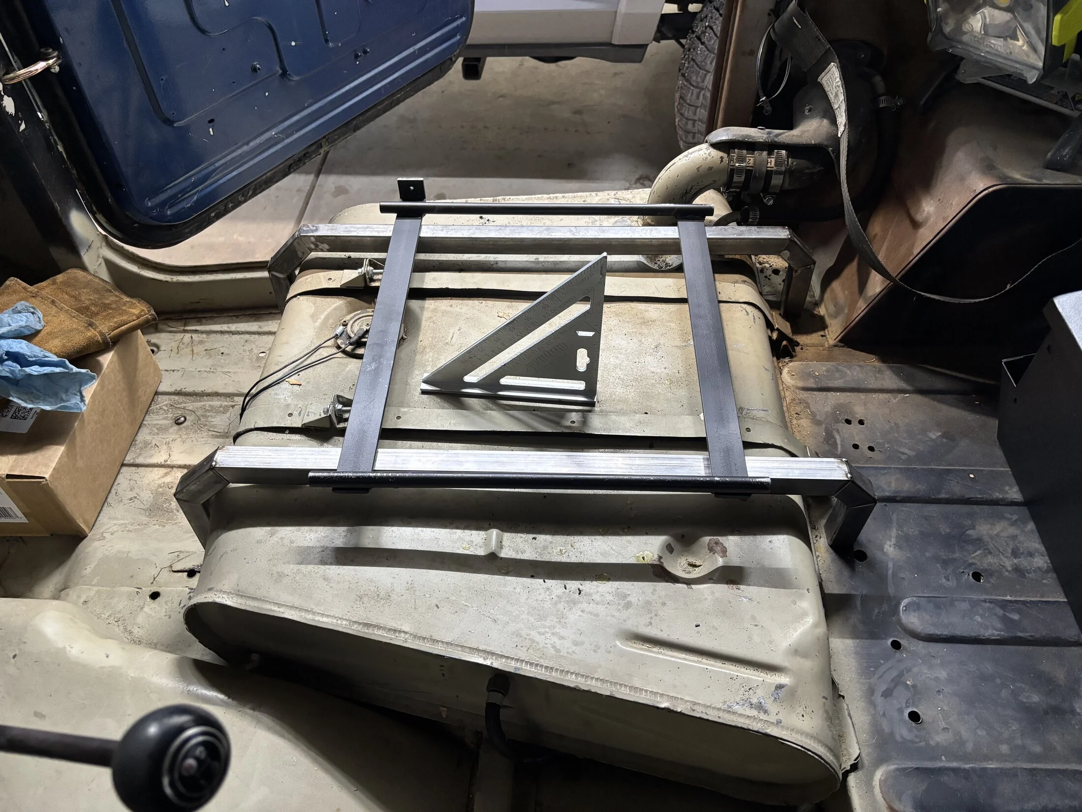

Made some progress today on the new passenger side seat frame. Hope to have it all welding up and painted this weekend. Taking the whole day off tomorrow to work on it. Ended up just cutting the legs off the base they was sent mistakenly for a bronco and I think it’ll actually work perfectly welded to my frame.
Didn’t quite get as far as I wanted today, but close. Have the seat frame all tacked up and feet plus bolts fab’d. ended up using rivnuts in the front to mimic the captured nuts in the back. Since the seat belt will be held on in different bolt holes, I figured I didn’t need to go bomber on the whole seat. I’m almost ready to final weld everything, but I keep trying to tack weld some thicker stock as an anti warp frame and in doing so, warping the frame ha. Would be really nice to not be right over the fuel tank, or I’d just weld it in place!
When told smoking his cigar near the B-52 might cause it to explode by the security airman, Curtis Lemay replied "It wouldn't dare"
Good news and bad news-

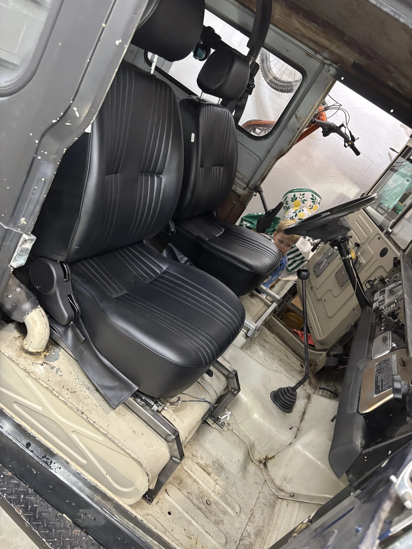

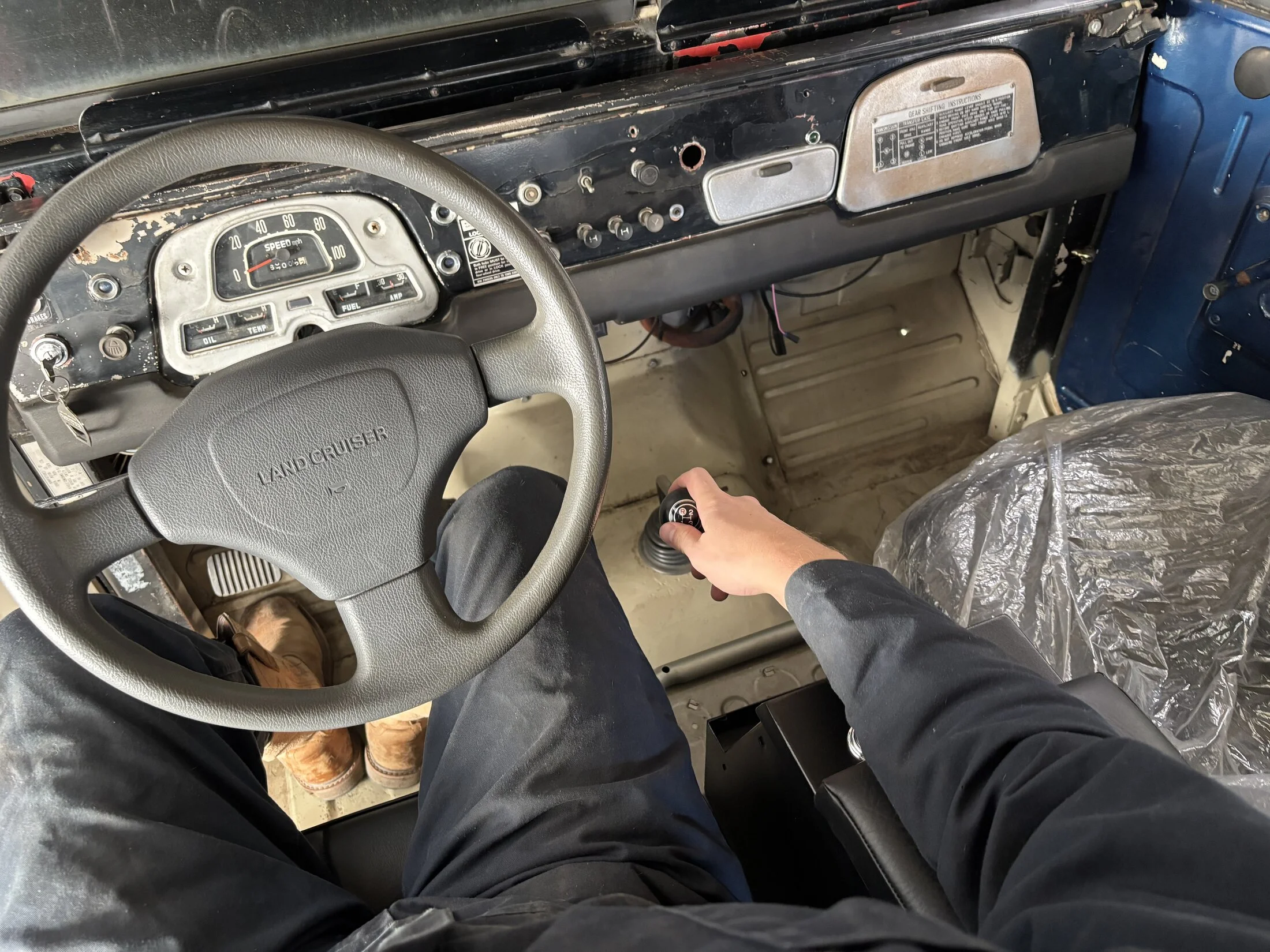

First the good- the frame works and the seat is great. The thin metal I used definitely warped a lot and it was a bear to get it un mangled. Slow down on the welding Kevin! Got it in for a solid test fit and took the kiddo for a drive.
