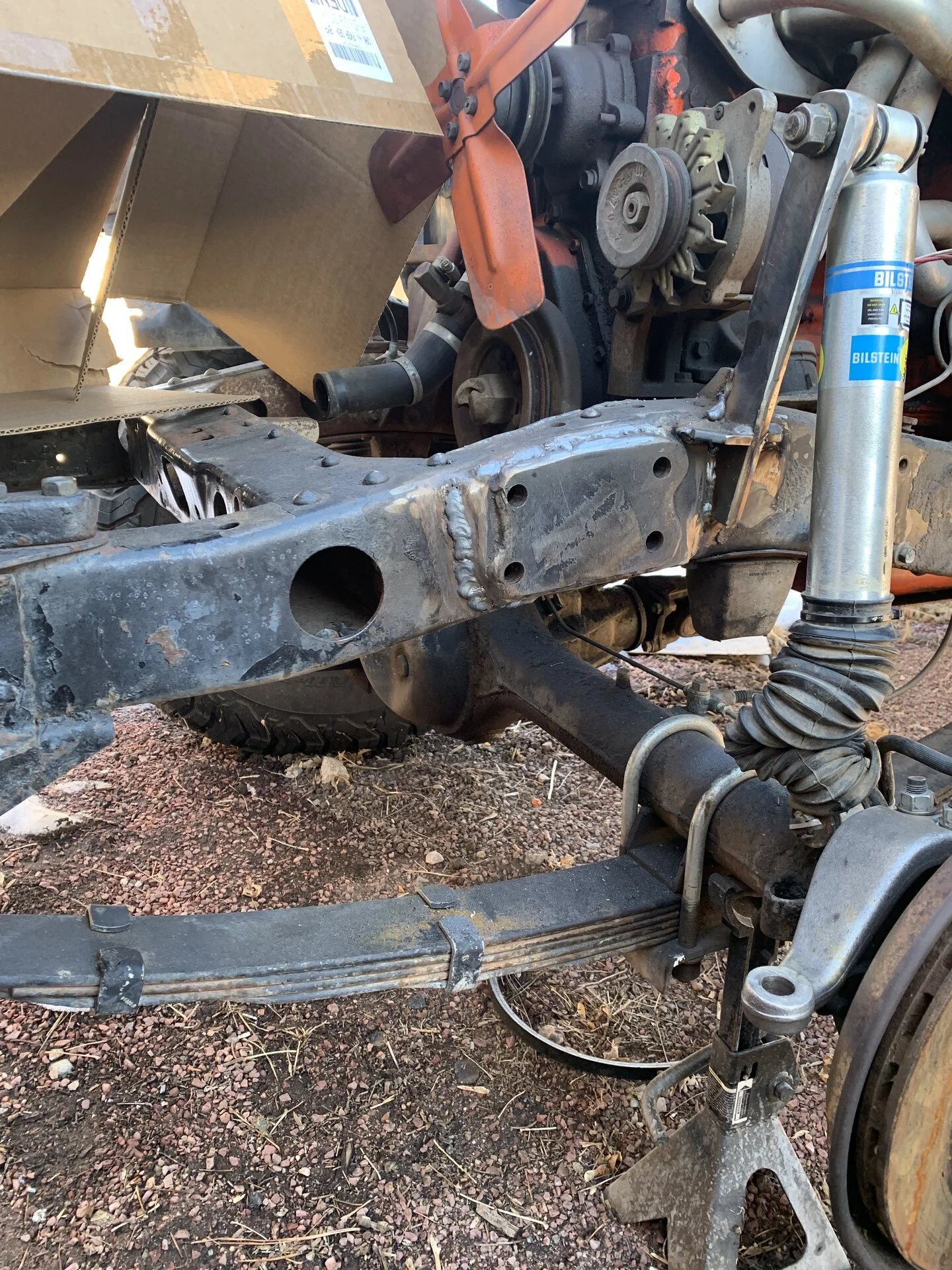

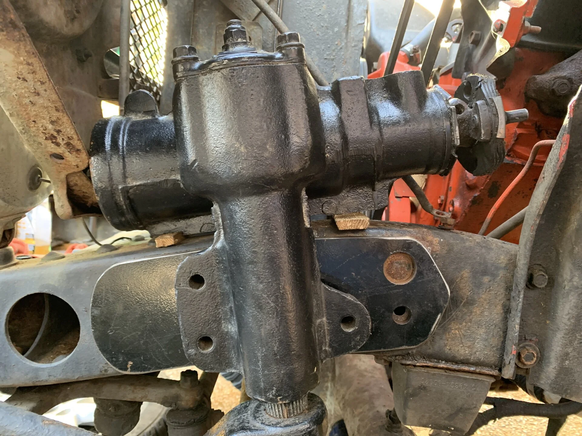

Maybe it is one. I just didn't see the curve. Here's my setup (I also added hydro assist). I added a plate on the inside of the frame rail and sleeved the bolt holes.
Mine definitely doesn’t have the curve like yours. But it’s advertised as 40/60/80? I think it’ll work.

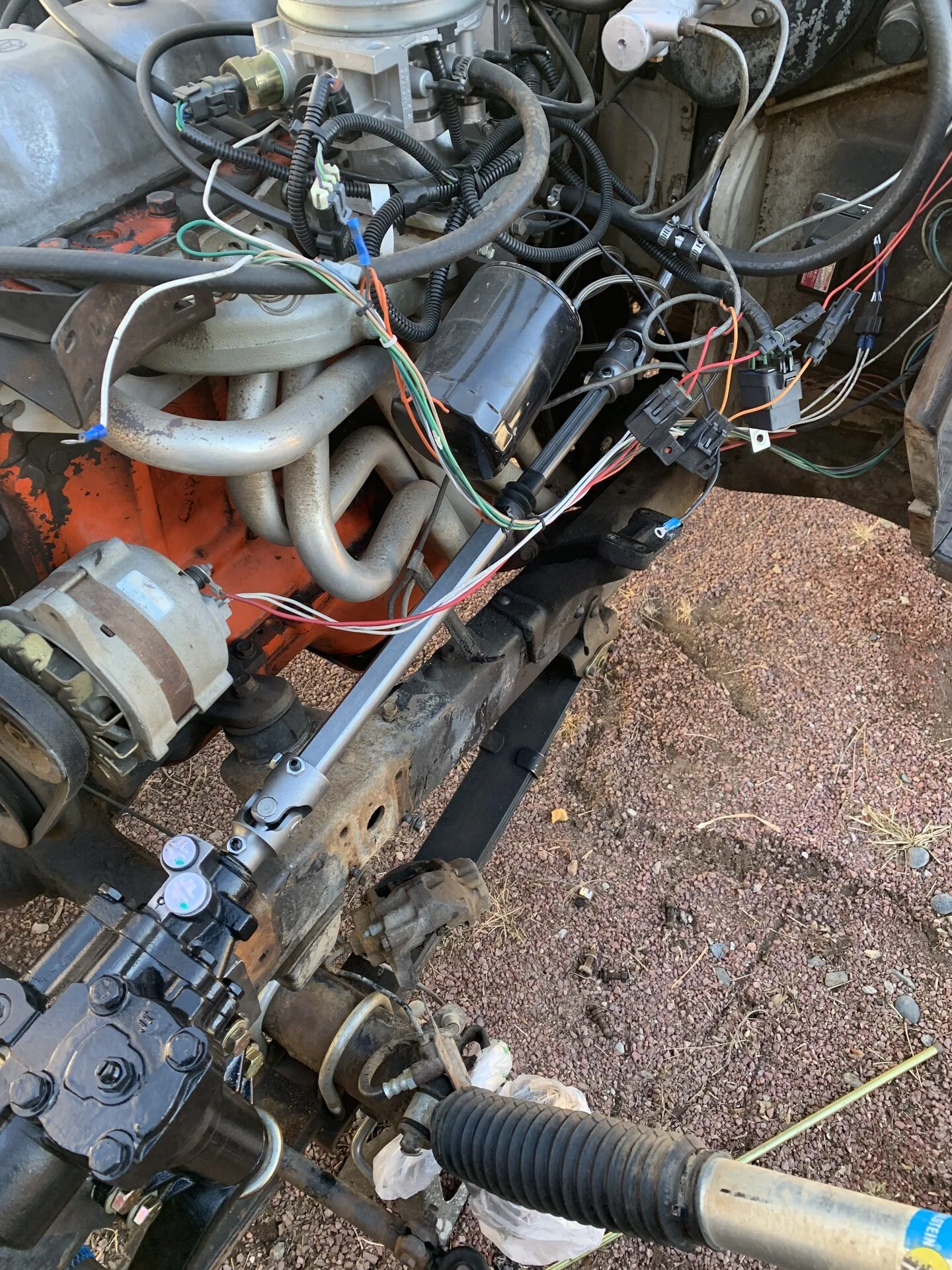

I got the steering shaft finalized as well and that feels really good. Turns very smoothly.

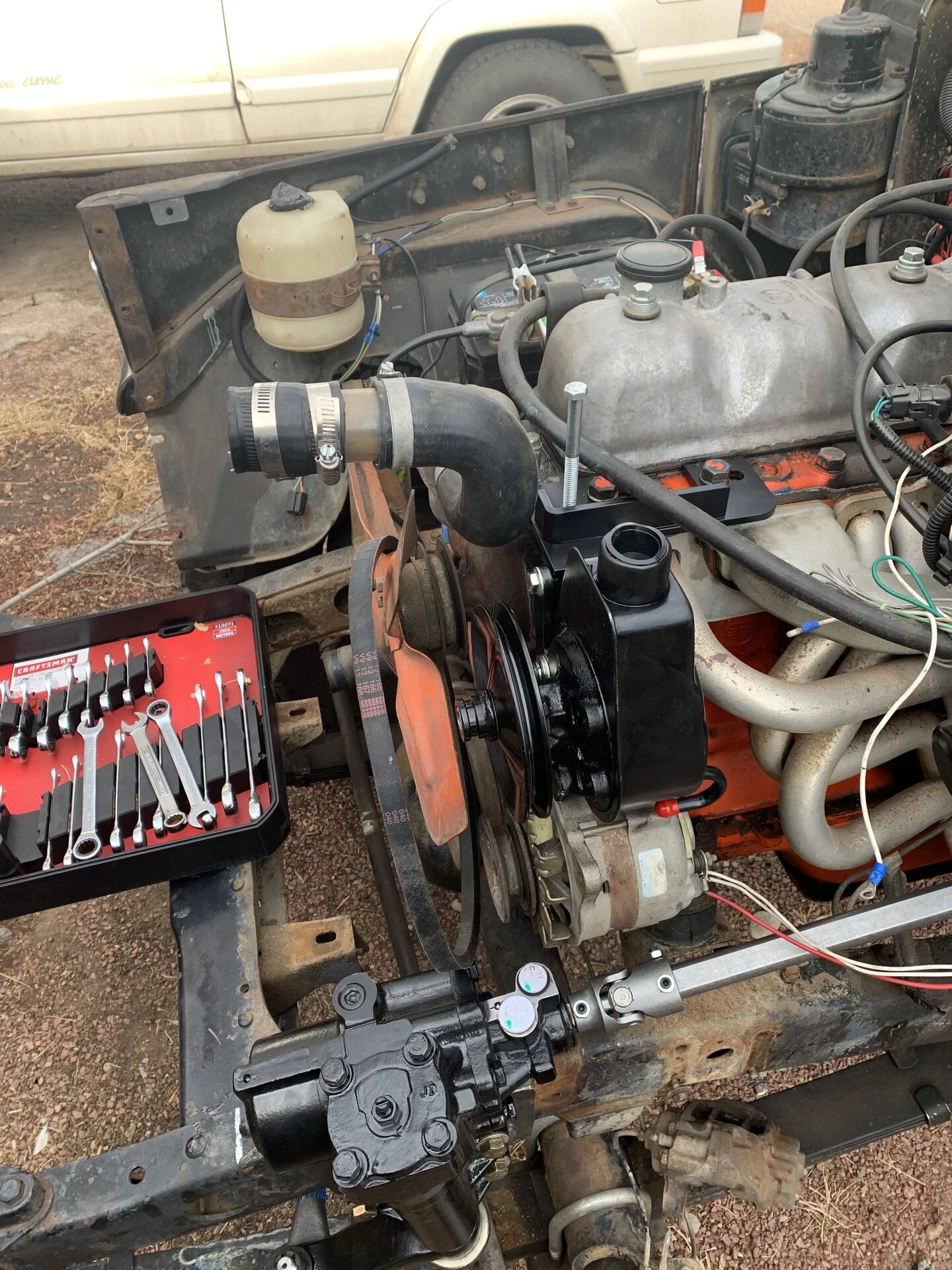

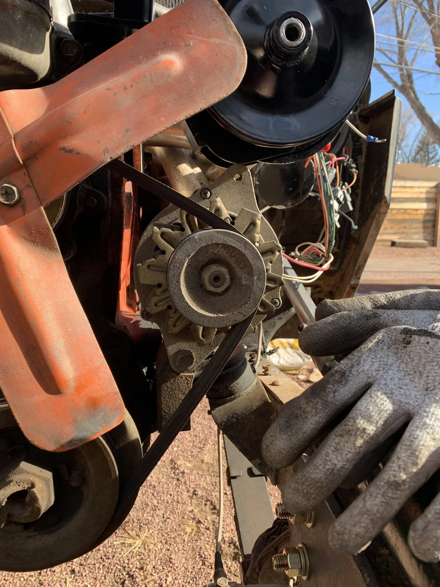

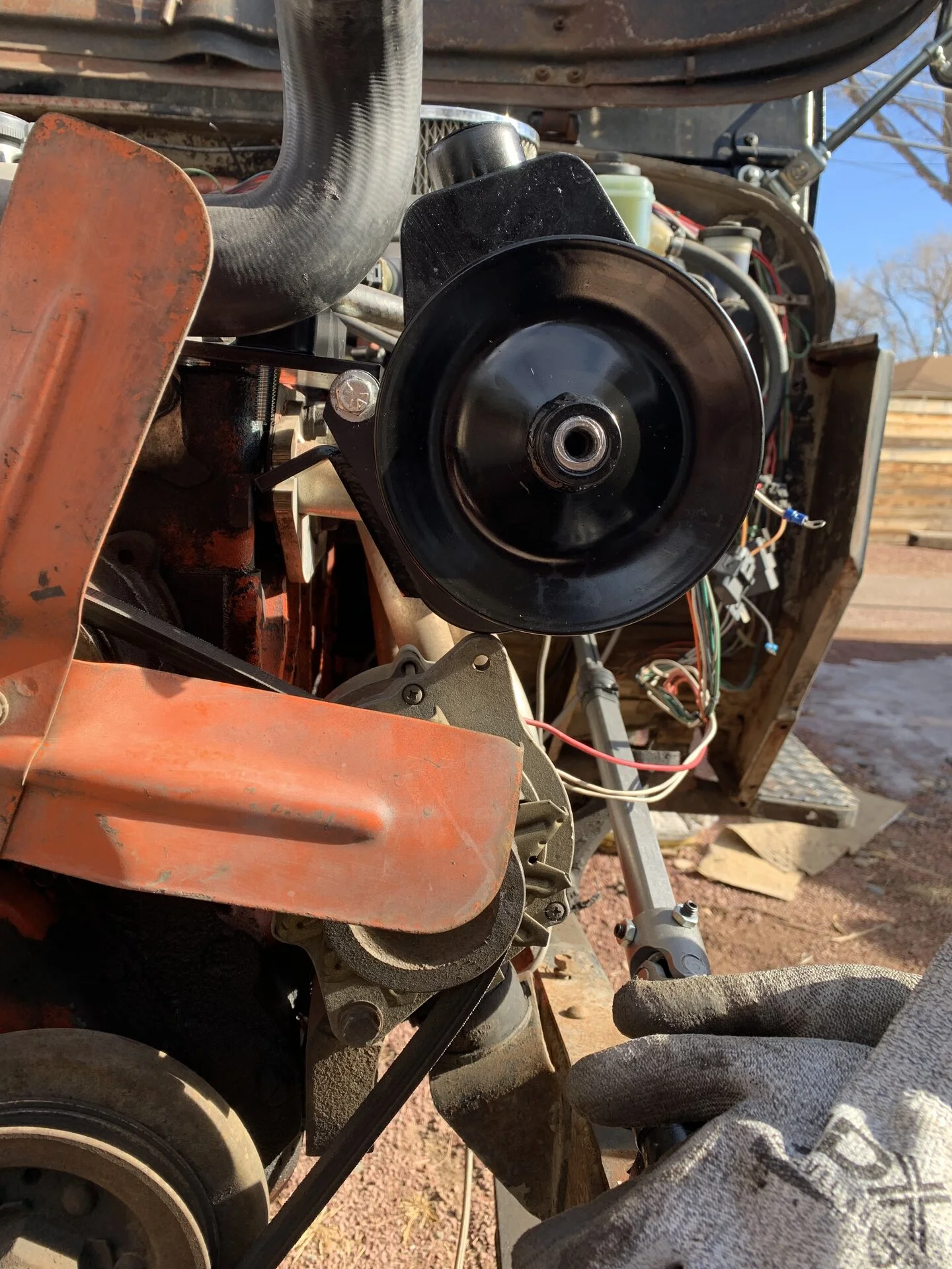

Then started putting the power steering pump and brackets together. Like a dummy I put the pulley on backwards, so had to order a puller to try that again. My head bolts look like they’ve been sitting in mud for the past five decades, so probably a good thing I’ve got a new motor in the works!
Finally got the my replacement pulley on (using a claw puller to remove the one I put on backwards ended up warping it, stupid $35 mistake!) and now that I've got everything mounted, I find myself a member of the "wide belt, narrow PS pulley" club, that I didn't know existed till I got in this far! Honestly why is the non-keyed pump sold in the kits from so many vendors?! From what I can tell, you can run a narrow belt with decent success in the wide pulleys, but dang it feels like the keyed PS pump is the same cost as the press and a much better starting point for all of these setups! My alternator is only held at the bottom, as it appears the top slider bolt is broken off the front of the motor and the POs have just tighten the crap out of that mount. It's actually pretty solid, and short of getting new mounts, looks like my only option too. With some adjusting, I was able to get the alt and the PS pump oriented just right, though not a lot of clearance for the return hose. I don't think I got a pic of the final alignment now that I look at these, but I was able to arrange them to fit, though not sure I'm loving the belt wrap on the alternator (or lack there of).

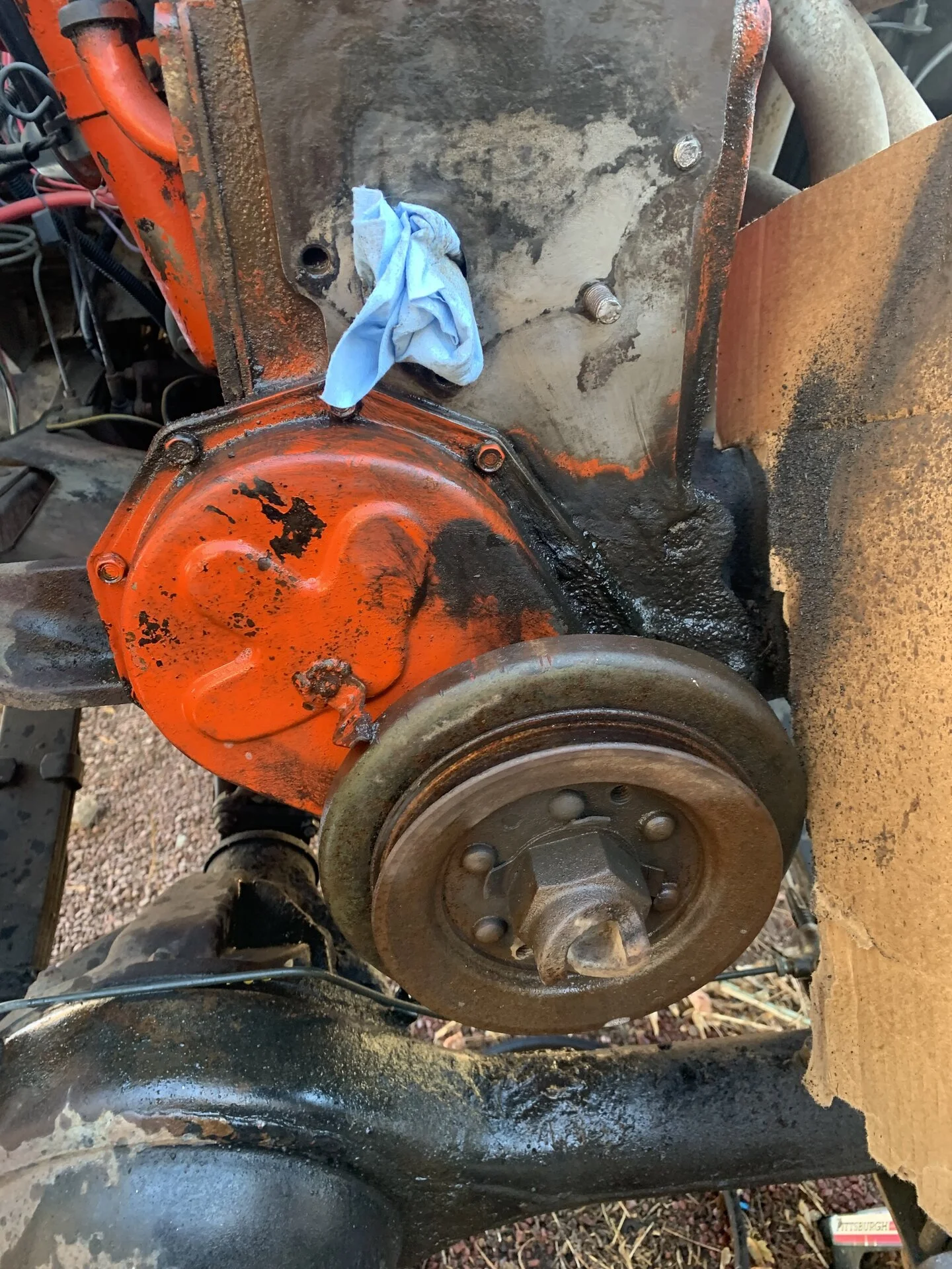

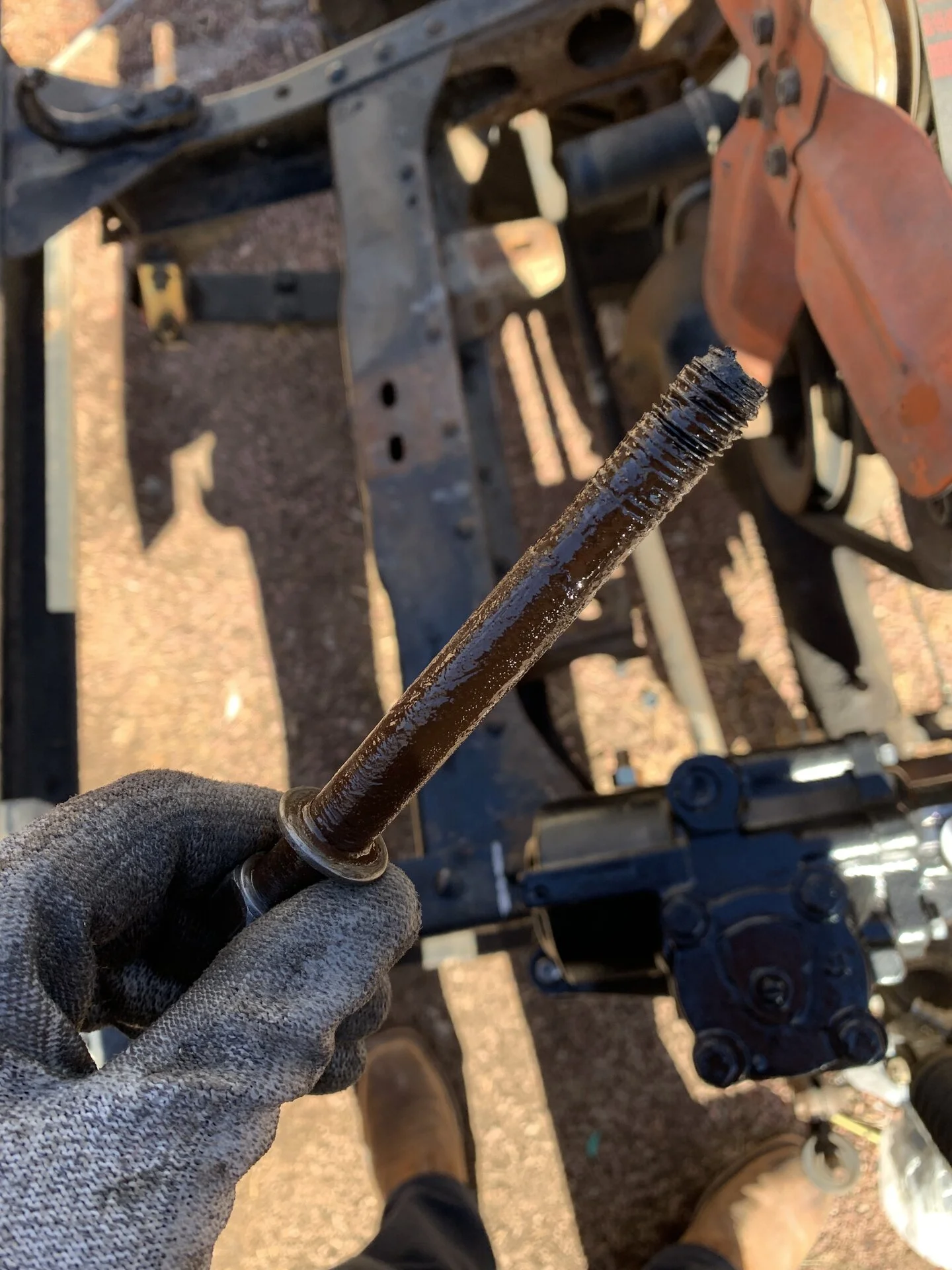

Anyways, the last pic is a shot of my head bolt that looks like it was sitting in a swamp! Both of the front two look like that, which makes me think a blown head gasket is the culprit, these should come out bone dry right? Thankfully I've got a new motor in the works, but I would like to drive this for a while before I get to that swap...

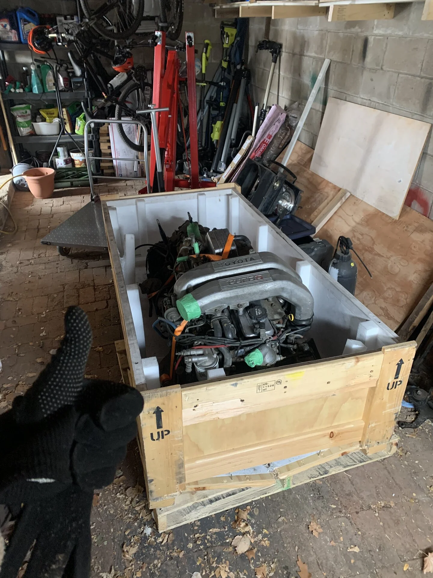

Not much progress lately on account of snow, frigid temps and most importantly a new baby! Should find some time in the next month to get this power steering wrapped up. In the meantime, would you look what showed up today and somehow weaseled it’s way into my garage:
Solves the belt issue.
Just might open up a can of new ones!
I had a look at tractor supply the other day and they have a ton of keyway pulleys with set screws for the wide belt for cheap. I think drilling a small set screw spot in the pump shaft would be the way to go there.

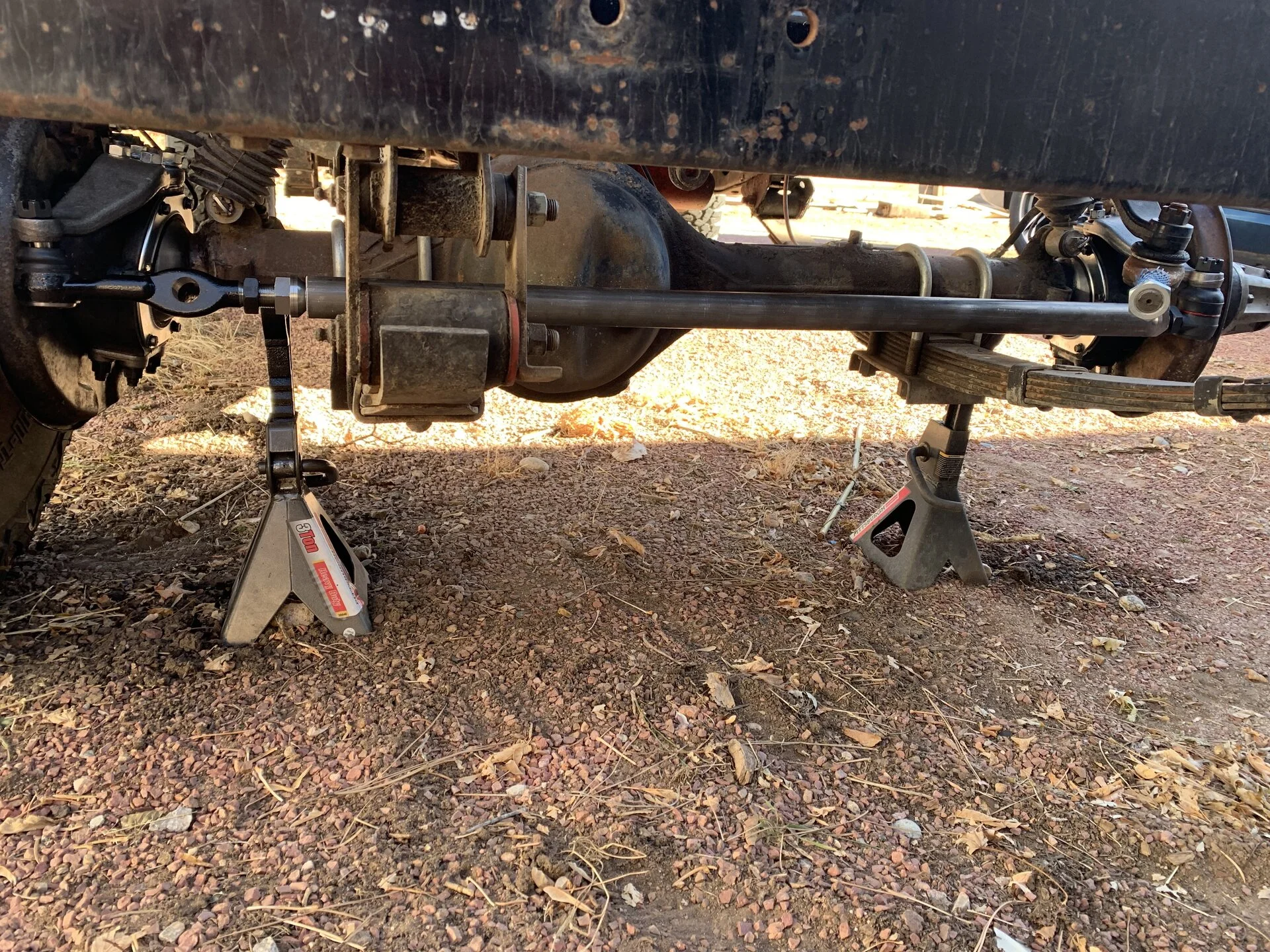

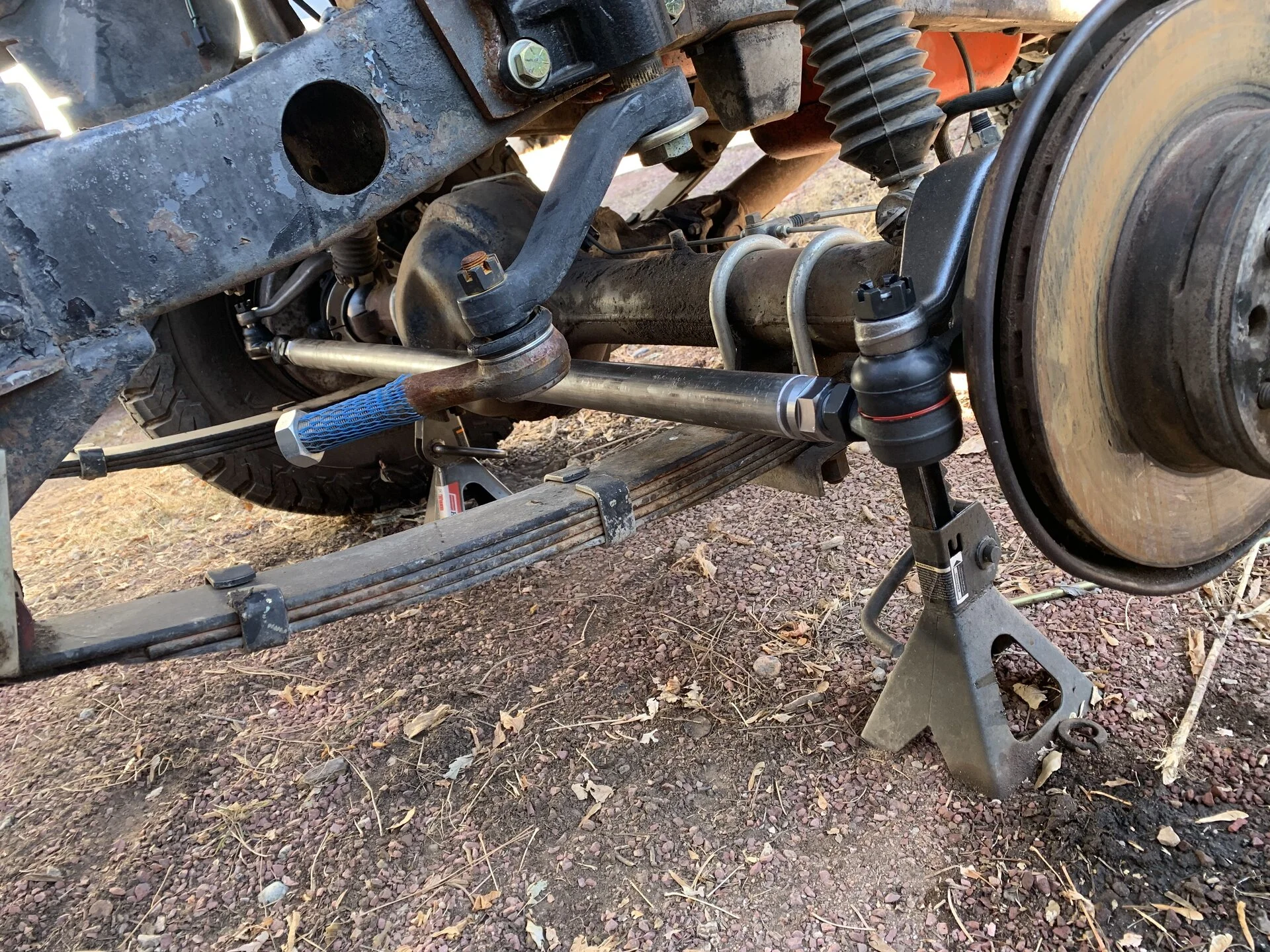

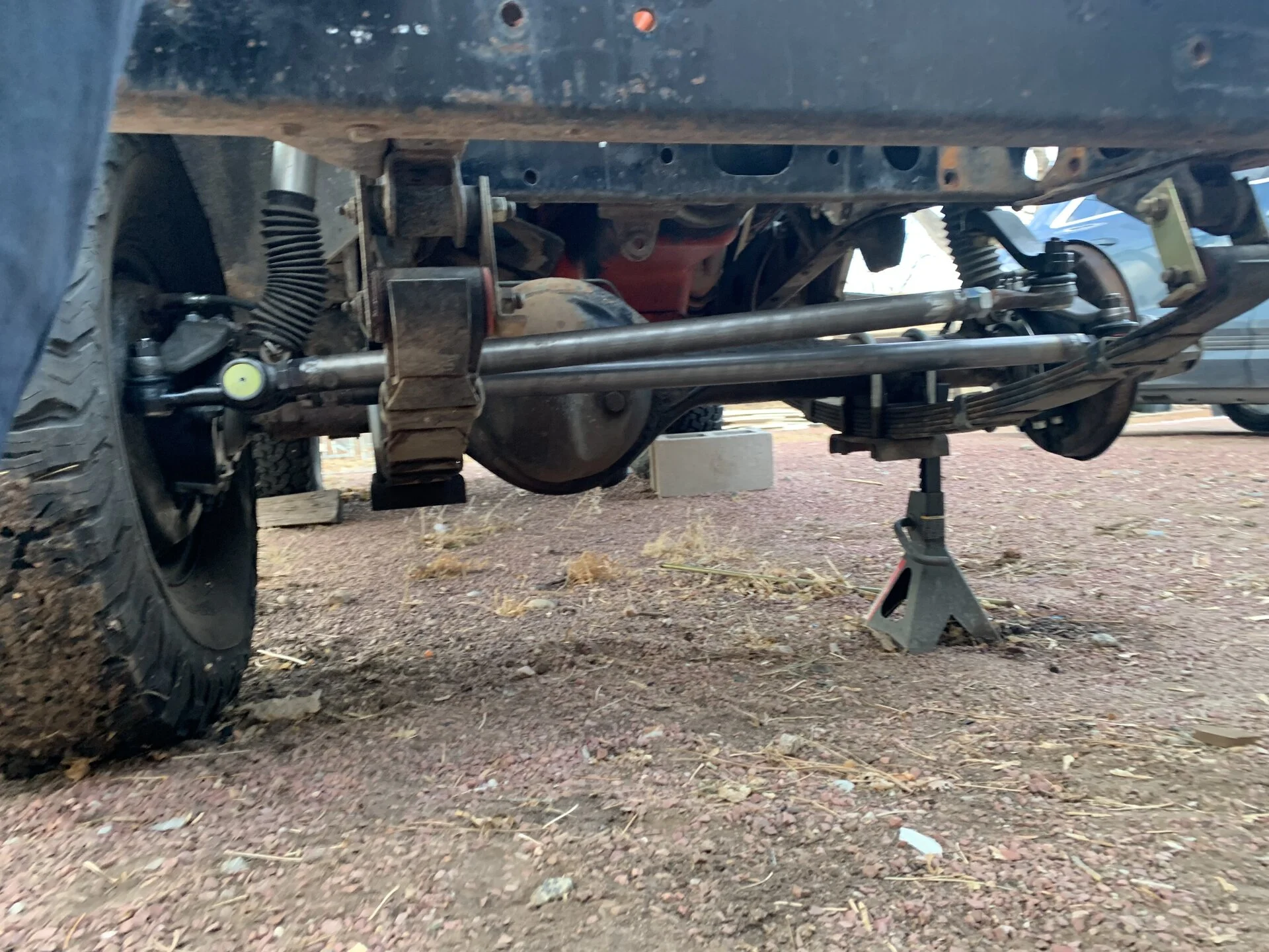

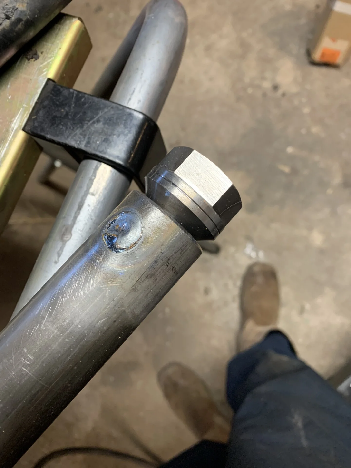

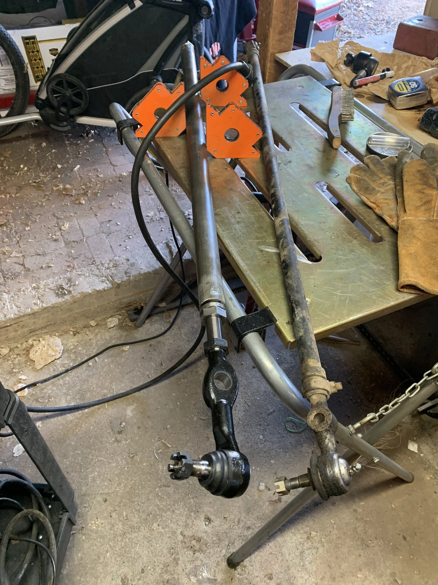

Got the tie rod welded up today. The Barnes kit is really nice. The size difference vs stock is laughable!

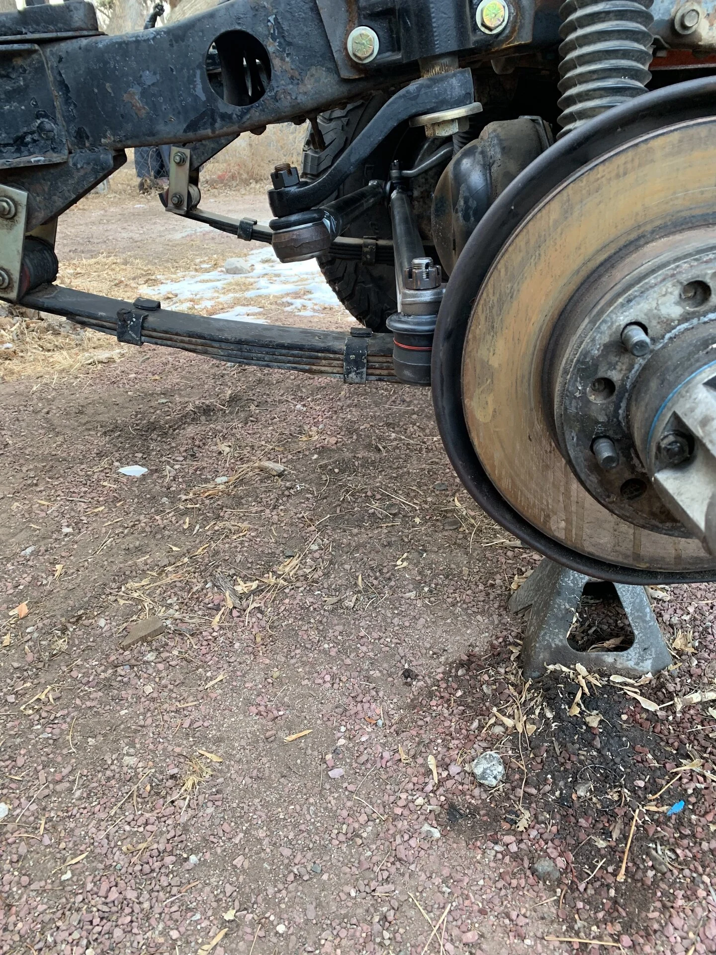

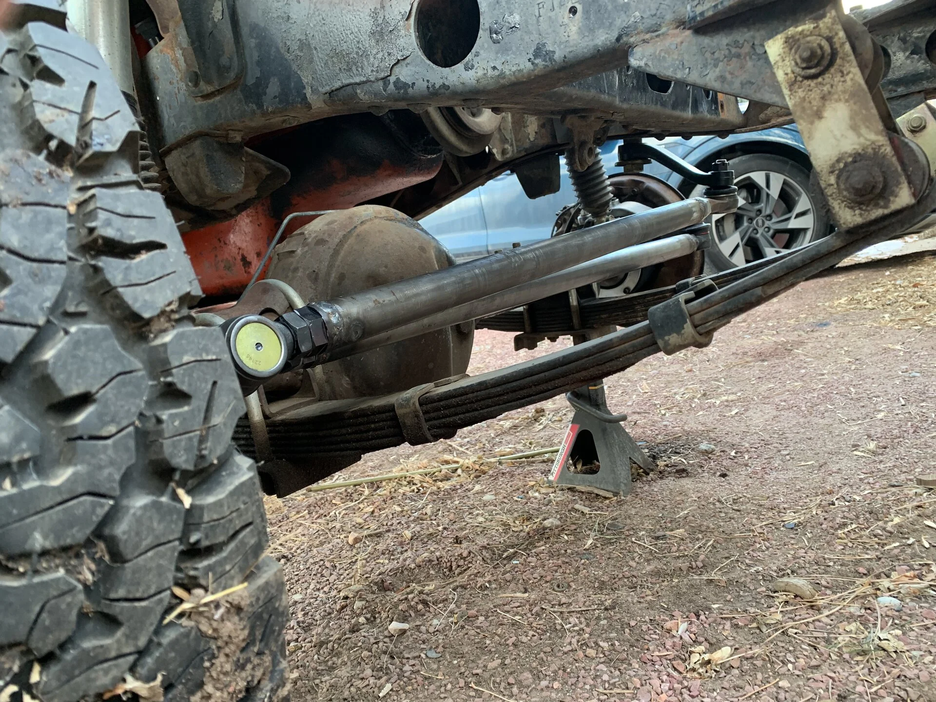

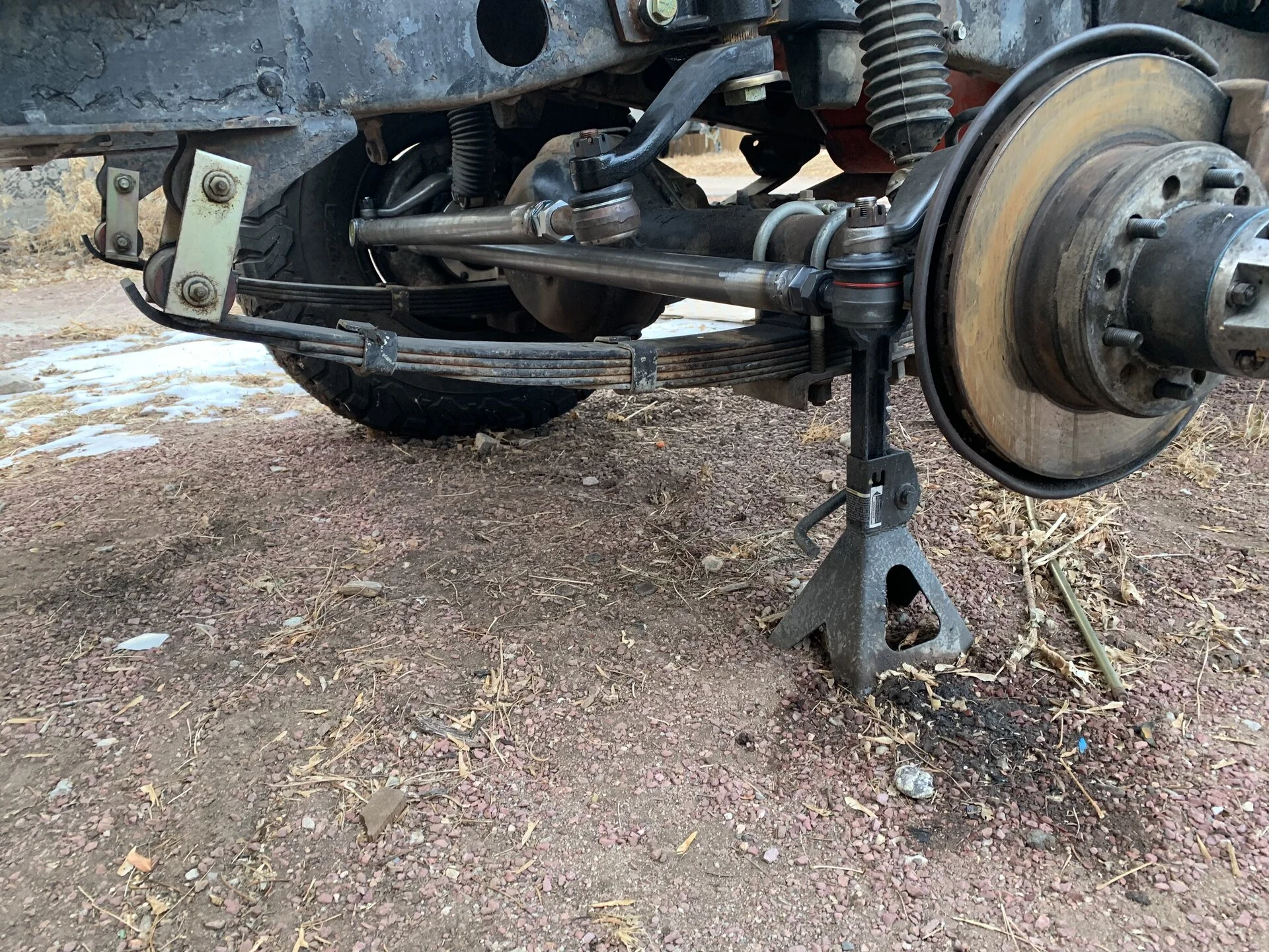

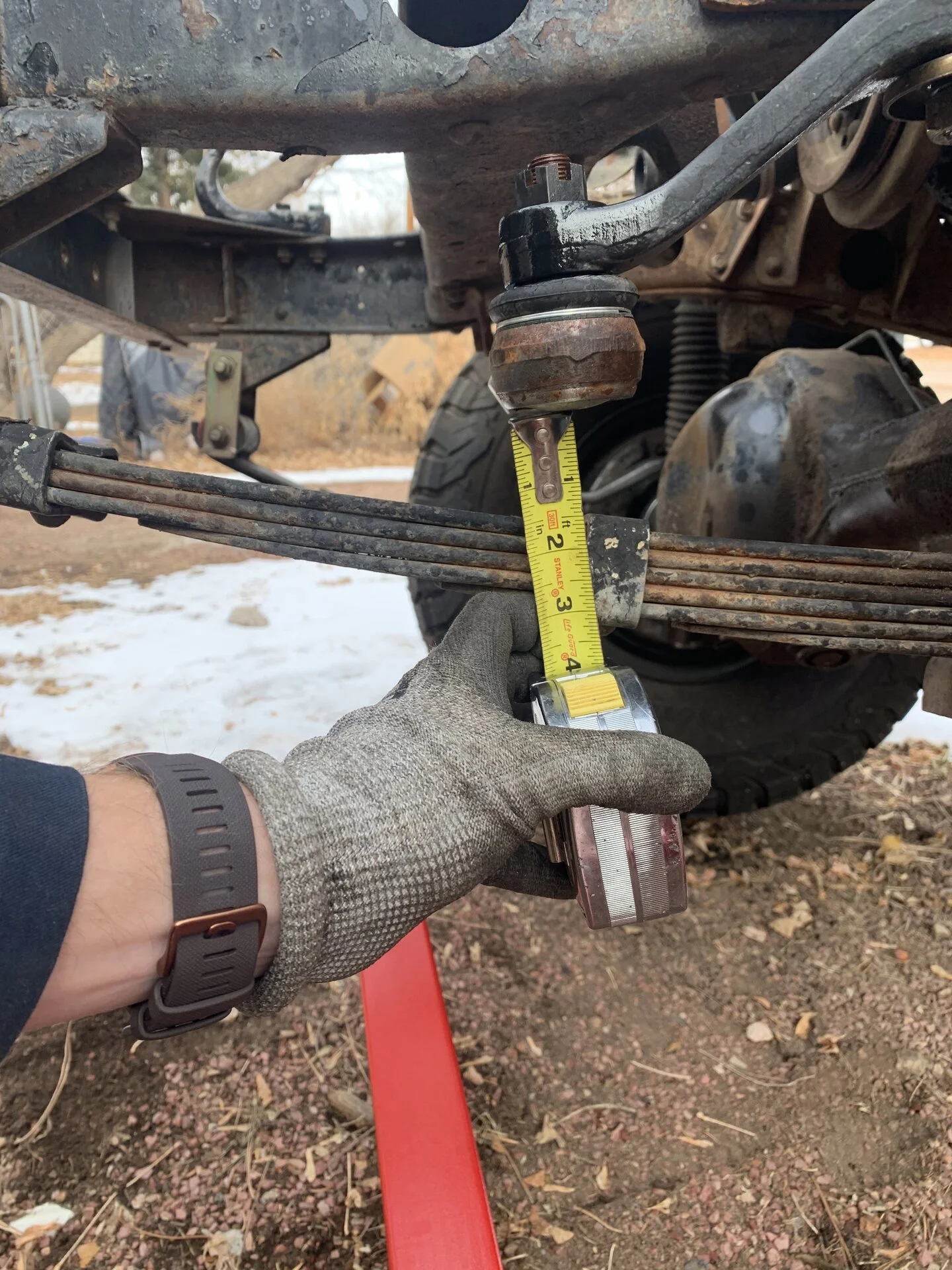

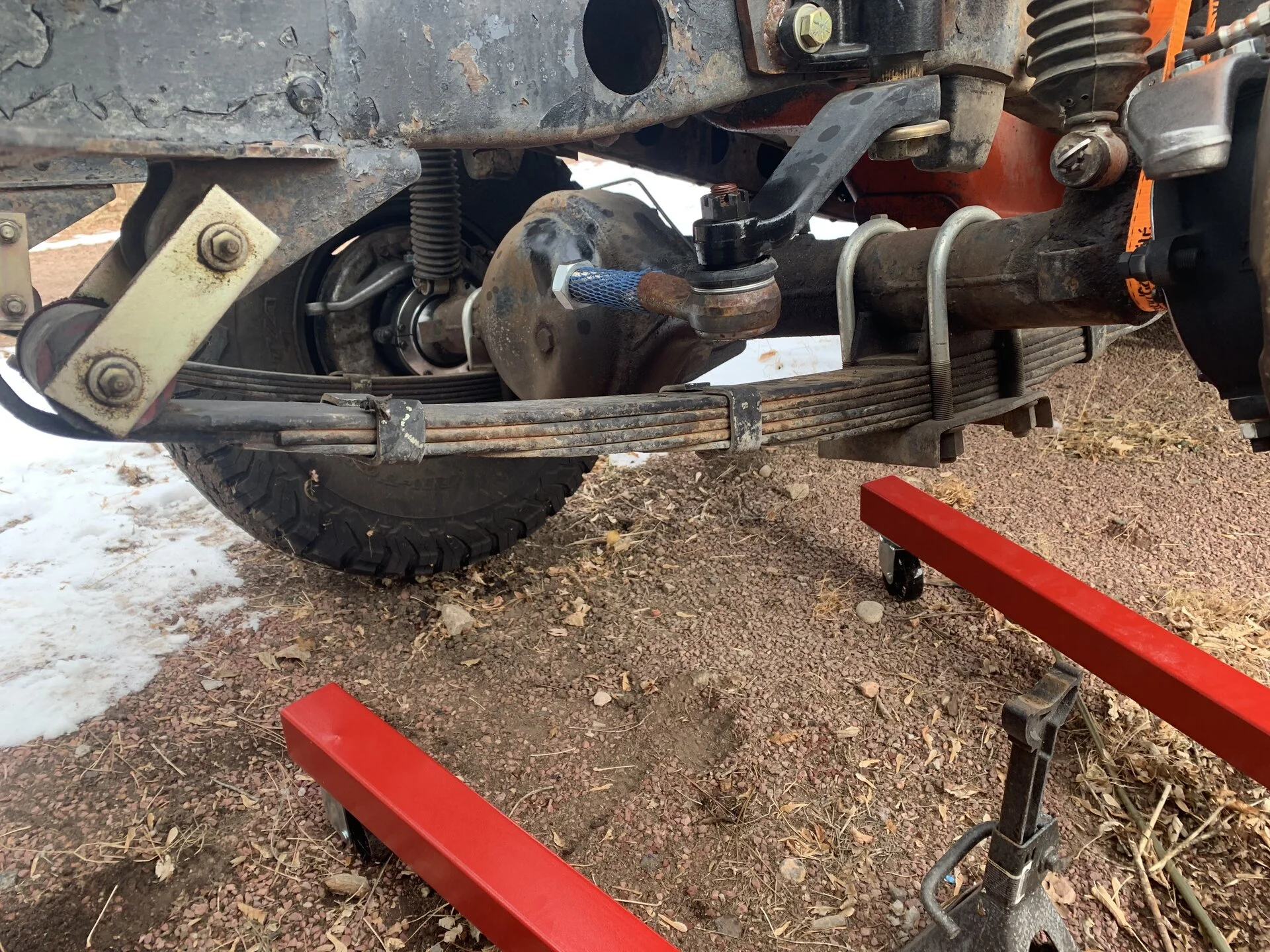

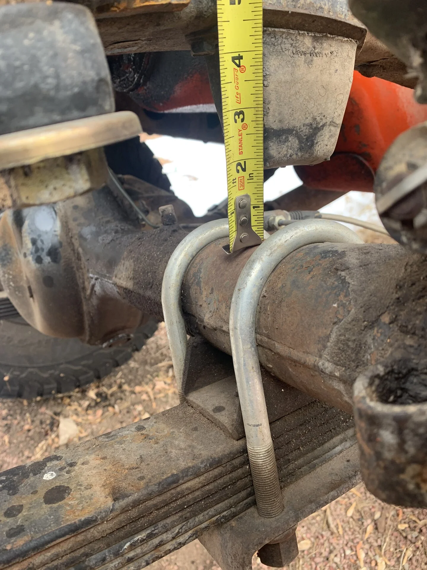

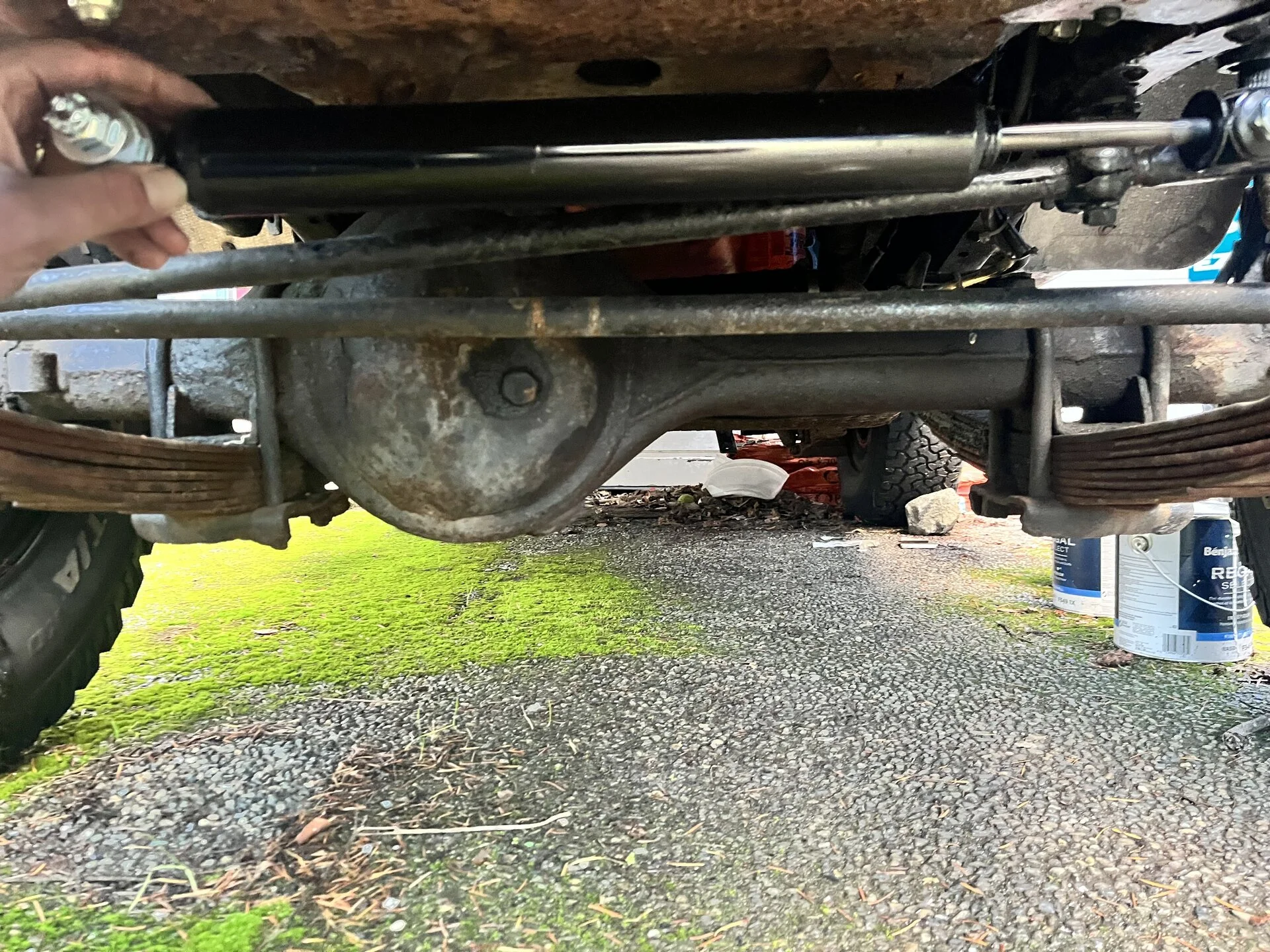

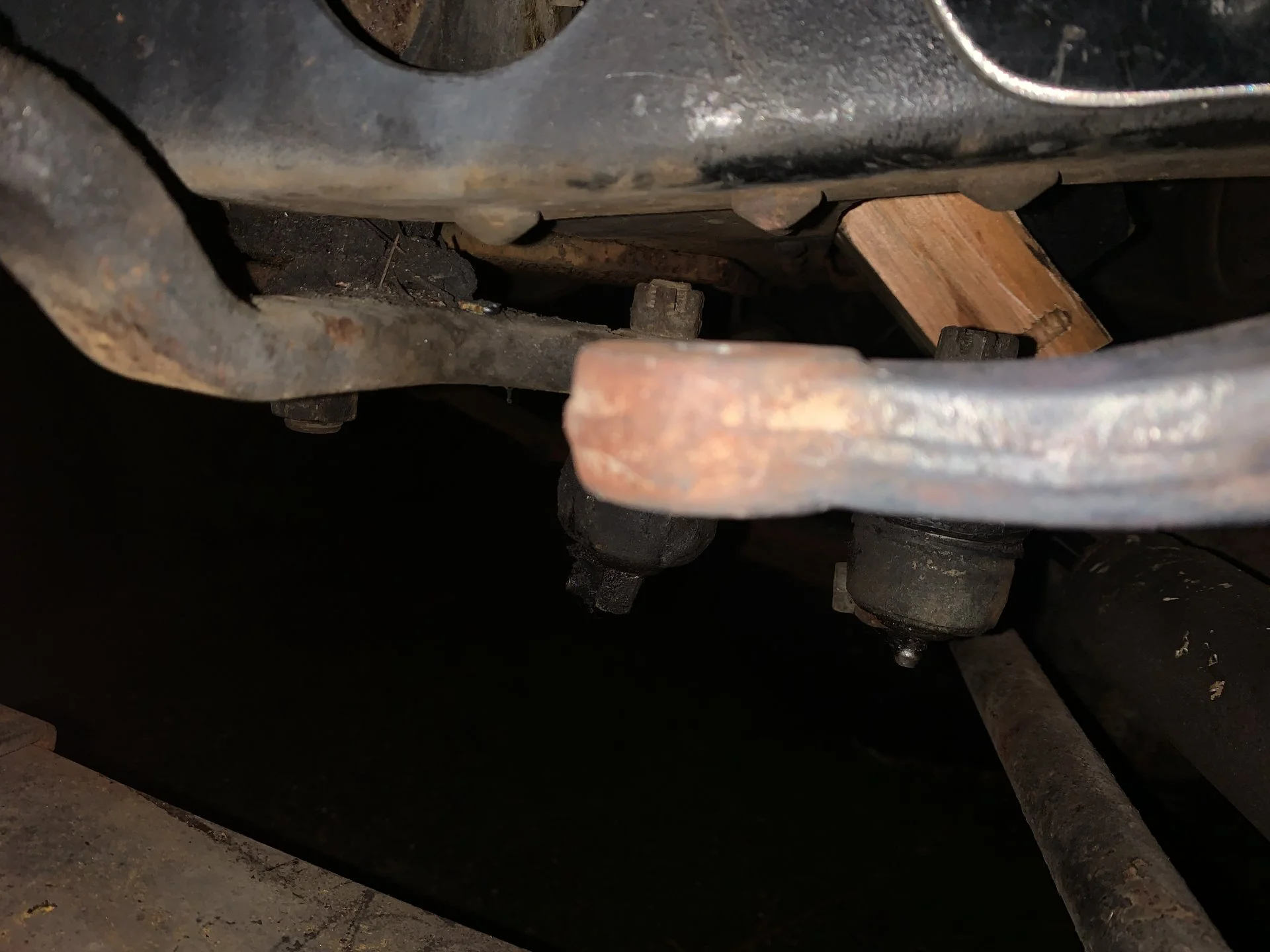

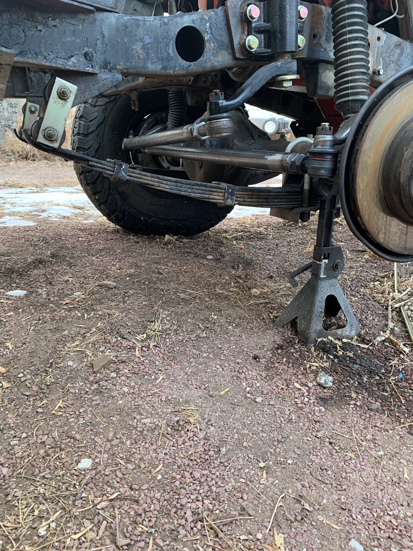

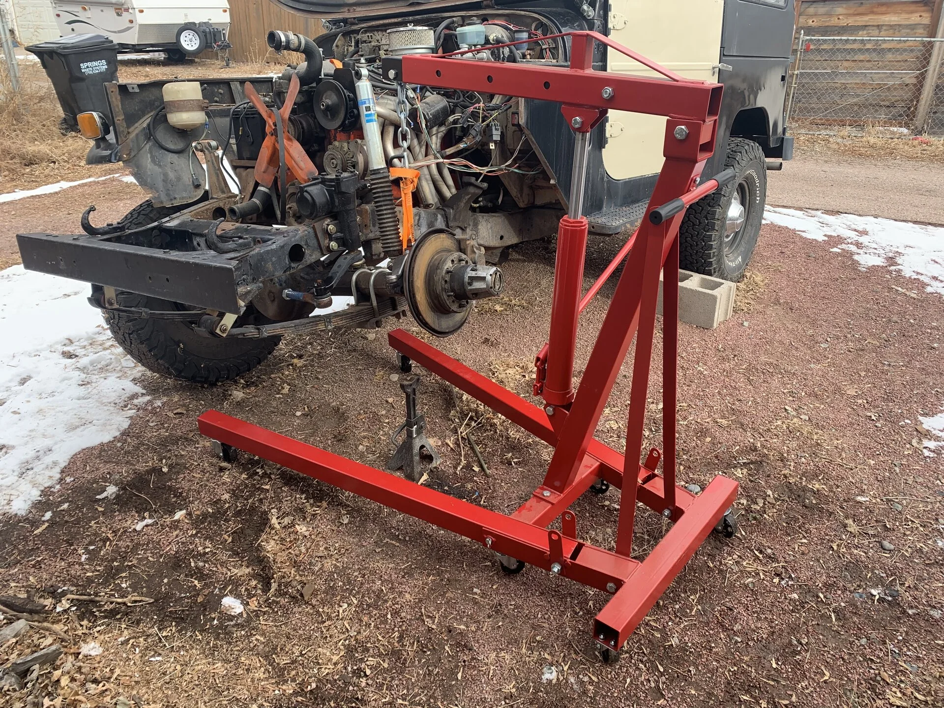

Ok flexperts- I tried my best to test front axle articulation to look at clearance on my pitman arm and the leaf spring. I used an engine hoist to lift the front driver side till the front passenger side came off the ground. There was still about 2in between the axle and bump stop on the drivers side. Am I correct in think this is as much flex as there will be? I’d assume if I lifted under the wheel that would put slightly more leverage on the axle but still the front passenger side tire was off the ground. In short- is my pitman arm clearance ok based on this test?
Pics for reference:
It will have enough to hit that bump stop with full weight transferring in twisty situations.
Got the linkage finished up today. Probably should have left the drag link an inch shorter for more adjustment, but but this the right length, just barely. Word to the future linkage builders- control your heat on the inserts. It’s SO easy to distort the threads. I had to run a tap through all but one end. Very pleased with it and how sturdy it feels. Will paint everything at once when it warms up.

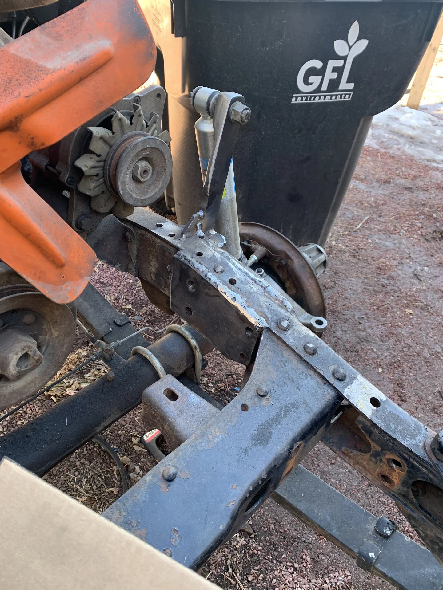

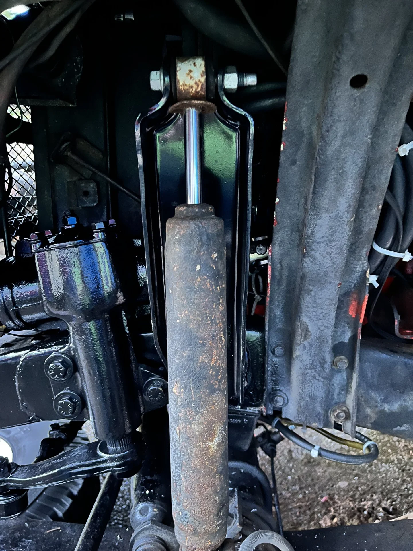

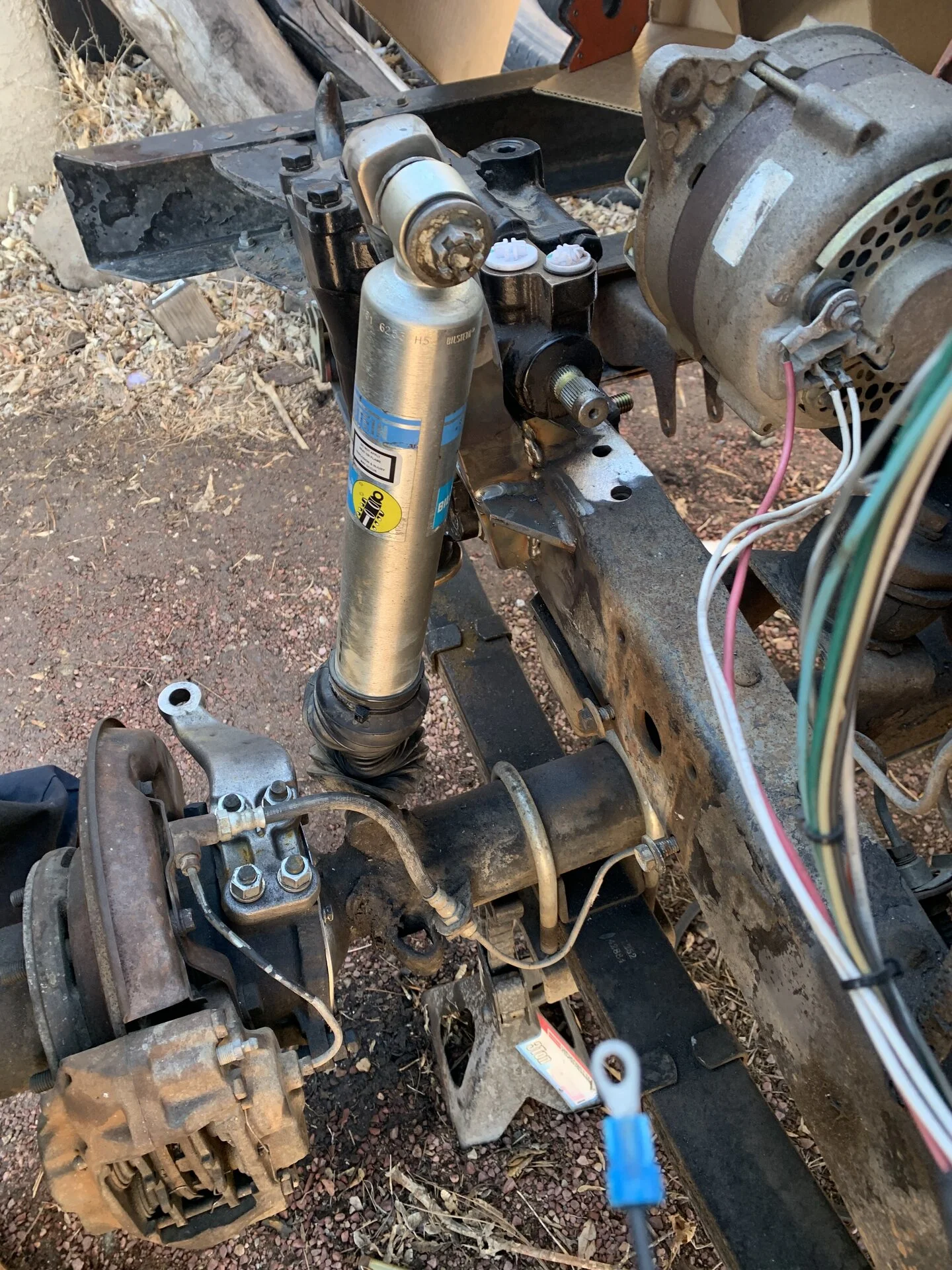

Made some more progress today. Finished up the new shock mount. Ended up using a 1.5in by 1/2in thick bar trimmed and gusseted to the frame to mimic the stock hanger but clearanced for the new steering box. Welding outside with the slightest breeze makes my welds look like crap, so really looking forward to getting my new shop built.

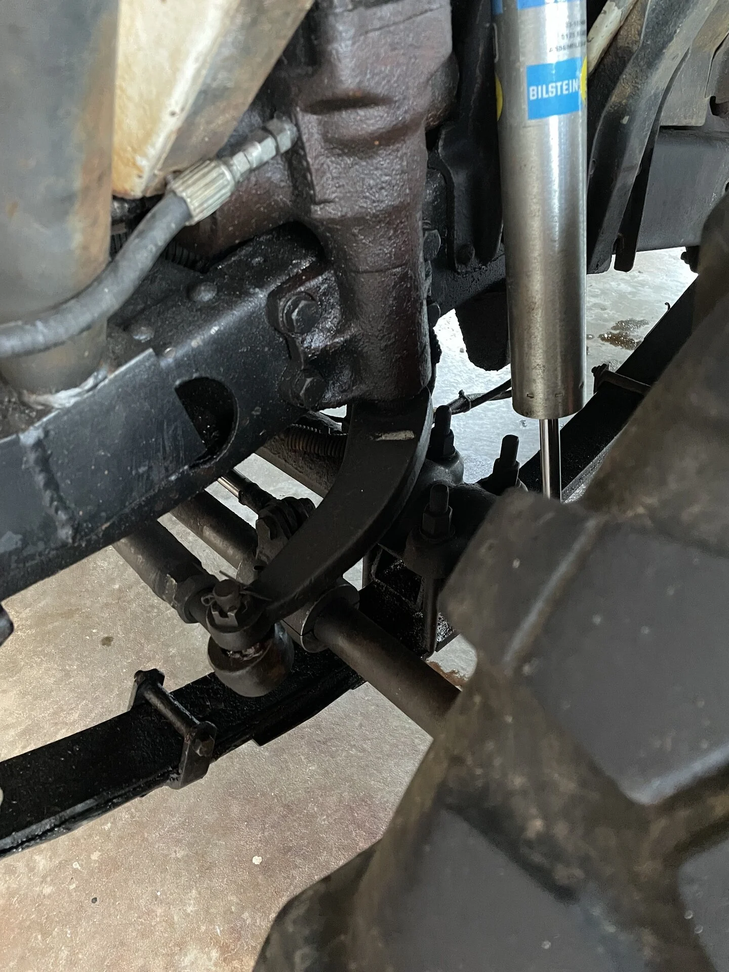

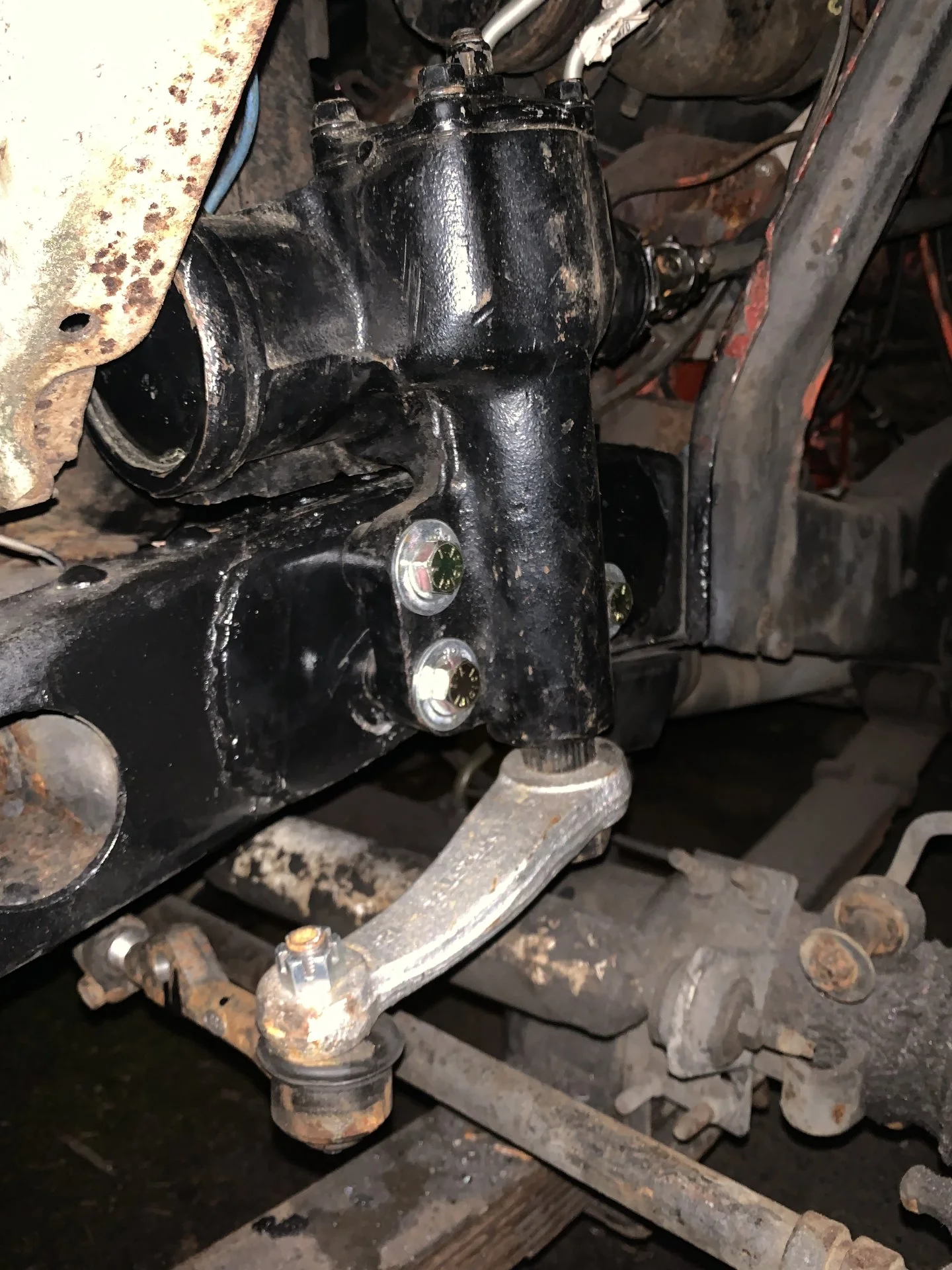

I've done a very similar conversion using a Scout II steering box. I had the same debate but ultimately chose to use a flatter pitman arm. There's a decent amount of clearance for the nut. Although there potentially could be some bump steer, it is at essentially the same height as the OEM bel crank would have put the TRE. Based on initial test drives it hasn't been an issue.
These pictures are going back a ways. The most recent is with a new "60 Series" steering stabilizer installed. Since then the front end has been swapped out and castor shims were added. The original spring plates are showing signs of 20 years of wheeling.

yeah ultimately I decided that I'm just going to extend my bump stop 1.5in. It probably needs to be done anyways since I have a 2-4in lift on it (previous owner installed). Plus I'm not going to rock crawl it, so more articulation isn't needed.

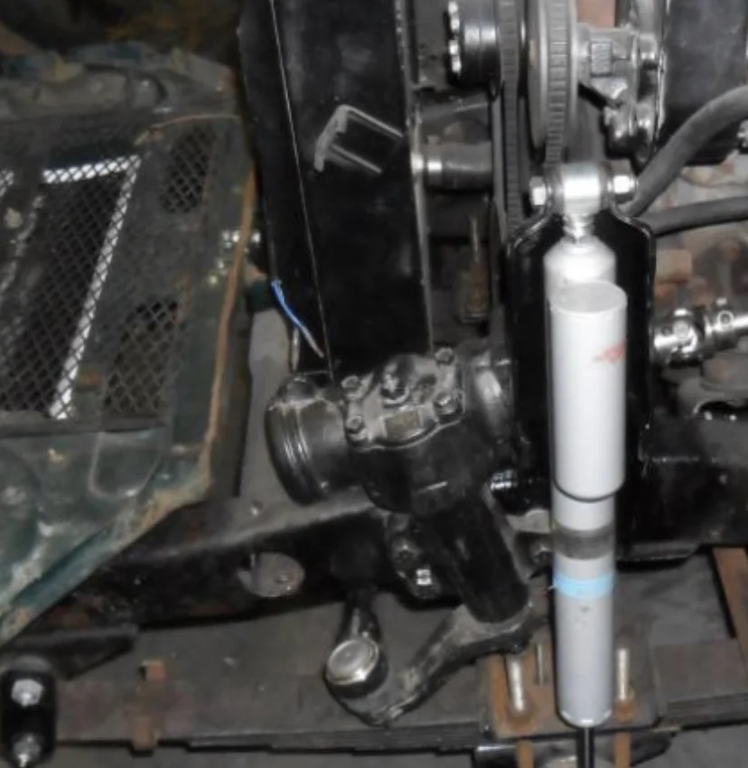

That Scout II box sure is a nicer smaller size than the 80 box I used. The girth of the 80 box really made the shock tower a tricky problem to solve! I went back and forth on a few ideas before settling with what I made.
Overall I don’t think Scout boxes are smaller. The dimensions are different, but very similar overall. Its a full size Saginaw box that results in one finger (or palm) steering that feels right.
Not that size really matters… I just wouldn’t want someone to hunt one down and discover it’s not much different.
