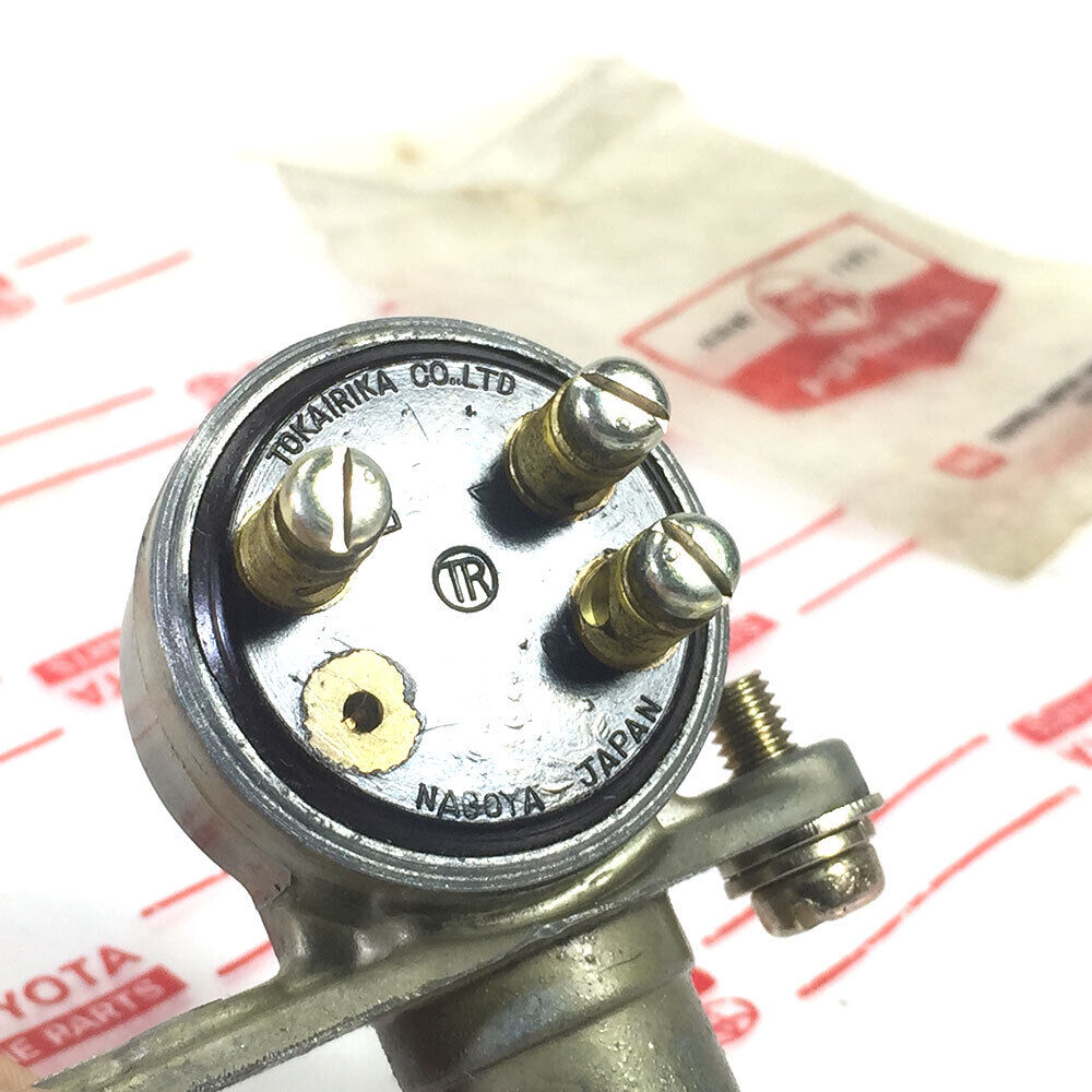

floor dimmers are long since DISC. / NLA
there are 100% COUTERFIET retro looking ones on EBAY , from all over it seams ?
so be careful there
i do not have any at the moment

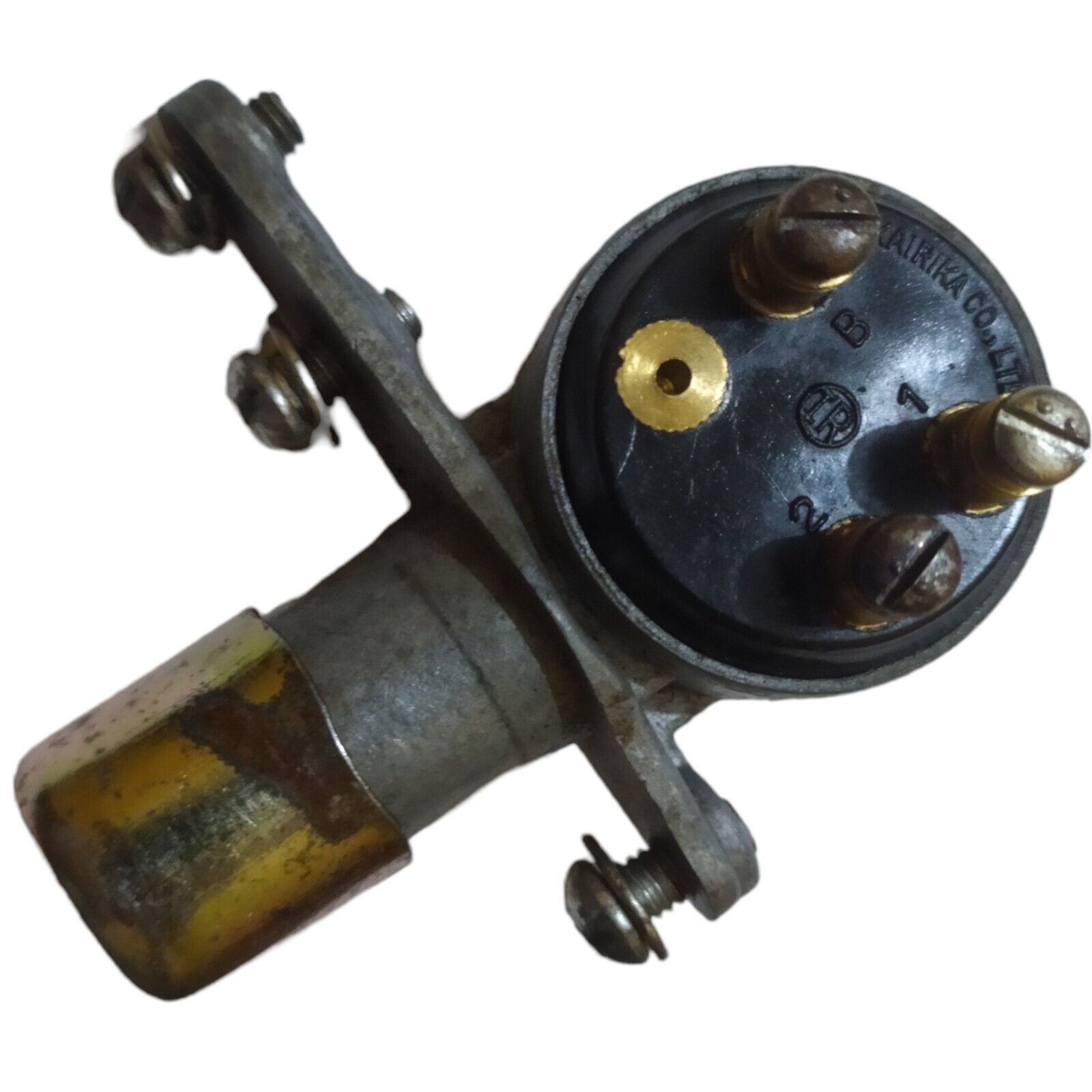

ALL these links are the counterfeit ones
i know because i got burned over the summer :confused:
they all have a shinny gold bumper part cap ,
all have 3 screws too , TOYOTA or TR company NEVER came with 3 screws :mad:
the TR in the circle is really a IR
retro tru-counterfiets
LOOK CLOSLEY the
IR in the middle ...........

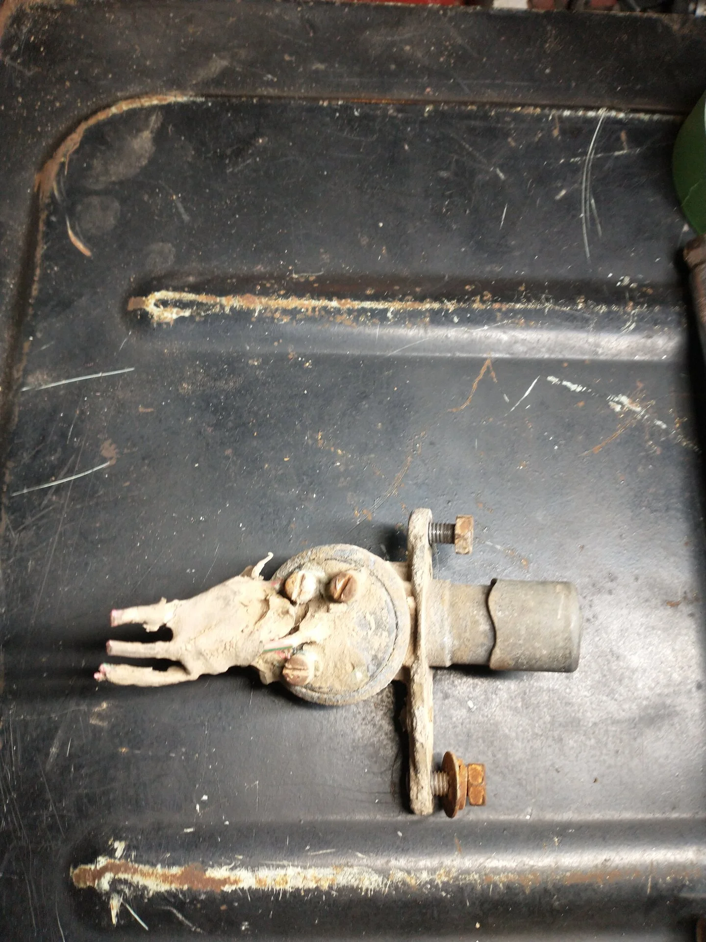

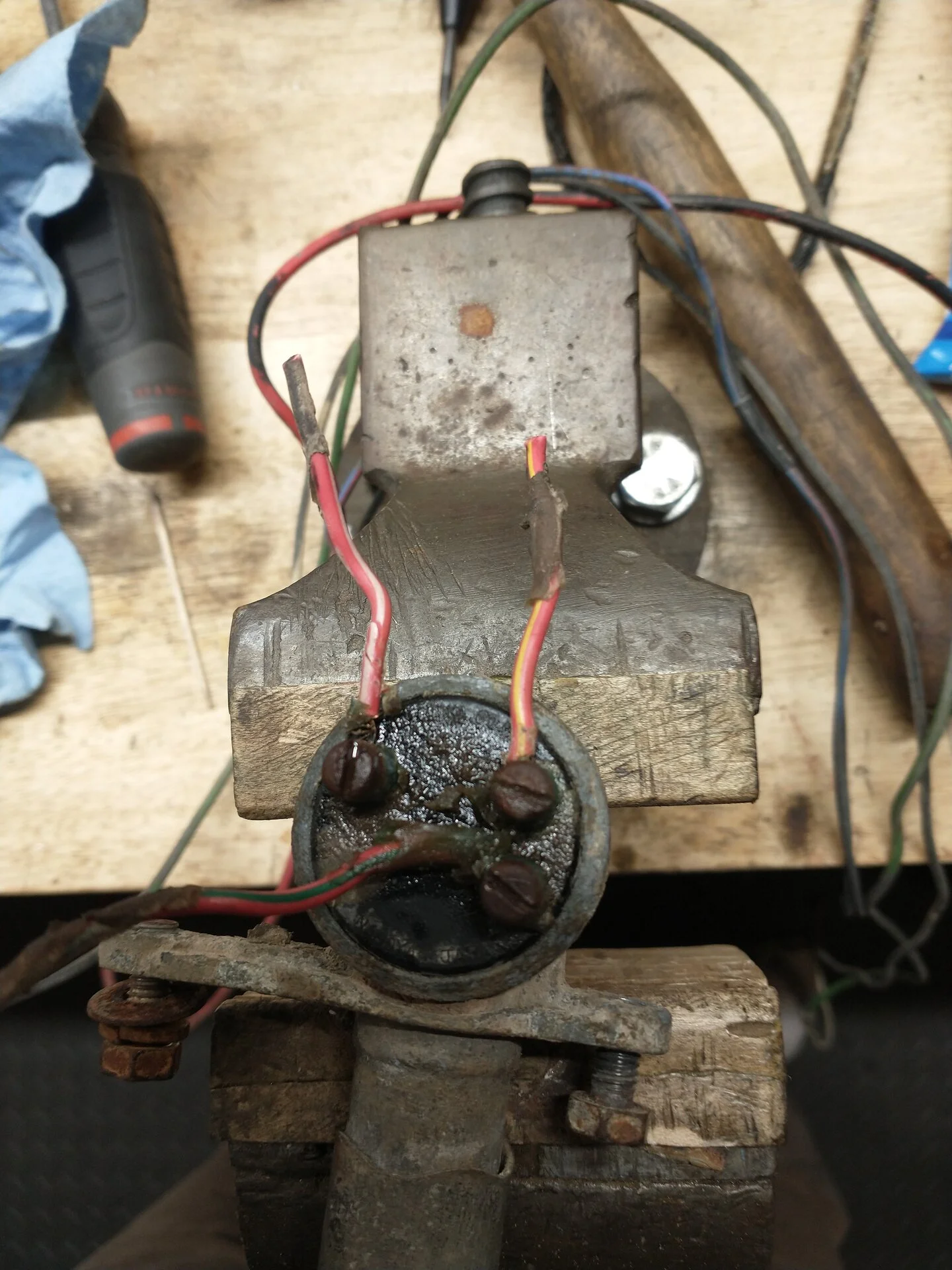

I used this Fuse Box & Cover from City Racer. The dimmer switch I drilled a little hole in the bottom and sprayed it with contact cleaner and worked it back and forth when it quite working.
Other than rusting solid, I've never seen a foot dimmer fail in any of my vintage vehicles. Is it advisable to get one just in case?
Mine would not switch, after spraying it with contact cleaner it works fine. Not worth rat holing that part to me.

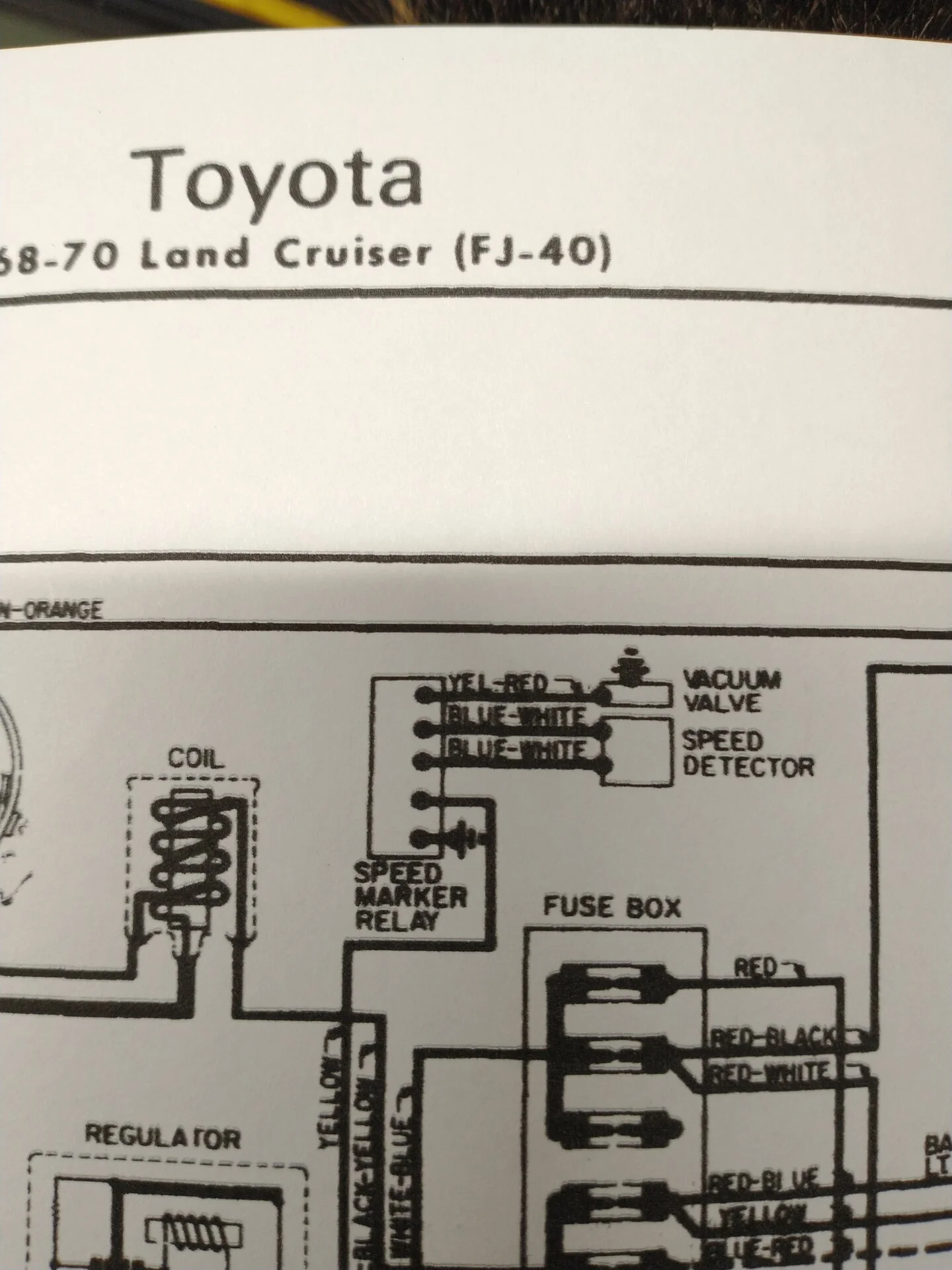

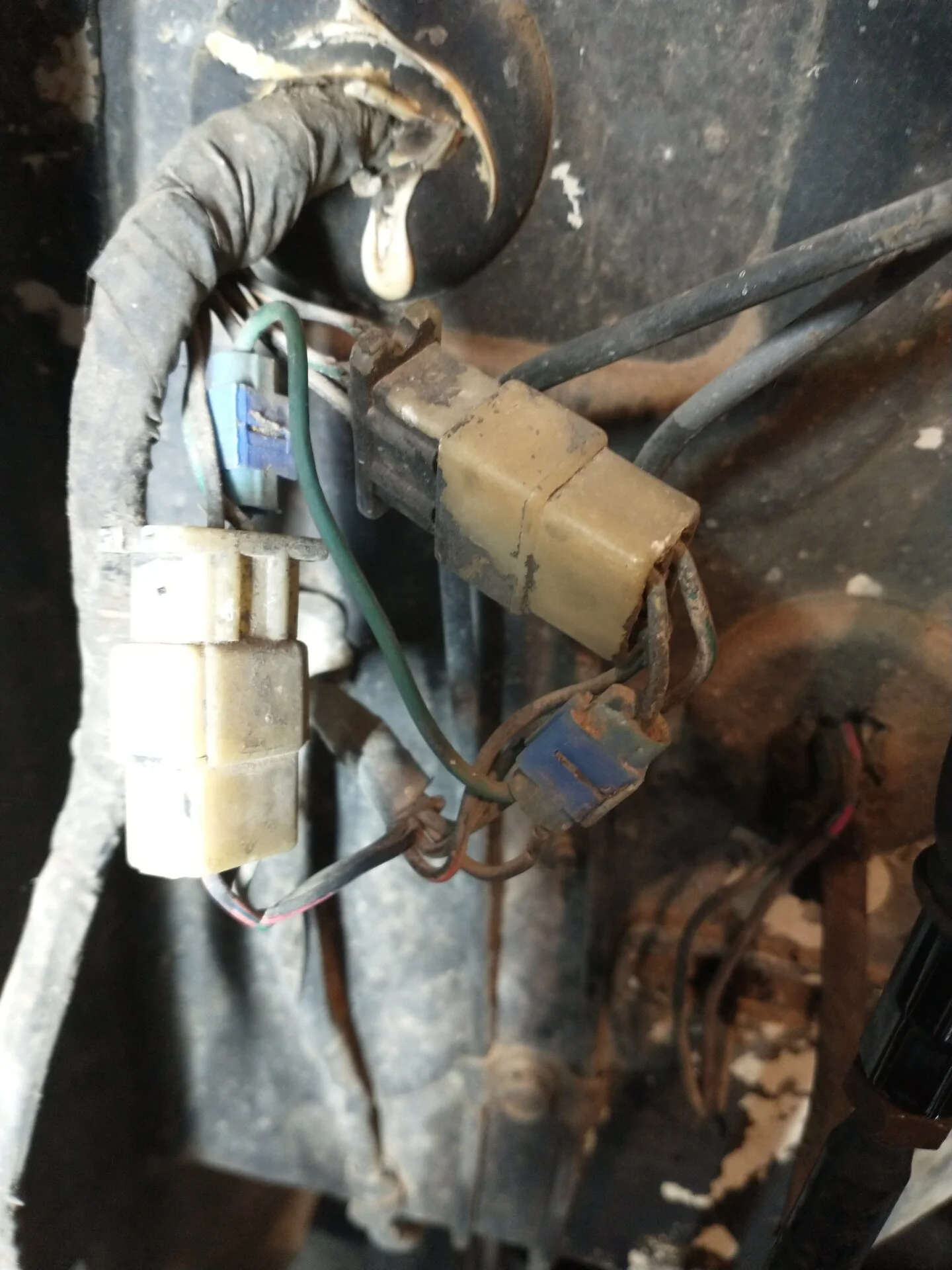

The speedmarker detector is inline with speedo cable-has 2 wires at approx 10" away from speedo cable end (at TC) which then go to the relay (firewall) then to the VSV (vacuum switch valve)-drivers fender. Not part of TC but emissions/distributor retard function.
