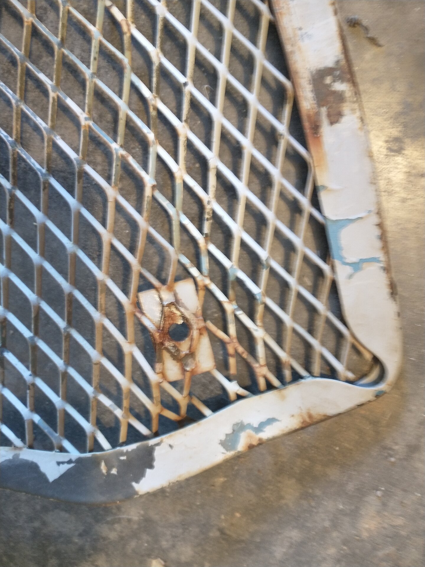

Just noticed something off. So I fixed it. Mig welded the broken bits of grill and shot it with some black paint.
