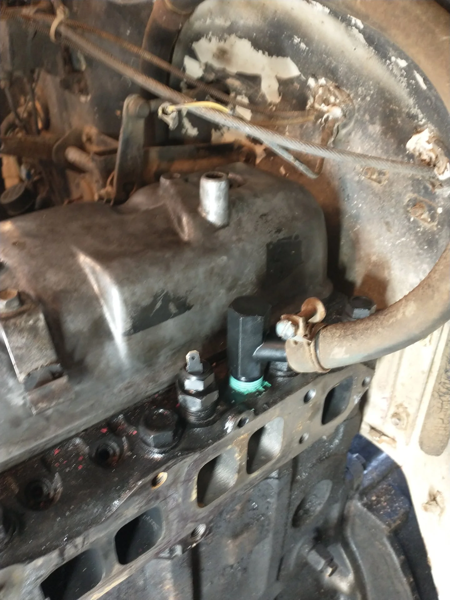

I had to install a barbed fitting into my fuel filter housing and new fuel line to run this pump on my 69.
I didn’t try too hard after initially stripping that barbed fitting, to remove it.
The pump that was on the 1F I removed had the same fittings as this one so I think I'm good

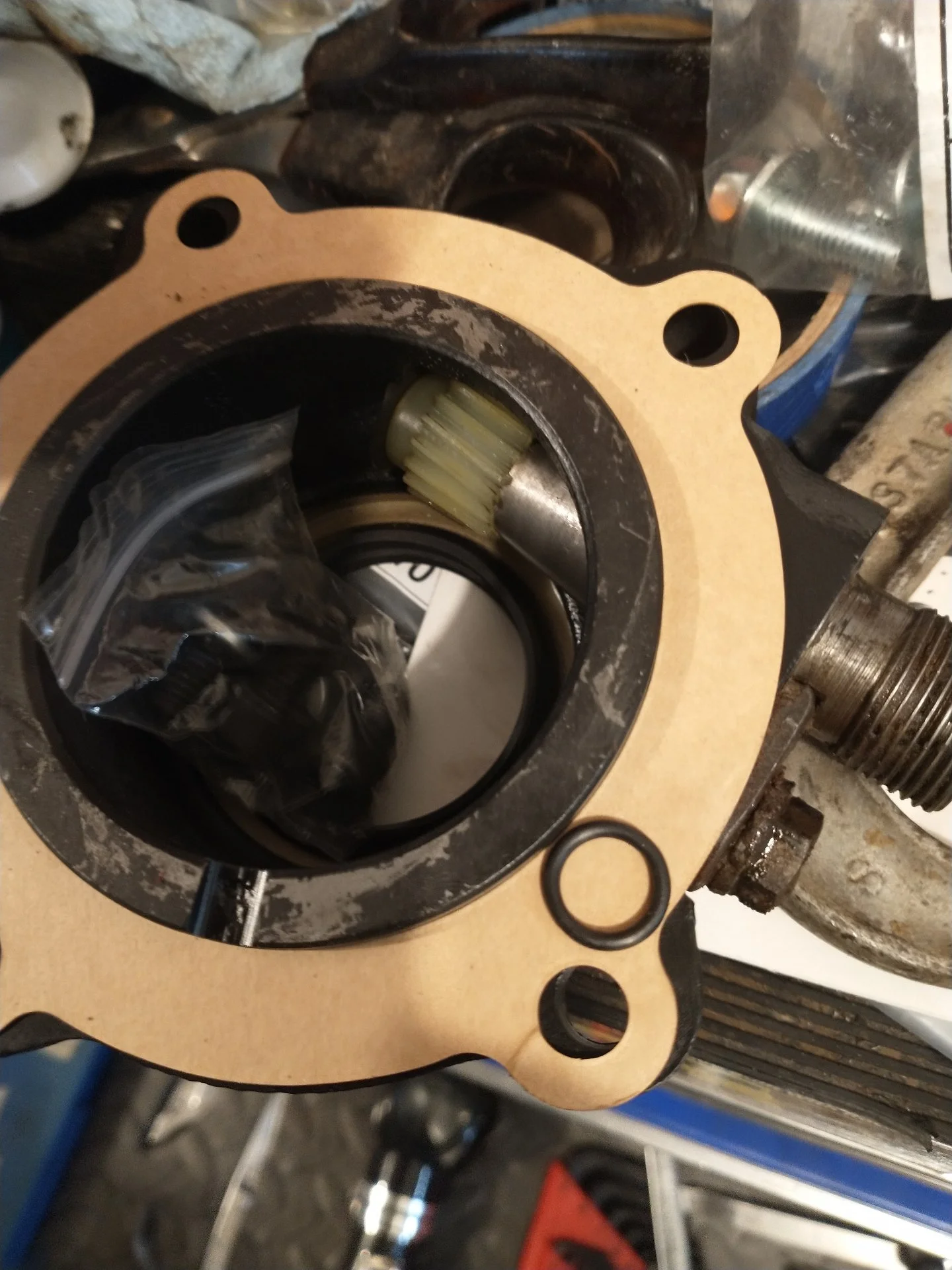

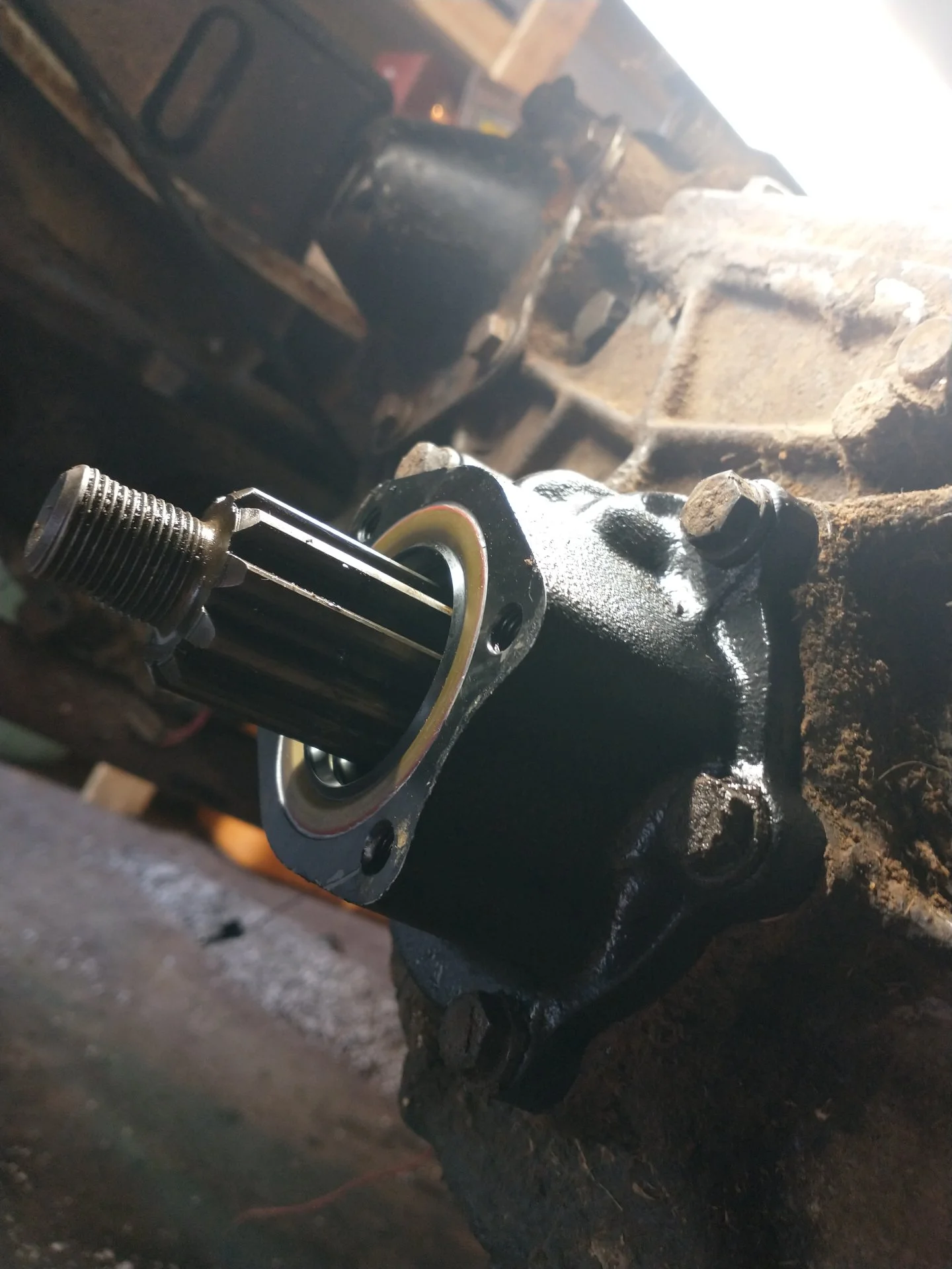

You're seeing the wear from a single seal.
That's good to know.
I may end up just putting another single seal in there and replacing it if it leaks. In the grand scheme of things, it's not that big of a deal to drop the rear prop shaft and disconnect the parking brake assembly again if necessary.
I am looking for this mythical double seal housing in the meantime.
Call Georg, @orangefj45 I think he was making them. There's a thread here somewhere.
Yup that’s me.
We have the kits in stock. Happy to help.

Ordered the kit, and received a USPS shipping notification less than 30 min later.
Dang. Instead of this part sometime in the distant future and having to wait for it, I gotta hurry up and get other things done so I'll be ready to install it when it arrives.
Started to reassemble stuff.
The kit came with a non castle nut, and I left that off because I don't trust them in place of castle nuts. It's Sunday and didn't care to buy a new cotter pin, so will do it tomorrow.
The best part about the kit is that they replaced the 12mm hex nuts with hex screws. Lot easier to tighten and loosen with the parking brake in the way
