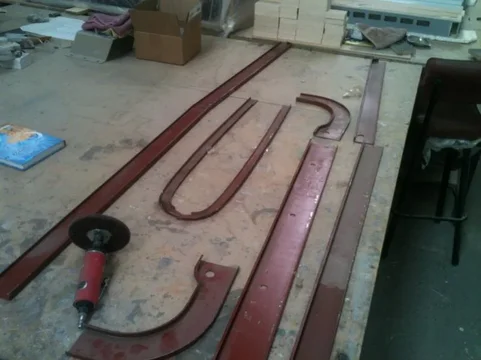

I start to clean the fiber top, and first time(15 years ago) I jus put a metal rain gutter home made hold with aluminium pop rivets, and fill with a lots of poliester resin.
Now like 1 year ago I got the southboston rain guter , and start cleaning all resin until to reach the original one,
It takeme all sunday morning and I get realy tired!!!
I try to put together the rain gutter under the top and I thing rain guter is so big , do I need to cut it to mach in the top fiber?
My gutter kit was also a little big. I trimmed a couple of the pieces that were flat (not the middle joint that is angled). I also had my old gutter for a template. I laid it on the garage floor and traced the inside edge with sidewalk chalk then laid the new pieces on those lines and trimmed/welded it up. Cap dropped right in then drilled holes for rivets and seam sealed everything.
Ok thanks, I was wondering that , so my original raingutter was piket out long time ago and the lates One I made on the hard top sides mounted on the car, at this point without a jig Im going to do that agen and ai just need the popout dimension from the side panels to the etch of the raingutter and fill the gap with seam seler has you did
Thanks agen!
this is what you mean, and the trim that you did went to the rear part to??
That looks wrong... Is that your trim in the pic?
