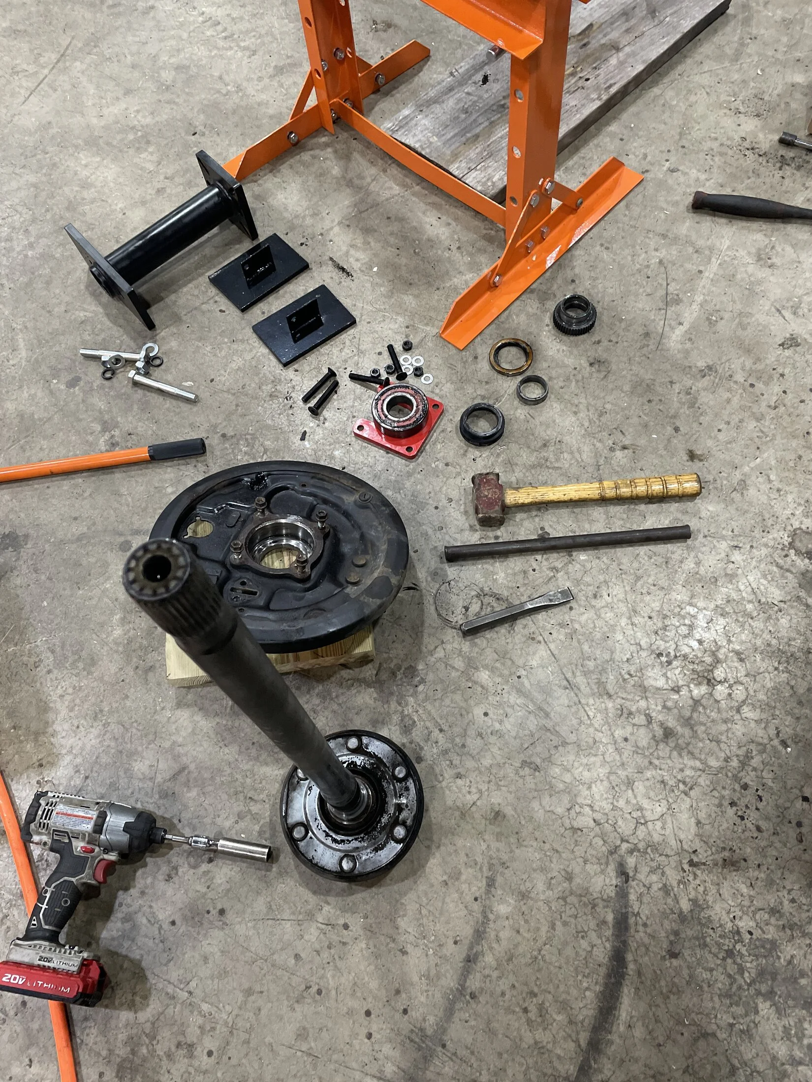

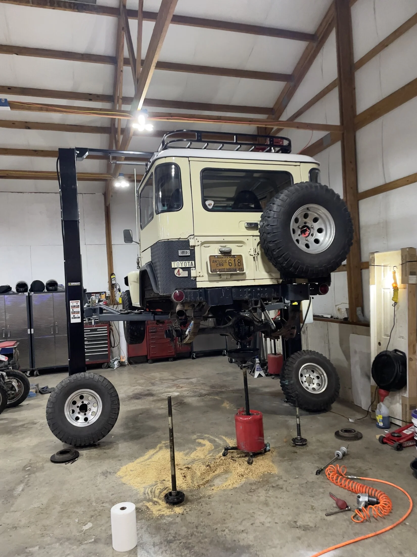

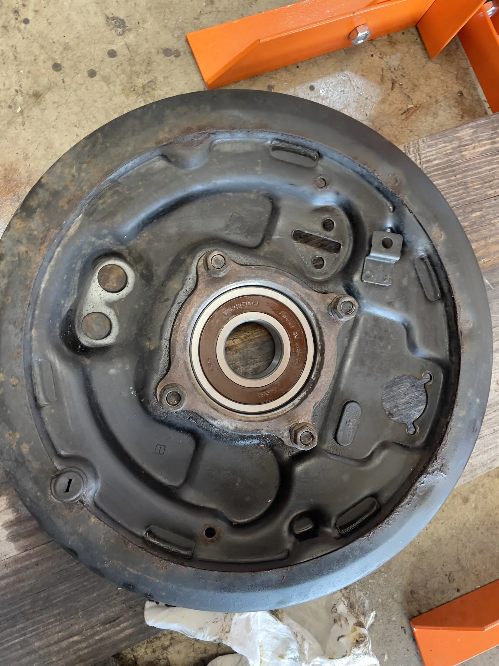

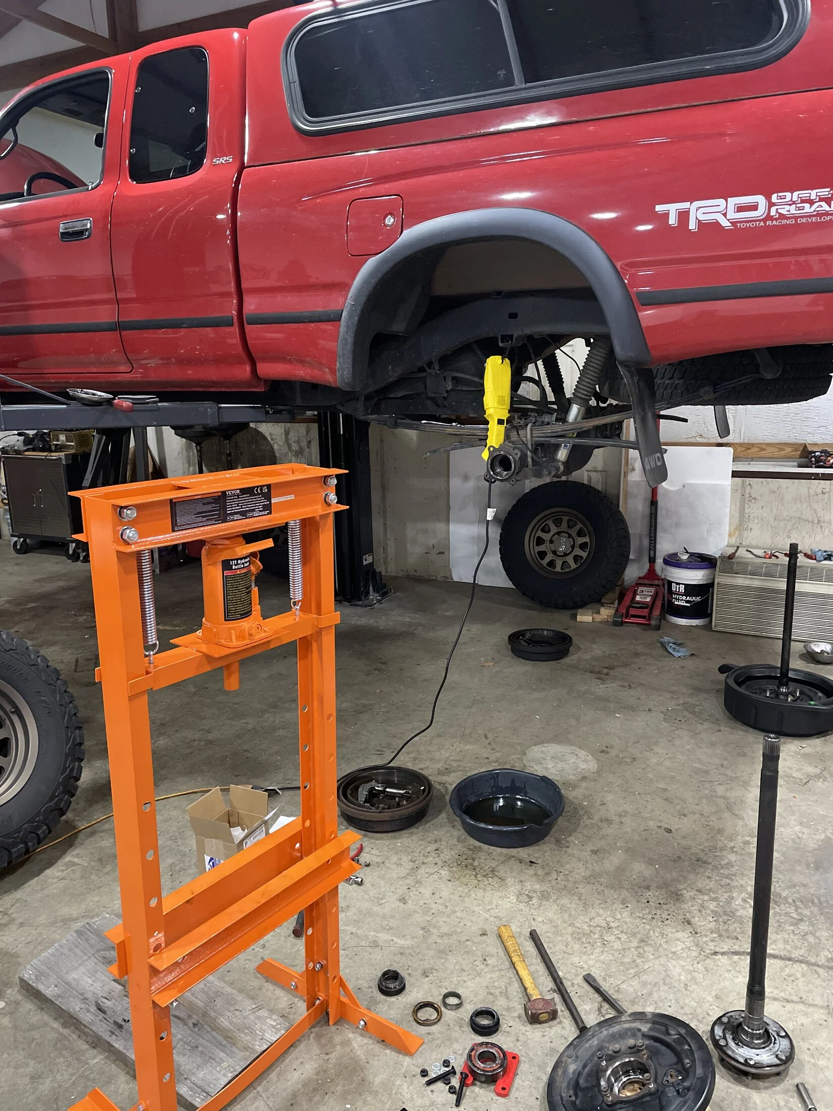

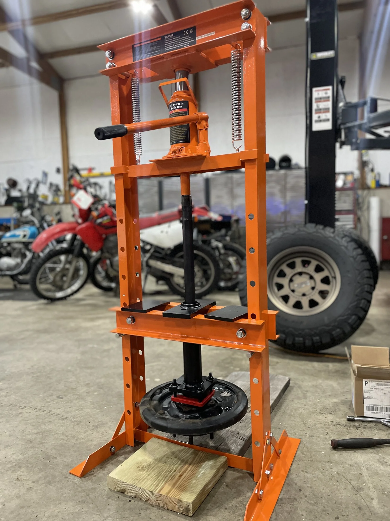

Apparently I said on here on Januaruy 2023 that I was going to replace an axle seal on the cruiser.....It took a while but I got to it back in the spring....it was wheel bearing and Axle seal season...did both rear bearings on the Tacoma, and did both on the cruiser as well. Got the Koyo bearing and seal kit and cleaned all the gear oil off of everything. Most of these pics are doing the Tacoma because it took a press and the jig to pull the ABS tone ring and bearings (on a non-ABS truck). but it was useful for the Cruiser too, because I used it to pull the races off the axles for the Cruiser.

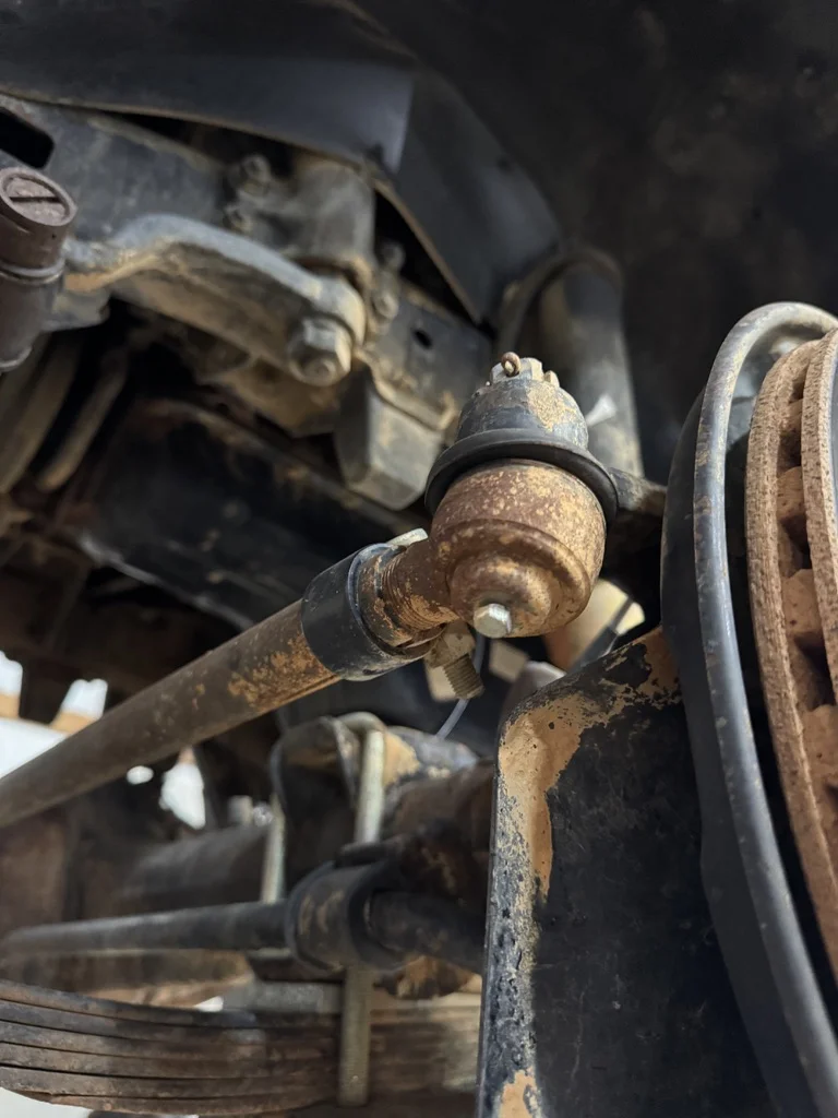

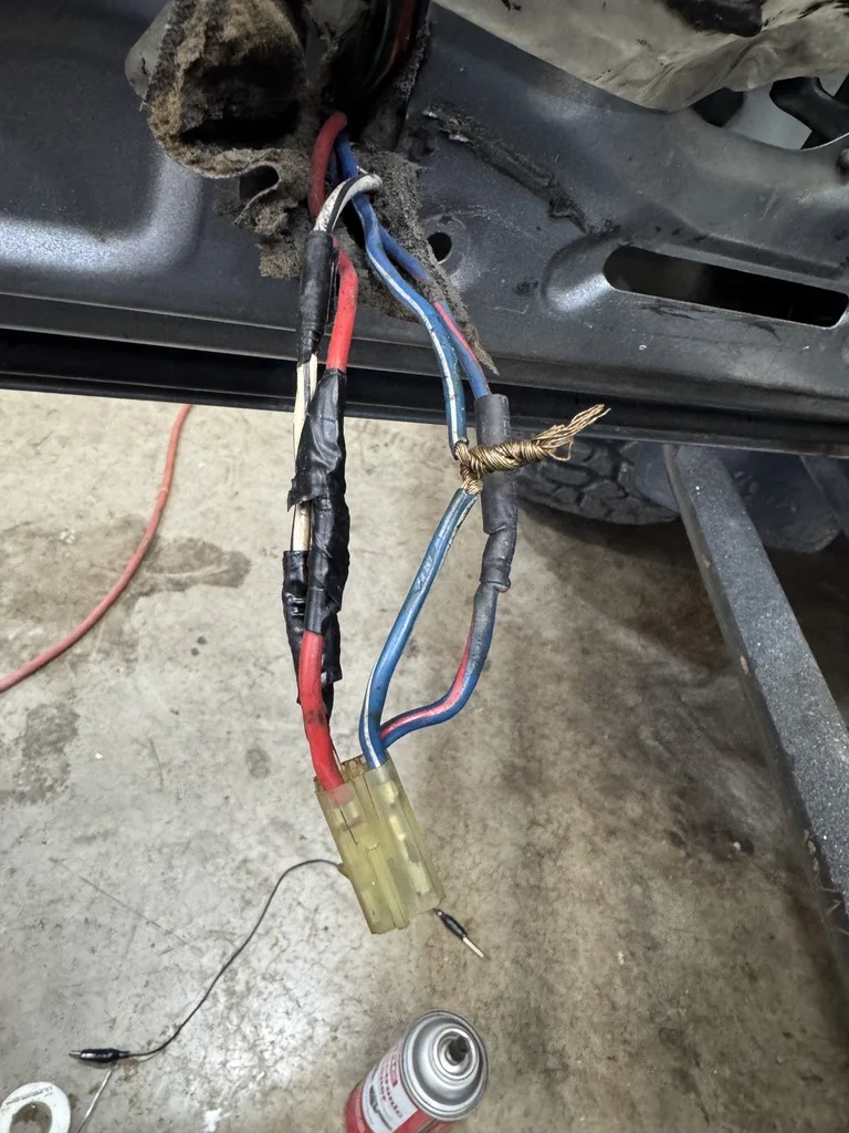

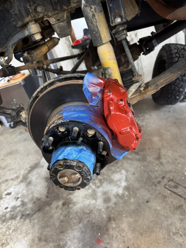

Probably gonna have to start another thread on here somewhere...... Just bought a 1990 FJ62, it was 2.5hrs away and really clean. California Cruiser with a clean frame and body. H55 swapped with a Twin Stick kit, some ARB bolt-ons and OME lift, whats not to like about it...Did some digging today and fixed some interior wiring today that was hacked up and balled up (door lock actuators and windows), and put some Grease Zerks on the Tierod ends (they were empty and capped) , put a Hex magnetic fill plug on the rear Diff and Checked all the gear oil, found some low oil in the transfer case, gonna keep an eye on it. Also put some quick paint on the calipers and hubs after removing the surgace rust. Overall happy with it having virtually no rust on the frame and body and a clean paint job.

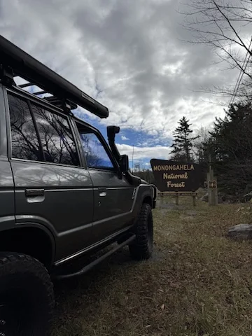

Had a day off work, so I figured I'd drive the 62 up to some trout streams and see how it pulled on the hills. Did great, loved driving it, got some cool shots and even some fish. Met @fjman in his sweet FJ60 while I was in town!
