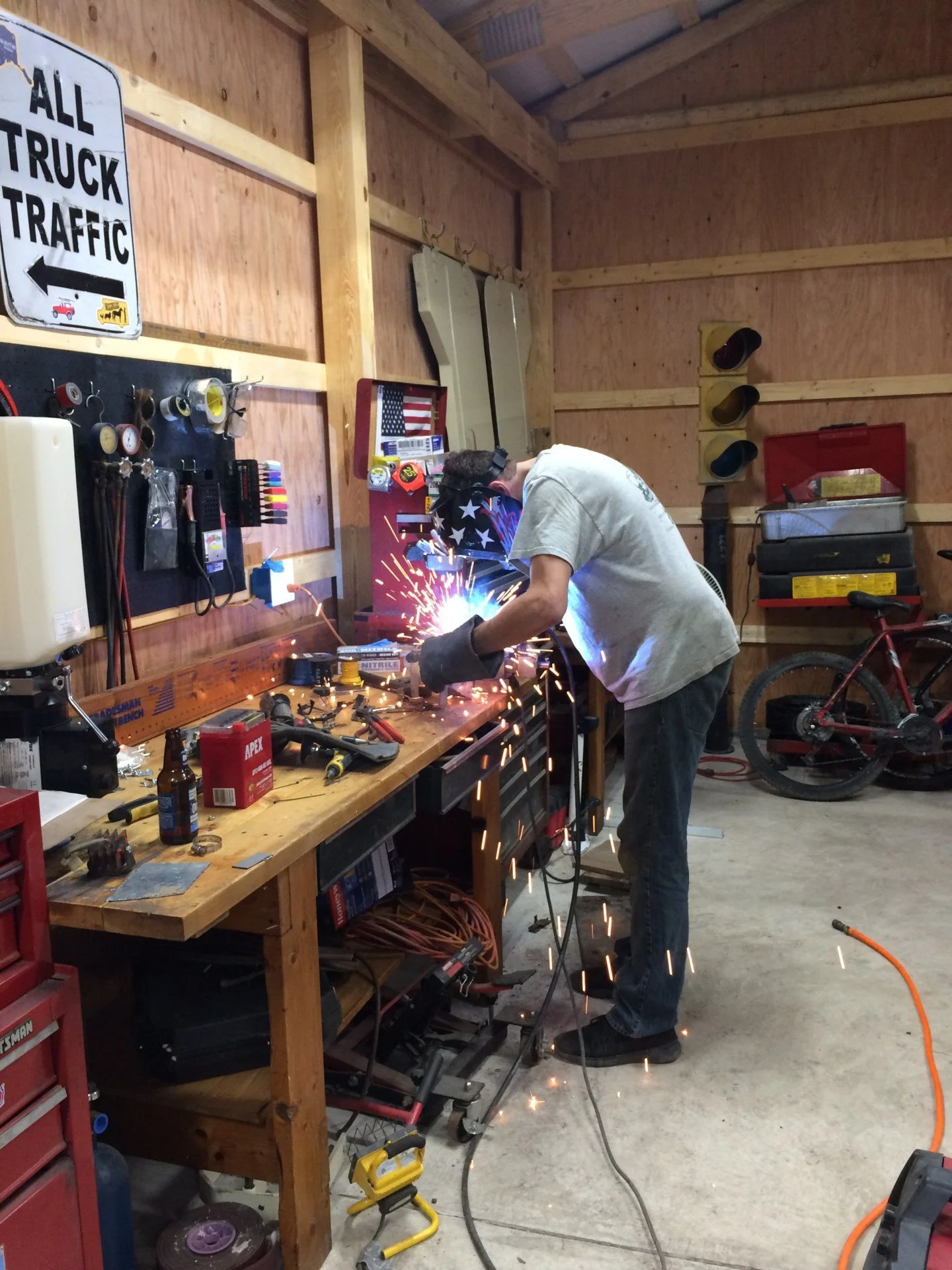

In the welding shot you can see the way I hung my half doors with some extra conduit clamps I got while running the electric to the garage!

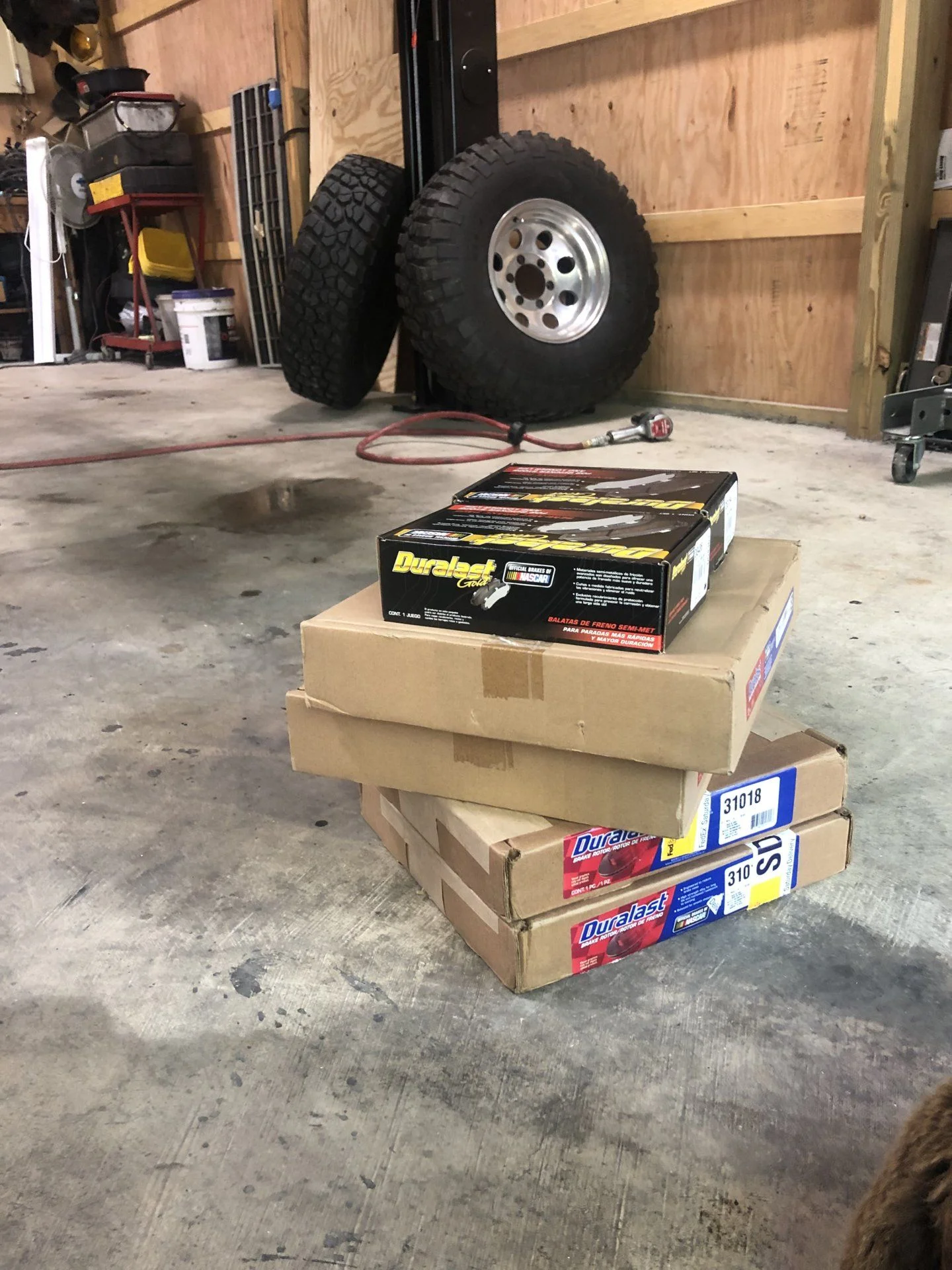

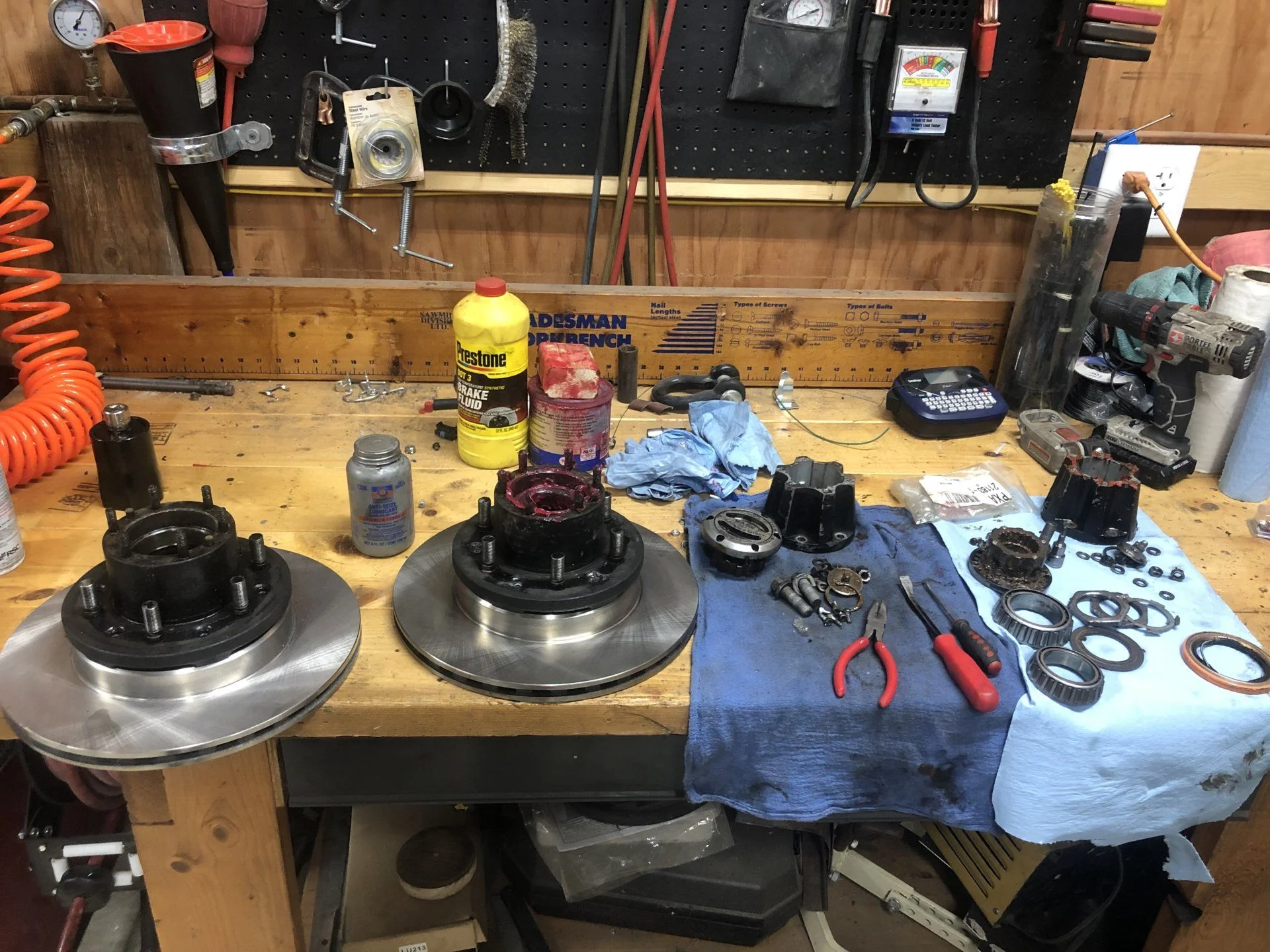

For my birthday I decided to knock out a brake job on the cruiser. I’ve had an issue with getting the rear/ front brake equalizer set correctly, which has led to some severely warped rotors. It would appear that because I used Loaded Calipers (from Rock Auto) when I upgraded the front axle to ‘88 4Runner calipers, and I then purchased the JTOutfitters rear disc conversion (w/ loaded calipers) I had two different types of pad material. I’m thinking this had something to do with it. I’m going to purge and bleed the lines really good and see how she does. I had to repack the wheel bearings as they appear to have seen some water. I’m excited to finally have good brakes.

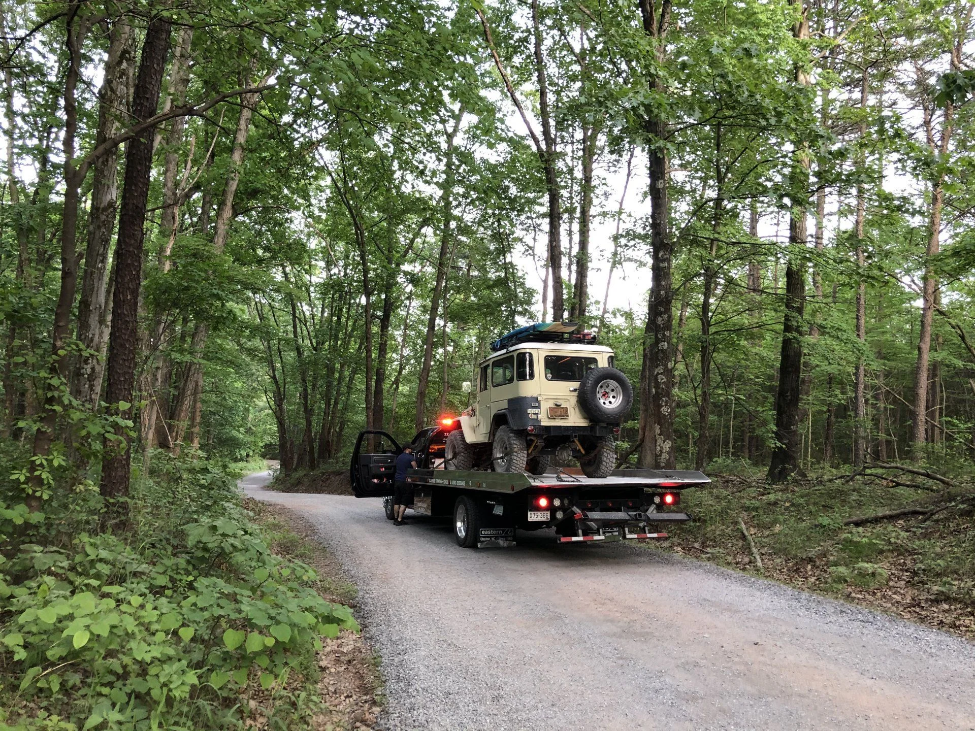

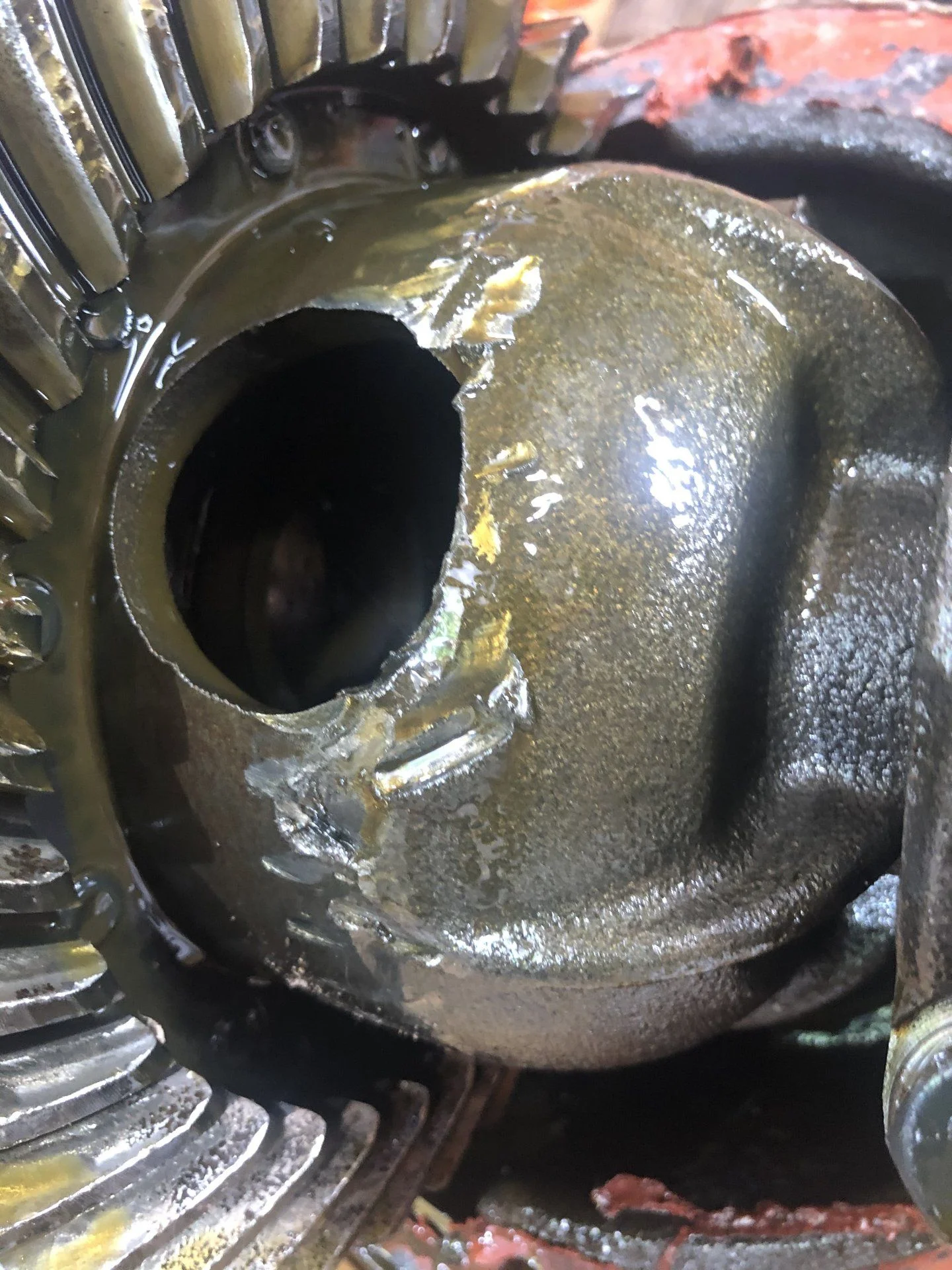

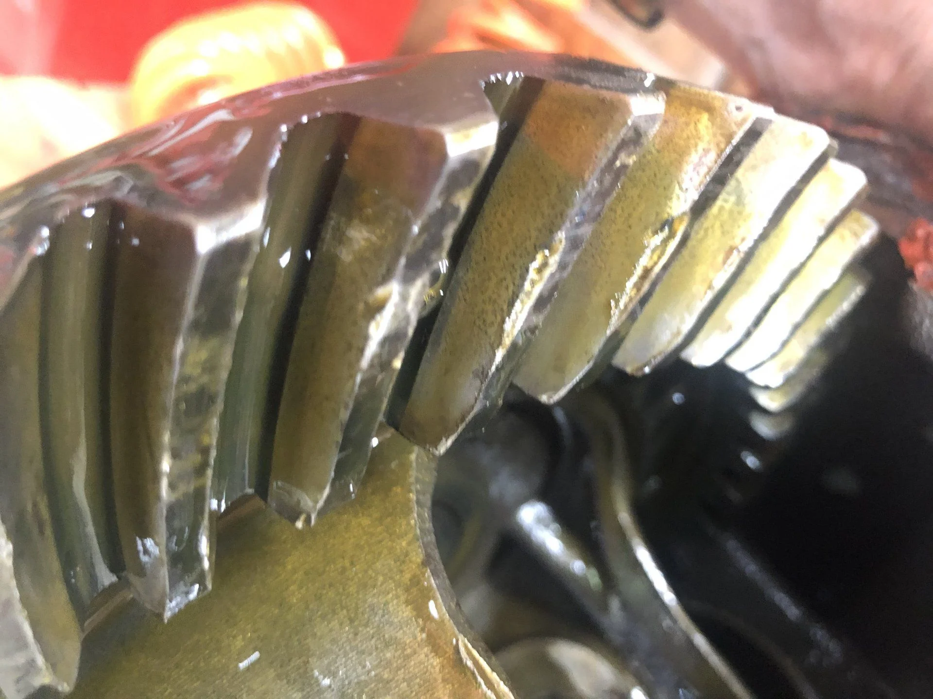

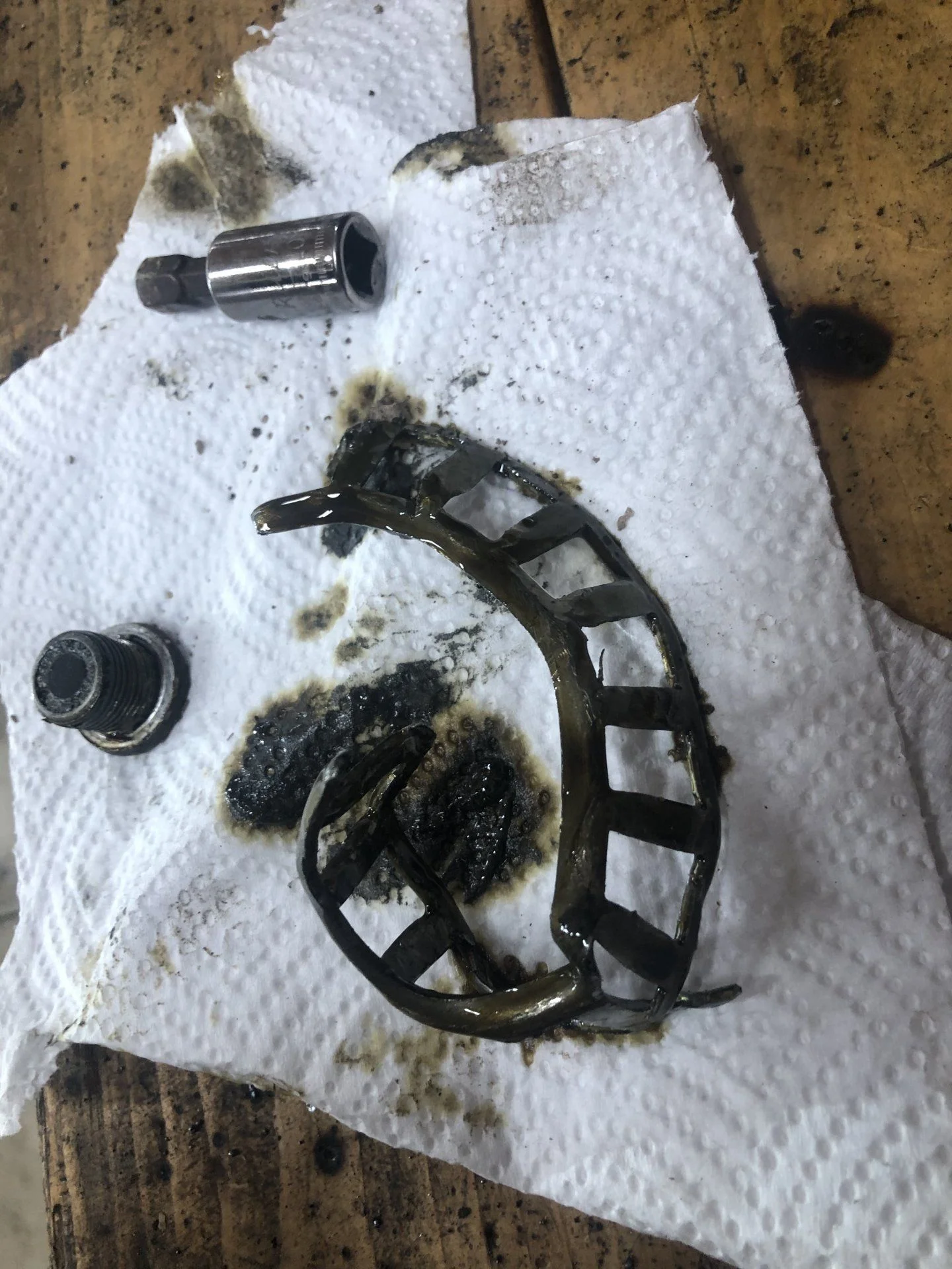

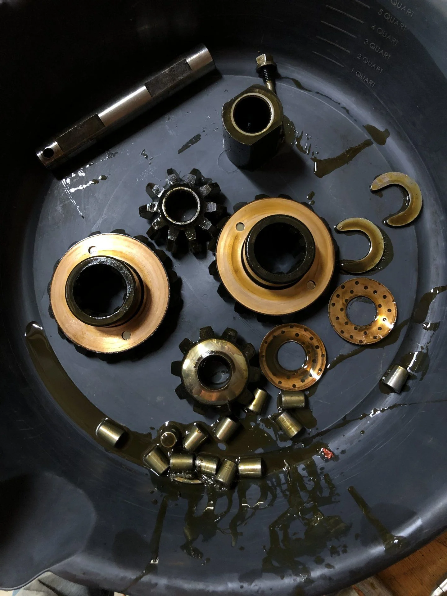

With very little vibration, noise, and notice, I was coasting down a long gravel road ( down the side of a mountain) and my back tires locked up. What I initially thought was a sheared pinion shaft turned out to be my pinion nut backing off and wedging in the carrier. I finally got the driveshaft off and the pinion nut back on while I was waiting for a tow truck. My roadside assistance covered the tow back to my house, which was nice!

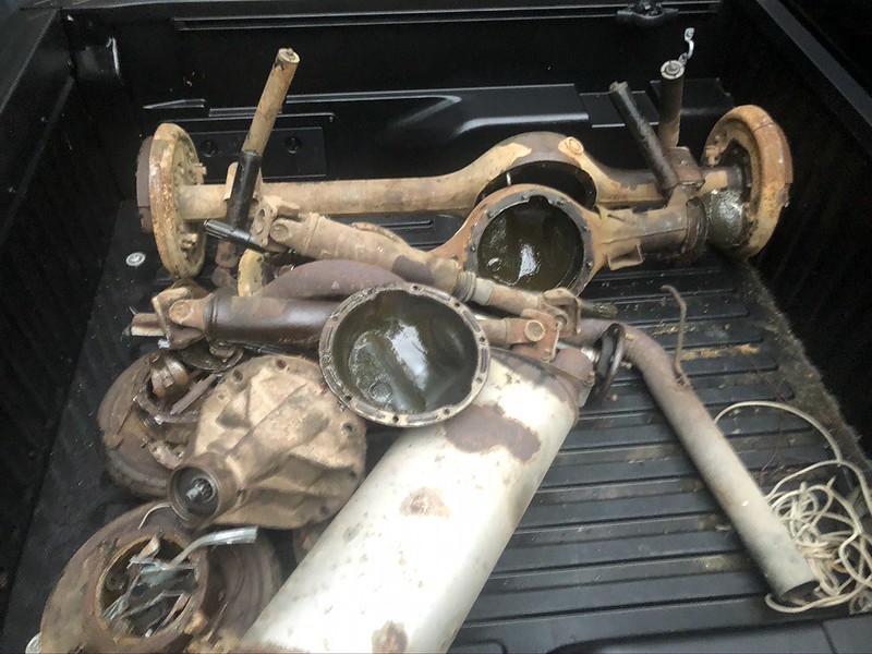

I was able to pull the 3rd today and get a look at everything.. I have been pricing the whole set up and it looks like I am going to need it....
My gears already had a fair amount of rust on them from sitting and the ring gear has some damage from the pinion hitting it. One of the pinion bearings is destroyed and the Carrier has a decent amount of damage from everything. I also confirmed have coarse spline axles which I am hoping I can replace in the process.....

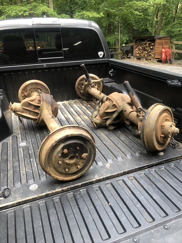

Once again, I have been bad about updating everyone on my cruiser!!! I got the rear back together in June and it is running strong, I also saved the front 3rd for another time when I have energy to break down the birfs again and swap it out. I know my front ring gear doesn't look great, from when I bought it years ago....

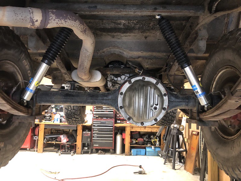

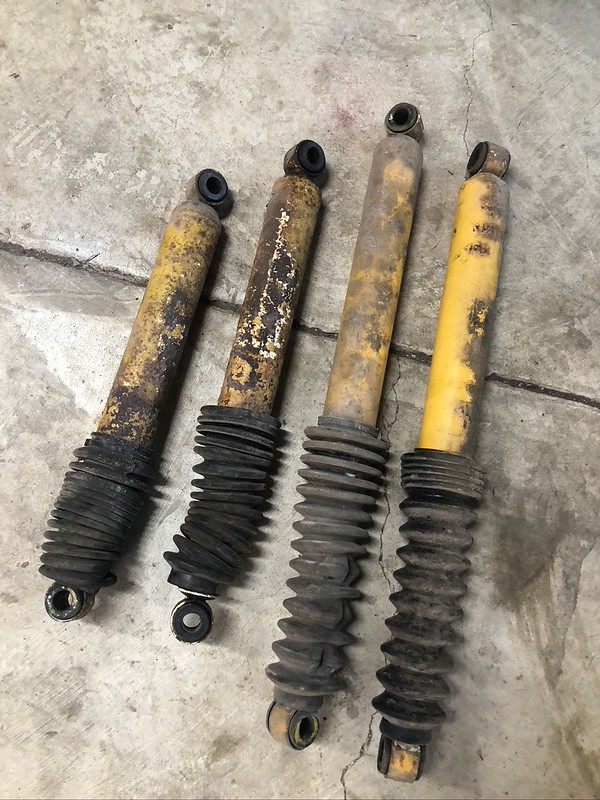

I picked up a set of axles on FB marketplace for around $200 I think...They are early ball and claw style, with the smaller Studs for the Third.....I think like pre 1967??? so I just drilled out all the wholes on the third to accept the bigger studs on my housing... The gears were in great shape (front and rear).
Then I threw some new shocks on as well....

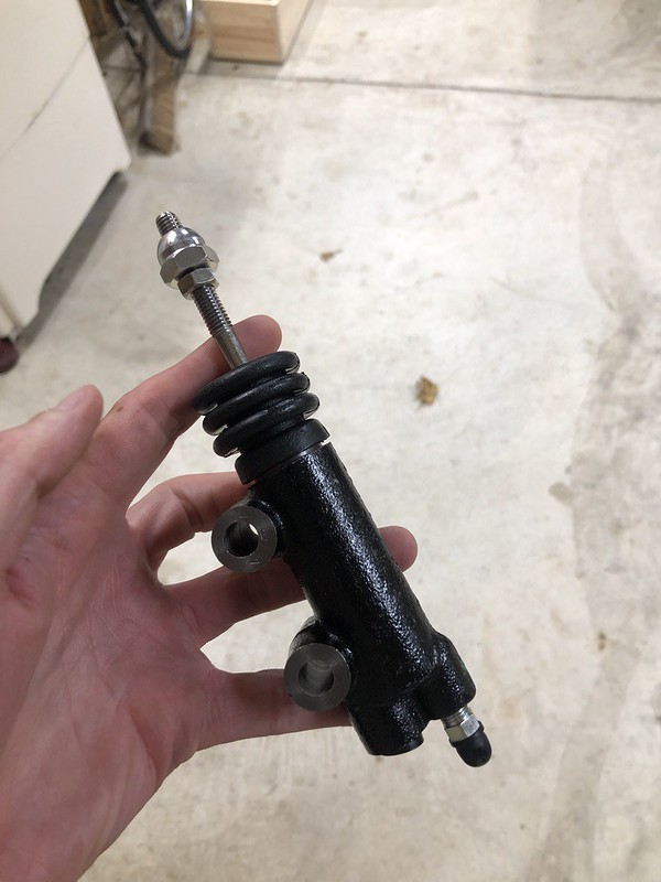

The Slave cylinder started to weep also, so I got a new cheap one off Rock Auto, but when it arrived, I quickly remembered, something about the line fitting size having two different diameters, so I just took the guts out of the new one and rebuilt my old one...quick fix.

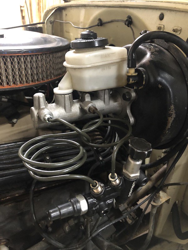

Then, Some of you may remember my brake issues...Since 2014 (I think). I did the JTO rear disc brake conversion ( I wish I hadn't).... I have had brake equalization issues...I have combed the forums for solutions, I and I have followed all the advice: I have ....
1988 4-runner 40mm front calipers
100series Landcruiser Master cylinder
JT Outfitter rear disc ( chevy truck rotors, el camino calipers)
Willwood Manual proportioning valve (5 lines, front-in, rear-in, FR out, FL out, Rear out)
I have never been able to prevent the rear Tires from locking up first.... manually adjusted all the way in BOTH directions (just for S!!ts and giggles)...
I FINALLY FIXED IT!!!!!!! my rear line had crushed the flange in the willwood valve, partially blocking the flow....I re did the lines going from the MC to the Prop valve and now it adjusts the front/rear as it should have!!!!!

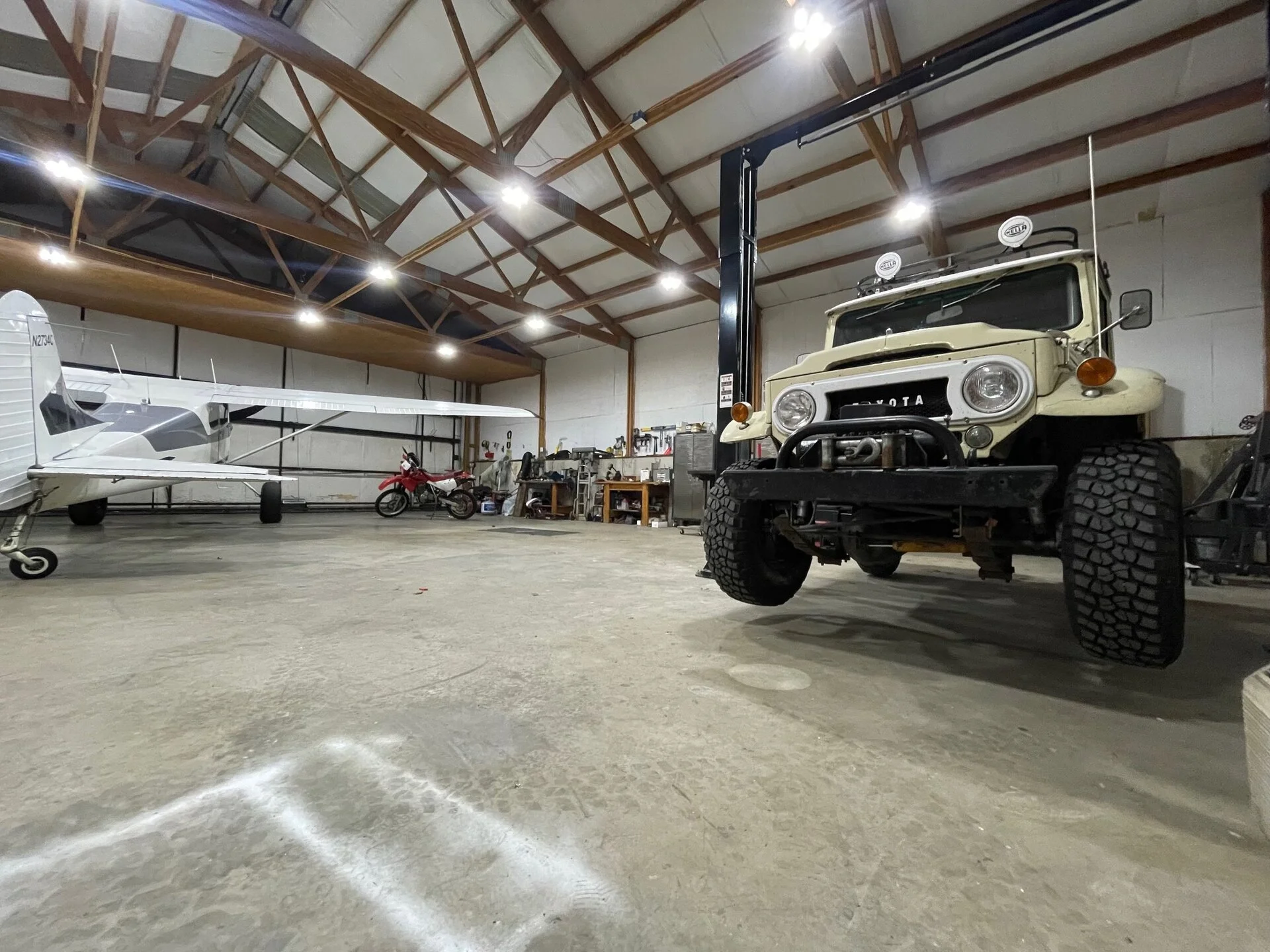

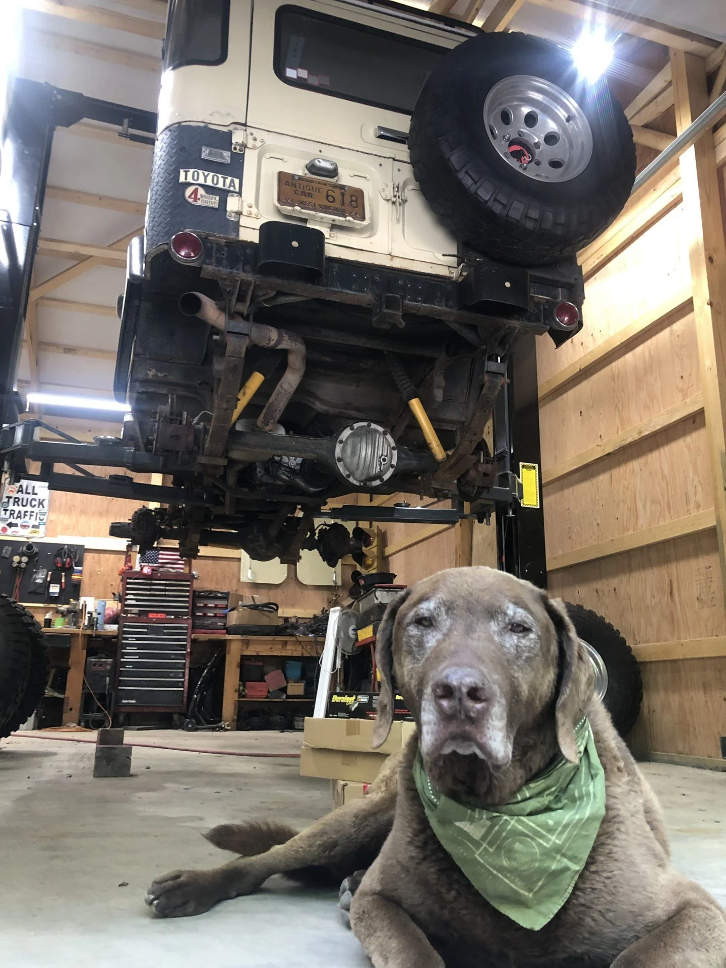

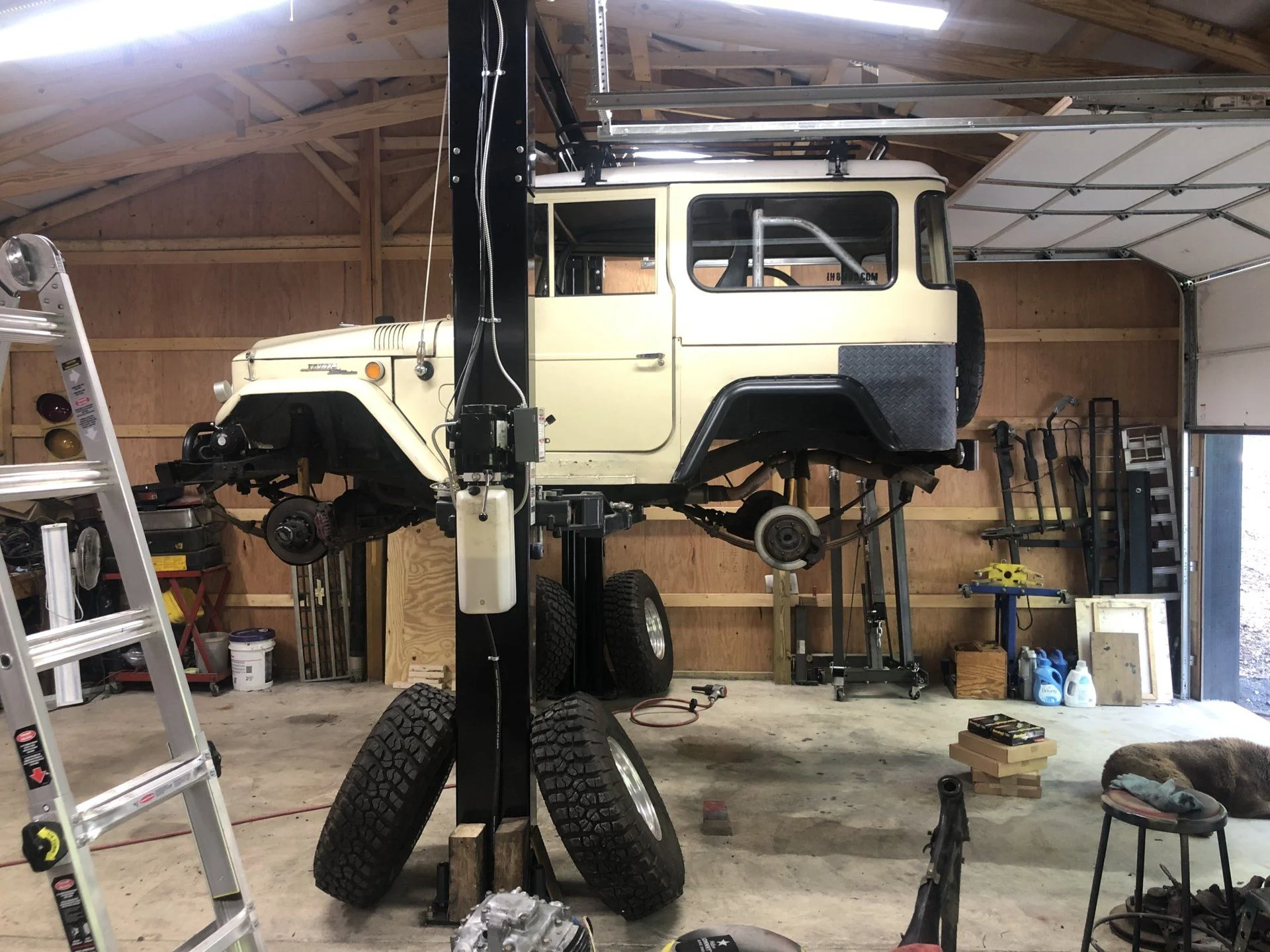

I finally got the lift moved over to the new shop, just in time to replace a rear axle seal. Its started to leak a little more, so I am going to try to get it knocked out this week! I also have a new winch cable and fairlead that have been laying around from the Tacoma project, so I am going to throw them on the Landcruiser as well!!
