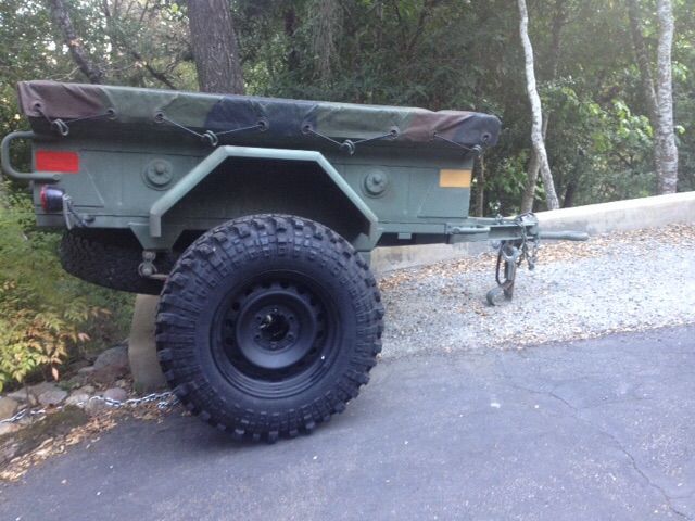

People like to put mud terrain tires on these for the look, but keep in mind that you really want some tread touching blacktop. These trailers weigh next to nothing even when loaded, compared to a truck. You're going to run the tires at a lower pressure than you would normally and they should be adjusted depending on load, just like everything else.

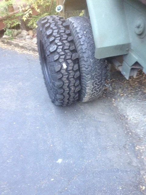

I went the MT route with a set of Super Swamper SXII. They are bias ply, but are E rated with a tougher sidewall. My concern was with dragging the trailer over rocky trails and the potential for sidewall cuts. Compared to the stock tires these are not in my view that much more aggressive. 33 x 9.5 17" Taco / FJC rims. Just over $450 for both, mounted and balanced. Will be swapping out this weekend.

Steve: Will you be running your trailer out on hard trails or mostly on the road?
Mixture, as I have to get to the trails in the Sierras, where I usually wheel on some pretty rocky granite. Tend to tear up tires, and the trailer will eventually have a top and RTT as added weight.
