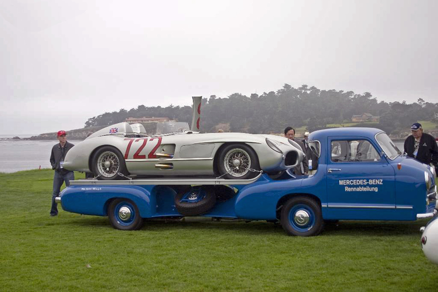

one more Mercedes :)
This Mercedes " Renntransporter" 1954 pickup was build only 1 time (engine 300SL)
s c r a p p e d :crybaby: in 1967
In I993 Mercedes began to built a new original replica, finished in 2000

I like rare things. They are more interesting than mass produced things, maintain value better, not everybody has one and......well....the're rare. That car hauler is the coolest truck I think I have ever seen. Real shame they crushed the original but very impressive that they recreated it. Thank you for posting that picture. I don't think I would have imagined such a vehicle otherwise. Steering with the axle so far behind the driver must take a little getting used to. You'd be swinging out over the sidewalk turning into a narrow street. :cool:
