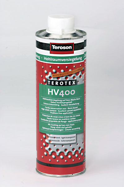

c) best wax product in all test was
teroson
