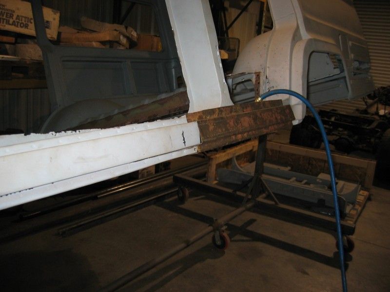

Got 2.5 hours of good solid work in last night. Cut and fitted my first piece of metal to the left outside rocker. Went well. Now I just have to do the other 100 spots around the truck and I will be finished. :D This piece still needs a little bit of fine tuning, but it is basically there. I am satisfied with it especially given it is the first one I have ever done. Next up will be getting the welding skills honed.

How do you rust proof the inside of the rocker panels, which you will not be able to get to later, before they get welded closed? I was thinking that if you were to coat them with something like POR 15 it would melt off while welding and the Weld Thru primers are not recommended for long lasting protection. Let me know what others have done.
Mine will be getting a thorough dousing of Krown Rust Treatment once complete and annually after that. They drill holes to access the rockers and all other inaccessable areas and then spray in their stuff and plug the holes later with plastic plugs.

I have seen that on TV before. I always wondered if it really works. Can you do it yourself or do you have to pay every time? What is the cost? I would think that if I were only street driving the restored LV once would be enough for a long time. Still seems there should be something to treat these areas as I am rebuilding.
I do it on my BJ60 each year if I can. When I was in Canada I did do it each year and I do think it works. Cost isn't that bad when you look at what you spent to get the LV where it is!! It cost about $100 - 200 to do the treatment the first time and a little less each time thereafter.
