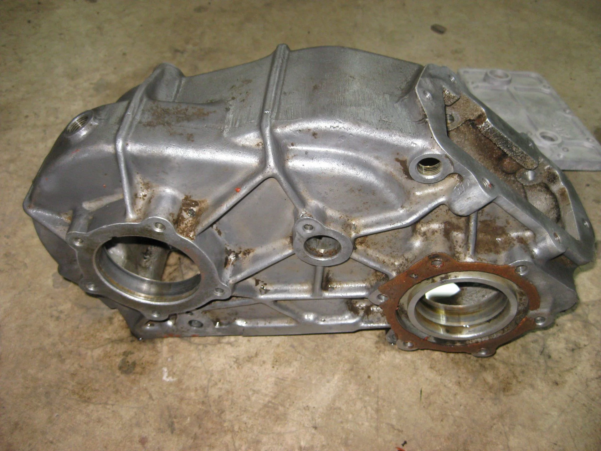

Started cleaning up the transfer case assembly and parts this morning before heading off to the real job. Internals are currently clean, case is on it's way...look how black the interior is. I'm not sure if I've seen a transfer case this color before.
Out of the parts washer and getting there...

Transfer case parts are done.....now they need clearcoat. Jason, if you're thinking about red powdercoat on some of these parts the PTO cover might be a good candidate also. If not, I'll clear it. I probably spent as much time cleaning the 4WD shift assembly as I did the entire case. Took forever!
