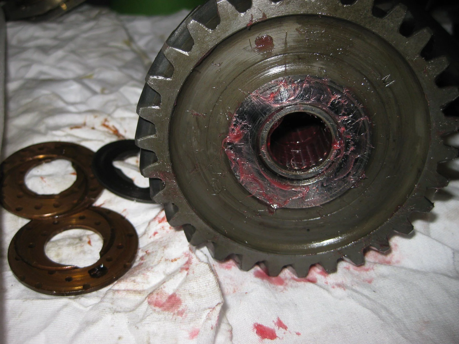

Well, it was a bit better than the 66' gear but not by much. That led me to tearing down a junk 3 speed transmission I had on my shelf which I traded a 12 pack of beer for several months ago. I thought that 1st/reverse gear was toast but it was the best out of all three. So, I had 3 three speed transmissions torn apart in short order.
Jason- we can call your transmission "Frankenstein" because it's cobbled together with pieces from three different cases. I used the "best" of everything I had from your 66', the Craigslist 72' and the unknown year that cost me a 12 pack. Awesome.
I used the reverse idler gear for the 72' and the "12 pack" transmission donated its countershaft assembly, countershaft thrust washers, 2nd gear, the synchro hub and the shift keys. A 12 pack never got me so far...
Pressing off the old input bearing...both the input and the output bearings were swapped out for new NSK units
Then it was time for re-assembly...56 countershaft needle bearings in place. I polished the reverse idler shaft, countershaft and the upper shift shafts prior to installing them
Countershaft assembly and the pile of needle bearings (96) that go in it
Needle bearings and spacers installed
Polished shaft, ready for assembly
Rotating assembly in...

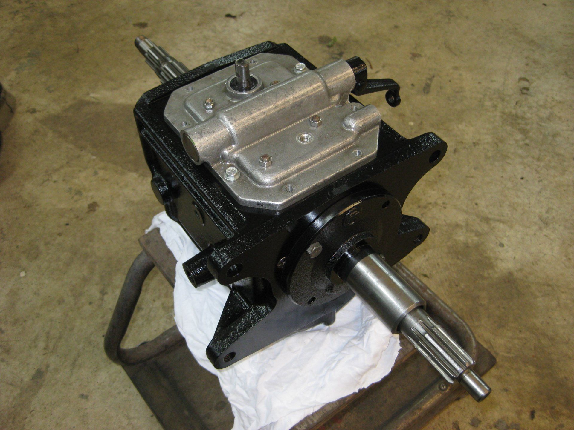

Gratuitous glamour shots...if anyone has worked on one of these transmissions you know how much of a b**** it is. I'm glad to put this behind me. The stainless nuts lacking lock washers are temporary until everything comes back from plating. The transmission will now go hibernate in my heated shop bathroom until installation. Yeah, my wife stays out of that bathroom...
One more...

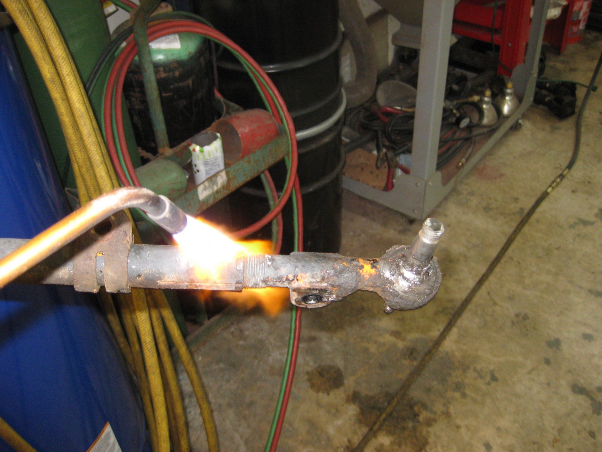

I also worked on the steering rods a bit, mainly to get a few of the tie rods out to retrieve the clamps. This tie rod was stuck so it got the heat!

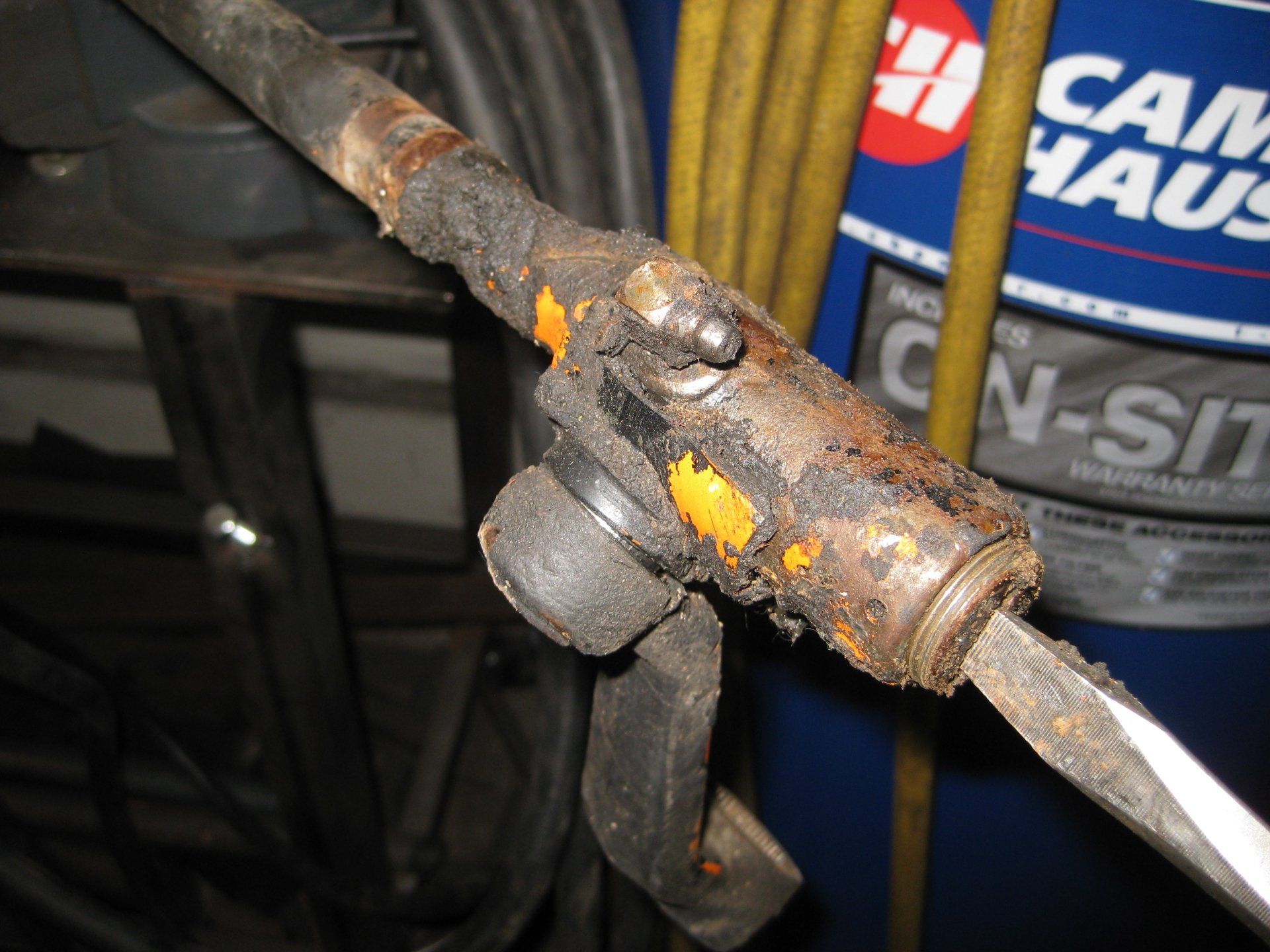

I took the drag link/relay link assembly apart also. Surprisingly this was in pretty good shape and the grease was still "grease" like. Jason- we'll need a new rubber seal unless you ordered one already.

Gratuitous glamour shots...if anyone has worked on one of these transmissions you know how much of a b**** it is. I'm glad to put this behind me. The stainless nut lacking lock washers are temporary until everything comes back from plating. The transmission will now go hibernate in my heated shop bathroom until installation. Yeah, my wife stays out of that bathroom...
One more...

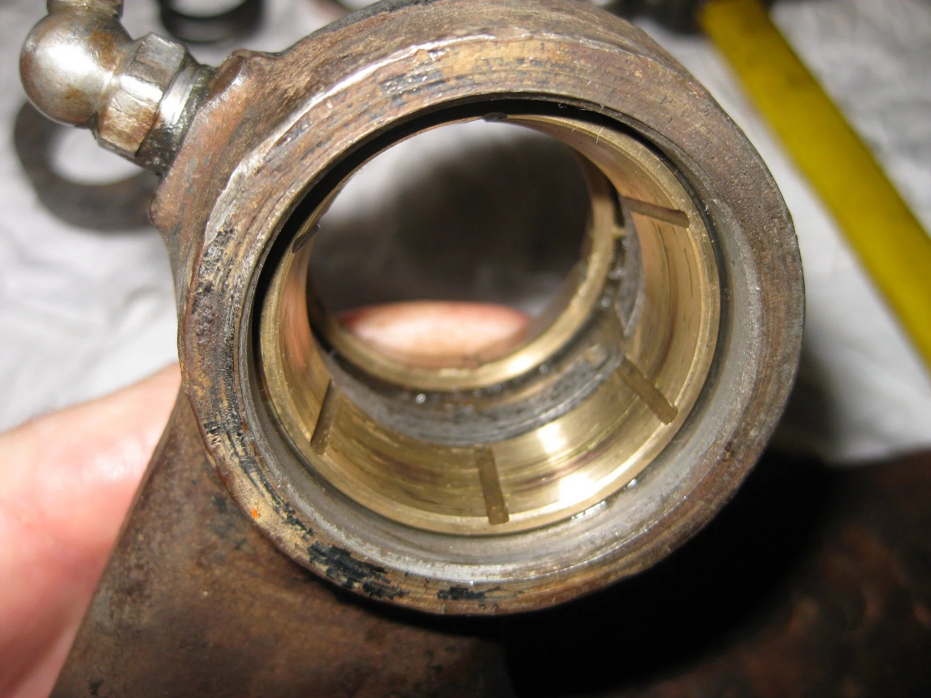

Moved onto the center arm components, one bushing had some pretty obvious wear marks

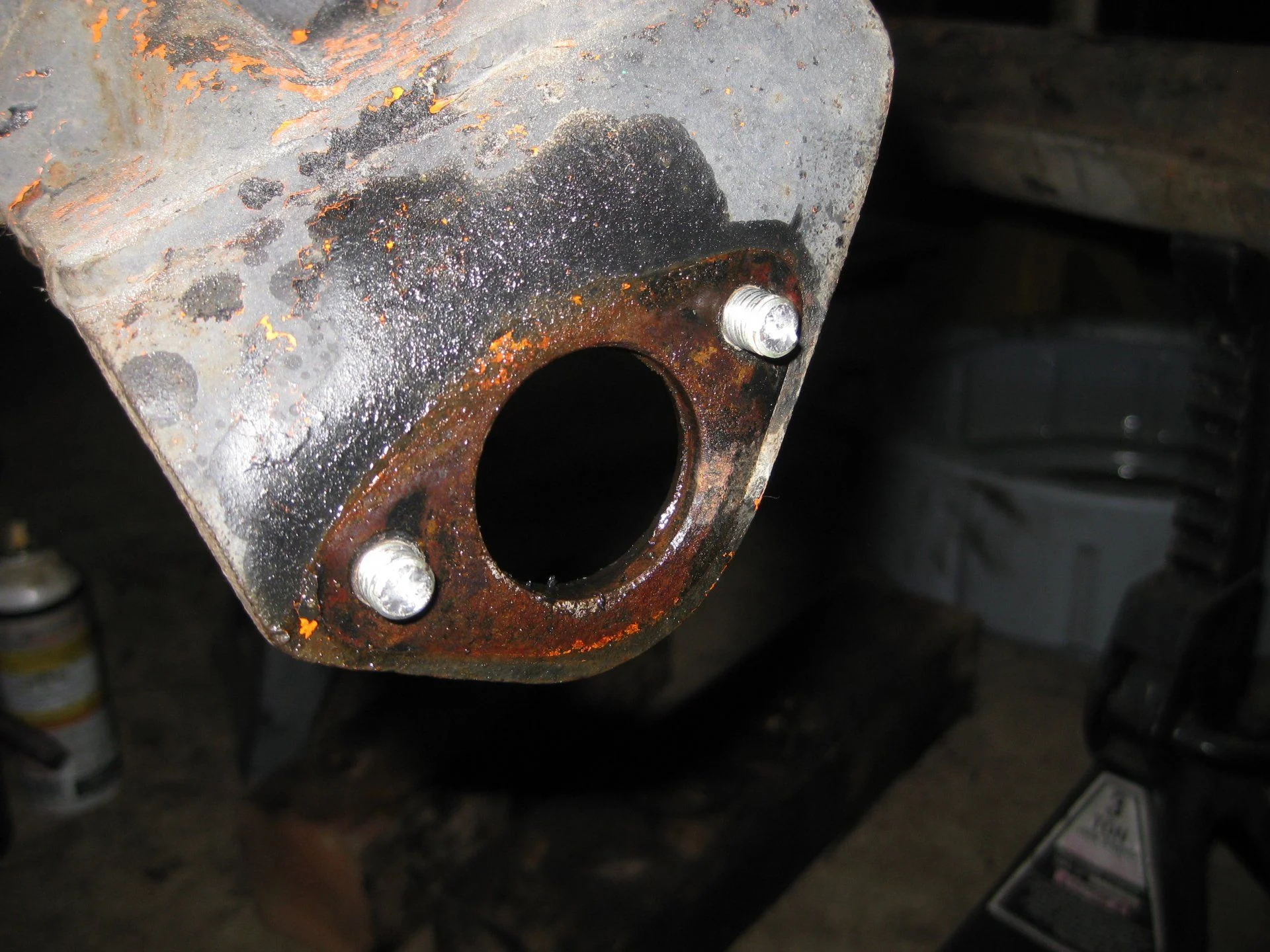

I had tried several times to get the center arm shaft out of the frame mount with zero success. It was stuck TIGHT and on the older 40's the center arm mount is actually rivoted into the frame. It soaked in PB Blaster for several days and it finally broke loose this morning after hitting with a brass punch and a BFH.

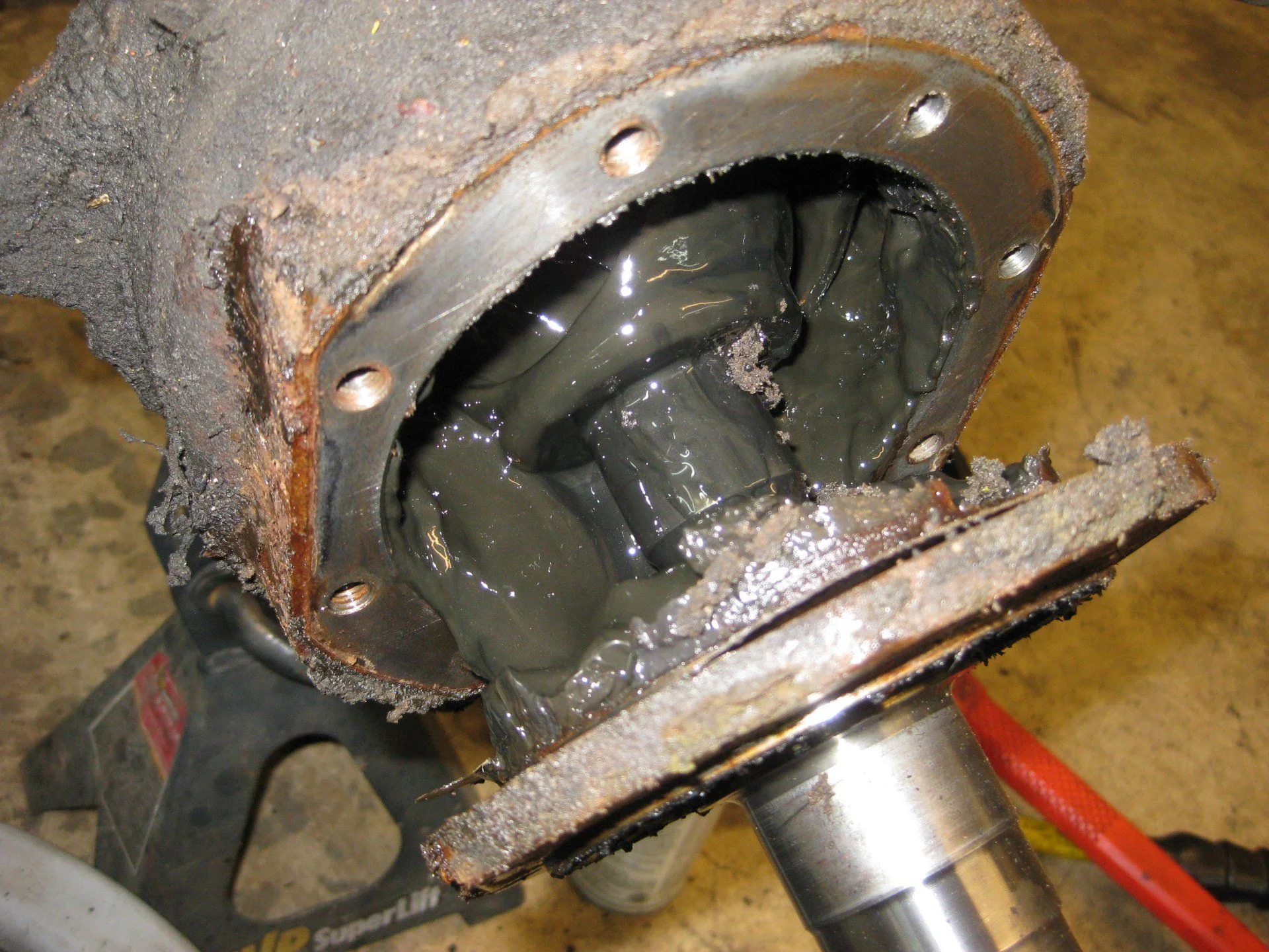

The knuckle grease is fairly obviously contaminated with gear oil.

And when the spindle popped off, oil and grease just started pouring out
