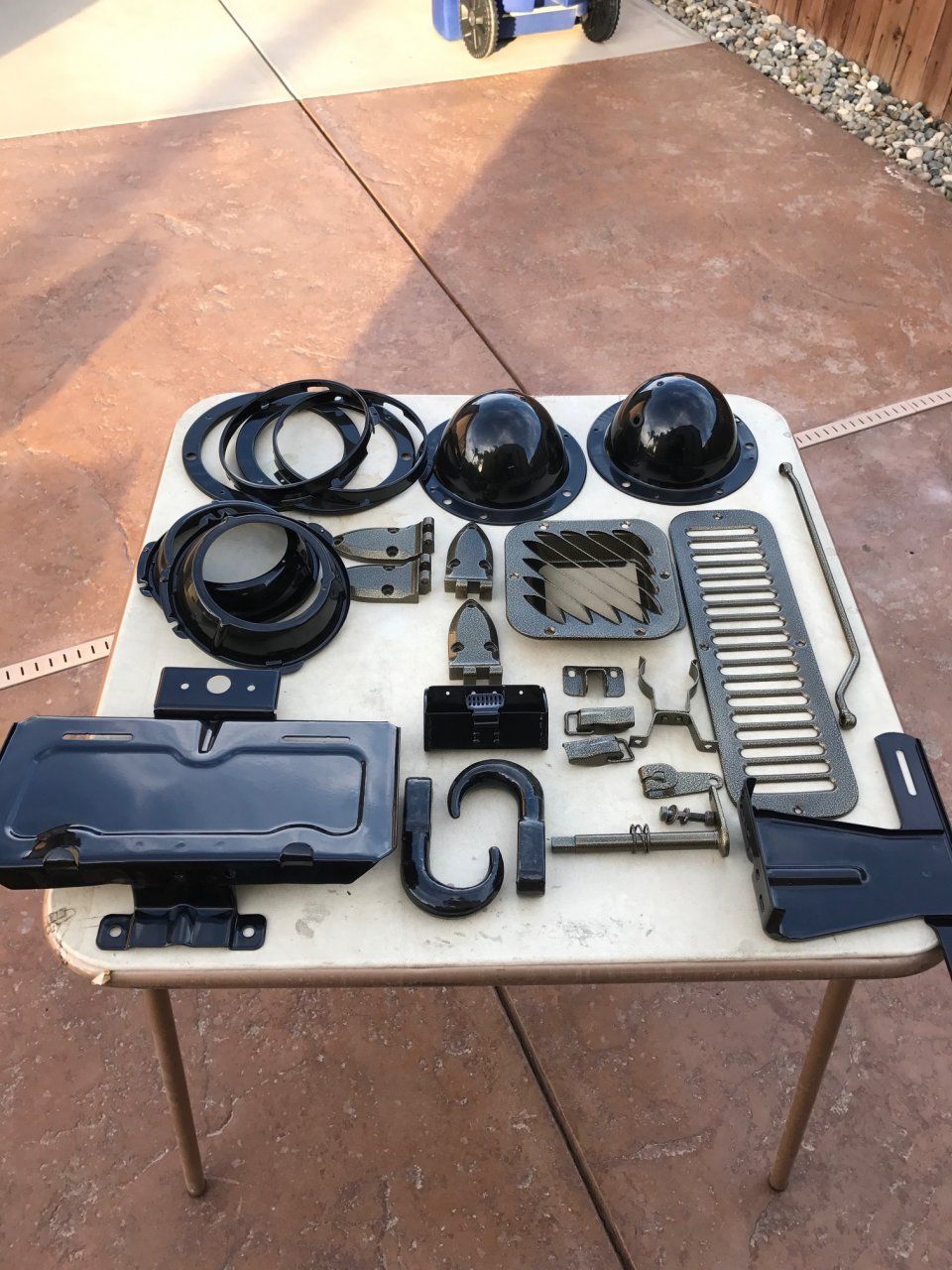

Did some more categorizing and photos today of the build:
The powder coat thing became addictive :)

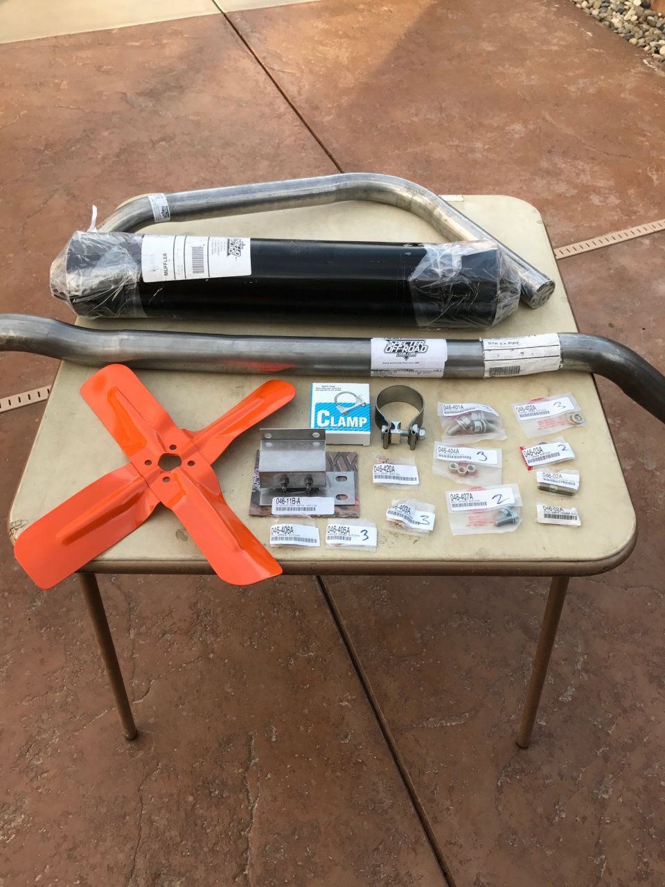

Specter Off-road does a nice exhaust OEM (I assume) with all bolts, brackets.... (did the fan back to orange)

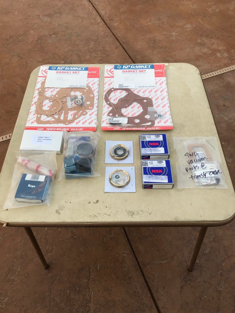

Went with the Advanced Adapters Transmission & Transfer Case, seals/gaskets/bearing and o-rings/parts.

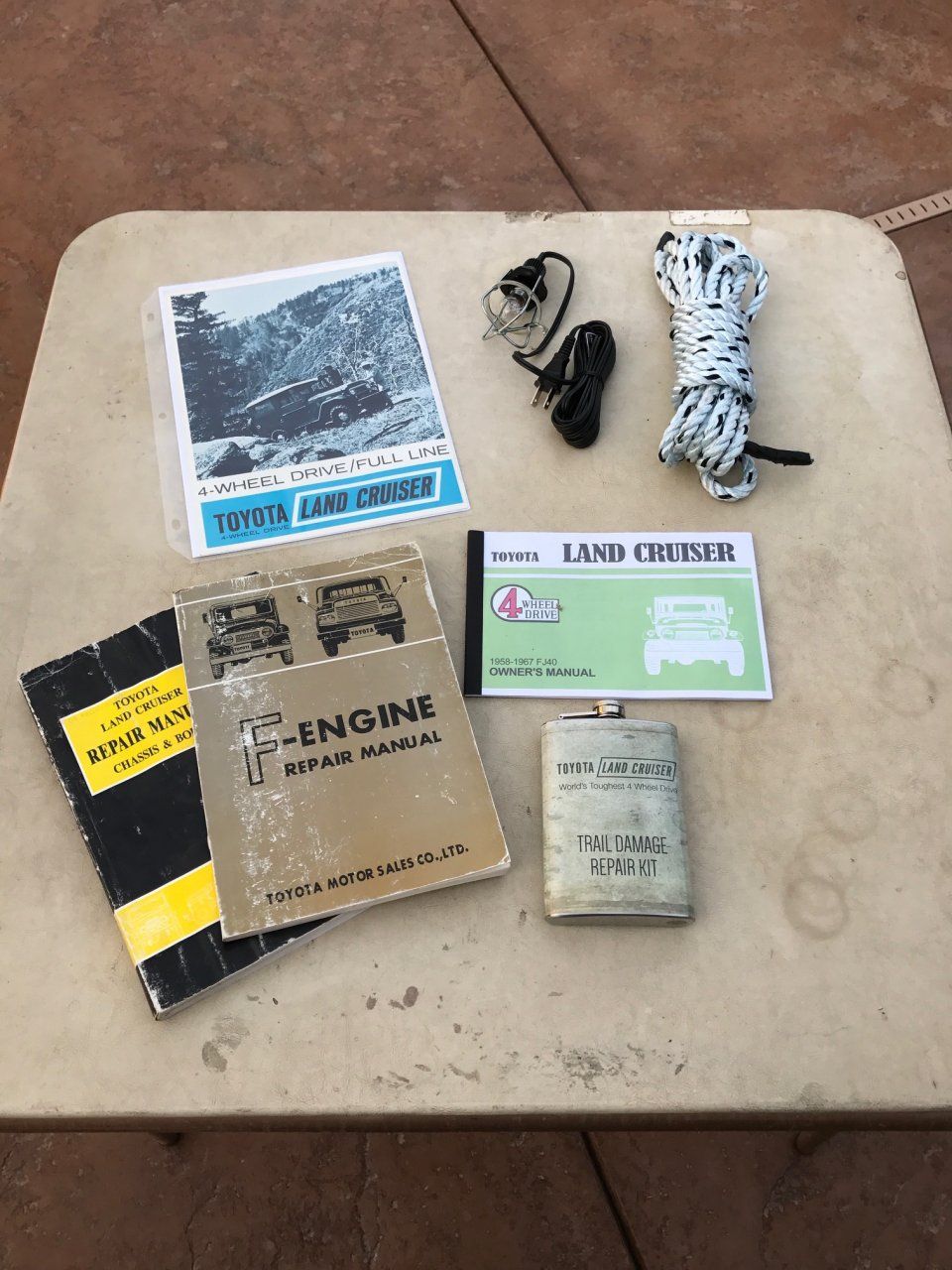

Then Grandpa/Dad had the original "F" engine & Chassis/Body manual. Specter has the nice re-prints of the manuals (that didn't make the generation transition, it was lost somewhere) & I picked up a cool 1966 FJ40 brochure on-line and an inspection light last week.

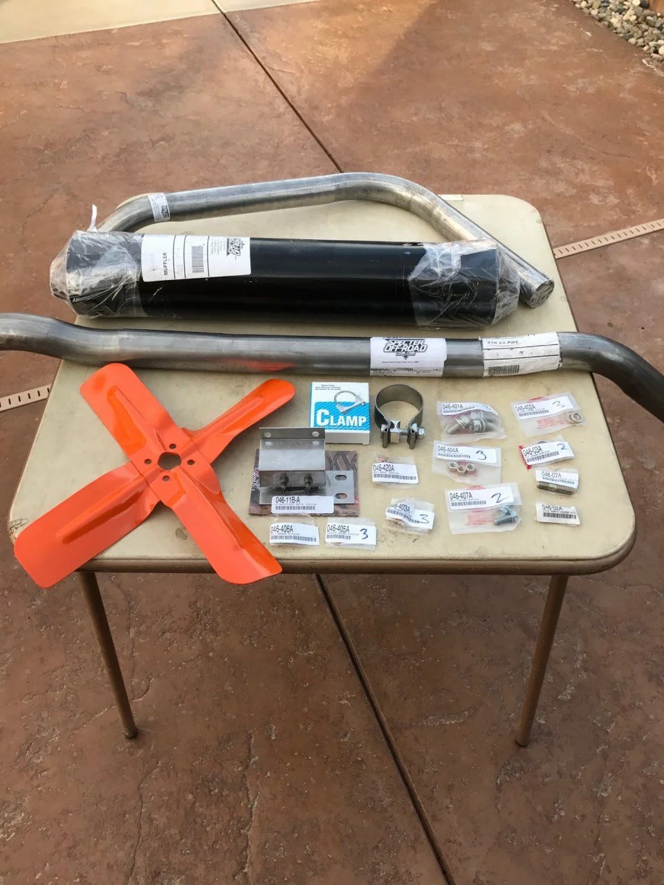

I installed a 6 blade plastic fan on my F because it seemed to me the vetran consensus was/is 4 blade metal fans are not so bueno.
You may want to stay period correct but I figured I'd repost a couple comments on the subject of 4 blade metal fans.
Free for the cost of shipping here too. I've NEVER sold one, and wouldn't want it on my conscience that I ever did. Most dangerous thing to ever be bolted onto a landcruiser [close runner up: delco dizzy]
Plastic fans rule!
Why do you think it would be a good 'addition'? If it is an UPGRADE from the 4 blade metal fan, well then....ANYTHING is a good upgrade from that timebomb.
Best
Mark A.
I'm glad you told me about the fan. I'm still new to the Cruiser life, but this is the first I've heard of the Original "F" 4 blade fan failures. So, they're common? Reason, I ask is I thought my Dad replaced it due to better air flow, but now I'm wondering if it was due to this. My cruiser currently has the 6 blade plastic, so maybe I'll stay with that? I was doing exactly what the "bigredrocker" was stating, I was going to back to period correct. Interesting !
I'm trying to restore my '65 as accurately as I can. Did the research and decided the old fan was too big of a liability. When I went to clean mine up for a repaint, I found a little crack already forming. Probably just a matter of time before it grenades.
