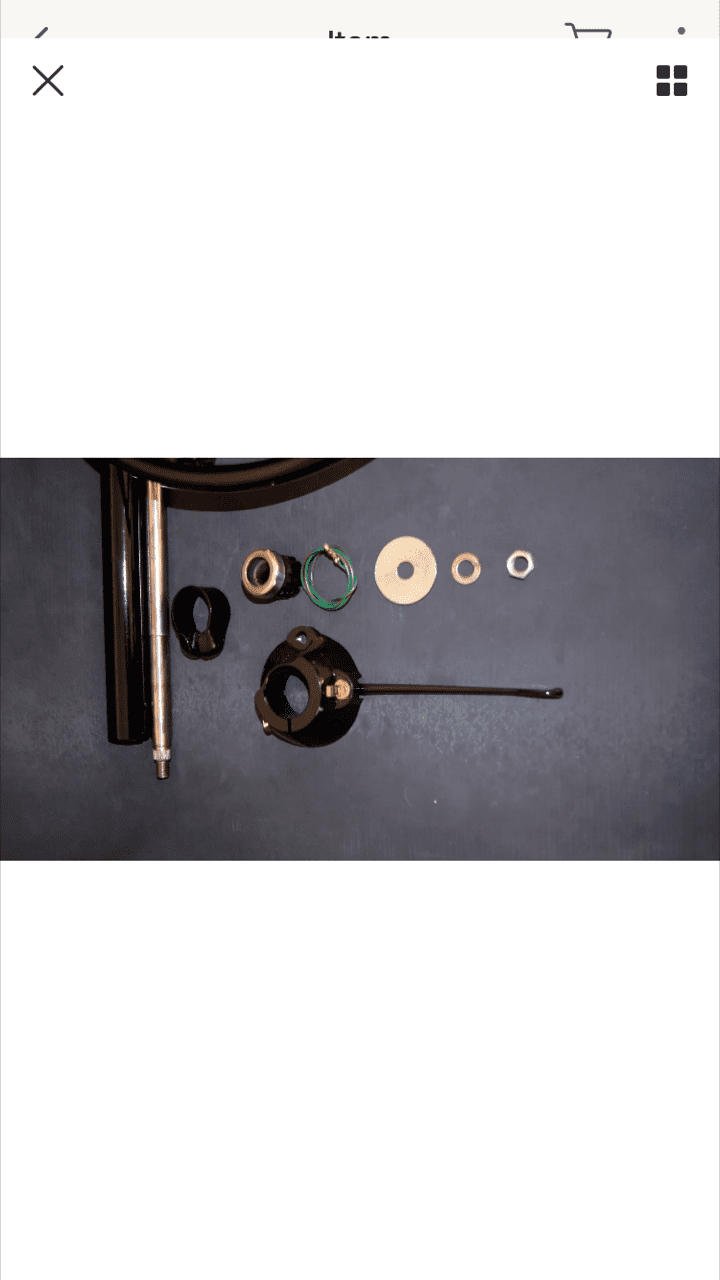

Finished getting my steering wheel, column parts, horn button & interior light switch re-conditioned. Came out very nice.

Looks great Jason. Could you breakdown what you had done on the steering column? I'm ready to do mine also. THX.
On the Steering Column, I sent my wheel off to a guy in Glendale who filled and restored it. As for the column and parts, I just powedercoated the down tube, purchased a new turn signal SW from Cruiser Corps. and my original OEM button, I had cleaned up and restored also. I didn't do anything with the steering shaft as it was fine. I haven't started on my column shift yet, but I think @Rock40 is going to be able to restore that for me (Poweder Coat).

I hate to tell you, but cruiser corps sent you the wrong turn signal switch. For a 1966 you need one with bullet connectors not the plastic connector style plug. Check your harness and you will see.
Dyno
Dyno
They did. Thanks, re-ordered correct on Cruiser Corps sent me the correct one. Good looking out. :)
Thanks for the info Jason, much appreciated.
