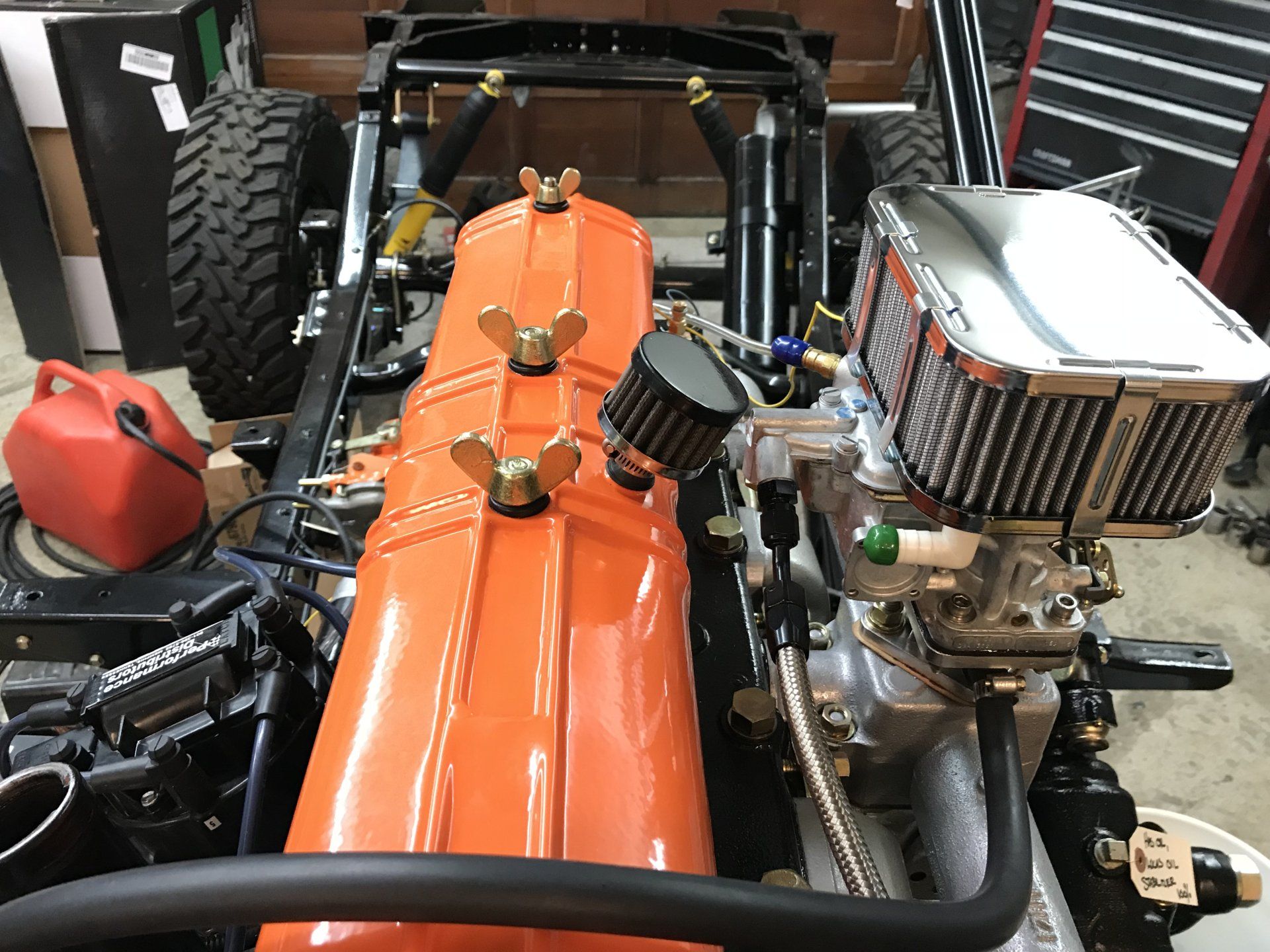

Now that the PCV is hooked up correctly, I elected to delete the obnoxious hose coming out the top of the valve cover and just attach a small breather/filter I had. Much cleaner

Hey Rock, could you give me (a neophyte) a short explanation on losing the hose from the valve cover?

@bb67tlc, the hose on the valve cover is fairly simple, now that I know how the engine is "breathing" so to speak. From what I understand, the valve cover breather is drawing fresh air into the top of the engine. It MUST be filtered for obvious reasons. Air flows down through the engine and then is sucked back out via the PCV valve on the oil filler neck. This air flow cuts down on condensation within the engine and also harmful gases/acids that build up inside the crankcase. That 90 degree fitting below the Weber air filter is just a way for "filtered" air to enter the engine. I liked the idea of eliminating the dorky looking hose though so the small vent breather will do the same thing.

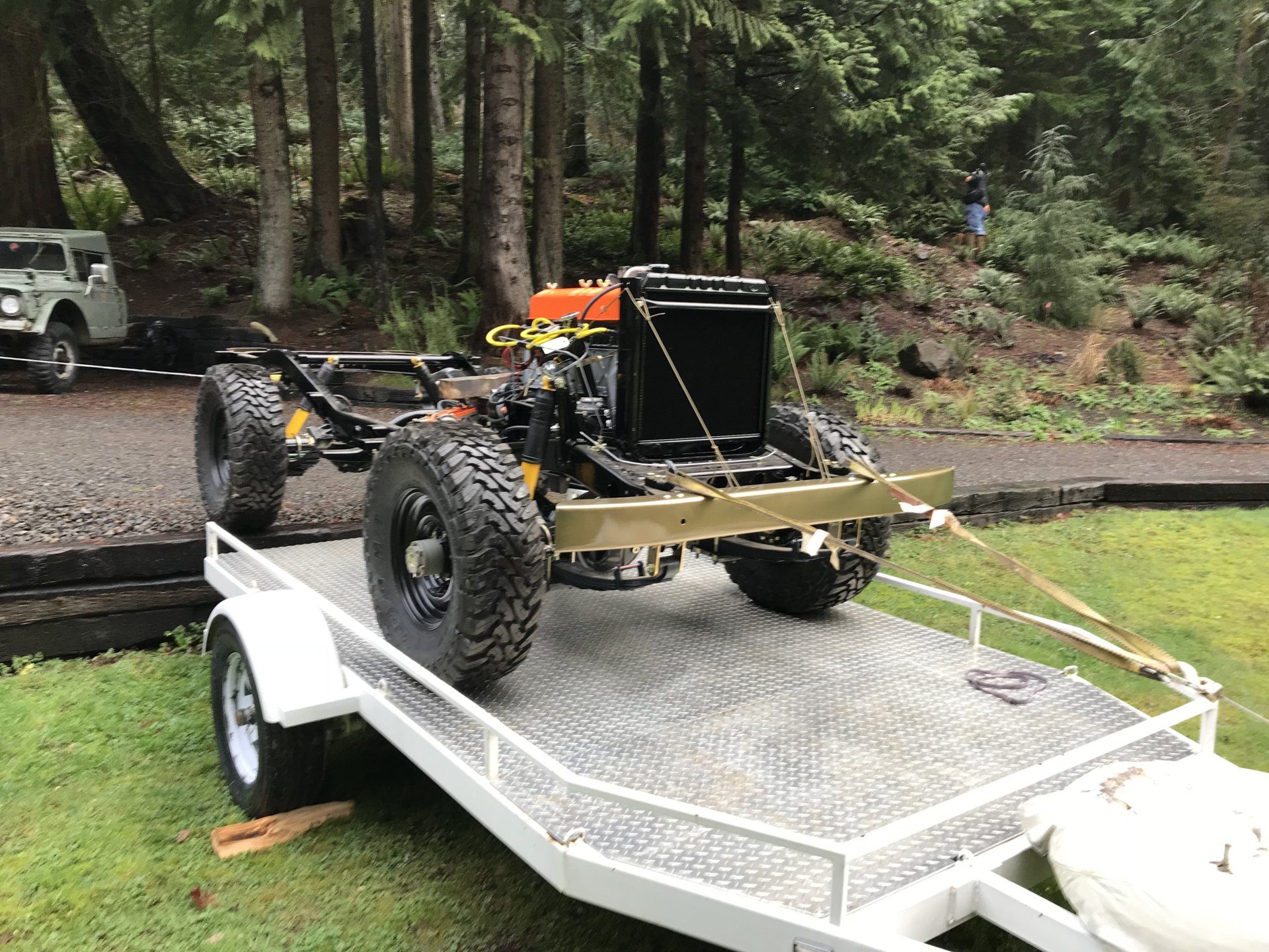

Well after a year and 7 days (Feb. 2, 2017). The rolling chassis is DONE. @Rock40 and I are meeting halfway in Medford, OR tomorrow for the handoff. She’s loaded up and ready to go. The body will go on in California on Monday. Assembly to follow....
Made the drive yesterday from Snohomish, WA to Medford, OR to meet Jason. Left the house at 3am and the weather gave us a huge break being sunny and dry! Here’s one semi-blurry towing pic:

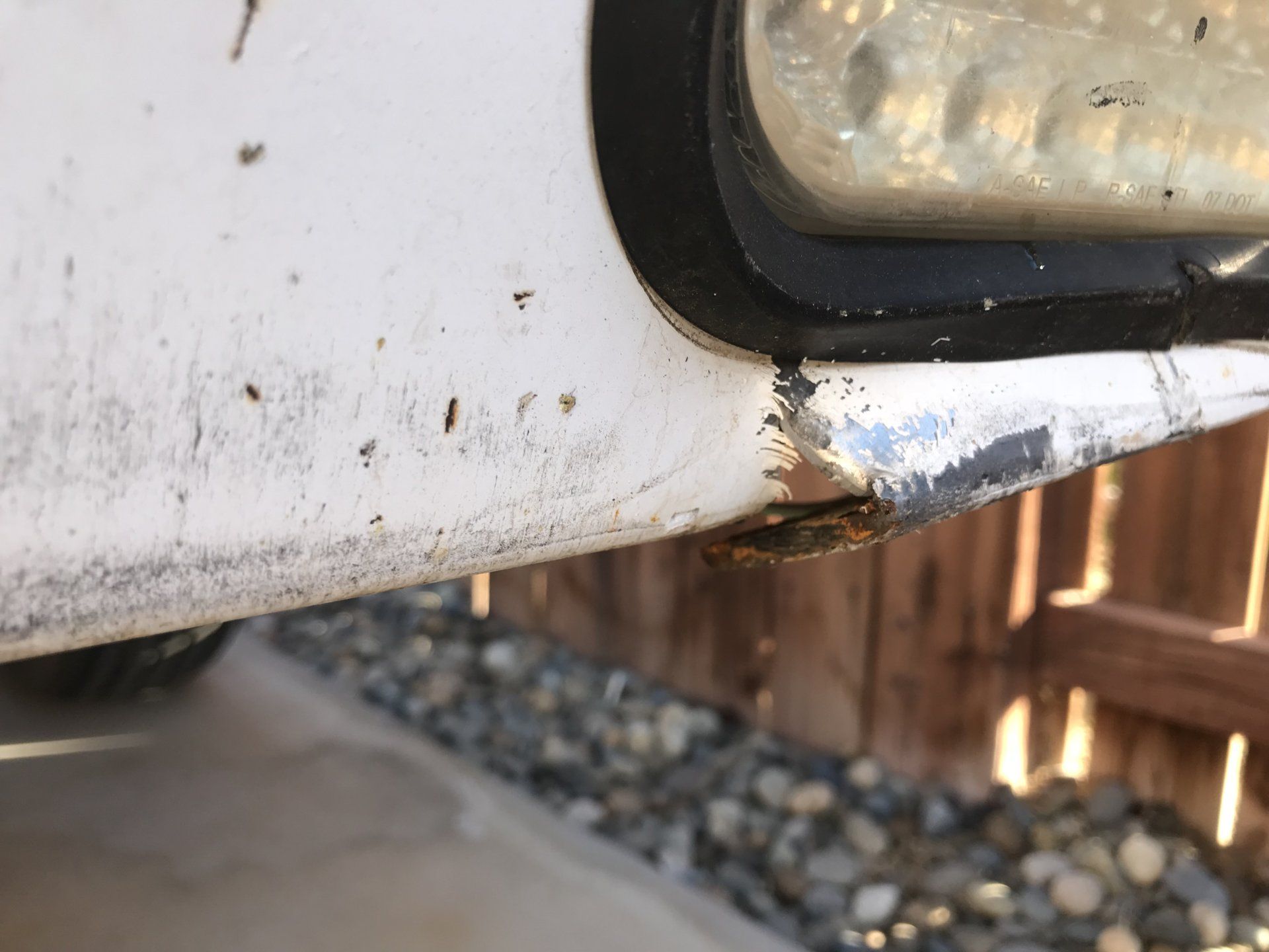

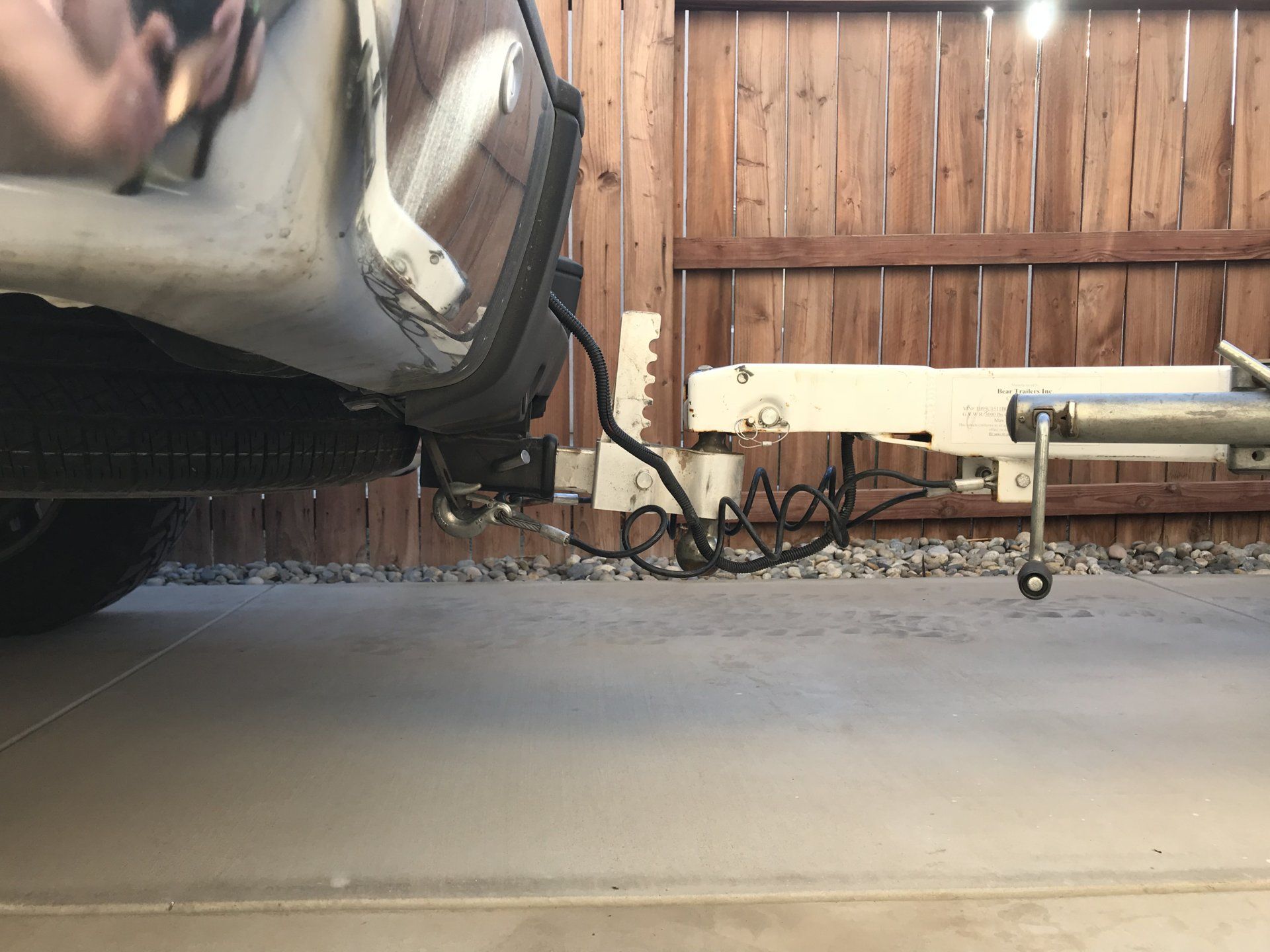

Well, I made it home. Not without some drama though. I had the FJ40 Gods looking over me for sure. 2 hours from home after meeting @Rock40 earlier I’m the day, around 10:30pm last night, someone rear ended me on I-5 south. Completely buckled the end of the trailer, nudged me as I was pulling the hill. I don’t know how I didn’t do worse. No damage to the Landcruiser at all. Completely shocked. Shoved my bumper on the truck down and in around an 1 inch or so. Thankfully I got home.
