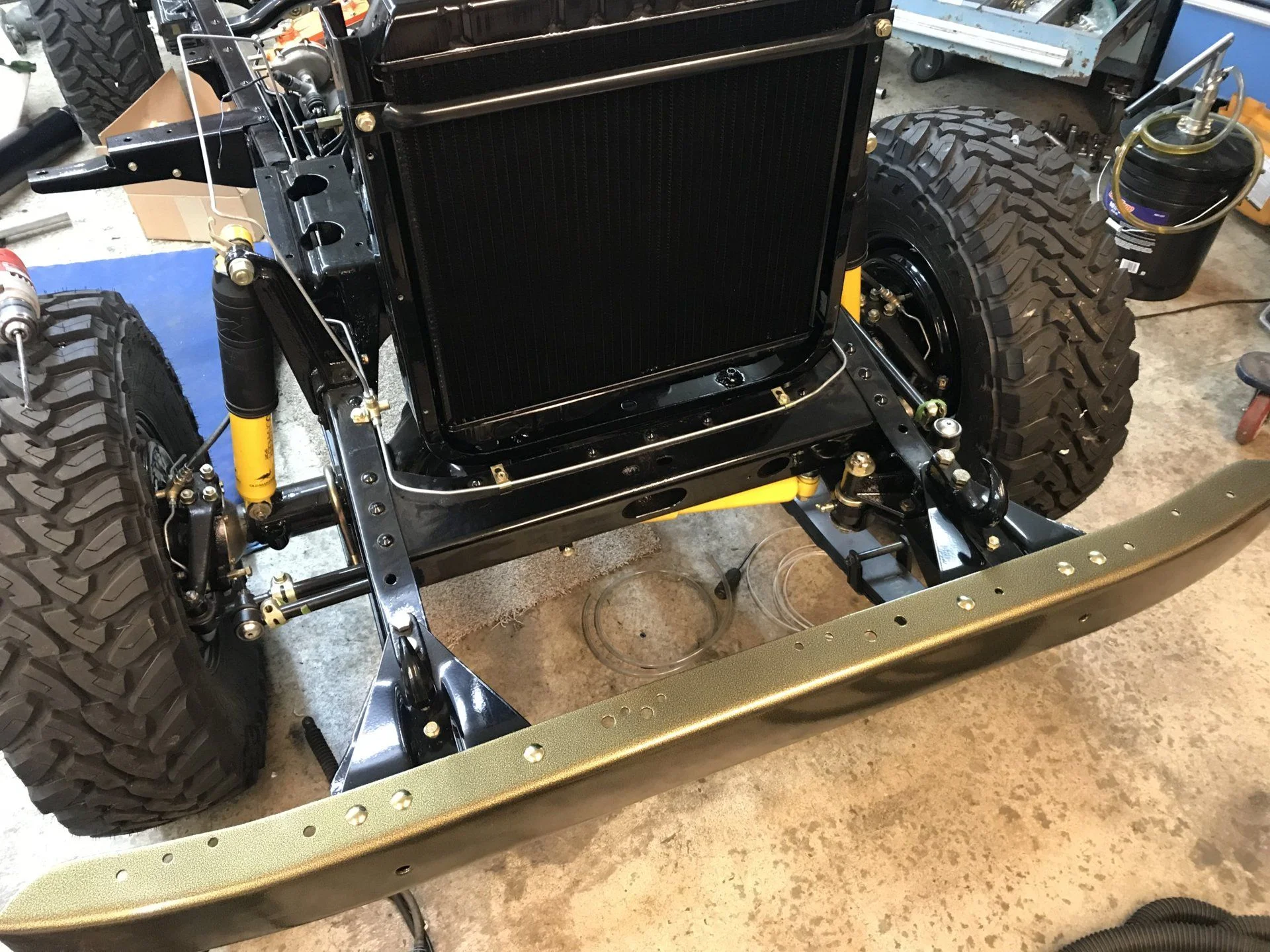

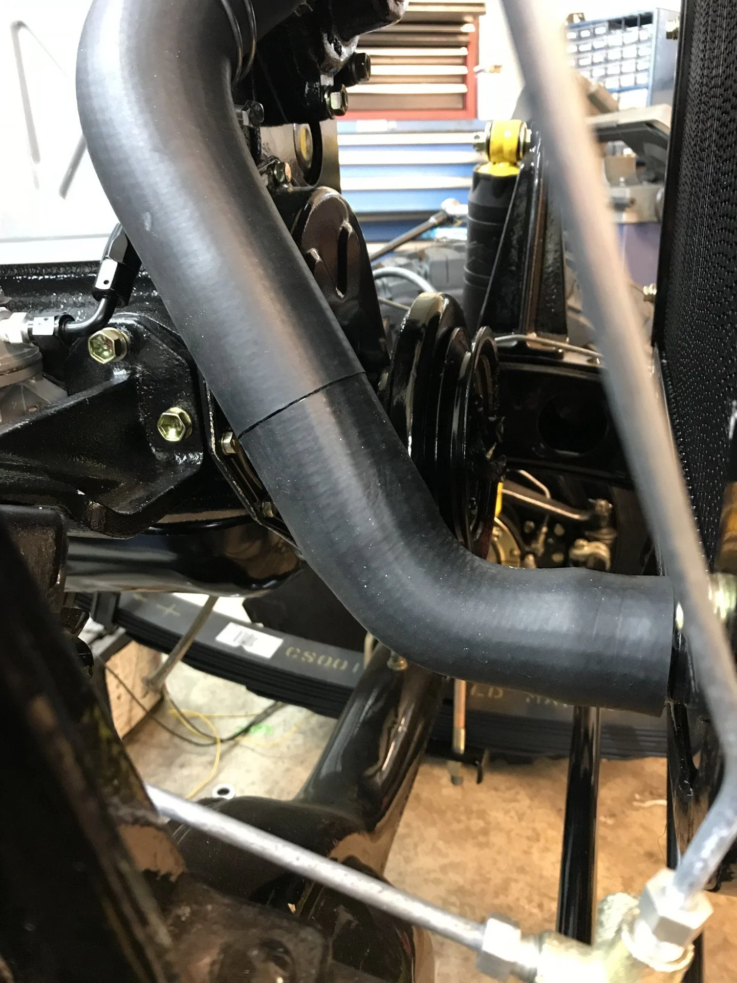

Cooling system is plumbed in...
Yeah, it's just a tad too long, my thoughts also. Correct, no heater on this truck.

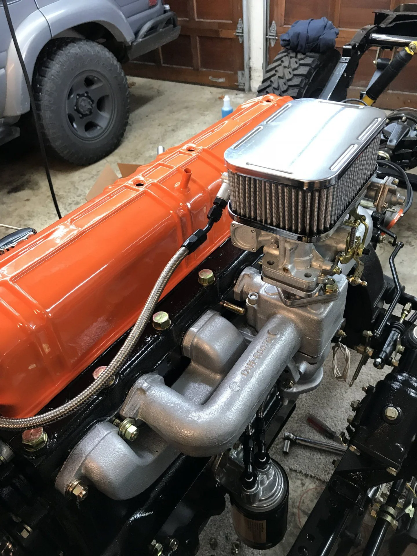

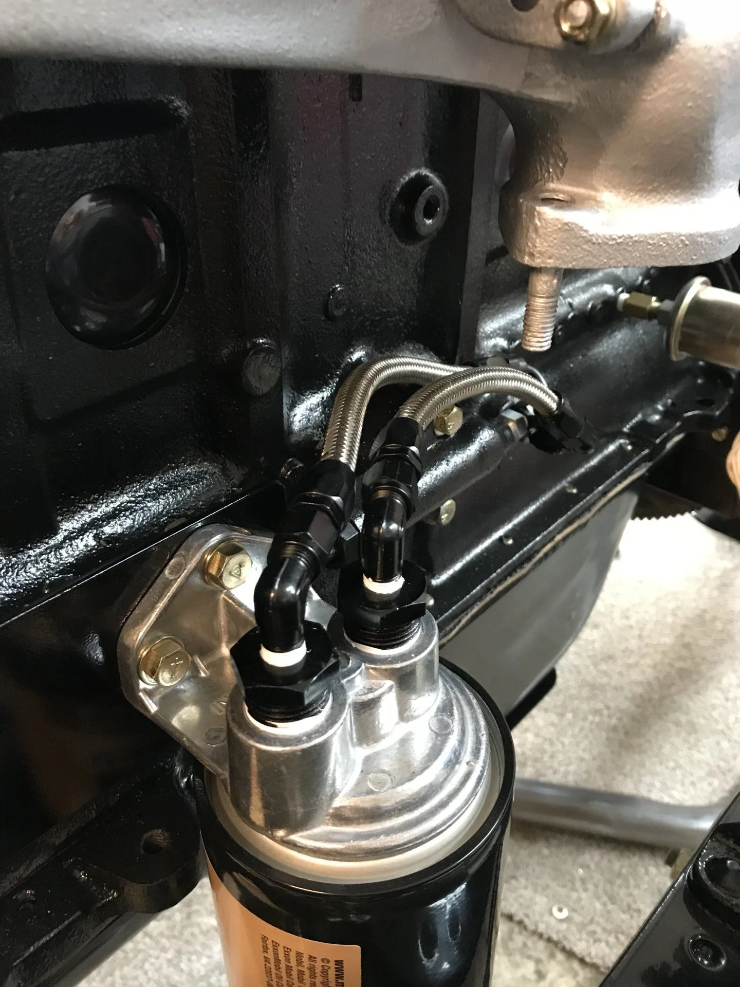

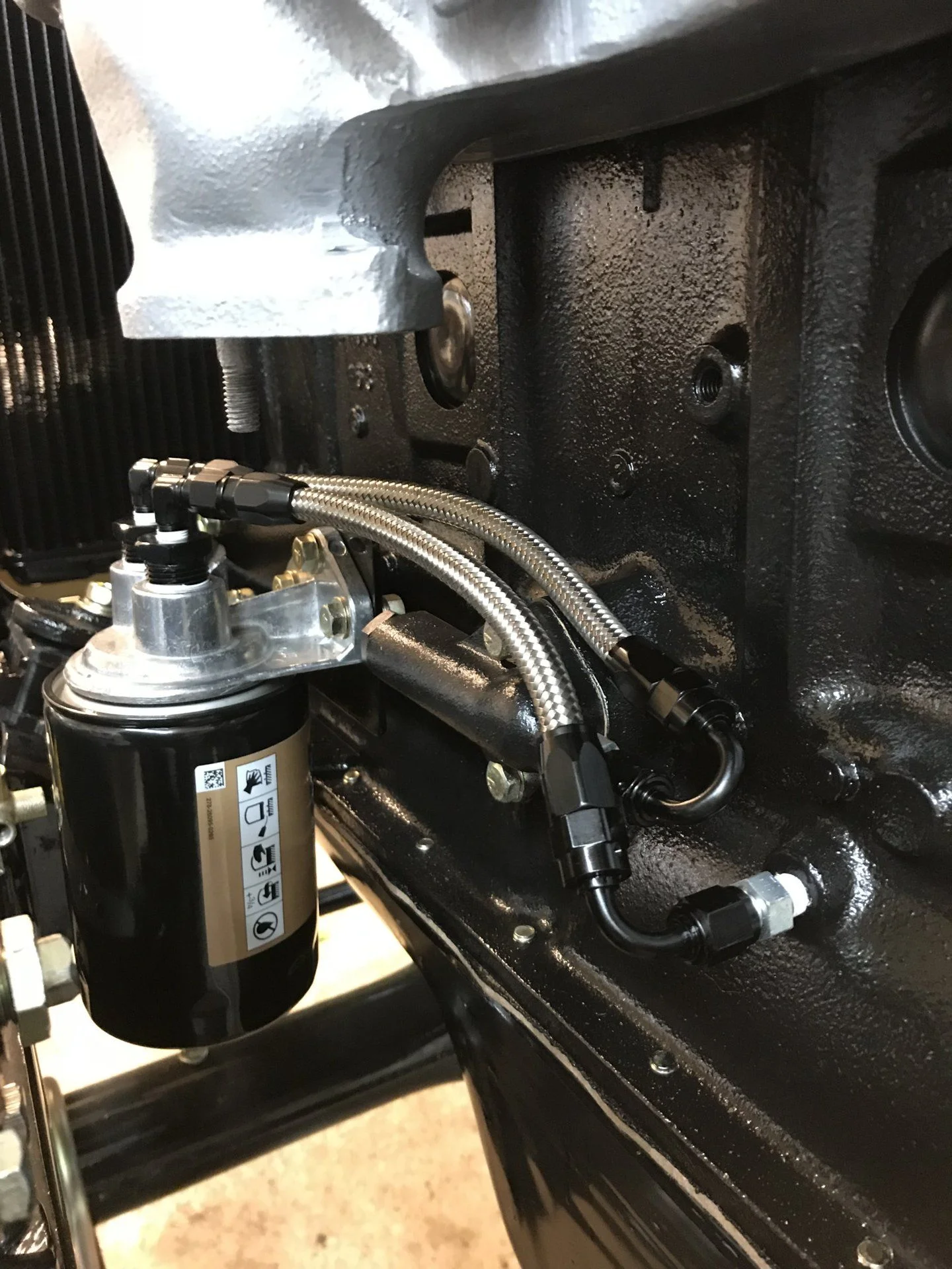

Oil filter mount and oil line routing is complete. Took a variety of 4AN fittings but it’ll clear the factory exhaust

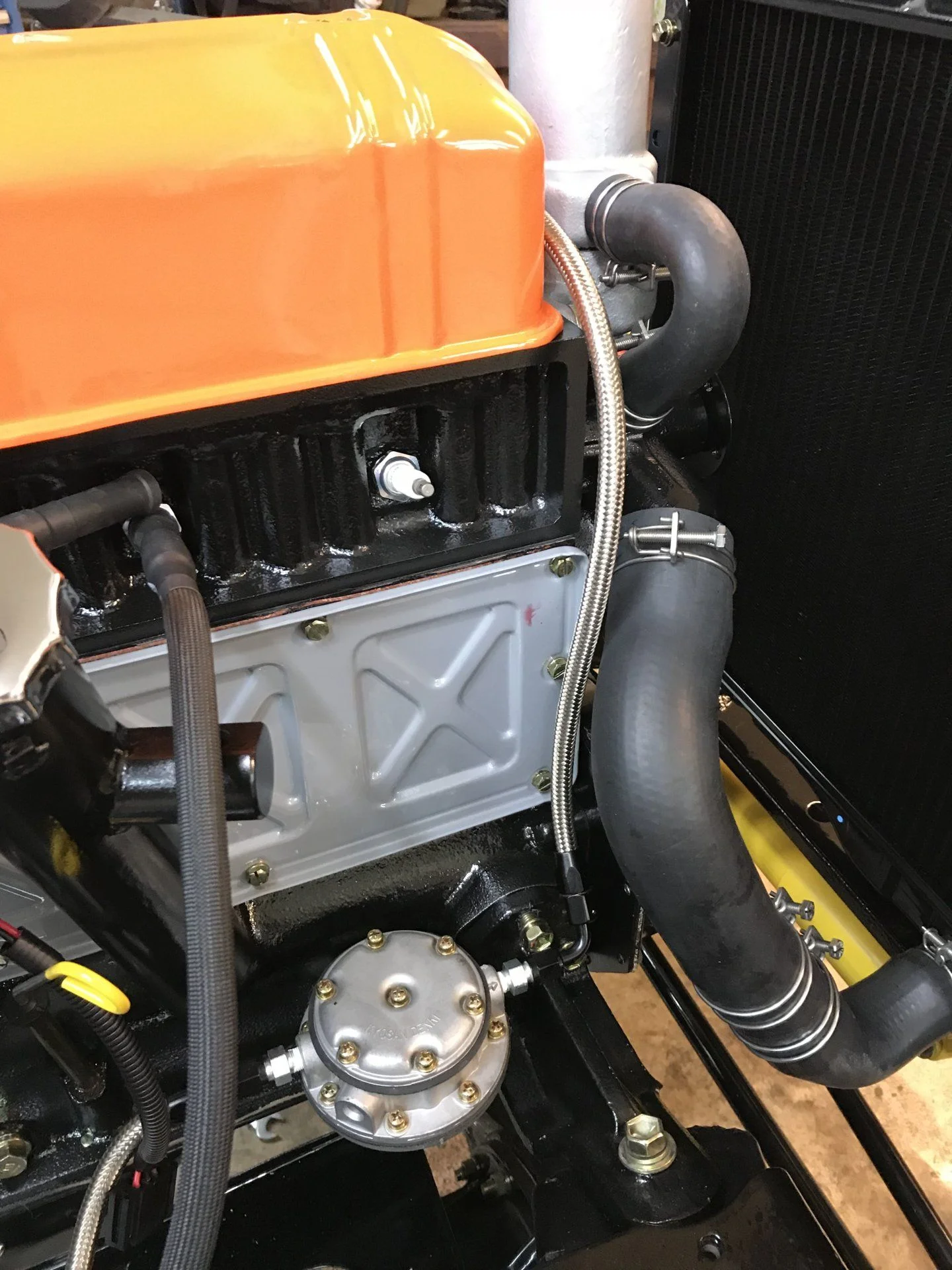

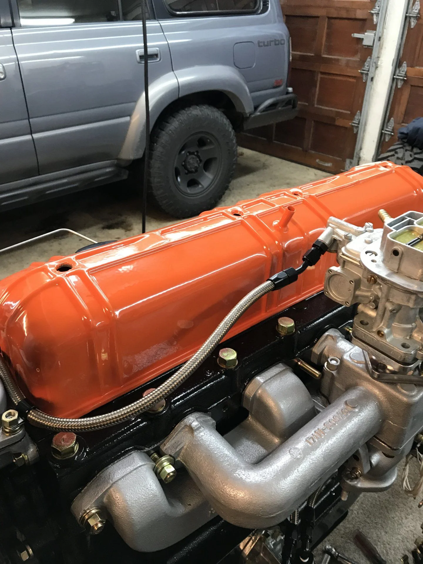

Also started to route and create the main fuel line from the fuel pump to the carb. I don’t have the proper M10x1.0 carb fitting at this point to complete it but the routing is clean and simple

That threaded hole that is at eye level with the throats of the exhaust is for the pivot bolt of the stock rod linkage. You might want to chase the threads and install that bolt while it's easy to get at in case Jason decides to go back to the 1bbl carb one day.
Ross
Ahh, thanks Mark. I wondered what that pivot was for.
No problem. I am enjoying doing a little coaching from the sidelines on this build.

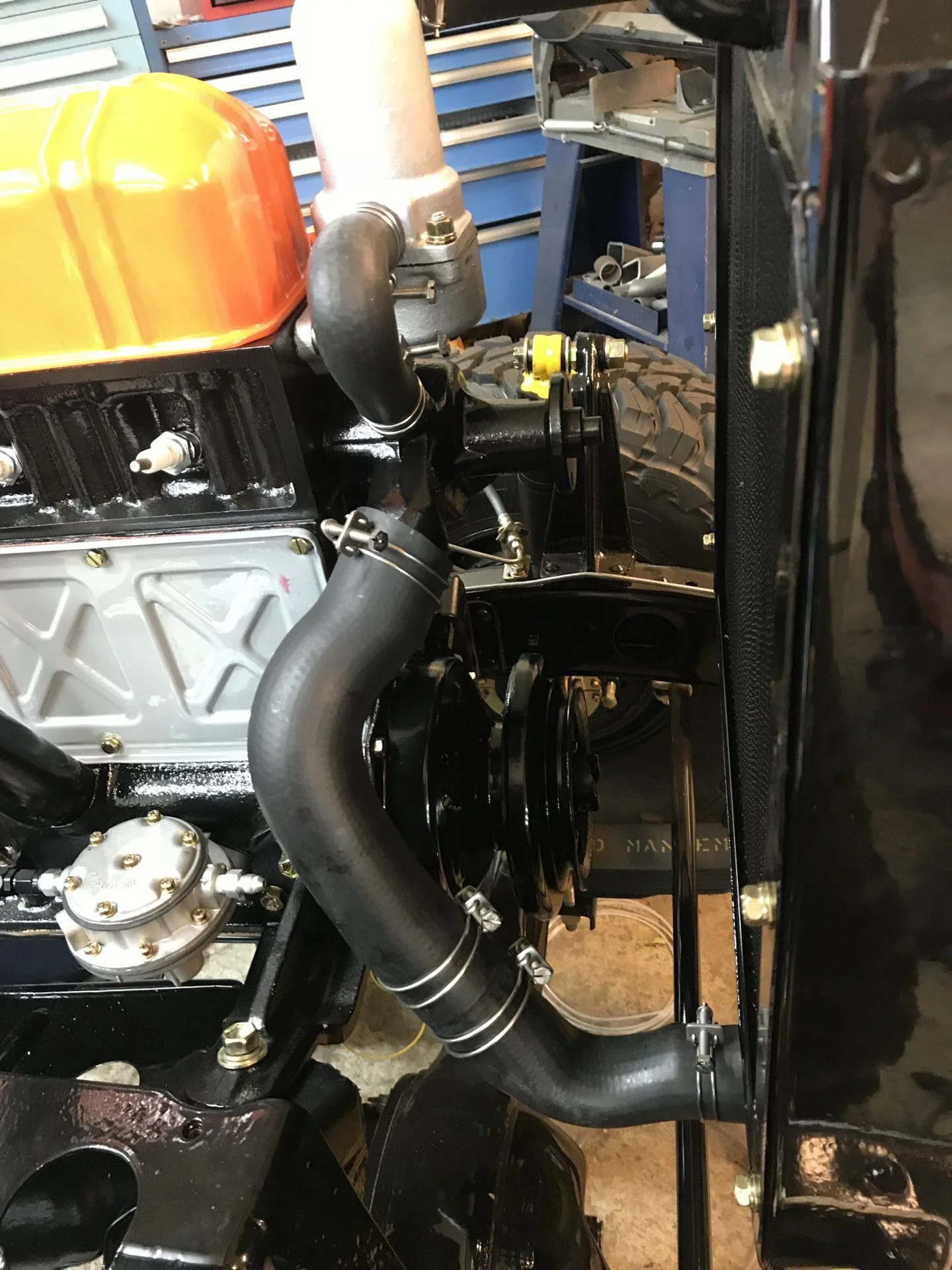

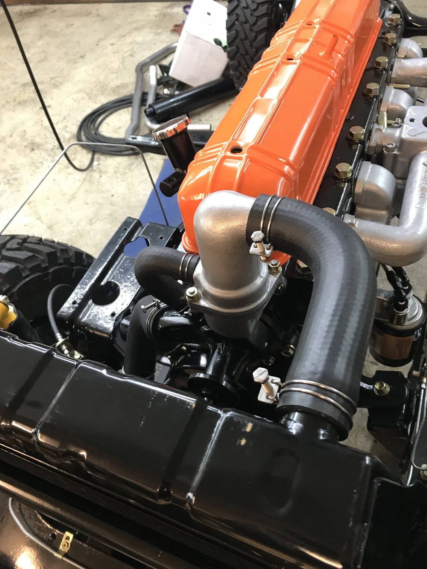

Got the kink out of the lower radiator hose

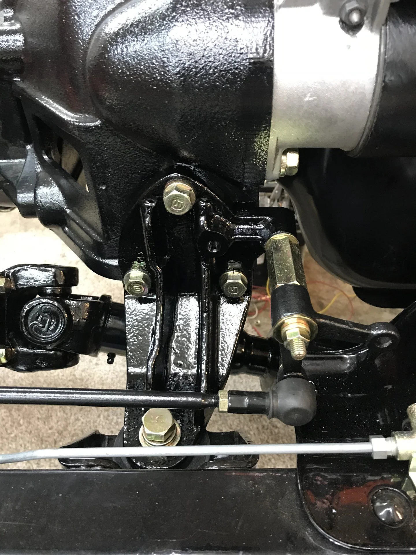

Replaced the rear passenger side motor mount so now the High/Neutral/Low transfer pivot works correctly

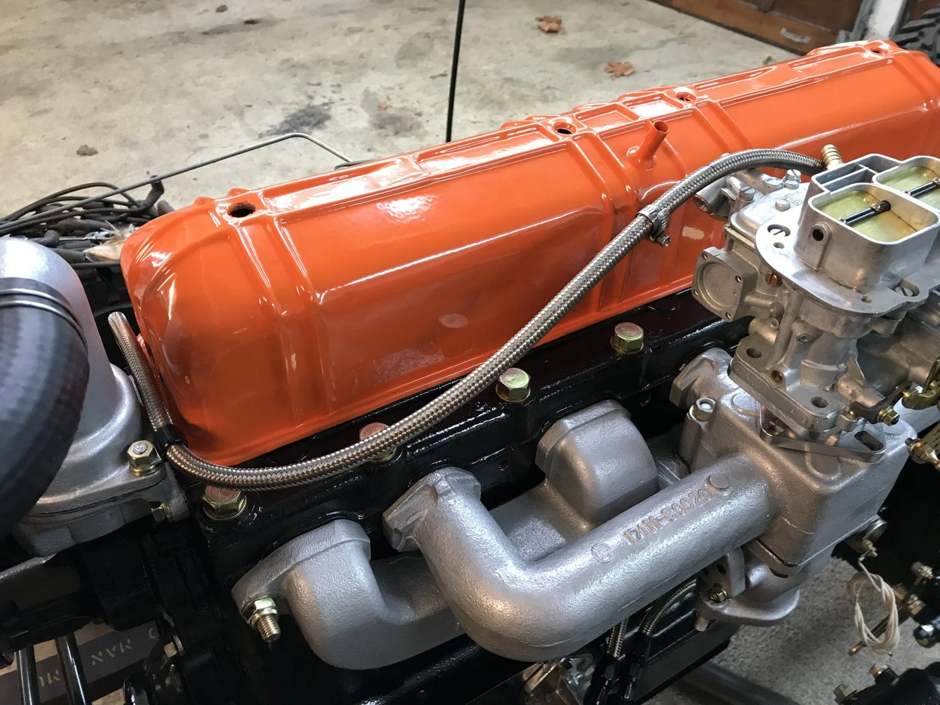

Made the final 4AN line for the Weber
Now going over everything again in order to source the final bits of mounting hardware. The Weber will sit like this
