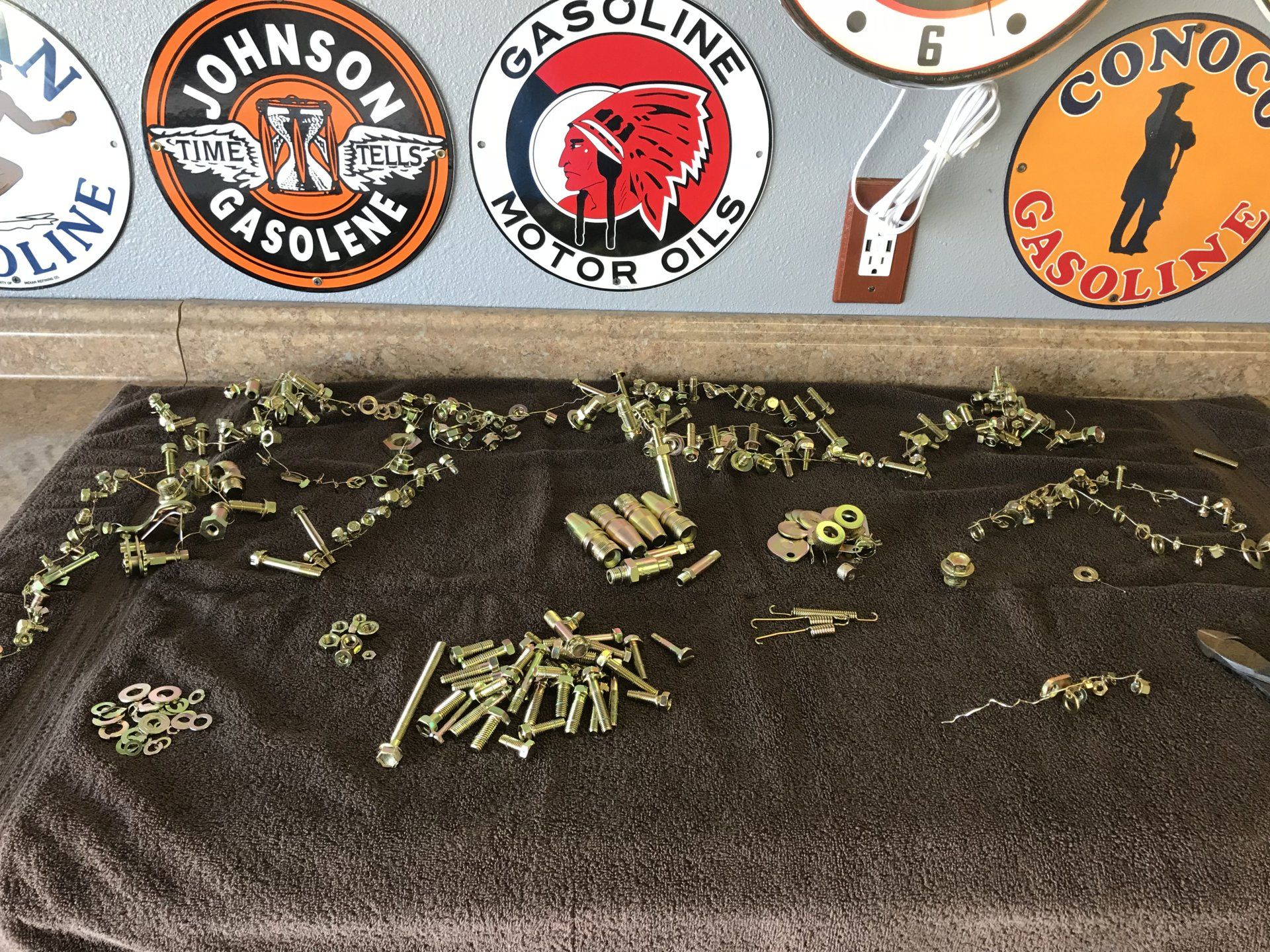

Plating arrived so I started more assembly. Exhaust manifold and intake are installed

One more, the little plated bits did turn out great

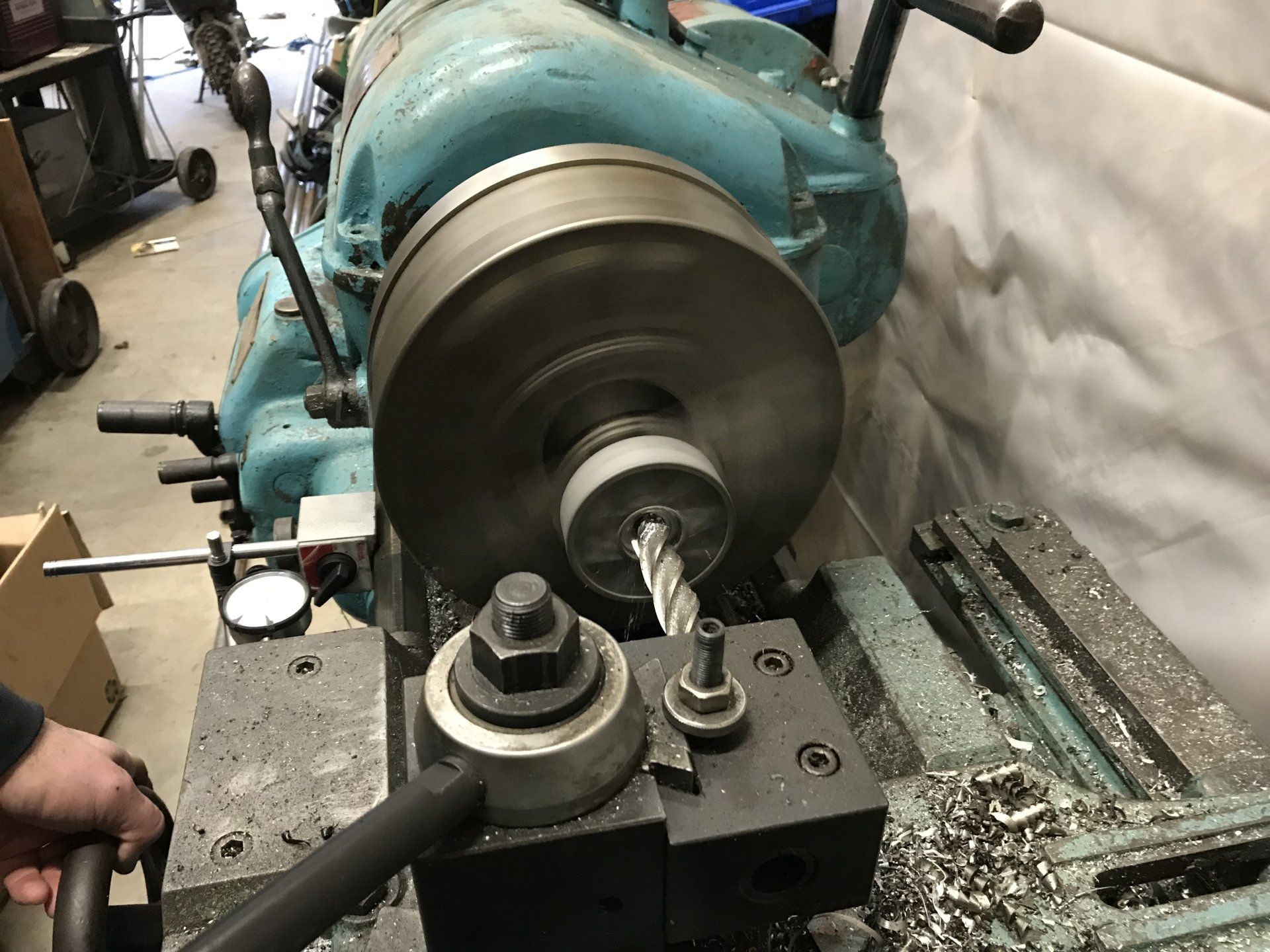

The old Flex-a-Lite spacer was machined just a bit today. It wasn’t quite deep enough to fit over the water pump and snug against the fan pulley. Only made it about .085 deeper but that’s all it took.
Machined
The fan now has an appropriate amount of distance from the belt. Yes, we searched for an OEM spacer, nobody seems to have one
