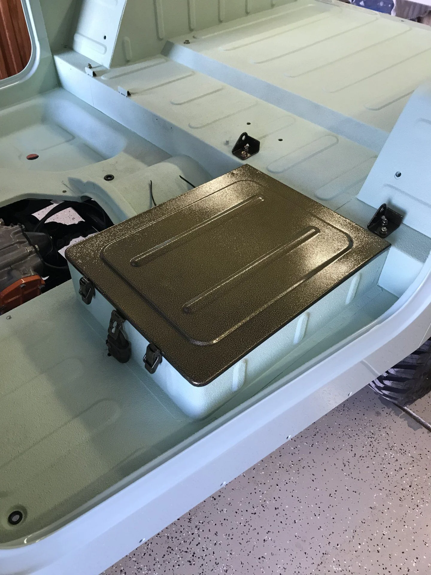

Today was little to no progress. Real time job got in the way :). After work I messed with all the tools and did my tool box, clasps, lid and tools. I was able to piece together an original Large Tool Kit roll #63-6609 (I think that’s the #), period correct bottle jack, an Original 1965-1966 owners manual ($$$ :() and dealer pamphlet. My grandpa had the original F-engine and chassis manuals and I tossed in a nostalgic rope and a drink decanter. I couldn’t find the lock, but ran across this vintage one on EBay to secure the OEM lid. All came out perfect for me.
I kind of made sure the ash tray went in tight so it won’t be used a lot and keep nice and in tact. Glove box lid done and new 3-speed shift plate in...

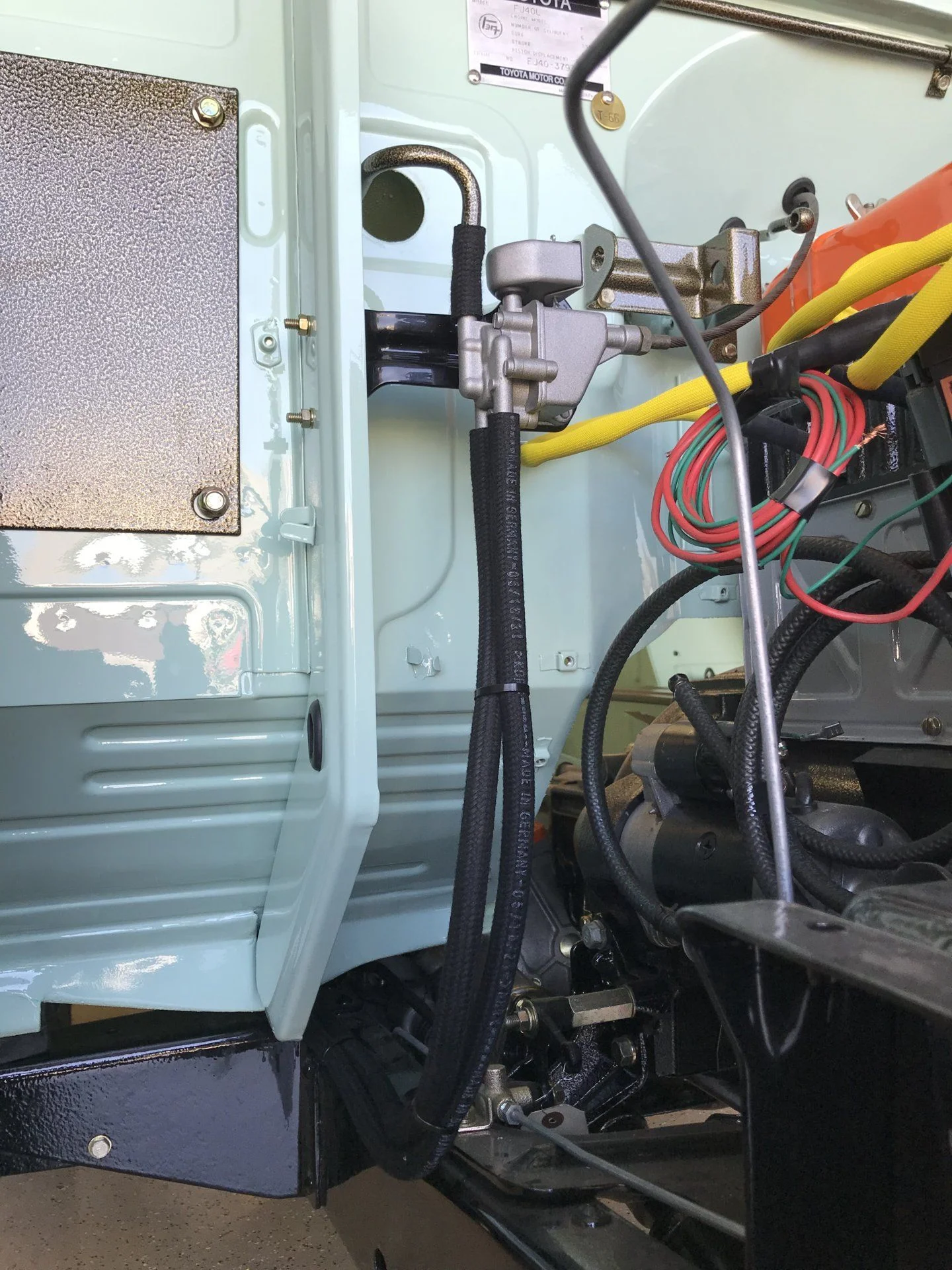

Worked on the 4WD vaccum system this morning. I ran the cloth braided lines straight from the diaphragm to the transfer valve. The old hard lines were bent to hell and this probably never going to see dirt, these should work fine. :)
Looking awesome Jason and you’re making great progress on it!! :D
Thanks Ross. Trying.... going well, I think so far.

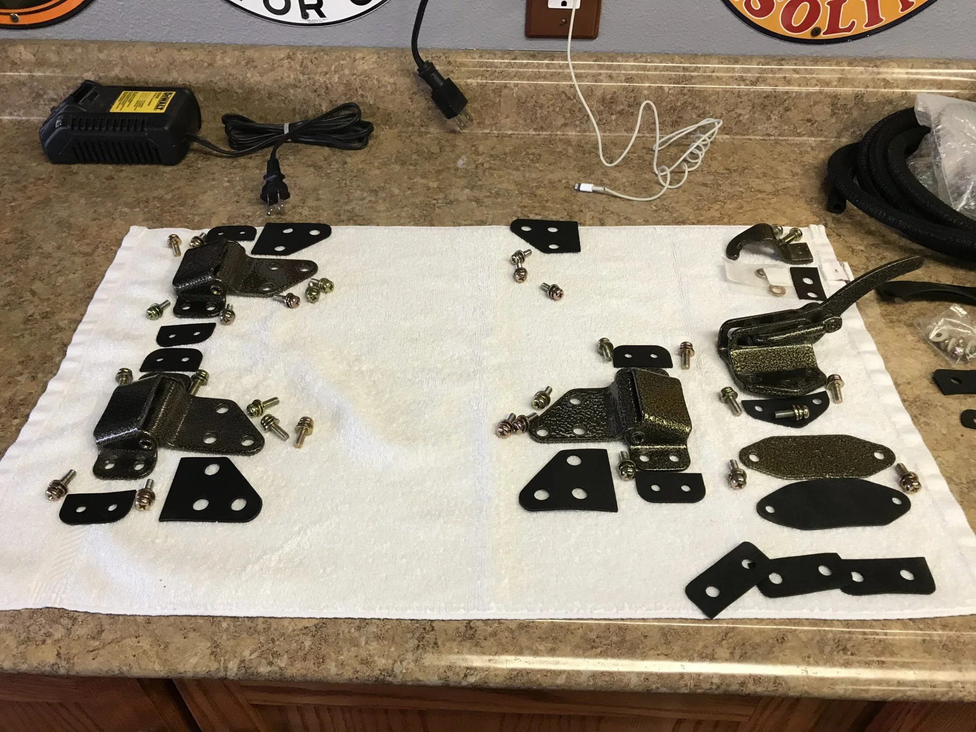

This afternoon, I finished tapping all the holes/zerts on rear and got hinges mounted for 1/2 doors and spare tire carrier. Also had time to hang the windshield hinges.....

This thing is beautiful. I am having difficulty wrapping my head around the hammer-toned items but I hope to warm up to them. :)
Yeah- I wanted to do something different than the normal OEM builds, these items in person, just pop really nicely and are super glossy. The color is called in the poweder coating world "Gold Vein".
