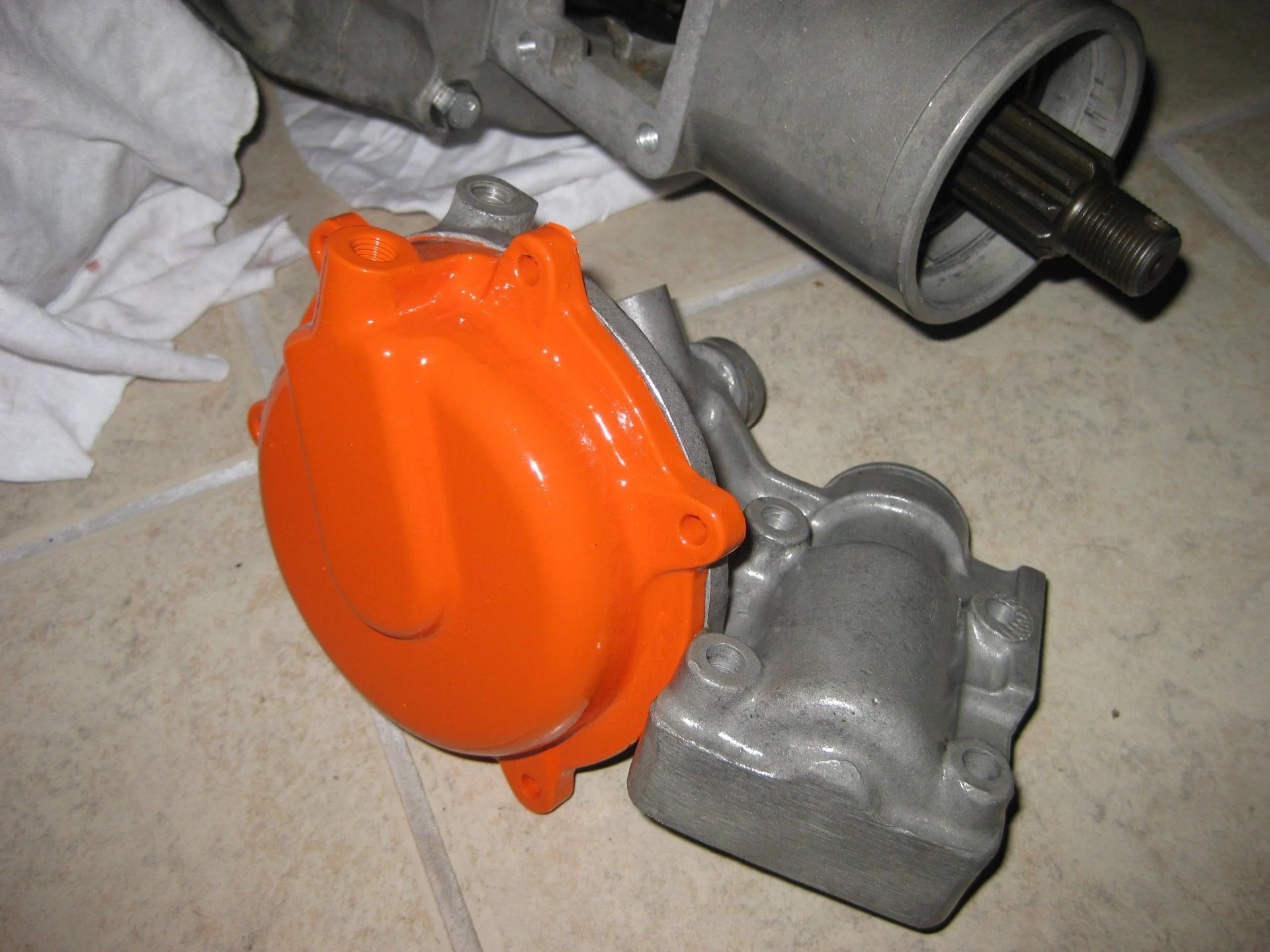

Here's some teaser pics of the tribute orange parts...

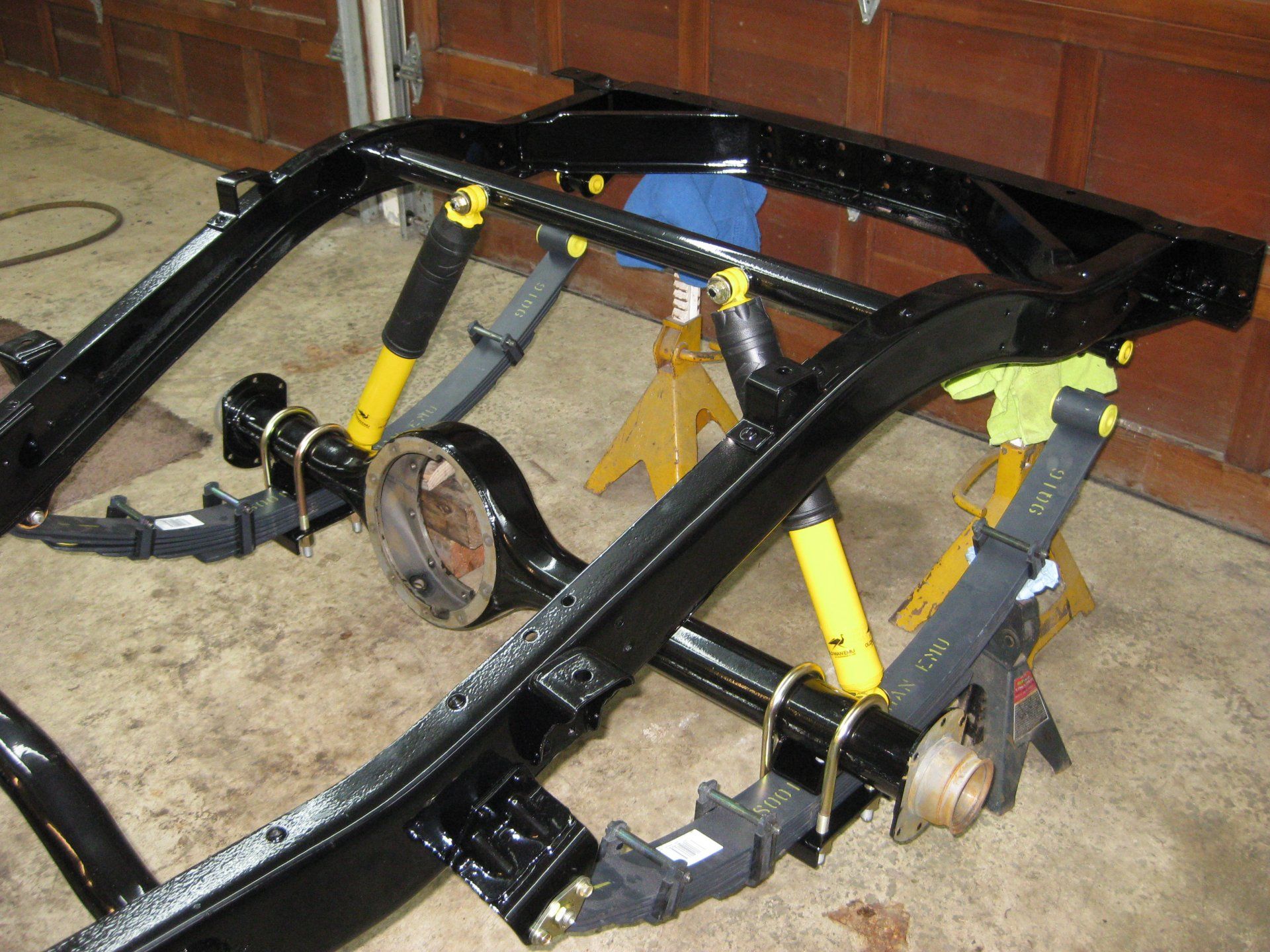

Started re-assembly today...
Fitting the shackles will be next, now that I know which lengths go where.
Chased all the threads and put new studs in both the front/rear axle housings also. the Loctite will set up overnight and then the differentials will likely go back in tomorrow.
Burst of productivity and the shackles are in, thanks @cruiseroutfit
Interesting, I think there's conflicting info out there, you are right though.
Got the front leaf spring orientation corrected yesterday, also installed the front and rear differentials
My real job is preventing me from working on this as much as I'd like. This morning, I was able to get both the driver and passenger side knuckles installed along with the knuckle seals.
Front spindles, backing plates, wheels cylinders and brake shoes are installed...
