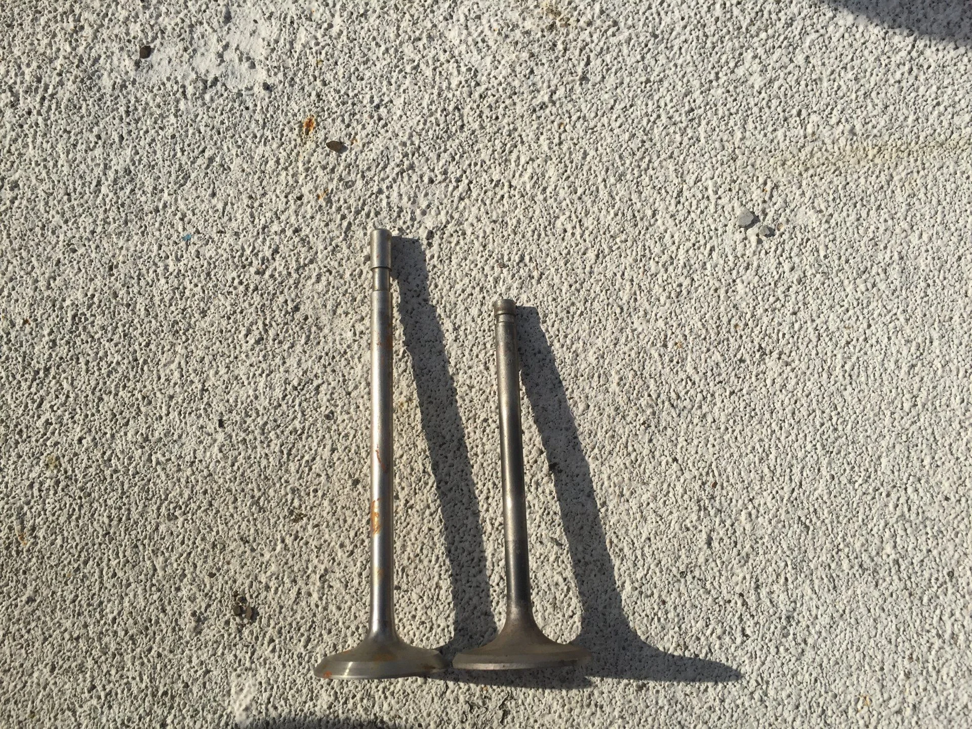

A pic should suffice
Left:F135;right:F145/2F

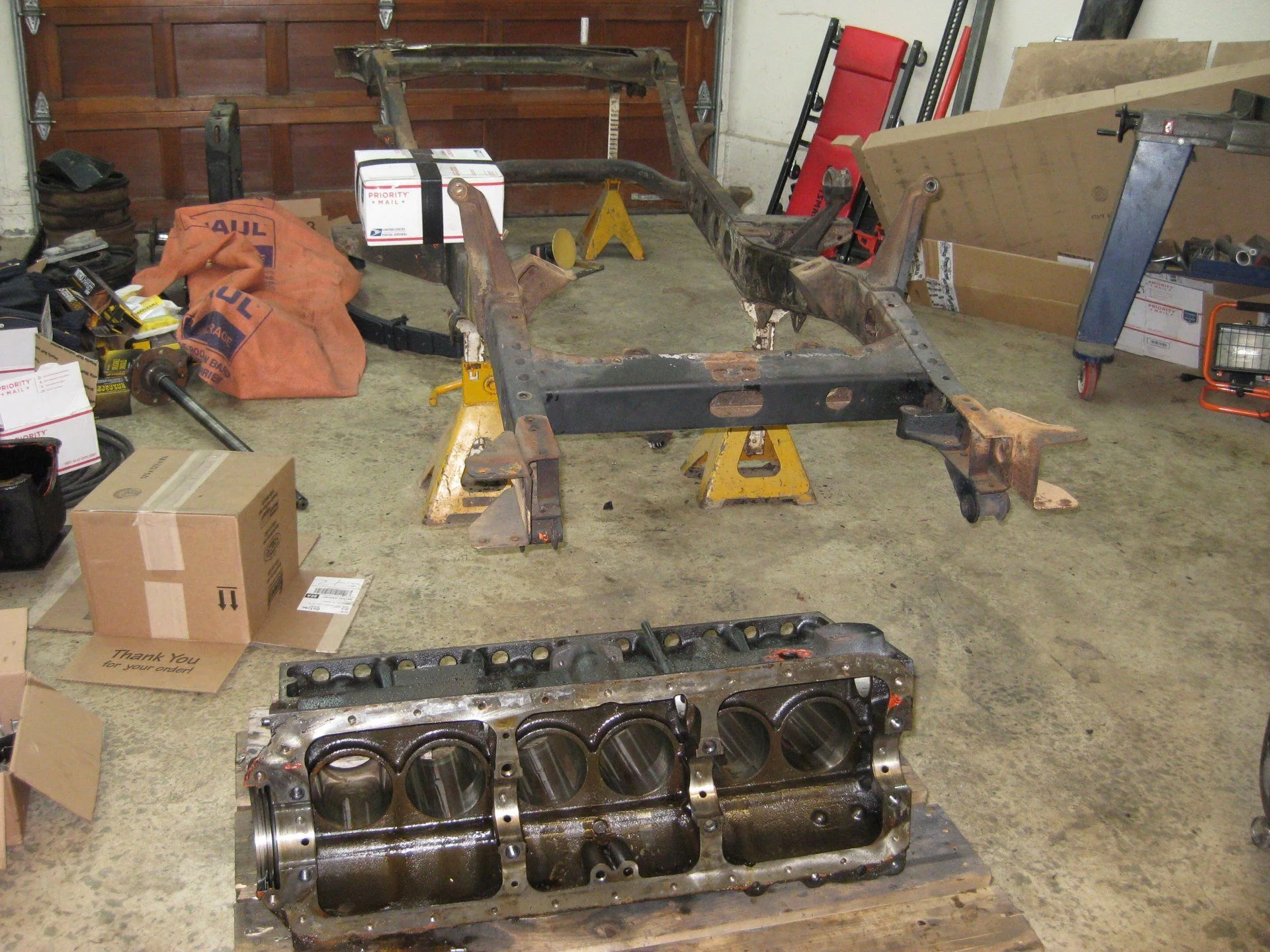

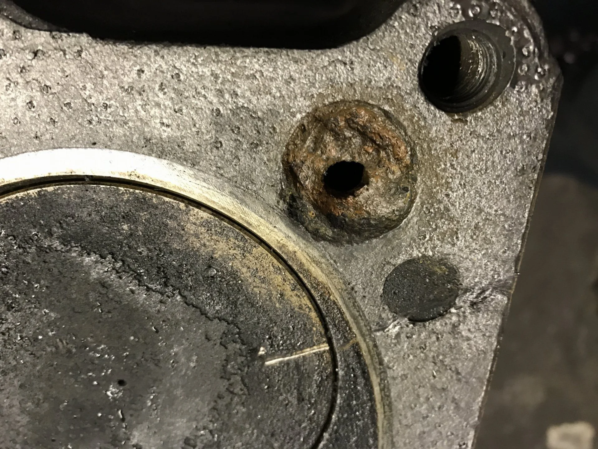

Hopefully this is the last of the bad news... I took the short block in to the rebuilder today, he is very experienced and is considered the best engine rebuilder anywhere around here. He looked at the coolant passages (especially this one) and strongly suggested "find a different block".
His concern is the pitting is so bad and has advanced so far toward the head gasket sealing surface that he has doubts about the ability of the head gasket to actually seal. That, and how badly deteriorated the coolant passages likely are. He stated this was the most horribly corroded block he's ever come across

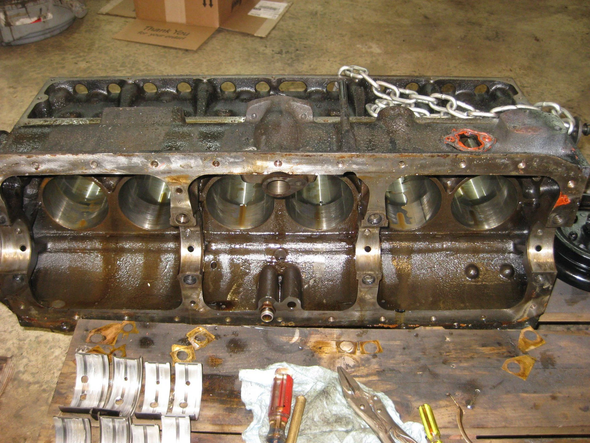

I hauled the short block back home to start disassembly. Both Mike (the rebuilder) and I figure the connecting rods, crankshaft and camshaft will likely be re-usable.

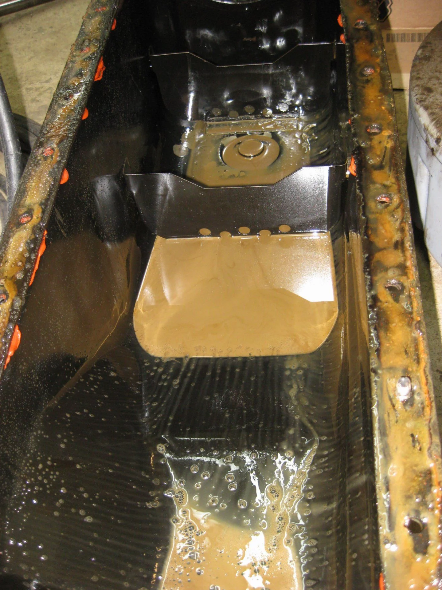

Pulled the pan, full of water and antifreeze ALONG with broken off cotter pins from the connecting rod nuts.

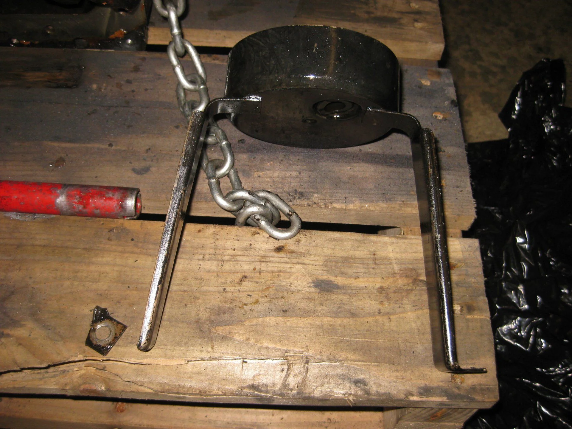

One leg on the oil pump screen/pickup was also sheared off. From the looks of it, it occurred long ago. The pickup screen also had large chunks of red RTV lodged in it
Starting disassembly after marking all the connecting rod caps...
Pistons and connecting rods and all out and the connecting rods are stamped (front facing) 1-6

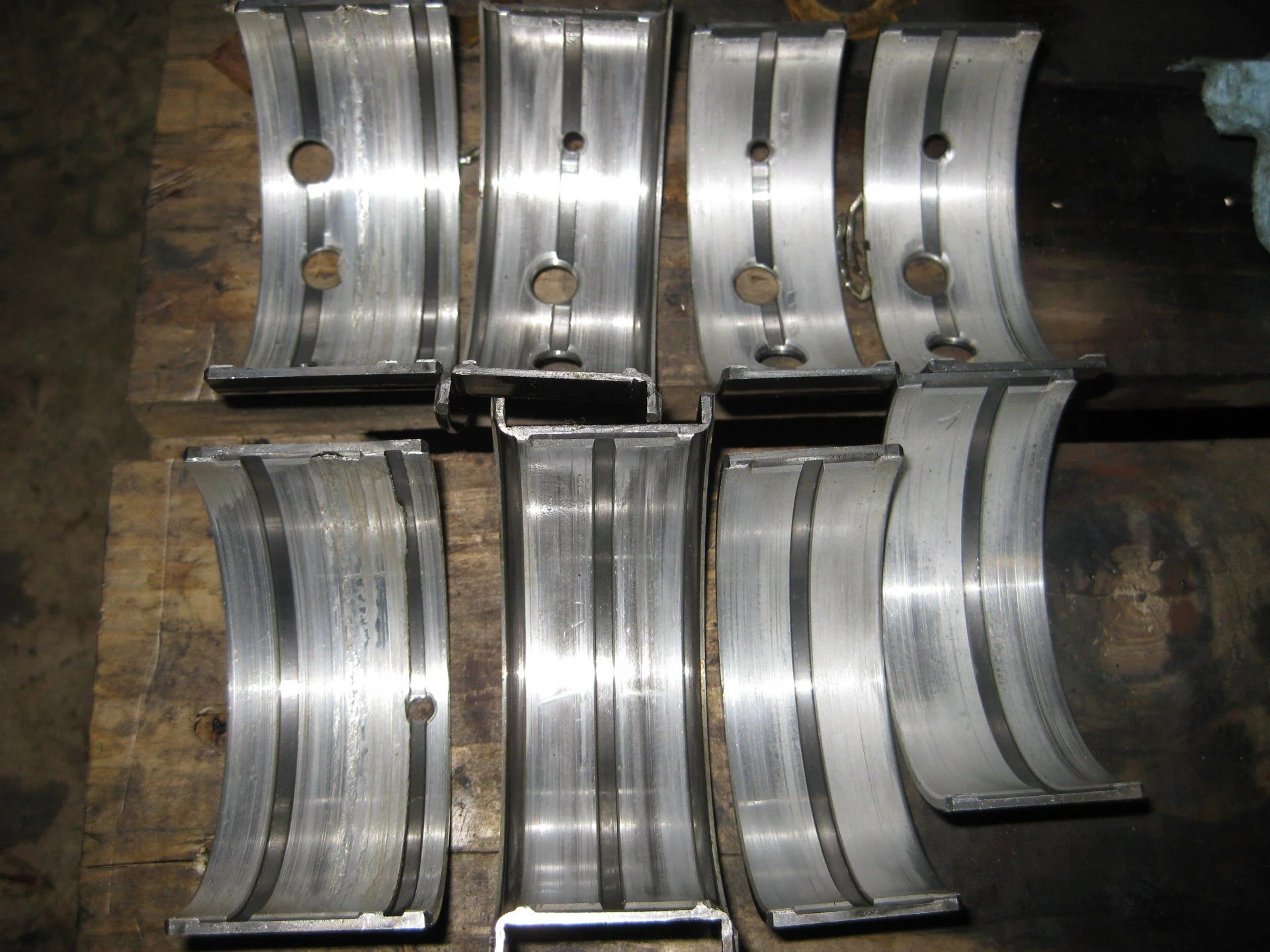

Main bearings....not good. The #4 bearing set is really awful. Either inadequate oiling or shimming is my guess. Either way, the bearing is starting to melt and separate. I'm VERY glad we found this Jason

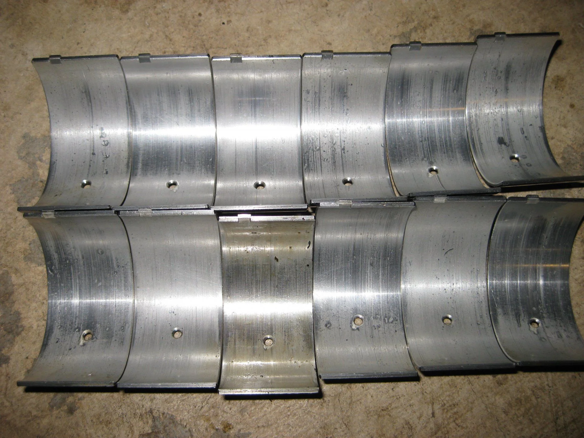

These are the connecting rod bearings Jason. Not "horrible" (I've seen much worst on Toyota diesel 1HD-T's) but not great.

Some of the shims were really ginked up and one of them had been caught up underneath one of the bearing cap guides. This destroyed the shim and must of really screwed up the bearing pre-load.

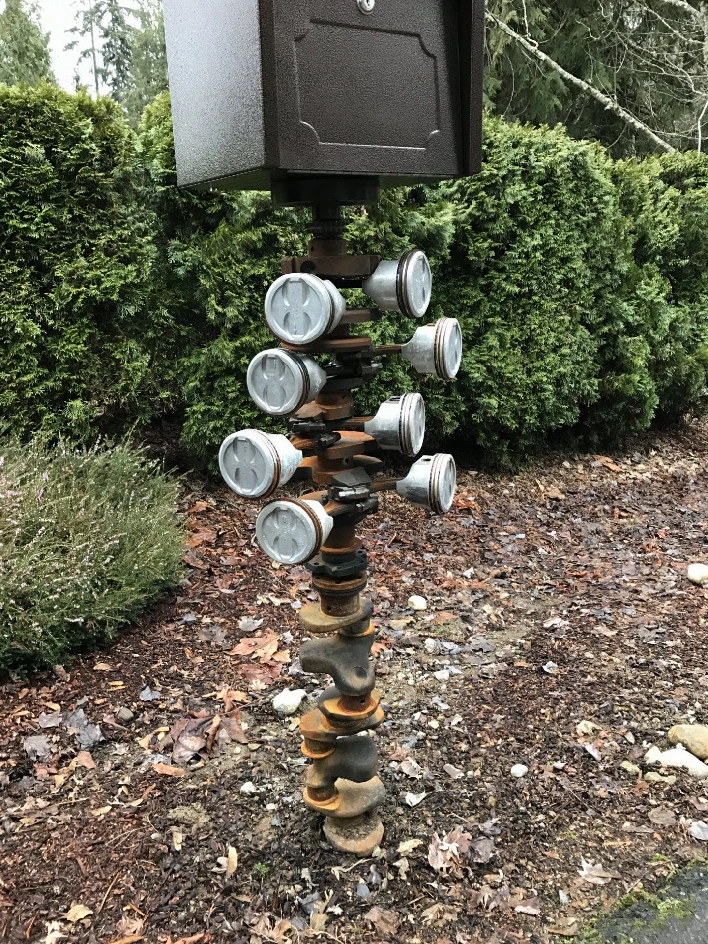

I told Jason: at least it doesn't look like this one!
This symbolizes the symbiotic relationship of GM and Toyota components in my FJ40. Yeah, it's an "F" crank welded to a small block 350 crank. University level bulls*** art. It also functions as my mailbox stand

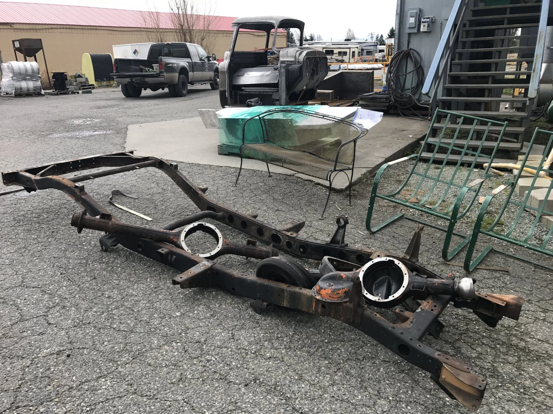

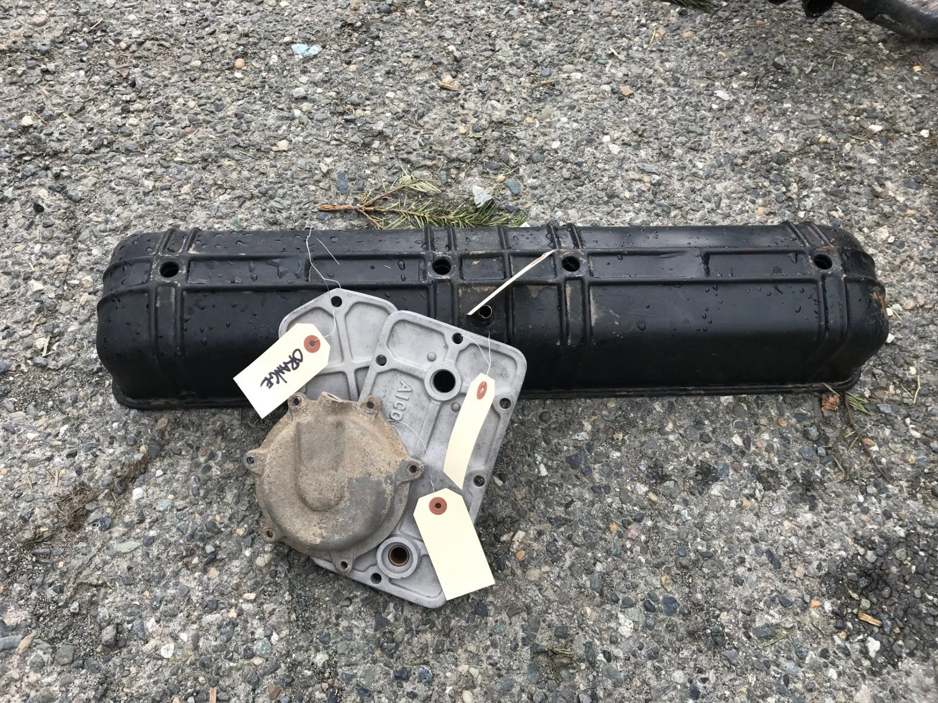

Dropped this pile off for powdercoat today...
It should all be done around the 14th of this month. Chassis parts will be high gloss black and the valve cover and assorted transfer case plates will be orange
