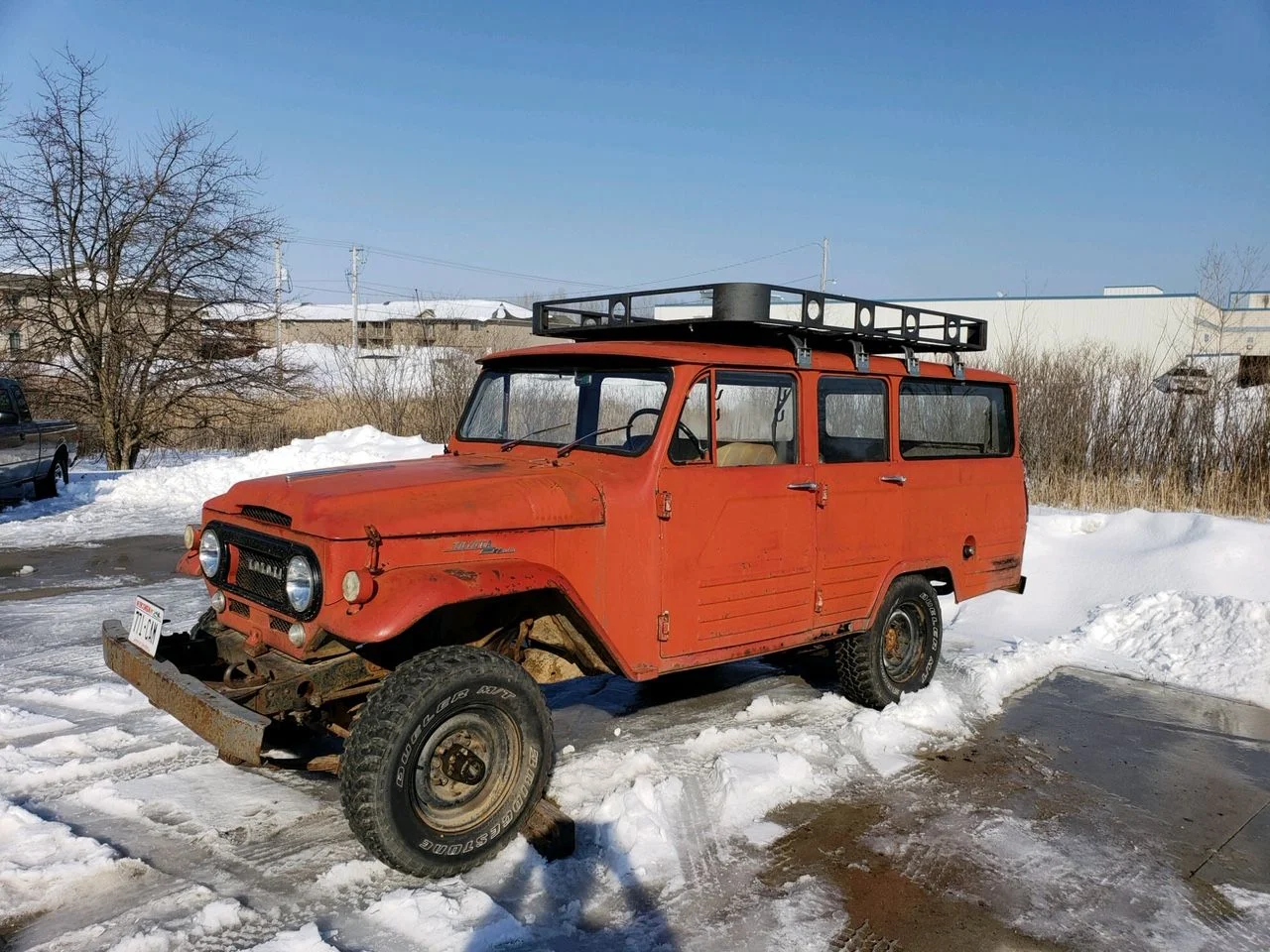

Hello 45lv community. I am in the process of bringing this beauty back to life. The story behind how I found it and why the undertaking:
The fast version is I found this in CO back in 2001 using the internet, when I was young and dumb and in love (with the LV and a girl), so I thought it would be great for my girlfriend and I to fly out to Colorado, pick this beauty up in Longmont, and drive it back to WI. We did this in August during a record setting heatwave, with small tires and the asphalt baked heat blowing up to our nether regions. The trip wasn't near as romantic as I envisioned. In fairness, the girl was game for the first 48 hours, but after that she lost steam and didn't speak to me for the last 48 hours. The LV was game for the whole trip, and actually made subsequent round trips to Idaho a couple times. After that, life ran away from me and it was no longer practical to use the LV as an everyday driver and the plan to restore it in my free time became a fantasy. The good news is the girlfriend returned to speaking to me, and has been my wife for over 16 years. We've decided 2019 is the year to bring the cruiser back to its original glory and take the kids on adventures with it. We're going to try our best to keep it original, but failing fast, so we'll see how this all shakes out.
I'm reaching out to the community as I know less than zero about restoration, and am just smart enough to know I need all the help I can get. My hope is that as questions pop up, I can serve them and see if something shakes out. Thanks for joining me on the adventure.

Thank you and great question. Current plan is to create a painted safe driver with some modern touches. Some day true stock, but that is probably a fantasy.
