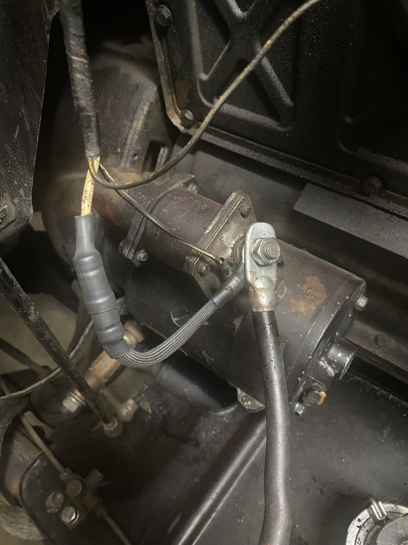

my ‘64 did not have a fusible link so I ordered one from @Coolerman. Easy install. Probably will shorten the harness side of the wire later but they are all taped up and didn’t want to get into it today.
