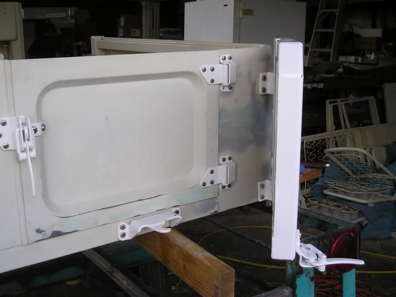

Still geting this thing ready for paint..
Mocked up the tailgates, latches, sparetire carrier hinges, and latch for the carrier. Had to drill new holes for just about everything since the new panels and channel don't come predilled..
For my new c-channel where the part that the spare tire carrier latches too apparently had a backing plate on it as well. I thought I was never going to get thrugh those 3 layers of steel
Forgot to get a pic of the carrier while I was there, just the tailgates..
Next time I get to the shop and actually remember my camera I'll shot a pic of it mounted.

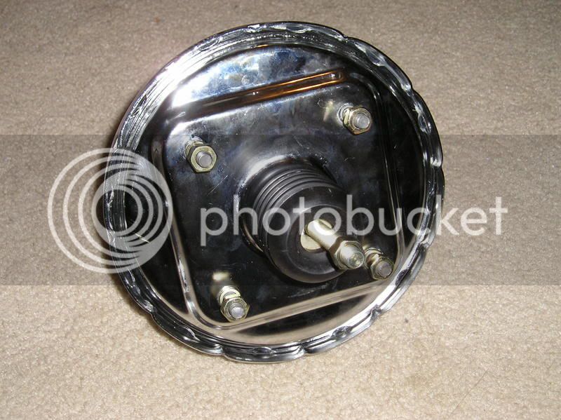

The adapter came in from MAF..
Bolted right up to the booster and firewall like a charm..
Also it looks like it came powdercoated, little perk I didn't know about. MAF's pic shows it zinc. If anybody wants to do power brakes I think MAF's GM kit is probably the way to go.

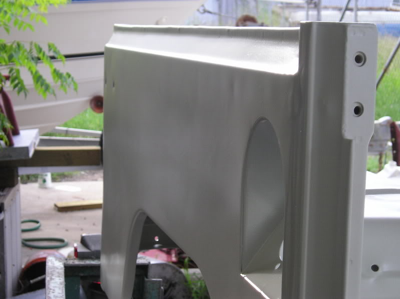

Got to put some paint down.
Put a coat of Corlar on. This is still a primer. Gonna let it cure then sand this real smooth. Then topcoat with Imron :D Maybe one day I'll be able to mount this tub to the frame
holy crap....thats a good looking re-build, ill be keeping track of your progress man...looken good
