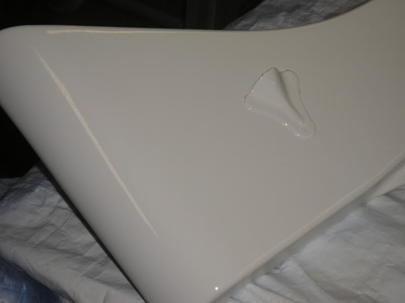

Well it looks like I'm finally done with the tub.
The passenger side got one coat more than the other side because I had a couple :whoops: s
But in the end it turned out pretty good. It was hard to get any real good pics in the dark shop, but here are some. Gonna try to get the tub line-x ed on the inside floor and the complete underside this week and then try to mount it up to the frame. And then maybe I can get this thing out in the sun light.
Here is a couple pics of the tub being painted.
These pics help show some of the gloss in the tub.
I took some of the small pieces out in the sun it looked pretty good. I'm starting to get excited now. It's starting to look like a new cruiser :bounce:
I coated a bunch of small stuff also, like fenders, aprons, bib, running boards, tail gates, two bi-fold parts, tool box lid, the frames for the doors, and the little windshield vent flap thing.

The pics may have looked a little hazy because Imron was everywhere in the air.
If you ever paint Imron make sure you wear a good resperator, or you might lose a left lung something to it. Nasty stuff.

Aren't you supposed to use a fresh air respirator when spraying immron?
Paint came out awsome.
It's preferred that way, but the paint guy said a good new respirator would be o.k.
I think it typically only effects like 20% of people that use it, and I painted a boat with it the same way about 10 years and I can still breath most of the times.
