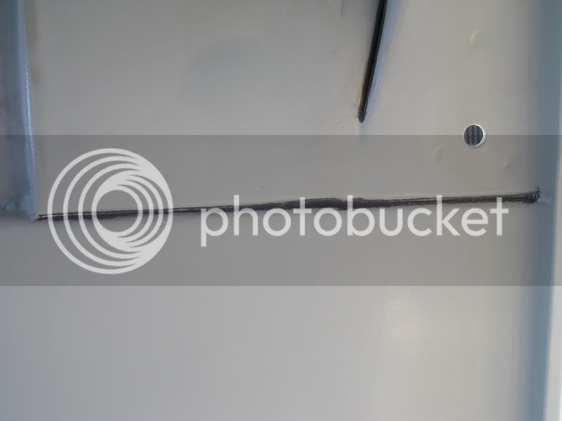

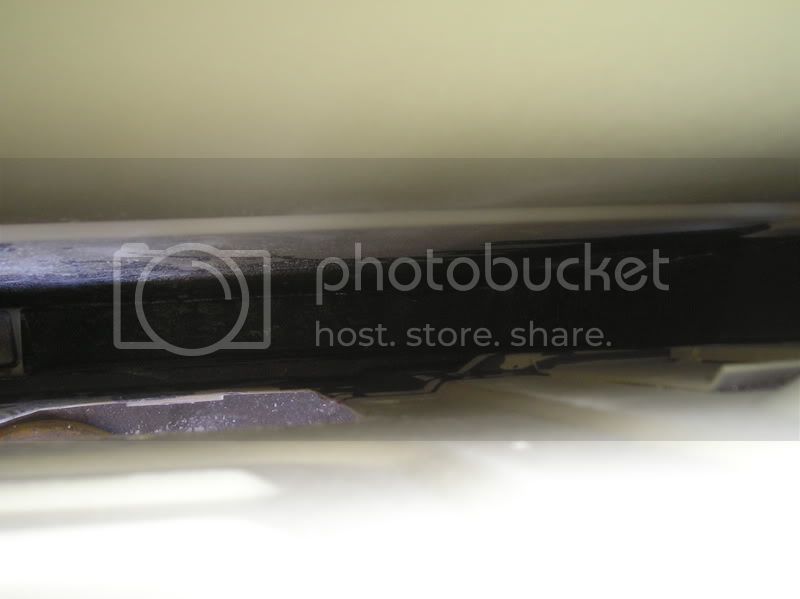

when I walked into the shop last weekend I saw some little rust spots on some of the seams. So I got kinda pissed and painted all the seams with POR15. Yes all of them.
Here's a couple pics of the seams..

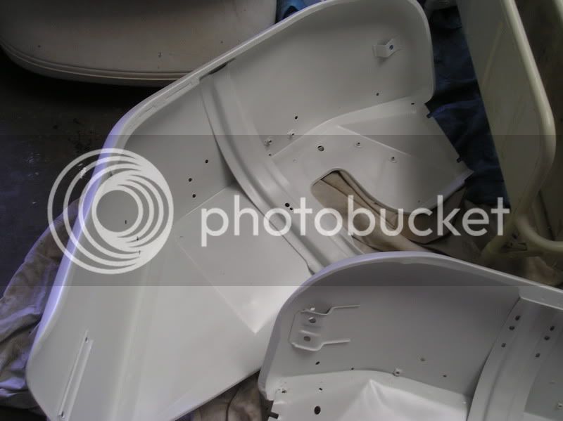

I have also coated the insides of the rear tailgates with POR 15, by simply doing what I did with the doors. Poor it in there and rotate the piece around.. I don't think these things will be rusting in the inside any time soon. BTW I cut some drain holes in the bottom of the tailgates to let any moisture and such get out..

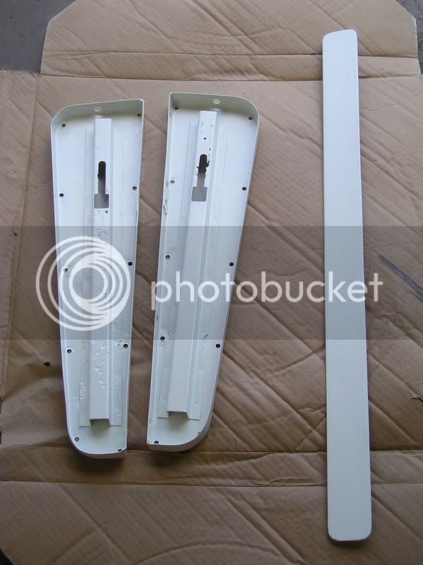

I also did the same things with the por15 in the running boards. Did it down inside of those ribs..
This pic is before the por15 process so it isn't quite as clean anymore :D
In the pic is also the vent flap that I gone ahead and put a coat of Corlar on..

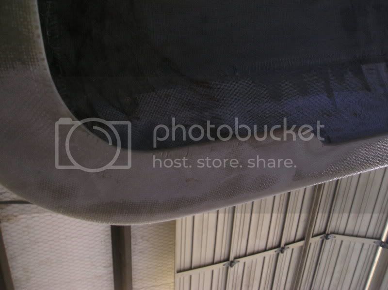

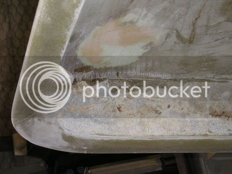

My fiberglass top has been sitting over at the guy's shop that built a boat for me. He removed all the rusted rain gutter and built a new one out of fiberglass, he also patched a hole in the top where a cb antenna was mounted, patched another area that had gotten messed up pretty good, and also put a new layer of cloth fiberglass down on the inside which streghened the top up a whole bunch. This old fella is a pure perfectionist in his work.
Here is what the outside of what the gutter looks like, it doesn't come out with a lip like the metal stuff, but is incredibly stronger. I don't think the lip is necessary anyway.
Here is what the underside of the gutter looks like, really stronger than before, and is outlined just like it was before.

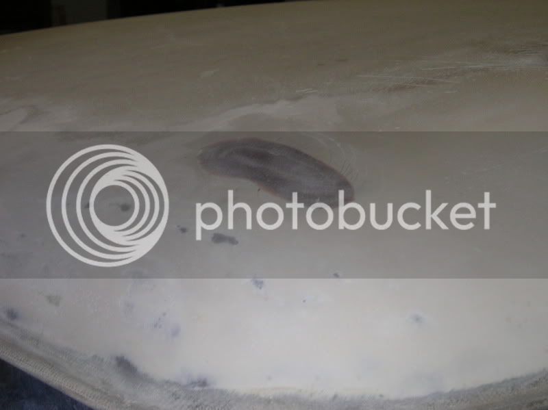

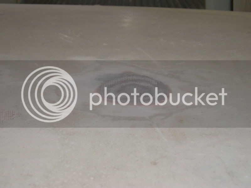

And here is a couple pics of the area he patched where the cb mount was and the other problem area.
At least it can't RUST anymore!!
