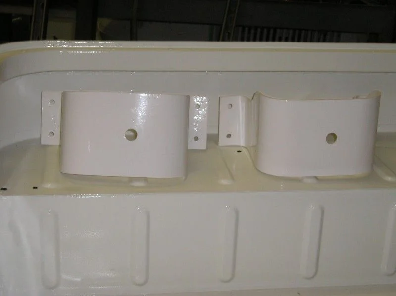

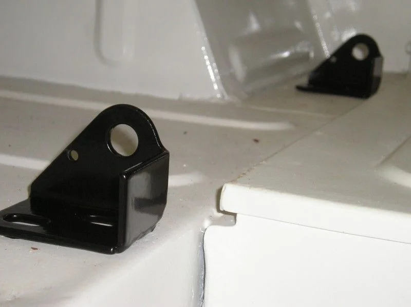

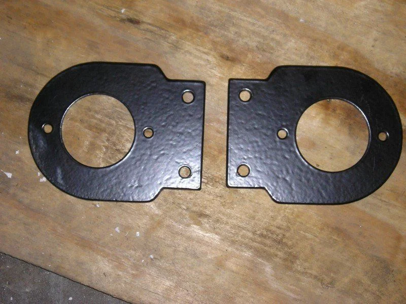

Few updates here, got my tail light brackets and front seat brackets back from powdercoat and turned out very nice.
Got both products from fellow mudders. Tail light brackets came custom made from Volunteer, here is a link to them https://forum.ih8mud.com/showthread.php?t=143114
And got the front seat brackets from 72cruiser, thanks man.

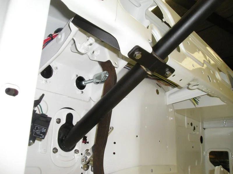

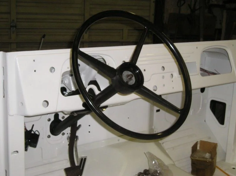

Also got the mini-truck p.s all hooked up and ready to go.
Cleaned up and painted shaft and brackets.
Now on these old shafts, they got weird rubber plastic thing for the column to rotate on the inner shaft. I wasn't really liking how that was working out, so I cut that off, and installed two bearings in instead. Got one way down close to where the shaft meets the gearbox, and one up close where that rubber deal was. They are definitely not going anywhere, took heat to get them on the shaft, and a little patience to get the column over them. Placed them where I could oil them if I needed to, bottom just past what looks like a wiring hole, and the other I can just pop the wheel off and get too.

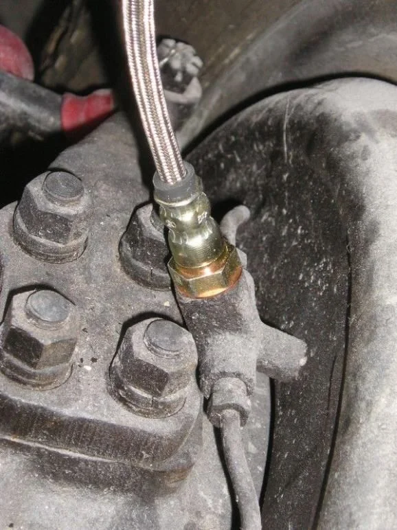

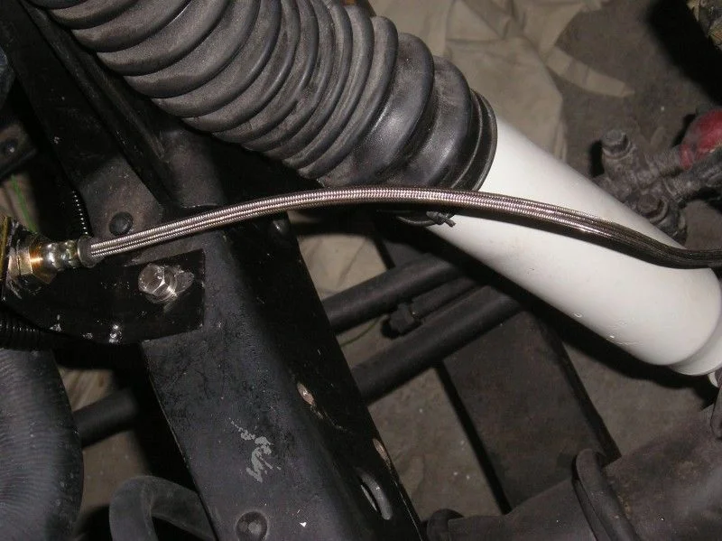

I've also got the brakes just about done.

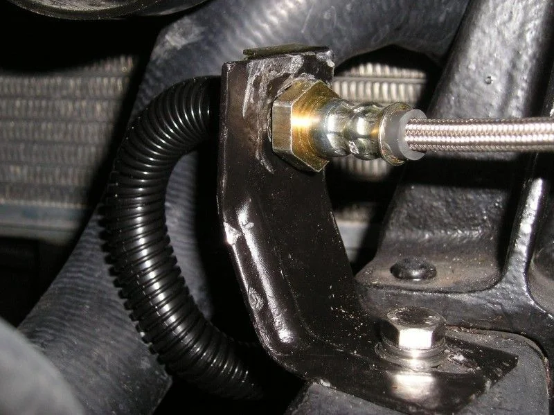

Had some stainlesss braided made hear locally. Down by the drum it's metric of course, but I had the other side converted to an 7/16" SAE, that way I can have everything a more readily available thread, instead of having to deal with metric.
Gonna run separate lines for the rear, and one for the front. Hard lines everywhere except for the extended lines.
Since most of the hard lines are running through the frame, I ran some of those wiring protective sleeves over them, so that they don't rub on the frame and try to cause a problem. And don't worry I got them setup where they won't hold moisture.
First pic is the metric joint at the drum, then the bracket holding it on the frame, and then an overall pic.

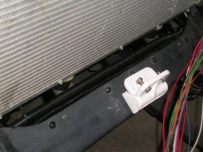

Here's a pic of where the lines run across the front, there you can see the protective sleeves I'm talking about. Just need to get some clamps to hold the lines, like they had stock.

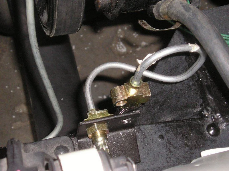

Here's a junction where I got the passenger line running up to the bottom of the tee, and the driver line into the top, then of course gonna run one line to the m.c.
It looks a little silly, but I'm gonna say it's a vibration loop, you know keep the line structurally sounds and all.

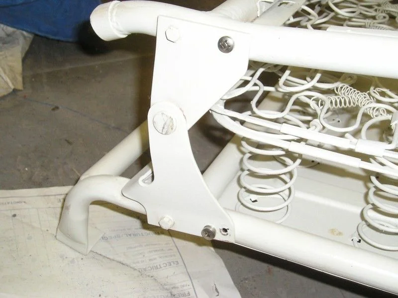

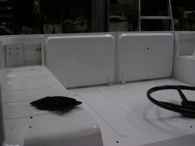

Apparently the passenger front seat was modified to be mounted in the rear bed, kinda like a jump seat. So I got to re-modify it :rolleyes:
Also fixed some threads that were stripped and one the front driver seat there was a spring that was broken, welded that up so it will work since I couldn't find a replacement. Not real pretty but it works and it's not like it will get seen anyway.
