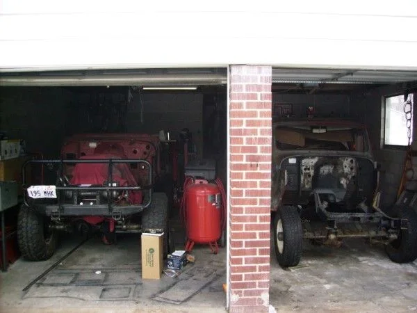

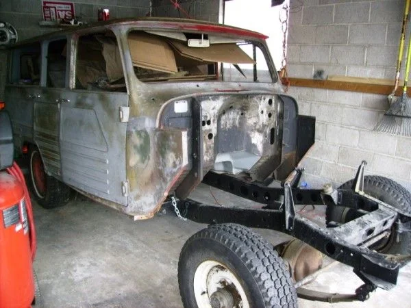

pics finally something for you all to look at.
here they are.... at least a few.
#1 : my old 40 project on the left, Lv on the right
#2 : the Lv
#3 : loads of parts.... in need of sorting...
That LV body was a cream puff. Cant wait to see more picture MD!

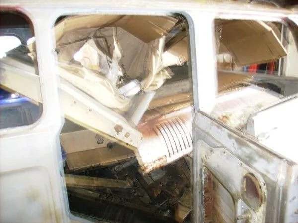

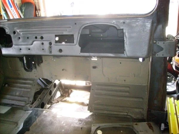

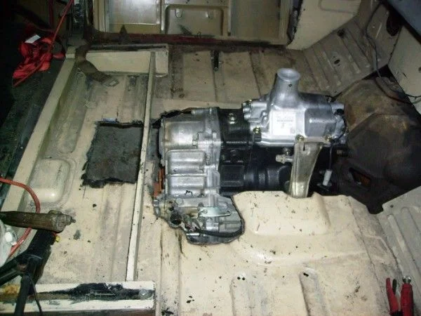

ok it's finals week in school... i haven't been studying like i should but i have made some progress in the garage. here are some pics. i have be wrestling with waht motor to put in a nd the 3FE won out and droped right in, all i had to do was slot the frame mounts like a later model 40 and it went in perfect. i also got the 5 spd in that took a little work and some help from the plasma reactor. the floors already need work whats a little more right? this week end i think i am going to put in the 4wd shift linkage so i can finish chopping the floor and the dog house up...

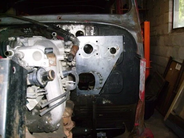

i think i may run into some space isuses in the brake master/intake area any one know were i could see some pics of what others have done here?

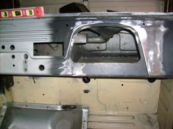

Heres what i am doing with my 40. I need the later firewall for brake booster and column due to fj 60 steering and diffs. Body mount was also rusted out so am doing that at the same time.
It's not that hard if you measure everything carefully and take your time. you will also need the latter pedal assembly
still needs cleaning and welding but you get the idea
cheers Steve

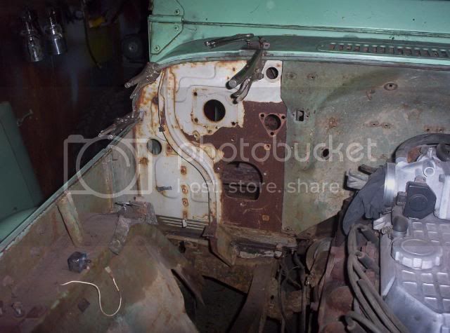

fire wall update
it's been a while... lots of work and school not so much cruiser. over the last 2 months i have repaired the glove box, put a 77' pedal assembly in and also a 77' steering wheel. i have also found more rust than i like in some pretty bad places... oh well it's a cruiser right? here are some pictures.
