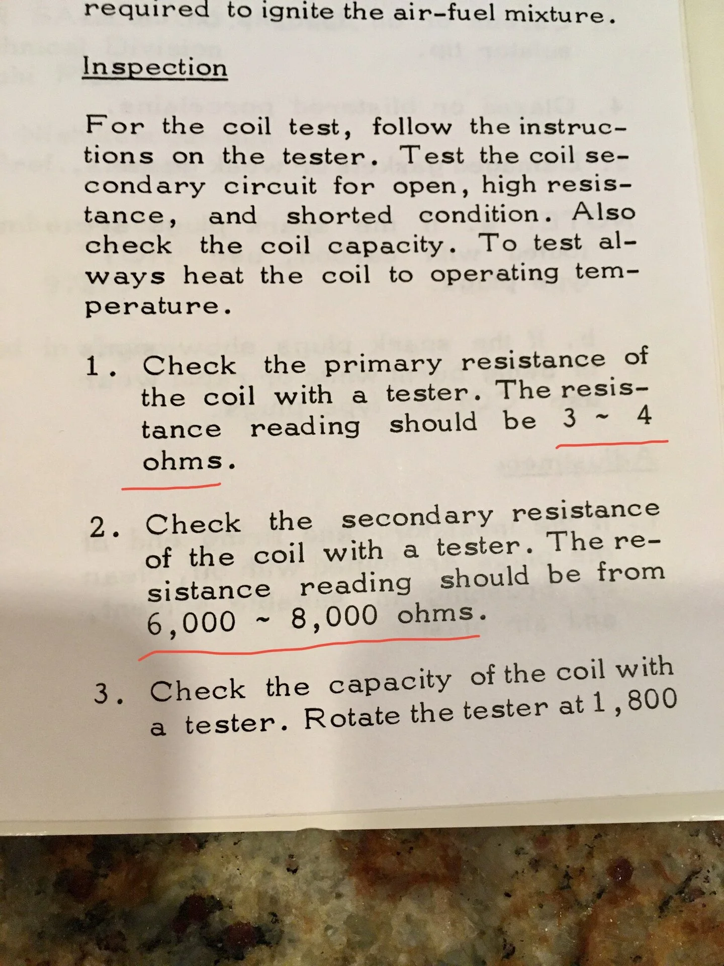

So the dead aftermarket coil (on right) from a forklift supplier has a primary resistance of 1.8-2.1 ohms and a completely open secondary. Its aftermarket replacement from city racer (on left) has a primary resistance of 3.3-4.0 ohms and a secondary resistance of 6.88k-6.91k ohms, so that should work (see below from F-Engine Repair Manual). It gets installed tomorrow. Included bracket is too narrow for the mounts on the 1F head but the original bracket will be used instead so no biggie.
Coil works and rig is back running :bounce: but my Speedhut tach is tango uniform:bang:. Should still be warranted.
