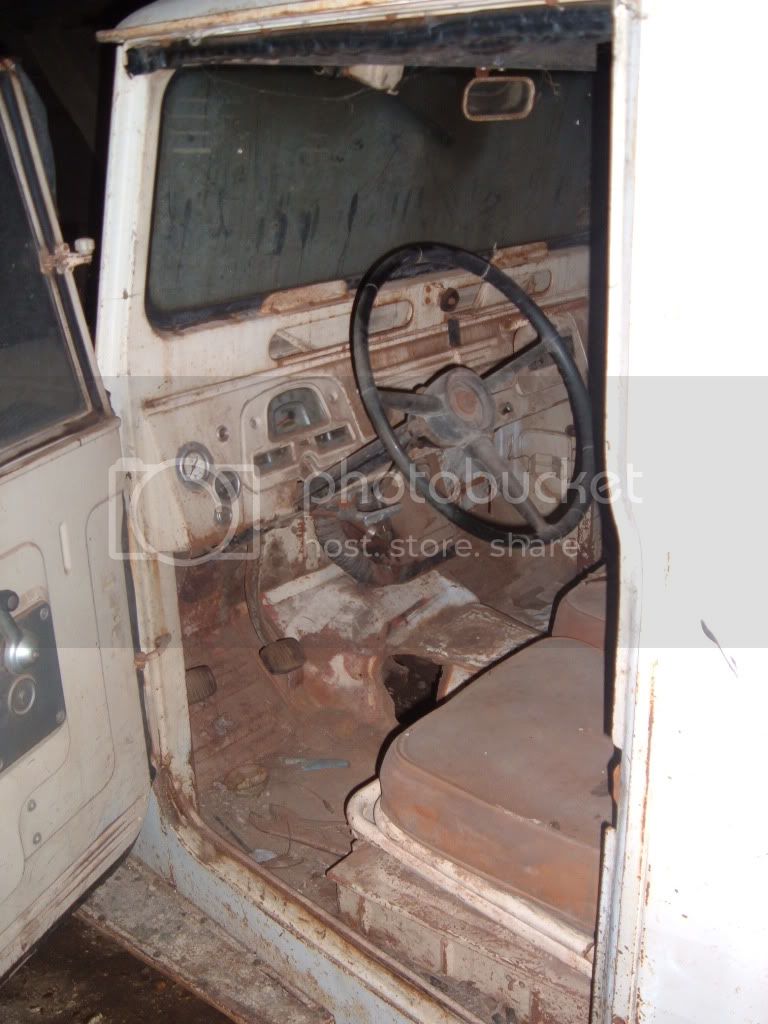

Seats done. Not a great job, but close enough. One of these days I might actually learn what a ‘62/‘63 FJ45 SWB fixed top had for a driver‘s seat. Until then this is what they have! 😂 based on all the pics I’ve looked at.
This is one of the pics/threads I used to figure out the seats. For tech, note that the seatback hinges mount to the lower bottom rail in D’Animal‘s rig, and they mount to the upper bottom rail on the mid-’63/‘64 seat I used. That makes it harder for me to slide the seat back and still have room for the seatback to clear the back wall. Huge deal for good fitment.
But then, maybe not. Here’s a pic from John Pardi’s @pardion immaculate restoration of an FJ25 a few years ago.
As you can see, the seatback hinges are actually attached to the upper bottom rail like mine, welded vs. bolted. But in either case if the seat is slid back, then the back slides also, which makes sense for a 25 or 40 because there is no back wall to interfere with. So unless I’m not interpreting these pics right, it looks like the very early 45 SWB fixed tops had unique driver’s seats that allowed the seat to adjust but not the back given the tight quarters.
still editing 😂 - the bottom position sets the angle of the seatback, so the above might not make sense unless as the seat bottom moves back the seatback becomes more vertical. Maybe?
And then there’s FJ40Jim’s earlier 45SWB (now @CHUOX17A ’s), this pic looks like the seatback hinges are mounted to the upper bottom rail (barely see it in pic).
@CHUOX17A do you have a more detailed pic of your driver’s seat you could share? Thanks!
