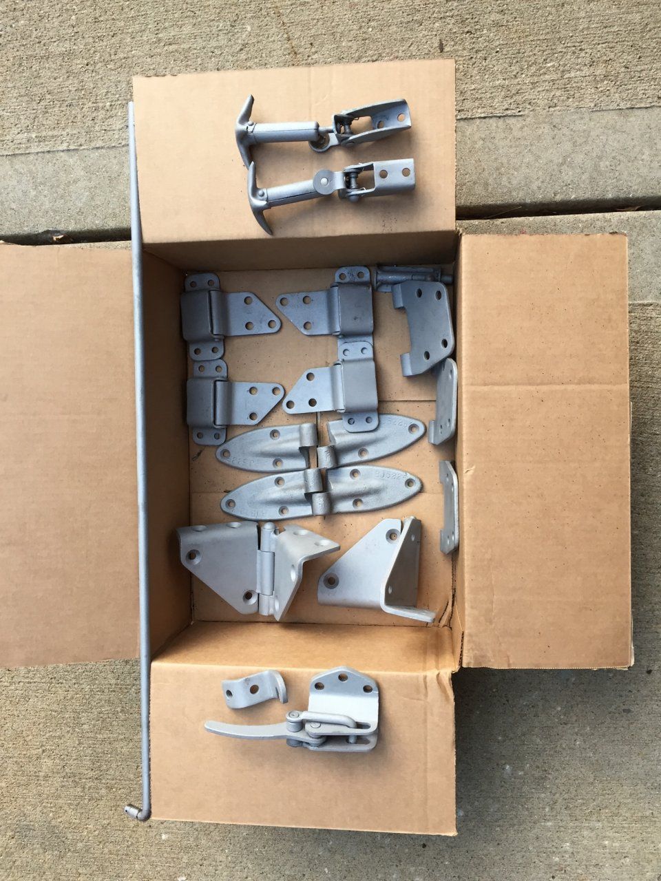

Another challenge: the hood hinges. Early 40s used hinges that (I think) had a pin pressed into one half. Time has not been kind to them and mine came with a big bolt run through them held in place with a square nut. It looks like others on here have worked out varying solutions, including a stainless steel pin retained with a C-clip.
If you look closely, you'll see they have some numbers cast into them. Looks like "BJ5225".
Yeah I’m chasing that damn cat (curiosity) again.
@Mikesta i have the same hinges and one of them has the same Allen wrench bolt that you show in the middle pic. Is this stock anyone or an incredible coincidence? (Yeah really old link)
It is according to these hood hinges.
ya know if your read Japaneese... would you know what a number / letter actually is?
BJ parts on a FJ.
It Reads BJ 5225 on the top of the hinge.
View attachment 27088View attachment 27089View attachment 27090
Yes. And doors, gas tank, trans tunnel, tool box lid, even the instrument bezel and glove box door (until I made them pewter).

Jingle Bells 🎶 🎵 🎶. Thanks Duke @offkilter .
Not the exact match for a ‘63 but close enough.
Goes well with the handle and rod I got from Dan @dmamj ! Not even sure I know what STO stands for. Short TakeOff? 😝
Now I need the tool box jack bracket.
