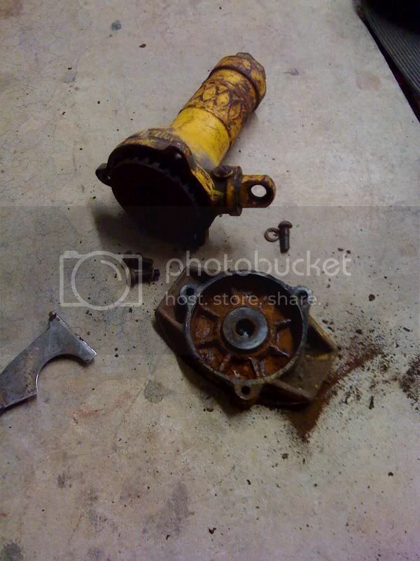

Then, I mounted the Winch control and ran the wires for it as well:
That was fun.....

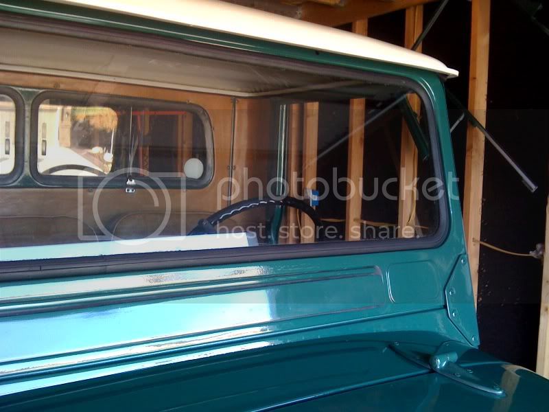

Setting up the weatherstrip and seal:
fitting the lid....

Thanks for the compliments! Now, I am just waiting on the door kits. Then, I'll drive out to the shop and toss the bed on :-) Today I am wrestling with the windshield gasket, argh.

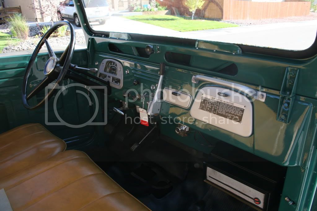

Hello again my friends. I have been busy this week thus far and hope to be tying up the project this weekend with the last of the gadgets.
These last two months have been a real struggle. I have had to put in major hours on this thing to get it where it is. I have tried to do EVERYTHING myself. Not to brag or boast or anything, but just to look at it in the end and feel some self-accomplishment. It's my anti-depressant.

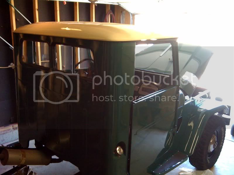

The paint process was very difficult. I have painted several cars in the past, but this one for some reason was very hard. From the base coat not covering well, to major temperature fluctuations, to running out of materials, you name it. It was tough.
As you know, I painted every piece individually the best I could. Upon bringing the doors home the first time, the kids were riding bikes in the garage, hit the trash can and pushed it over into my doors and knocked them both over. I had to repaint both doors.
Then, I put a ding in the paint installing my glove box door. That had to be fixed. Sorry to whine - but just letting you guys know that it has been a rough go this last month.
Much good has come of it however. Having painted cars for the last 5-6 years, I learned a ton on this one and paint jobs in the future will benefit.
I have made some genuine friends.
My wife was really involved in helping on this project - totally cool.
I love rustic green - best color ever.
AND, I am about DONE and ready to start on the next project. WOO HOO
So....This afternoon I am going to get the bed and get it mounted onto the frame. I am really excited because the bed came out really nice. I was worried at first because when I was in the booth, I had the temp control shut off to conserve LPG. Well, the temp dropped nearly 20 degrees in a matter of minutes and I put a run in the passenger side.
I had to use 800 to block it, then hit it with 1500. Then 2k and 2500 3M polishing compound and it turned out very nice. I am stoked about it.

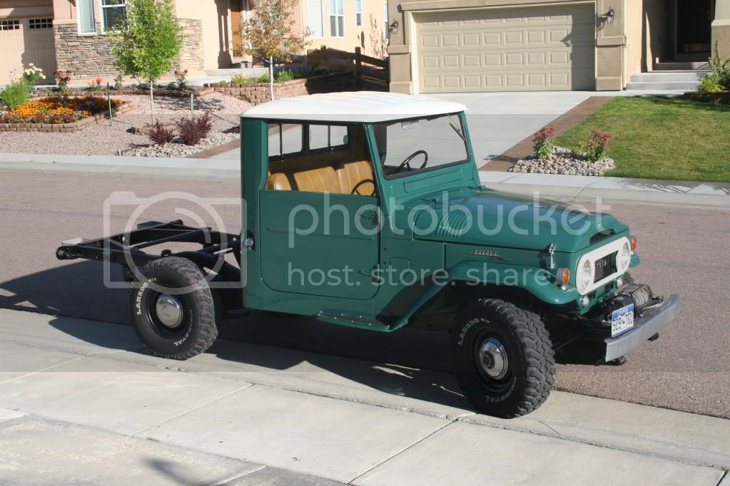

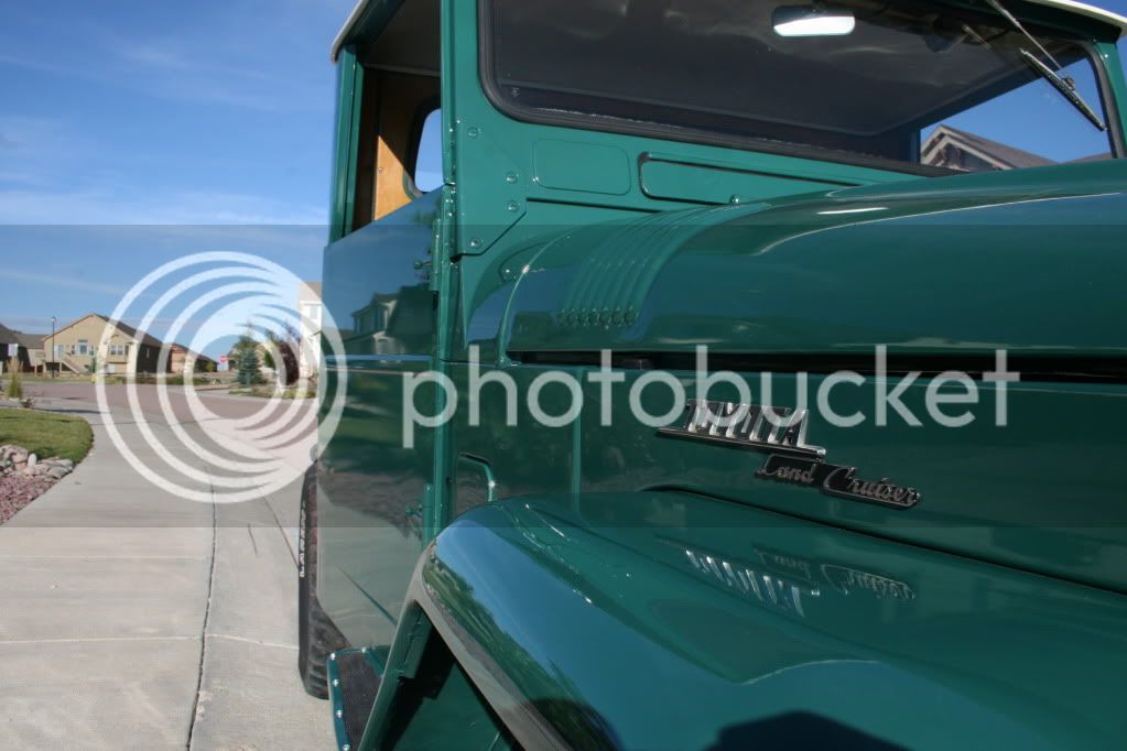

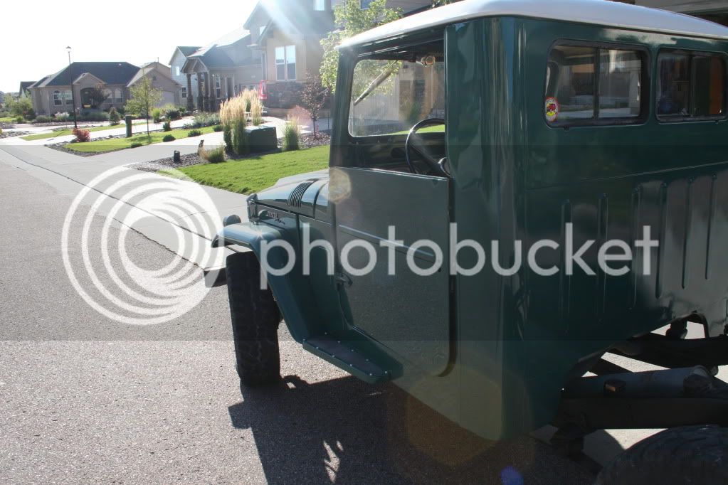

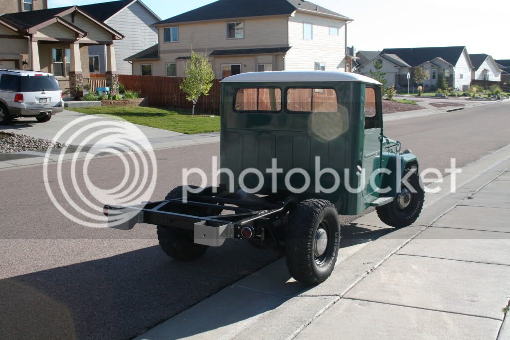

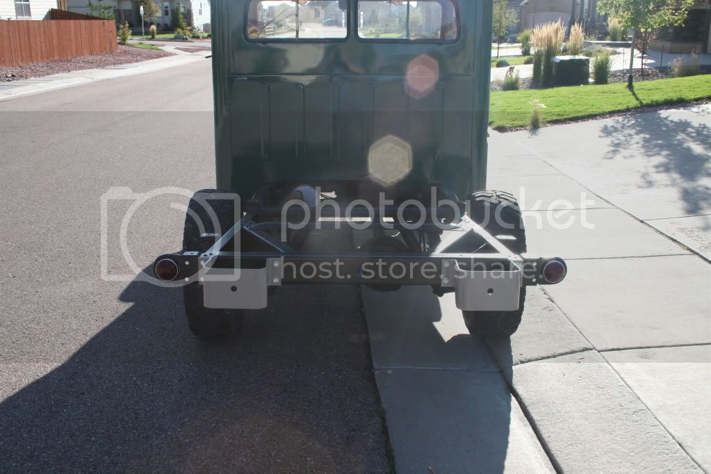

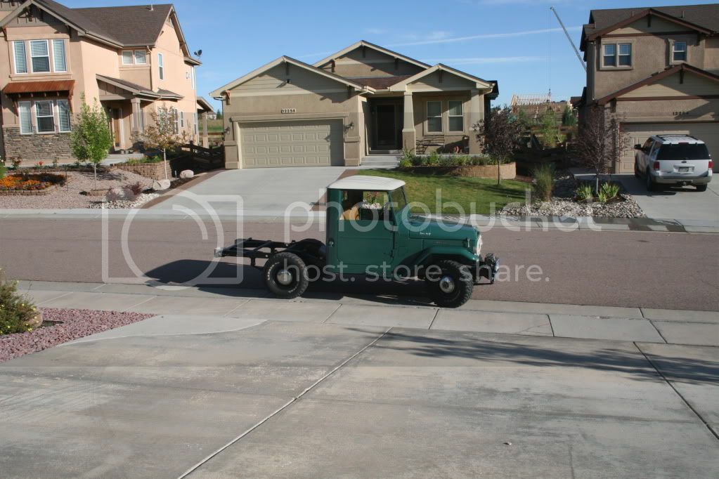

I pulled the 45 out into the sun this morning for a breath of fresh air. (To me) it looked so nice - so I decided to snap a couple shots for you guys. Hopefully you don't think I am flaunting. The 45 just looked so neat at the end of the driveway.
All the best guys and thanks for staying tuned.
Dallas
