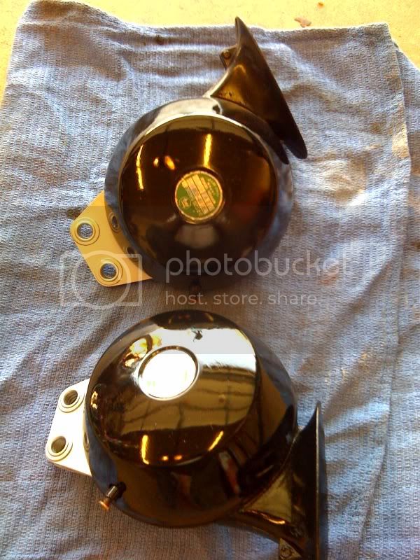

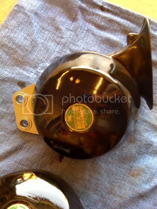

This morning I restored and installed the Horns. Pretty much a pain in the butt.....
Here are the Horns:
SORRY for crappy cell pictures......

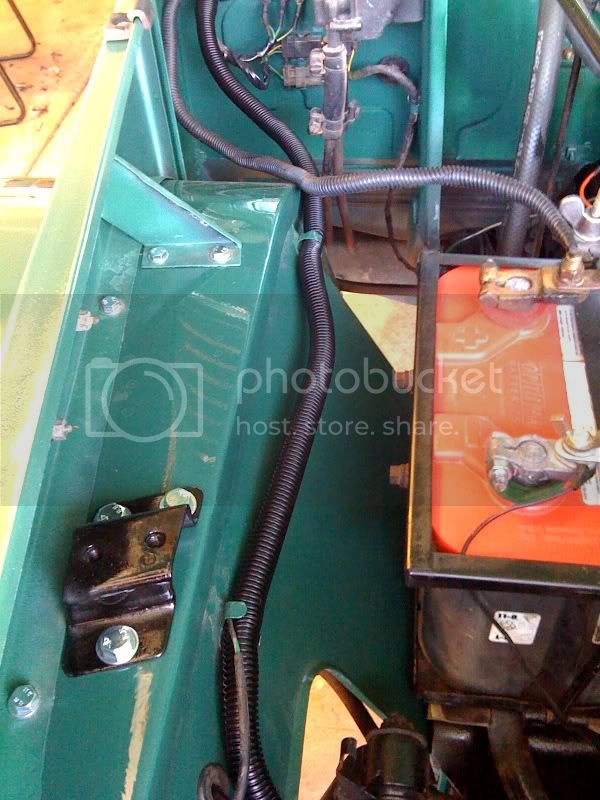

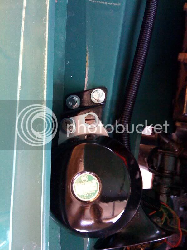

Brackets re-installed onto the fenders:
Installed:

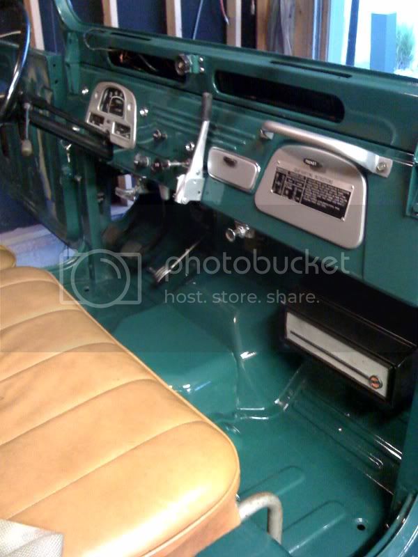

Cleaned up the interior. Just need to order a few more items, install the windshield and then I am good to go.
A question for you guys. . .
What can I use to put on my floor to keep from scratching the paint? Keep in mind I have a 77 FJ40 "Toyota" mat that I am going to use, but what is something I can put down first?
This is not going to see a lot of water, so I was thinking some carpet pad? I don't know....
I know cool cruisers sells that insulation stuff, but doesn't that stick on permanently?
Thoughts?
Many thanks,
Dallas
CCOT has some pre-cut insulation:
Floor Mats FJ40
I put some in my 40 and it helped noise and floor heat a bit. Nothing that couldn't be done more cheaply, but at ~$25, I was happy to have someone else cut the pattern out.
If I were you I wouldn't let damplifier or anything other adhesive sound deadener touch that beautiful floor. I'd rhino-line the firewall before I did that.

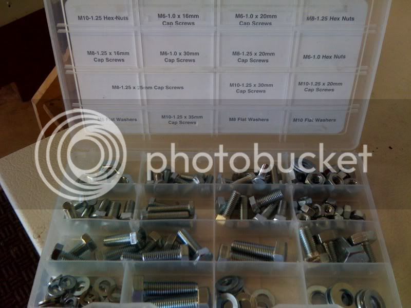

Well, not only are they expensive they are US spec, meaning the 8x1.5mm bolt has a 13mm (1/2 inch) head on it. Whereas all Toyota's used the 12mm head. I know a minor detail, but frustrating.
What we need is JIS spec hardware. Lucky for us Checker (Just purchased by O'Reilly) now carries a little "grab bag" if you will of JIS hardware for about a 1/3rd the price. It's 9.50 for this case of them and I bought 3 cases, and then proceeded to tell the store manager "Thank You" for carrying these.
NOT common to find JIS hardware in the states.
