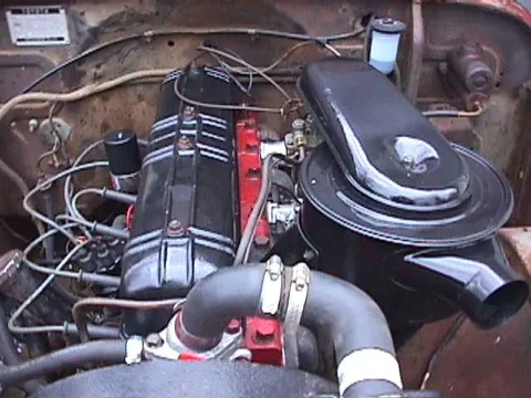

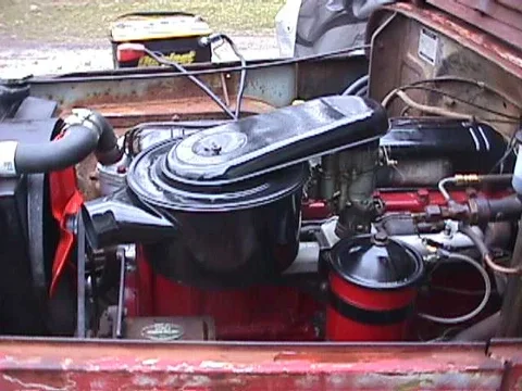

:beer:Hi Guys
Been playing with FJ25, Doing a little clean up on parts, got every thing adjusted and engine is running good, I did a little panting on engine. Colors may not be corect fj25 but it cleaned it up a little. yes i used the original oil filter. will try to add a few pictures.
Thanks Toy25ht Bill

Hi Guys
I am tring to keep it under 50 mph with the battery on the fender. Some day I will put it back under seat or under hood like a fj40. Some one talking about gas caps for the 25, I cleaned and painted the one on the fj25. Is it original for 1961 fj25?
