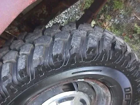

even broke down and replaced the tires ,same tires my uncle drove it home on 35 years ago, went to
Pep boys quote $869.29 for all 4 out the door , the told me they match from other vender so called Discount tire $625.00 out the door, Pep boys matched and gave me 4th tire free, finale cost $460.00
out the door. made by cooper for pep boys Definity Dakota M/T radial 235-85-16 mounted on my 25
wheels, 31.5 inches tall. They ride very well for a lug type tire. note to self next time paint rims before
getting new tires. Still need a fj25 rim for a spare tire.
Thanks Toy25ht Bill
