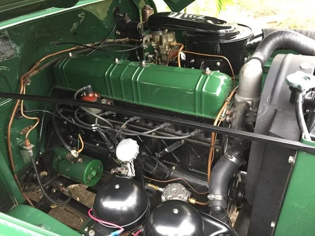

I think that valuation is a bit high to somebody that knows what they’re looking at. 1959 hardtop trucks are hard to find (there’s only a couple known to exist), but this one is missing a lot of FJ25 specific parts and some artistic liberties have been taken.
Does it have the original drivetrain (it does appear to be the correct vintage f120)?

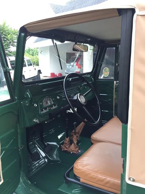

Can you post some pics of the wiper motors and wiring along the windshield frame?

Yes, that is the original drivetrain

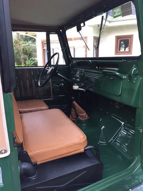

Wow. I have no expertise on valuation but that sure looks like it ought to be in the range your thinking. Looks like period correct drive train if not original to vehicle. Love the pre-build pics too. Do you have any front seat build pics (what’s under the covers) that you are willing to share?
What we know is the land cruiser was all there before the restoration process. Of course i am no expert when it comes to what is missing. We have the original starter but needs new brushes so other than the starter on it now it appears period correct.
I can see if I can seat build pics. Maybe Splangy can chime in on what he see is missing??

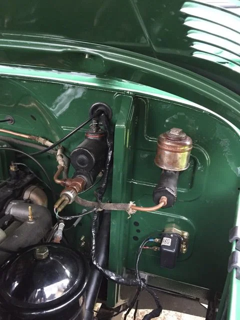

Missing correct fuel pump, generator, voltage regulator, master slave cylinder, front bumper (looks like it should with it), rear tail light brackets, rear license plate bracket turn signal switch and possible 25 steering wheel. That is just a quick look. Did see a clear picture of the gas cap locking style? It is the correct large one?

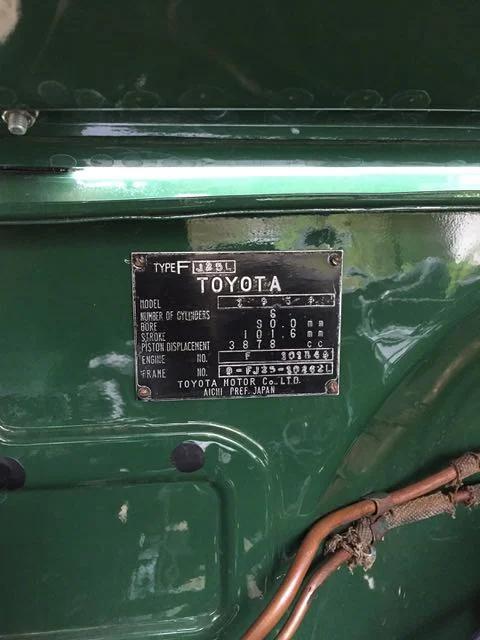

Finding these parts is hard anywhere. I ended up buying multiple 25s to collect parts. The front bumper and gas cap were used on the FJ25 and 61 FJ40. The rest were FJ25 only. Would have to see clear picture of the dash and wipers to tell what's original and what's not. US mainland got vacuum wipers but some got electric. Those were not the normal TNK used on the early 40 series. Looks like you have the tire plaque on dash and missing the plaque for the transmission/transfer case?
