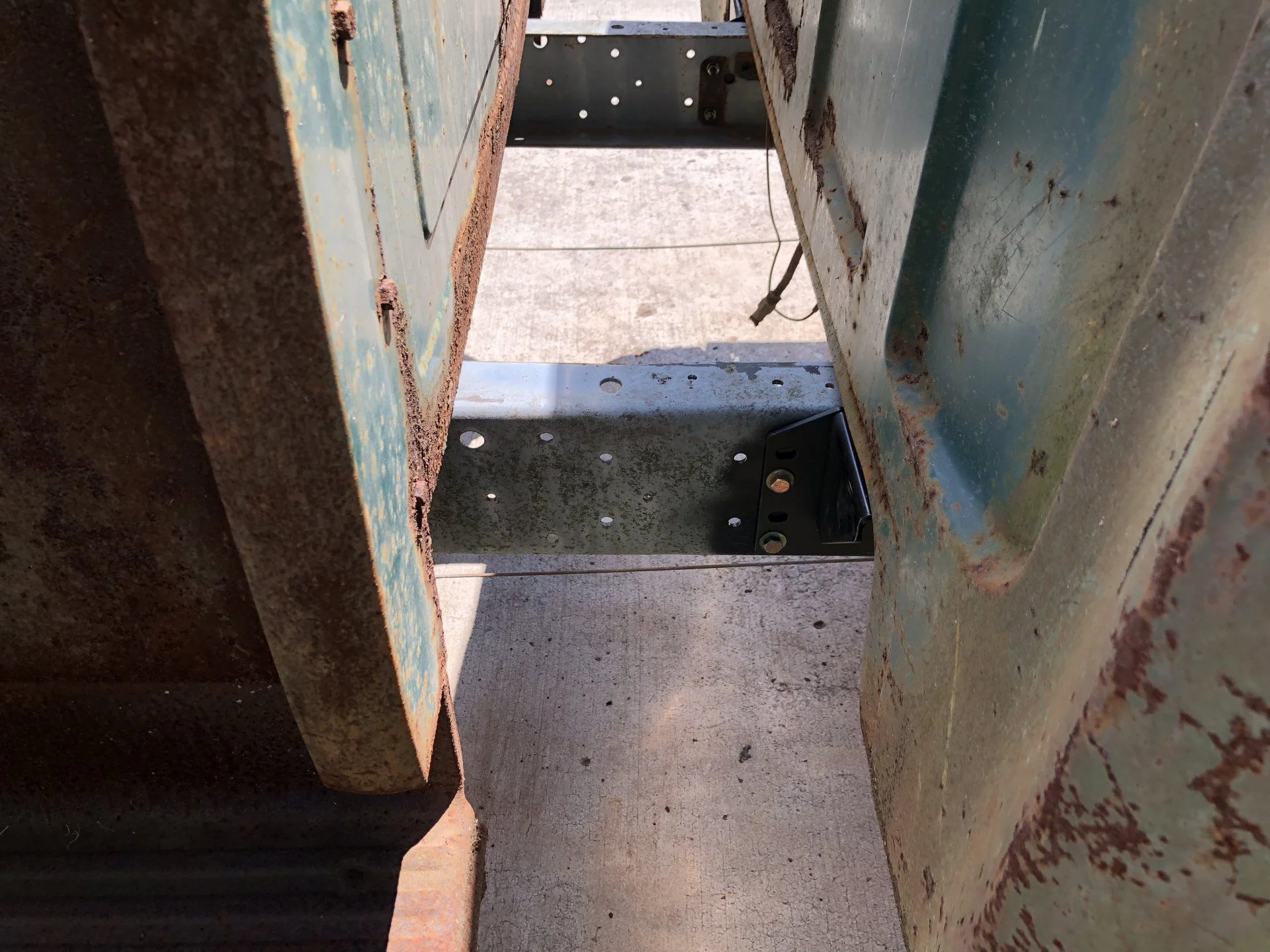

This was the end of the day Saturday. I started by grinding the rivets holding the body mount brackets off of the 76’ chassis. After that I mounted the “EZ Chassis Swap” cab mounts. Then I started dismantling the 55’ and transferring body parts to the new chassis. This is all to test and measure for the frame shorting the 76’ frame will need.
In this picture you can see how much the frame needs to be shortened, roughly 10”.

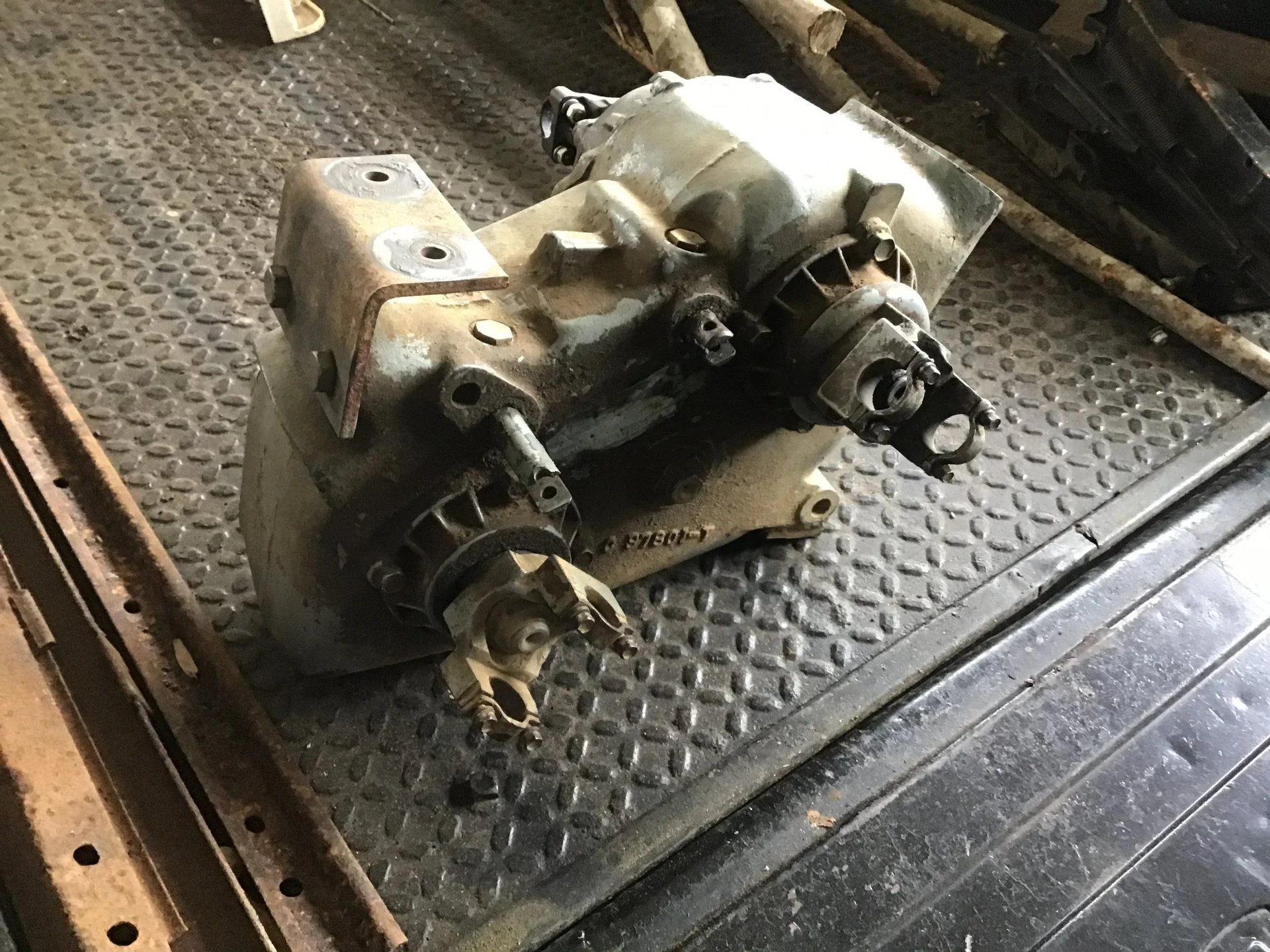

I added another a piece to the puzzle this week. I drove up to Chattanooga and picked up this divorced NP205. It’s in good condition but I will need to find the cross member and a shifter.
Looks like you'll need a new rail too.
@BILT4ME yes it has a broken shifter shaft, but if I use a twin stick shifter those shafts will be replaced anyway. Good eye!
We've got a 70 K2500 GMC with a NP205 and the shift are is worn as well as the pins. There is a vendor you can buy a lot of replacement parts. I don;t recall the name right now.
Also, I watched a guy show something brief doing a crawler that they pulled the rails, ground off an area, then reassembled. The point was they could have 4H, 4L, Front Drive only or RWD only. I have not found any details anywhere yet. I though this would be interesting to allow using just the front to pull you through something or just the rear to slide it sideways if needed.
