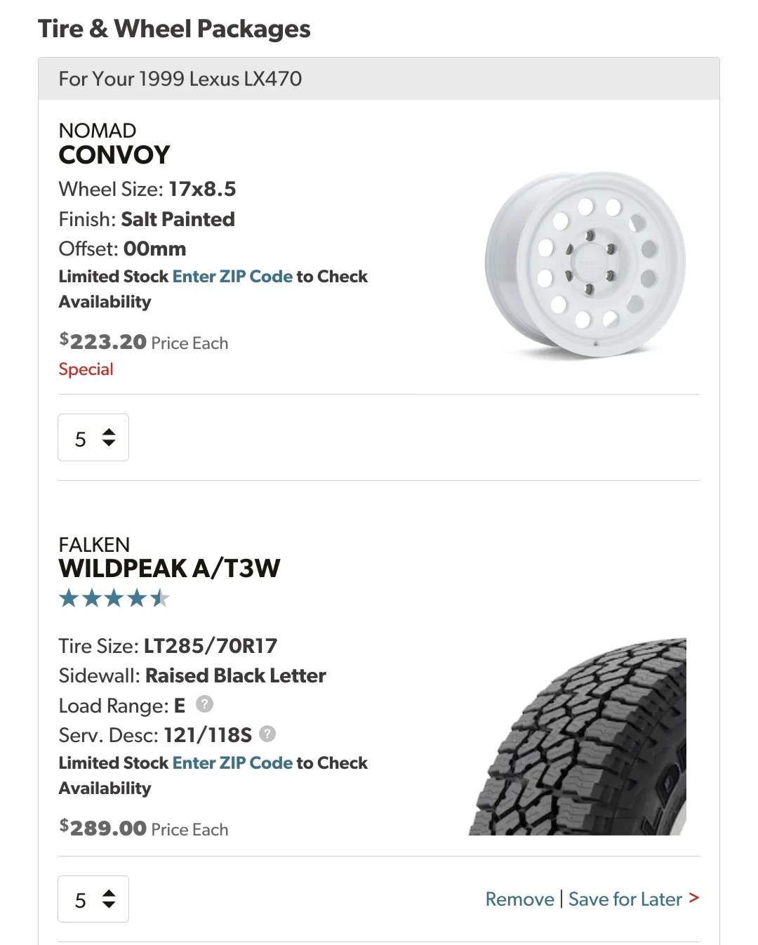

* 17" Nomad Convoy 501SA wheels (0mm offset)
* 285/70R17 (32.7") Falken Wildpeak AT E-rated tires

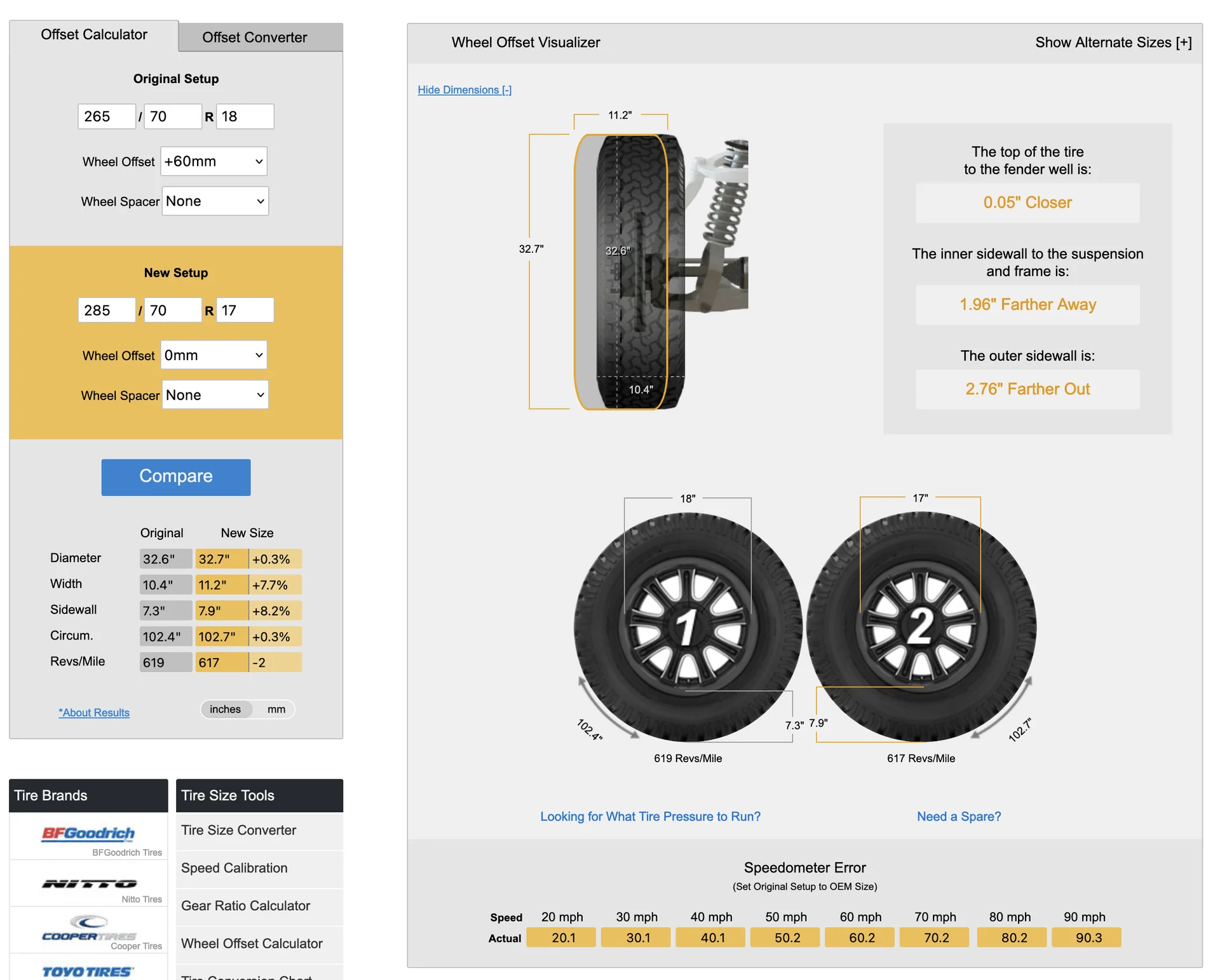

Did some cursory searches and it seems like some people are running 285/70R17s on 0 offset, but most of them seem to have some kind of lift going as well. I am on bone stock AHC and would prefer to keep things that way. I would also like to avoid trimming if possible. I know that +40mm seems to be the best offset for the 100 Series, but unfortunately these wheels are only available in 5x150 with 0mm... and I really like them. Price is nice too.
How bad of an idea is this? Worth contacting Nomad to see if they'd be able to make a set with +40mm?

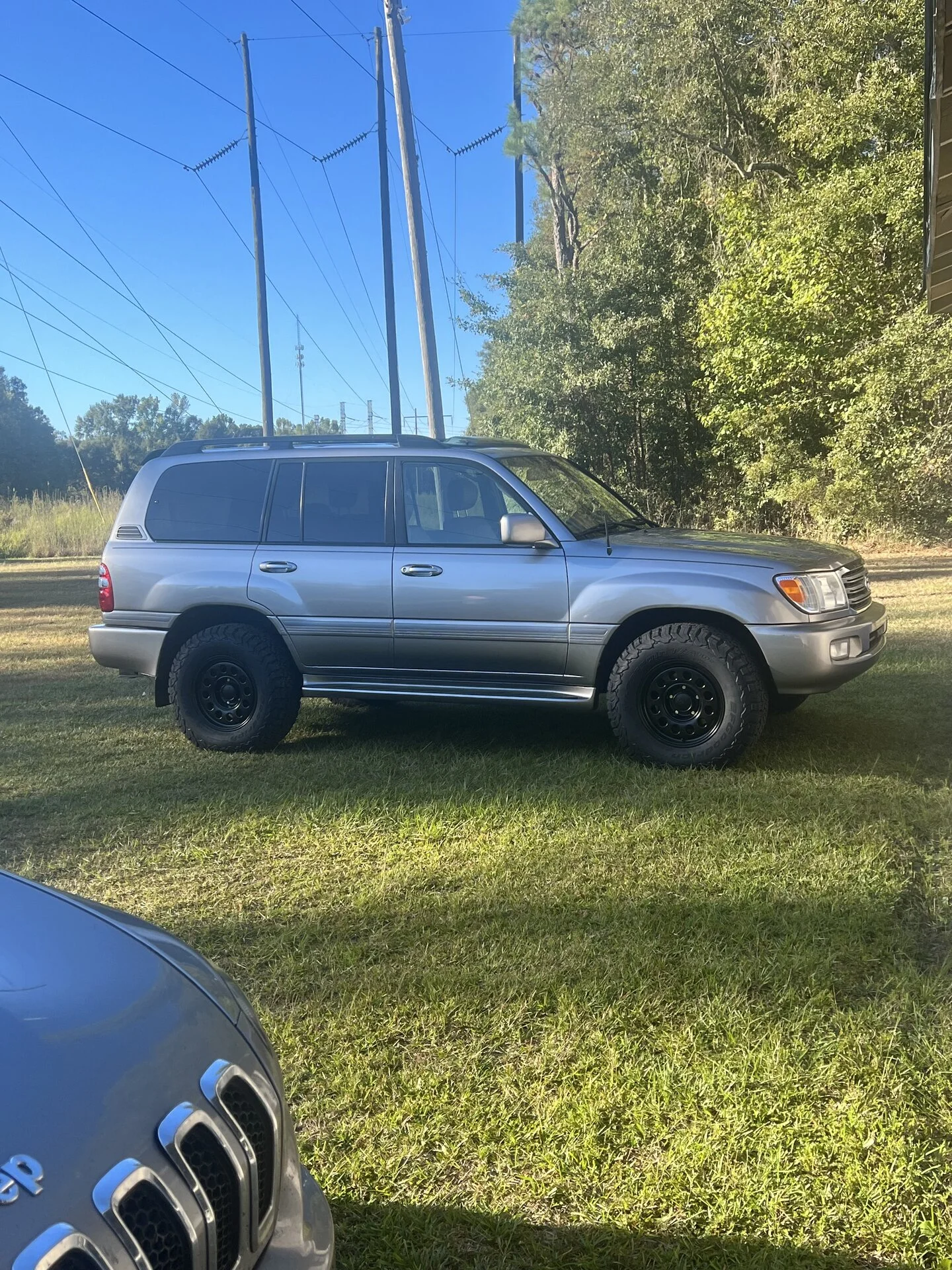

I actually have these nomad wheels. 285/70/17 bffoodrich tires. Stock suspension. I had to jack the torsion bar up an inch and cut the fender well due to rub. Fits perfect. Also check out Tirerack on buying these. I saved 200-300 dollars and they include the caps for the 100 series.

I always felt that 0 offset was excessive, almost 2.5" outboard from stock is a lot and sticks out a fair amount. You may not have issues with those small tires though. Do you even know if those wheels come in a 110 hub?

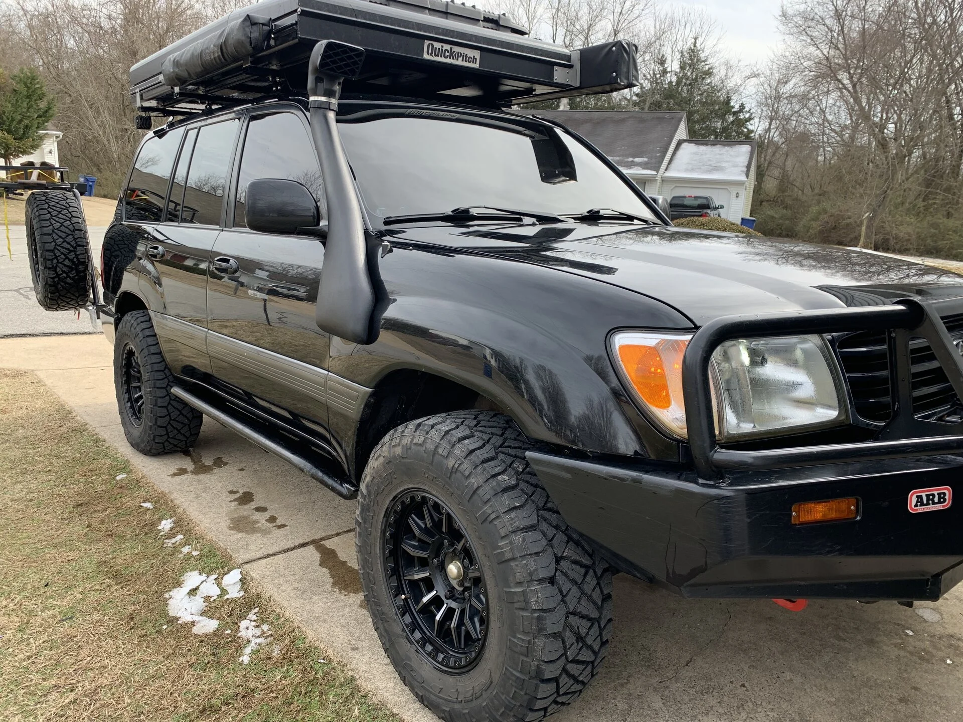

285/70/17 on zero offset is like perfect on a 100 to me..
Looks great, I'm assuming you have a lift since you have a Land Cruiser and not an LX? Did you need to trim or shape the liner?
Thanks for the explanation! Also, the description of the Nomad Convoys says that they require "60 degree tuner lugs" - that's probably something else I should research. Ideally, I'd be able to use the factory toolkit or something similar enough to take the wheel off it pops on a trail... not sure if a product like that exists, or if I should just schlep my torque wrench and the spline adapter with me everywhere.
It did have a 1.5 lift.
Not sure I trimmed anything until I went to 35s

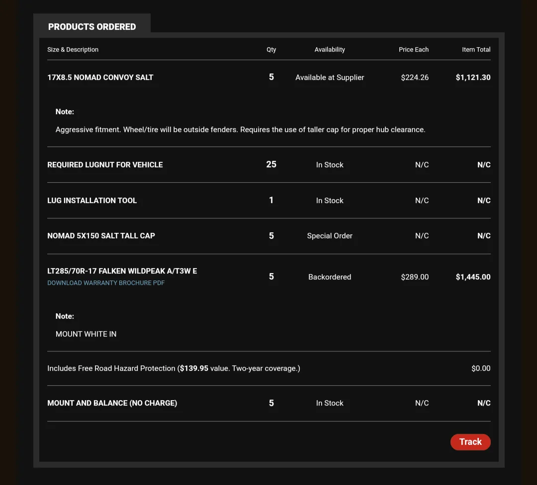

Went ahead and placed the order... apparently the Falken Wildpeaks are backordered and won't arrive in stock until the 29th of December so maybe I'll have to do some research and see what else is out there. On KO2s right now, but I'm looking for something slightly more road oriented.
