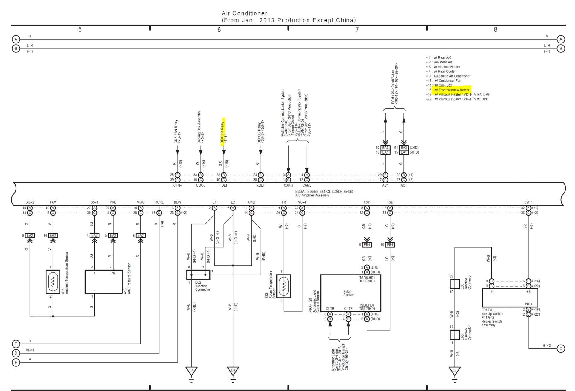

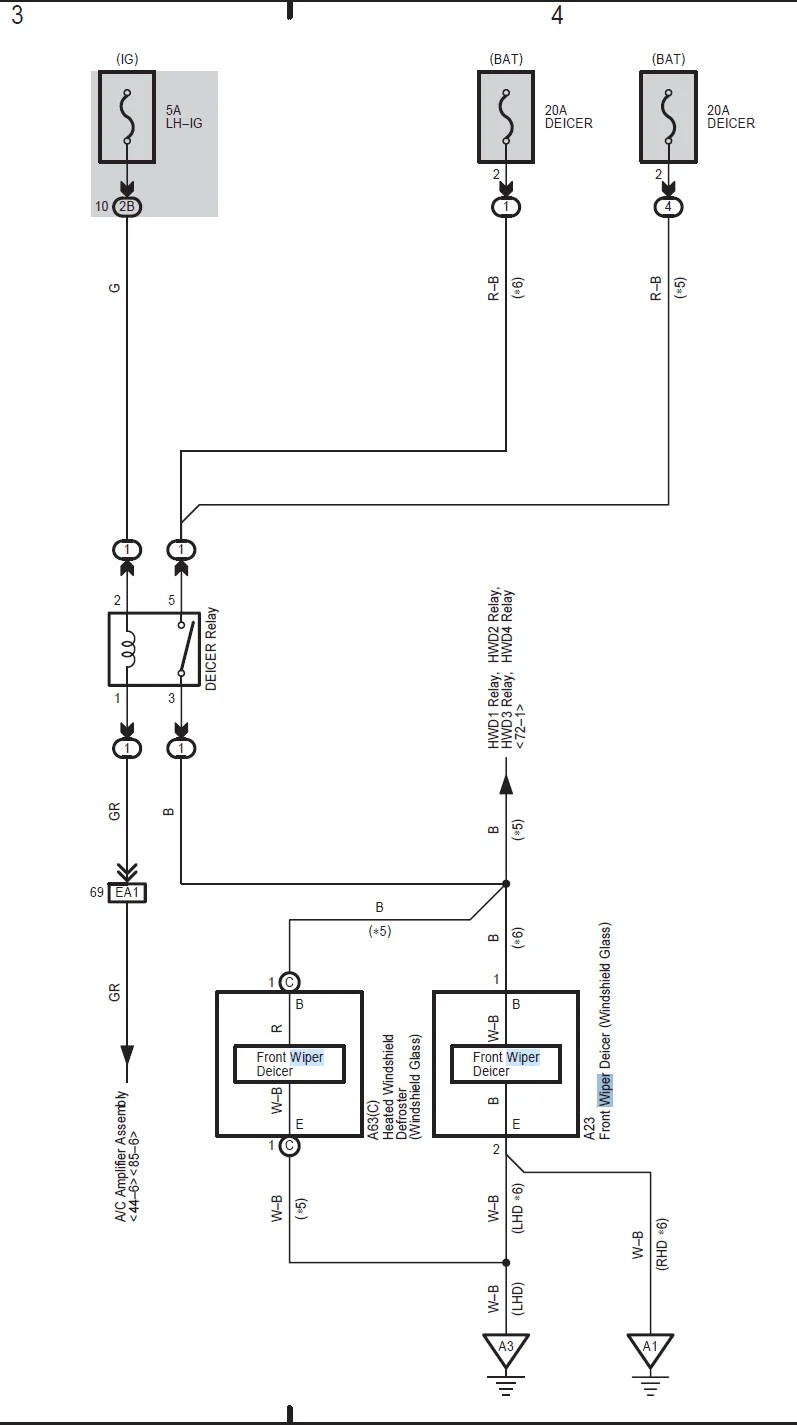

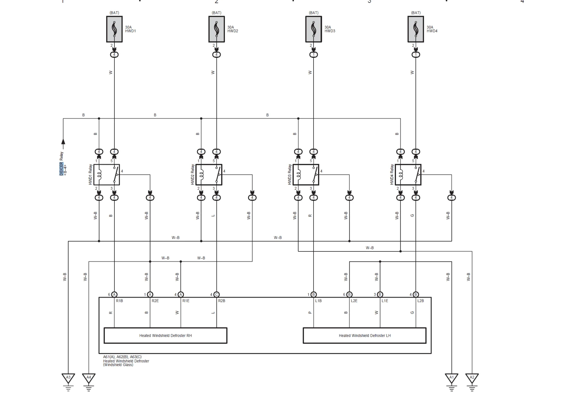

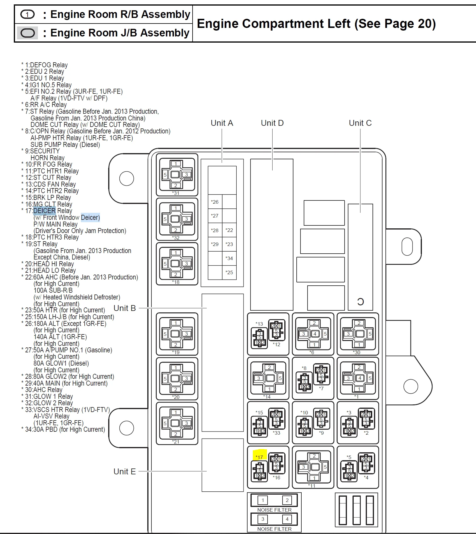

It would seem that we should be able to keep this feature adding an external switch which would replace the relay controlled by the head unit
Looks like the relay is located in the engine compartment
thinking if you pulled the relay and added a switch between pins 3 and 5 in the socket that would provide the ability to use this feature I didnt even know we had :D
