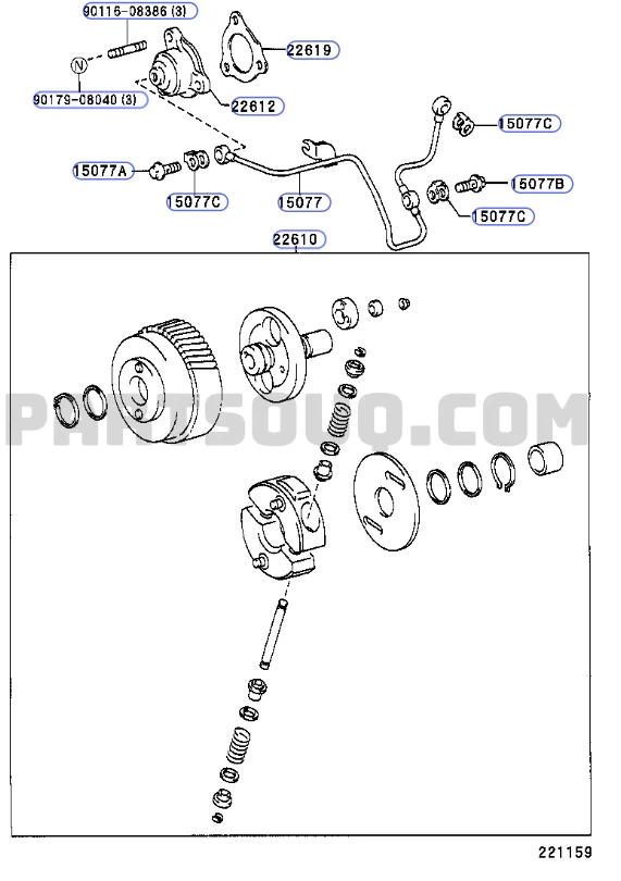

On a journey to diesel swap my 40, and am looking hard at the 15b-FT/FTEs. I have a potential source for an FTE, and originally thought one could just swap a mechanical IP from an FT and toss the electronics. However, I then came across that 1HD-FTEs cannot be easily converted to mechanical due to different IP mounting flanges from the mechanical FT pump. I haven't come across this issue with the 15B-FTE, but looking at parts and parts diagrams, the mechanical FT pump looks to use a 2-bolt mounting flange and splined shaft, while the FTE uses a 4 bolt and threaded shaft which I assume a timing gear threads onto. Is this correct? Has anyone successfully converted a 15B-FTE to a mechanical fuel injector pump? I'm thinking starting off with an FT may be the easier route if I want a mechanical IP.
I understand injectors would likely need swapping to match mech IP pressure as well.
FT pump:
FTE pump:

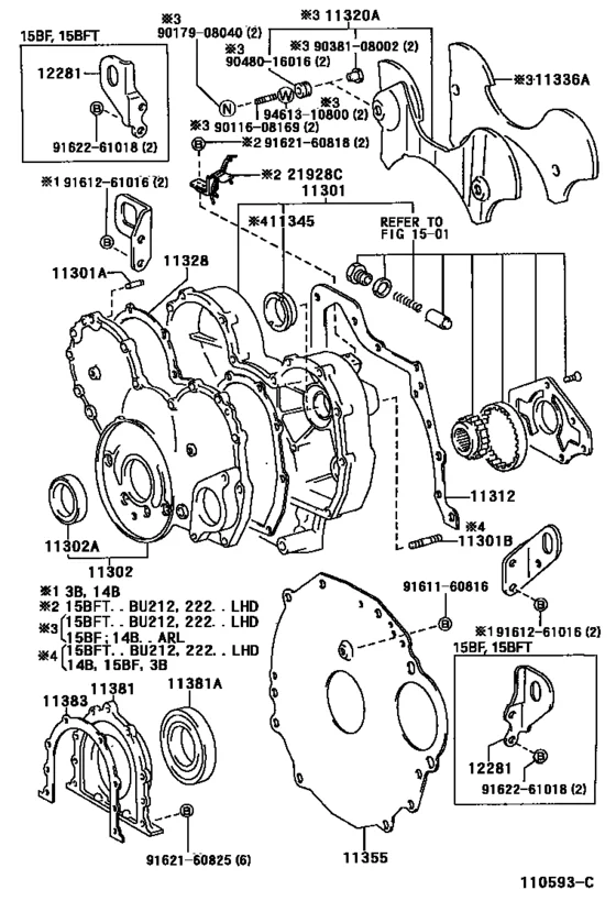

It looks like the timing gear cover on the front of the engine would need to be swapped out for one from a mech IP engine. And maybe timing gears as well.
Hopefully just the back half of the case, here are some part #'s I have found. Would need to confirm whether each is for rotary or inline pump.
11301-58010
11301-58011
11301-58012
11301-58020 (2 stud rotary pump) - This one actually shows up on toyotapartsdeal for some reason.
11301-58021 (also 2 stud, and also on TPD...)
11301-58030 inline pump
11301-58031 inline pump
Seems to be some overlap with 14B timing covers.
Haven't found much info on timing gear setups yet.
This Thread shows timing gear setups of a 15BF and FTE and has some info. Starting to look like more trouble than it is worth unless you have a complete 15BFT to rob parts from.
It does, however, look like the inline pump and some rotary pumps use the same tapered shaft with threaded end which is secured to the timing gear by a nut that the FTE pump uses. One could maybe drill and tap the case to accept the inline mechanical pump.
One more issue, if the other thread info is accurate, is the FTE uses slightly larger flywheel bolts. Unsure of spacing, but could maybe drill out holes on a 3bii/13bt flywheel.
I have found 2 instances of mechanical rotary pumps being fitted to an FTE. One was done by drilling into the FTE timing case and used new bolts/studs, and the other used an adapter plate. Not sure how the adapter works as the shaft wouldn't be sticking out far enough to reach timing gear.
This has been a good learning exercise, but it is starting to look like a big headache and diesel engines are new territory for me. Have not given up, but the turn key complete 13BT package Landcruiser Heaven sells is starting to look appealing...
I have two of the harnesses from Mick Wallin for the 1HDFTE. Those work like magic. I have committed to building two trucks with 1HDFTE’s, but would do a 15BFTE in a heartbeat now knowing how easy it is to use Mick’s harness.
He is not currently building for the 15BFTE but could possibly be convinced in the future.
Looks like timing cover will not interchange with FT. There was a change in front timing case at some point to accommodate a larger idler gear, which was shifted towards the injection pump side a bit and thus not interchangeable with older case. I cross referenced the FTE timing case gasket (11328-58020) as well as engine side timing case gasket (11312-58010) and came back for only the FTE Dynas and Coastsers, so looks like the switch came with the FTE and there were no FT engines with this front timing case/gear arrangement to swap over.

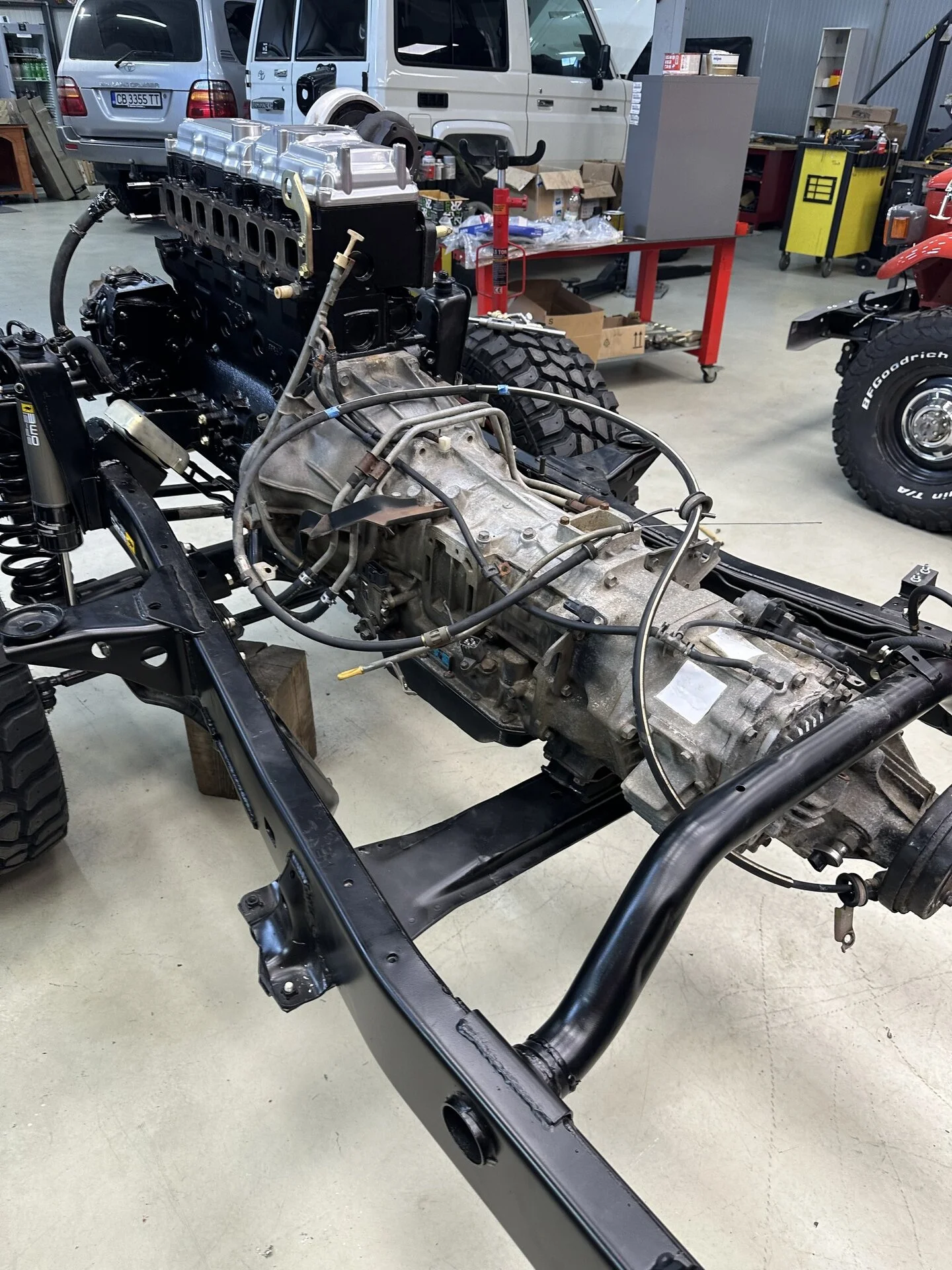

I'd LOVE a megacruiser half cut which includes transmission and t-case. If half cut, than 15BFTE would not be a bad option, as all wiring/electronics are there.
They fit very nicely into 70 series frames. Here's a megacruiser engine/trans/tcase in a HZJ78 frame:
